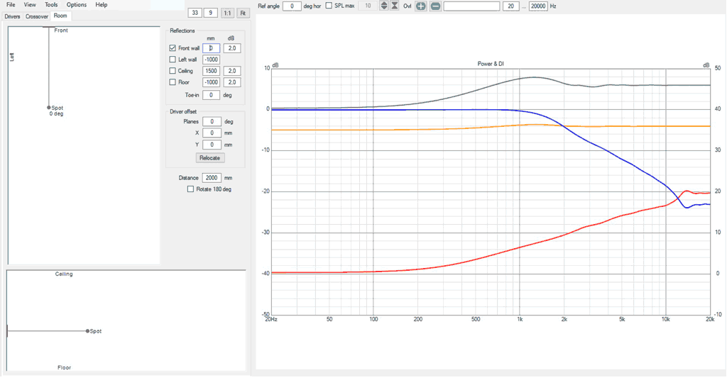

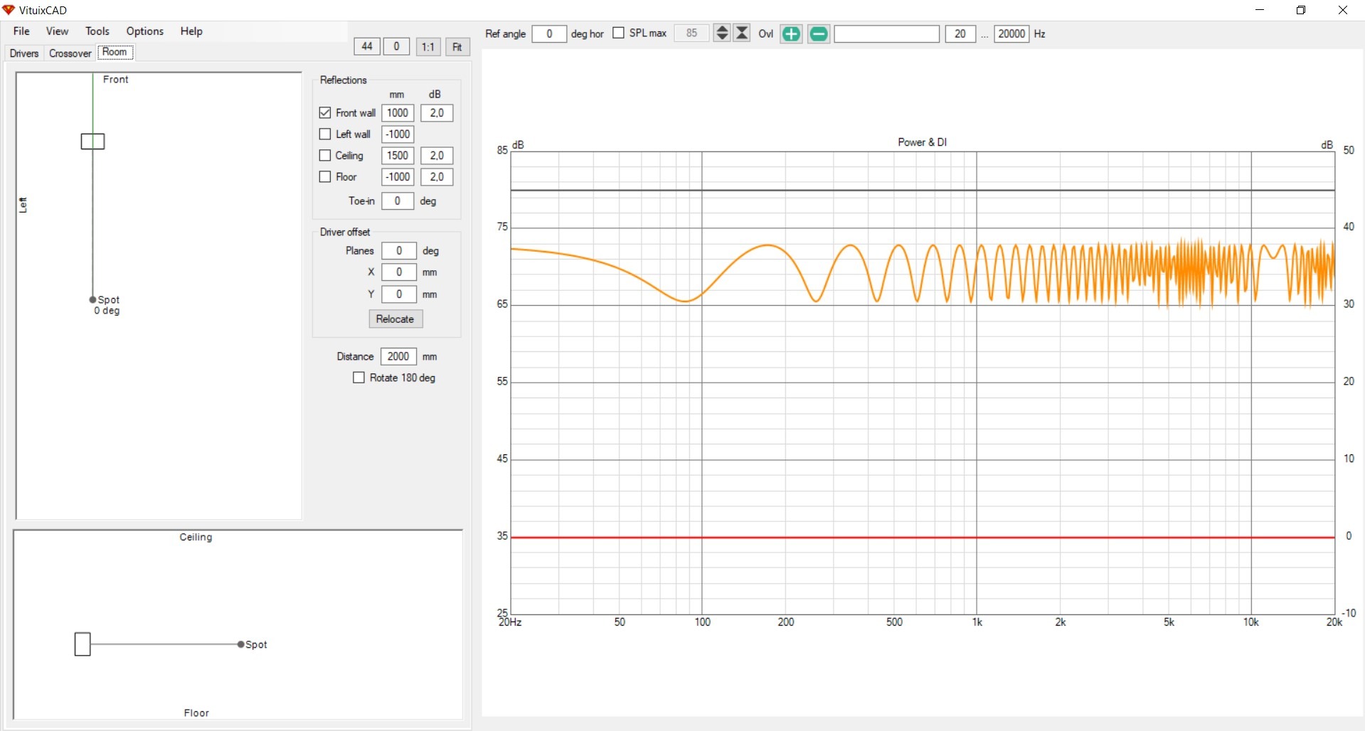

Here is simplest demo on the subject:

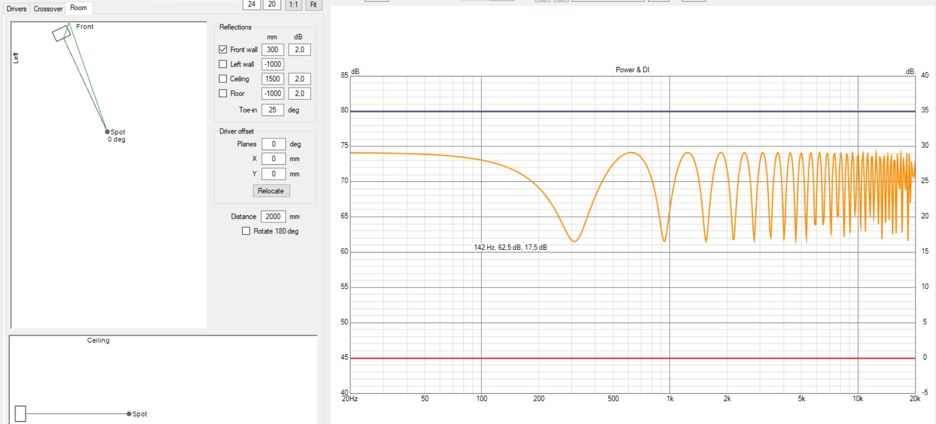

Attached again same made up 30cm distance from wall and only front wall reflection. Ideal driver (omni). As it is seen the first interference null happens somewhere in low mids. The first deep null is there where the path length difference of direct and reflected sound is 1/2 wavelength. Basically, with long enough wavelengths, where the path length difference is roughly < 1/4wl, the direct and reflected sound combine constructively. But, as the frequency rises, wavelength shortens and the interference happens, initially with rather wide nulls that get narrower as frequency rises, a comb filter. The interference pattern is same regardless of the distance to the wall (path length difference), only the frequency / wavelength where the interference starts shifts down as we get longer path length difference.
If we are very close to the wall, so that path length difference goes towards zero, the first null is very high in frequency and we are in half space below that, but this is almost impossible without going inside the wall (or very wide baffle) since almost any drivers have several centimeters worth of structure behind the diaphragm. The shorter we get the path length difference the better in this regard best being flush with the wall, no reflection, no path length difference, no interference.

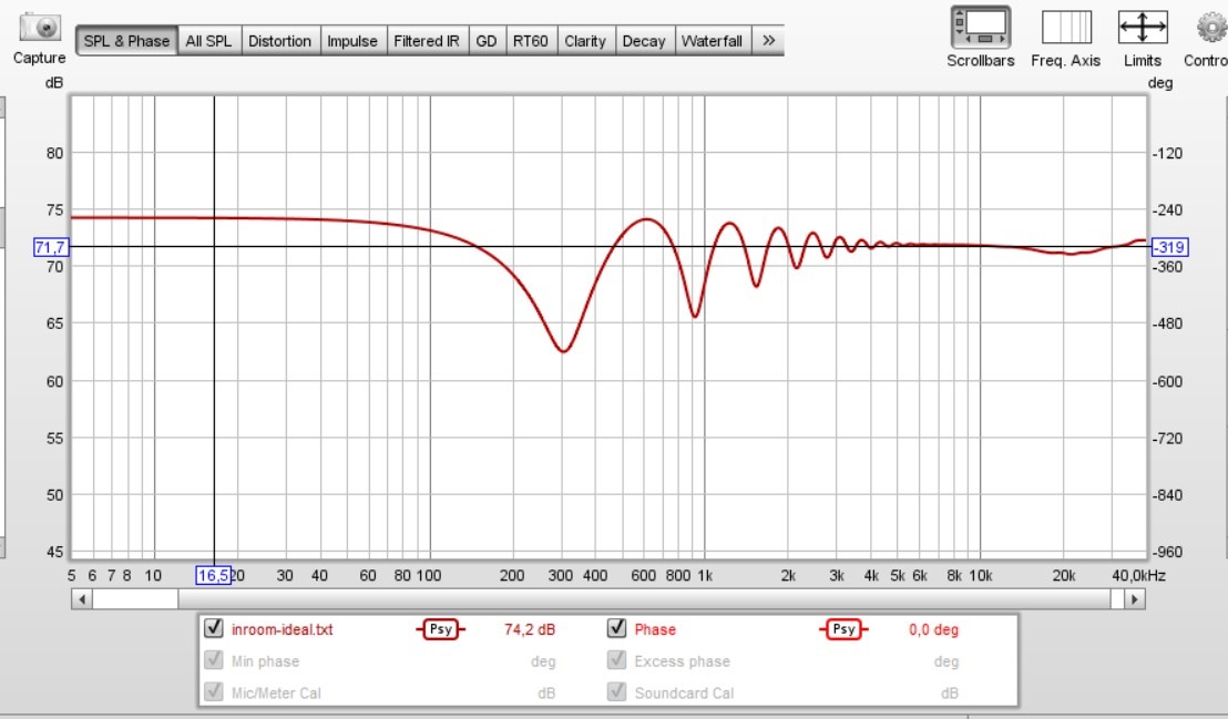

Second attachment is REW psychoacoustic smoothing applied to the first attachment interference pattern. "Psychoacoustic smoothing uses 1/3 octave below 100Hz, 1/6 octave above 1 kHz and varies from 1/3 octave to 1/6 octave between 100 Hz and 1 kHz. It also applies more weighting to peaks by using a cubic mean (cube root of the average of the cubed values) to produce a plot that more closely corresponds to the perceived frequency response." and if we apply that to the interference pattern we see that roughly around 3kHz the "perceived interference" gets to +-1db territory and then vanishes. Worst thing is the lowest dips, very wide null.
Alright, on this ideal scenario there would be few things to do. For the worst interference dips we can push them higher in frequency by reducing path length difference of the front wall reflection and direct sound. Here we had the transducer only 30cm from the wall and few meters listening distance to get path length difference so that first null is as low as 300Hz. On the upper end we have the psychoacoustics to help, as well as waveguide that don't need to be very big to effectively reduce sound to the front wall reflection point as demonstrated in the previous post, above few kiloHertz perhaps. This leaves the bandwidth between roughly 300Hz and up to few kiloHertz that would benefit cardioid response, in this particular example case.
edit. regardless the system being cardioid variety or not, the second attachment shows the main problem bandwidth with front wall reflection with on wall sokutions. The reflected sound combines back with the direct sound which seems to be audible at the mid frequencies unless very thin physicaly. Not considering all the other reflections that happen, sidewall, ceiling and floor, back, which might average things out. Besides using cardioid to attenuate the reflection we could utilize other ways to reduce the interference, for example: rise the reflection zone out from the wall to reduce path length difference, or have attenuation at the first reflection point in form of absorption or active system, very thin panel with beam steering or what have you. But this is the problem, if any, the mid bandwidth that is poisoned by the front wall reflection.
Note, any other speaker system further out in the room would have the same interference problem as well! Only starting lower in frequency as path length through the front wall would be longer. Some attenuation and extra delay with the longer path length might make it less apparent than with the on wall setup we are inspecting here. I don't know. All I want is problem free near wall solution 😉

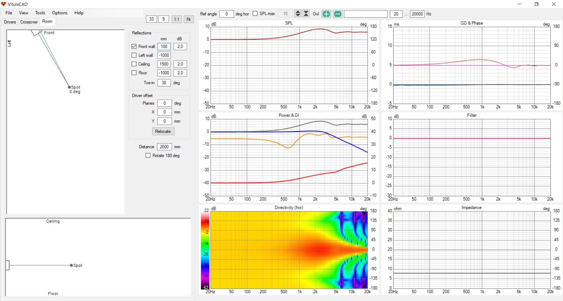

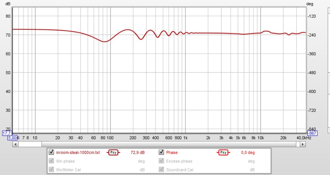

Here is few more of the simplest kind.
I mentioned in the last post that as the path length difference gets longer the interference pattern just comes down in frequency. Here is few to this.
First attachment, everyone says that speakers sound better as they are farther from walls. If it was only for the frequency response / interference here is why, psychoacoustic smoothing applied ideal point source 1m from front wall (2m path length difference). Just to demonstrate how these look on the graphs. Note how the pattern of the interference is same as previous post, just lower in frequency. Comparing the 1m away or on wall, the main difference would be the smoothed ripple gets within +-1db below 1kHz when positioned further out! Not considering time difference and other possible phenomena, but this alone would suggest further out sounds better.
Now, what if the driver beams? Surely there will be frequency above which not much interference happens because of the beaming, no much sound to the back? Two GIFs demonstrate this, the first one is ideal 8" driver on minimal 21cm x 21cm baffle, and the second one is ideal ~3" driver on minimal 11cm x 11cm baffle. This is very interesting to tweak realtime in vituixCAD as the interference just pulls out from the DI ~10db region as the driver is pulled out from the wall 😀 Anyway, only centimeter or two out there is huge interference and smack dap at the most sensitive region for ear, around and above 1kHz. The smaller driver just has the same phenomenon higher up in frequency. If I did this with 15" driver, it would be quite similar, 10db DI point is just about 1kHz when with the 8" it is around 2kHz and with the 3" around 5kHz.
This is easy test to setup, few clicks and anyone can try and reason what the implications might be 🙂 Toe in and listening triangle doesn't change the situation much to the straight on used in the example, it is the path length difference that matters. Even if we didn't know how much this all affects to sound, this is still what the difference is between on-wall and furhter out position, the interference is higher up in frequency.

Second attachment is REW psychoacoustic smoothing applied to the first attachment interference pattern. and if we apply that to the interference pattern we see that roughly around 3kHz the "perceived interference" gets to +-1db territory and then vanishes. Worst thing is the lowest dips, very wide null.
This illustrates problem with the simplified version. When you only consider one boundary the result will not be at all valid higher in frequency, in practice.
In a room, by about 1KHz the speaker is in control and the interference has reduced to very little. All of the sources real and reflected/diffracted are combining together and settle down to a predictable response. You can see this in Vituix too, that when more sources are added the interference goes down.

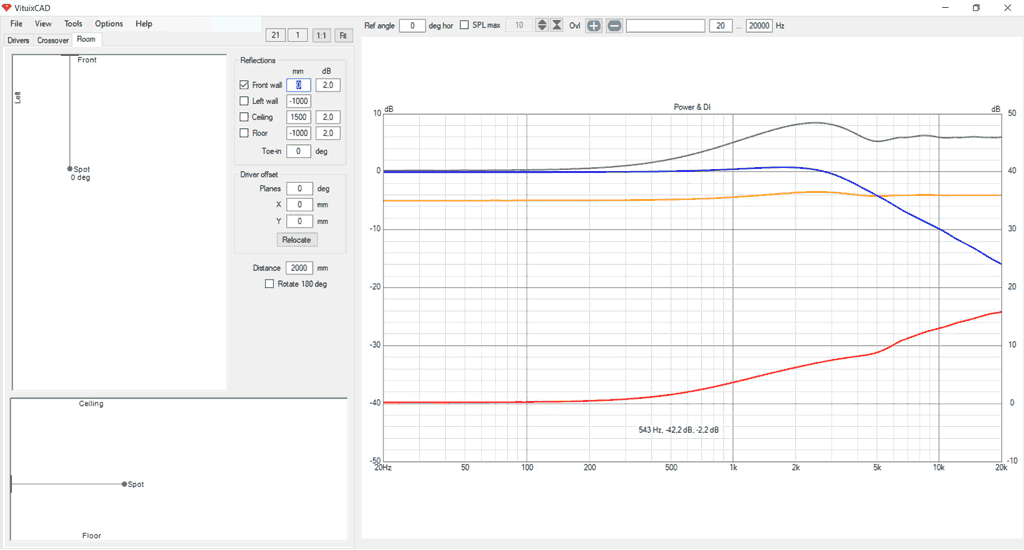

Yes I know, the listening distance stays the same in VCAD. How ever this is not relevant for the demonstration since we have the path length difference that makes the interference happen and determines the frequencies the nulls are. Moreover everyone's listening situation varies. Only thing we can deduct from this is that the path length difference of direct and reflected sound can be minimized bringing the speaker closer to wall and maximized taking it further out. It is pretty bad between path length difference of 1cm - 100cm. Then there are some cheats we can apply like bring just the reflection point closer, apply some attenuation to the reflection one way or another. Attenuation is very best option to my logic, to the frequency range that has the sparse interference dips = 1/4 wl and up.
As what comes to the multiple boundaries all making reflection and contribute to the frequency response at listening position, yes definitely. And VCAD doesn't even have only but the one room corner to test with. It might turn out that there is so much going on in the rooms so that the interference doesn't matter much if it all averages out. Although, people seem to report close wall sounds poo and further out sounds best, it would indicate there is something to it. And wasn't it Toole who had to make a revision of the book to correct the early reflection point of view?😀 Be it time delay difference or something else, or just the interference from the front wall being worse sounding somehow, that is visible in the simple experiments here.
Anyway, I've made many experiments with the simple VCAD room model and it looks like there is nothing I can do to average out the 1kHz region with speaker and driver positioning and radiation patterns. Low mids seem to even out with speaker positioning and then some with cardioid pattern but the 1kHz shows anomalies no matter what 😀 basically a very narrow pattern waveguide there, or MTM configuration helps, brute force attenuation towards the ceiling and floor reflections. None of this might not matter though, I don't know how audible it is and how it affects. Just an observation from experiments.

My demos are a bit misleading, since AllenB noted earlier the reflection line to the wall in the room view goes through the box. Yes it does, I'm trying to demonstrate the path length difference and not how it looks on the room view, only the graphs matter. We are dealing with reflection from wall, which we could possibly get rid of or at least attenuate. I've got the 3D model on the forehead🙂

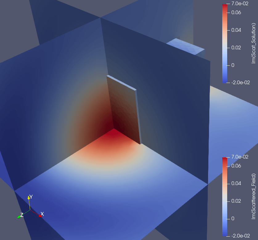

Only had a short time free yesterday but made some progress. The weird plot shown earlier was due to user error/misunderstanding rather than software bugs. This became apparent when I got the BEM++ software working to some extent and saw pretty much the same thing with my test case. Current plot using acousto attached.
Both BEM solvers have issues which make them less than ideal for our purposes. Both need a modest amount of scripting to manipulate the input grid and field data from the upstream grid generation stage and to manipulate it for the downstream evaluation and plotting stage. This is not a significant issue just part of adapting research-type software to our needs. Nonetheless they both seem to work if not as well I would like. Rather than continue looking at BEM solvers (I have noticed one or two that might be possibilities) I am going to pick one of the current two and adapt it to use for the initial on wall study. Not sure which one yet.
Perhaps I should add that I am keeping in mind what we will need later in the project when designing the details of the cabinet structure and simulating the radiation from the vibrating cabinet rather than just the driver. I have used acousto for this before a few years ago but it was a bit fiddly in terms of input files.
