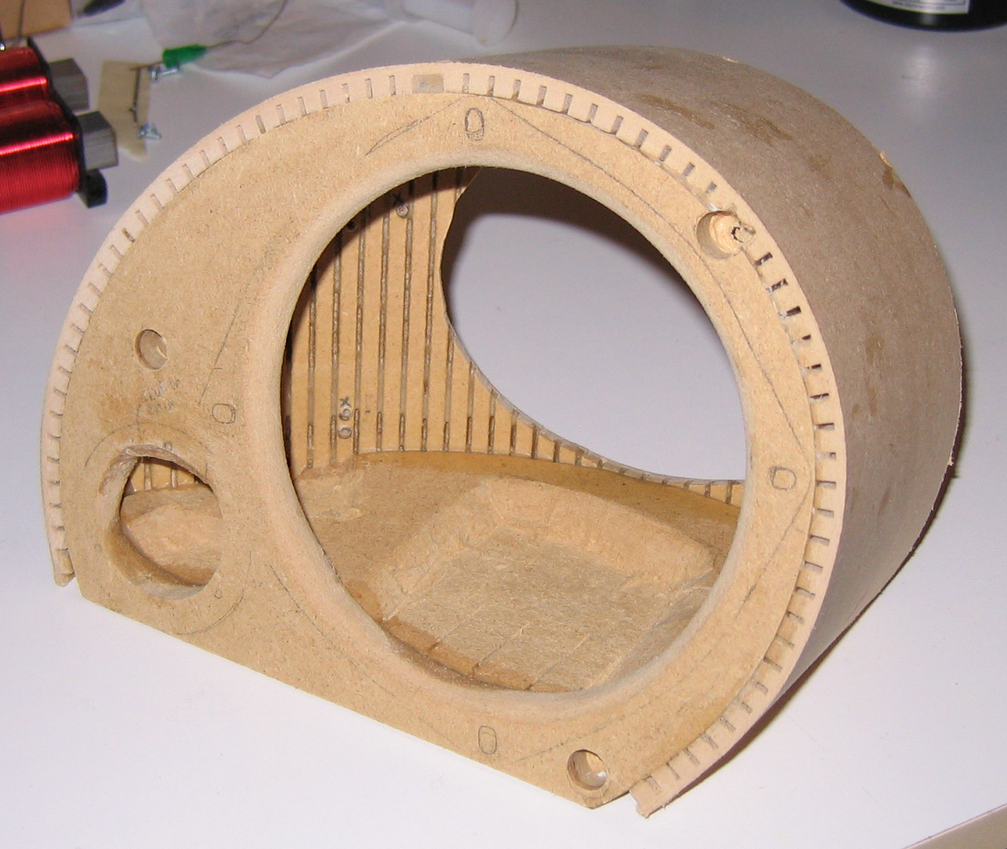

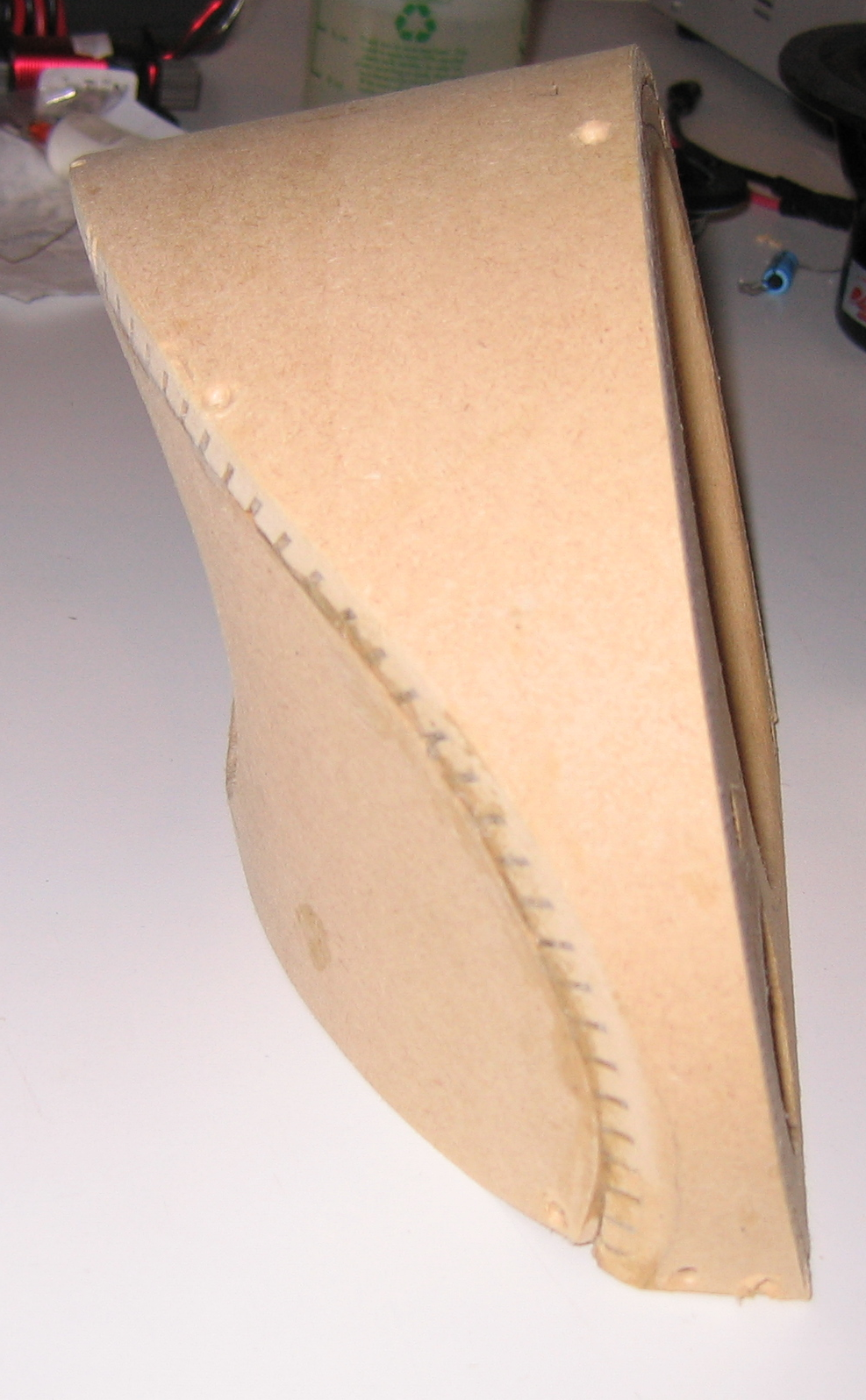

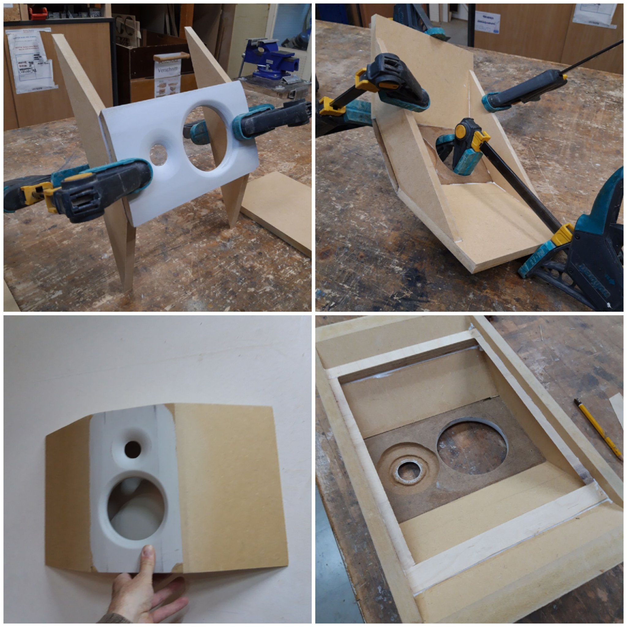

Yes, I used the circular saw blade for the kerfs, about 4 mm wide. And the MDF I used was of a not very flexible type. I would only consider such a technique for much bigger bending radiusses and multiple sheets.Your kerfs look a little wide, and your radius a little tight.
And then I'm not so sure I would really make all those long cuts ...
Prefabricated material is defenitely better!
Did you use it for a speaker project?to get it to do what I was asking.
Yes, but it was a small desk speaker, so the rigidity required wasn't extreme. The cross section was basically elliptical, which also helped stiffen things. A couple pics from the middle of construction:
They were ultimately veneered, but I don't have pictures handy of their completed state.

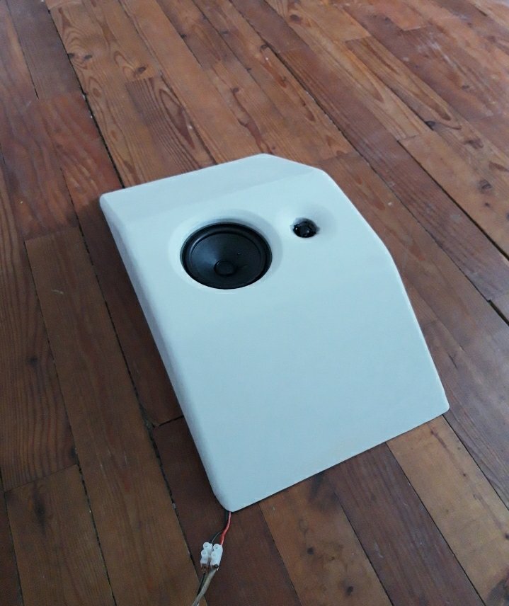

Low cost wall speaker building progress:

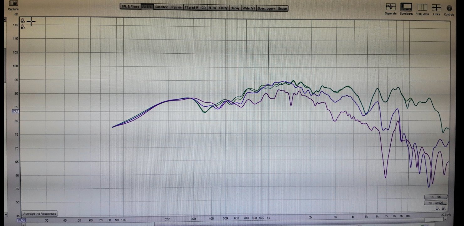

First very rough measurements ...
The speaker rests on the floor, mic at 50 cm above.
One advantage of a wall speaker is the extended gating window duration of ~11 ms 🙂

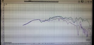

Response 0°, 30°, 60°:
The cancellation at 350 Hz is the result of a (mild) reflection of the floor, next to the slanted baffle sides and the more pronounced step at the top and bottom of the speaker.
Baffle step can be seen above ~600 Hz.
Driver: visaton fr10 without whizzer cone, see here.

By the way, I suspect the 3 kHz wiggle may be result from the rear mounted driver. I will try to reduce the thickness of the exposed baffle edge by countersinking the driver from behind.
The crossover frequency to the tiny 14 mm polycarbonate tweeter will be around 4 kHz.
This is a very low cost and driver recycling project, to be installed for background music in the local maker space.

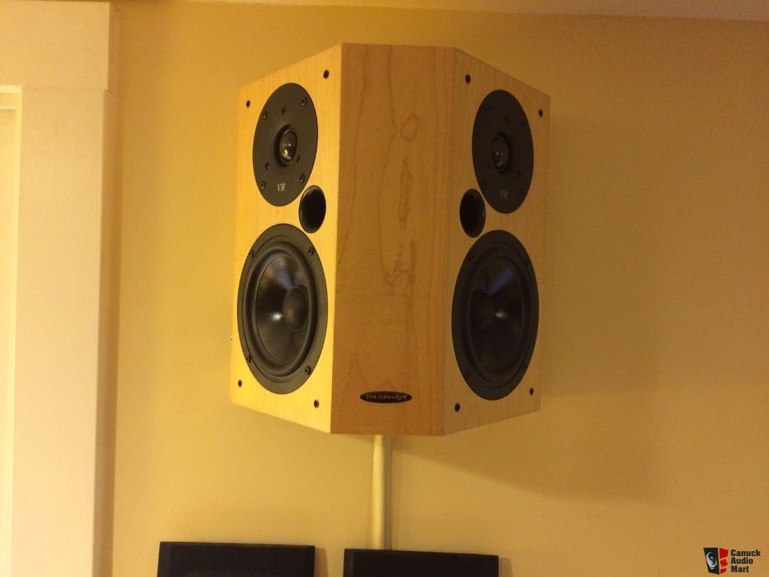

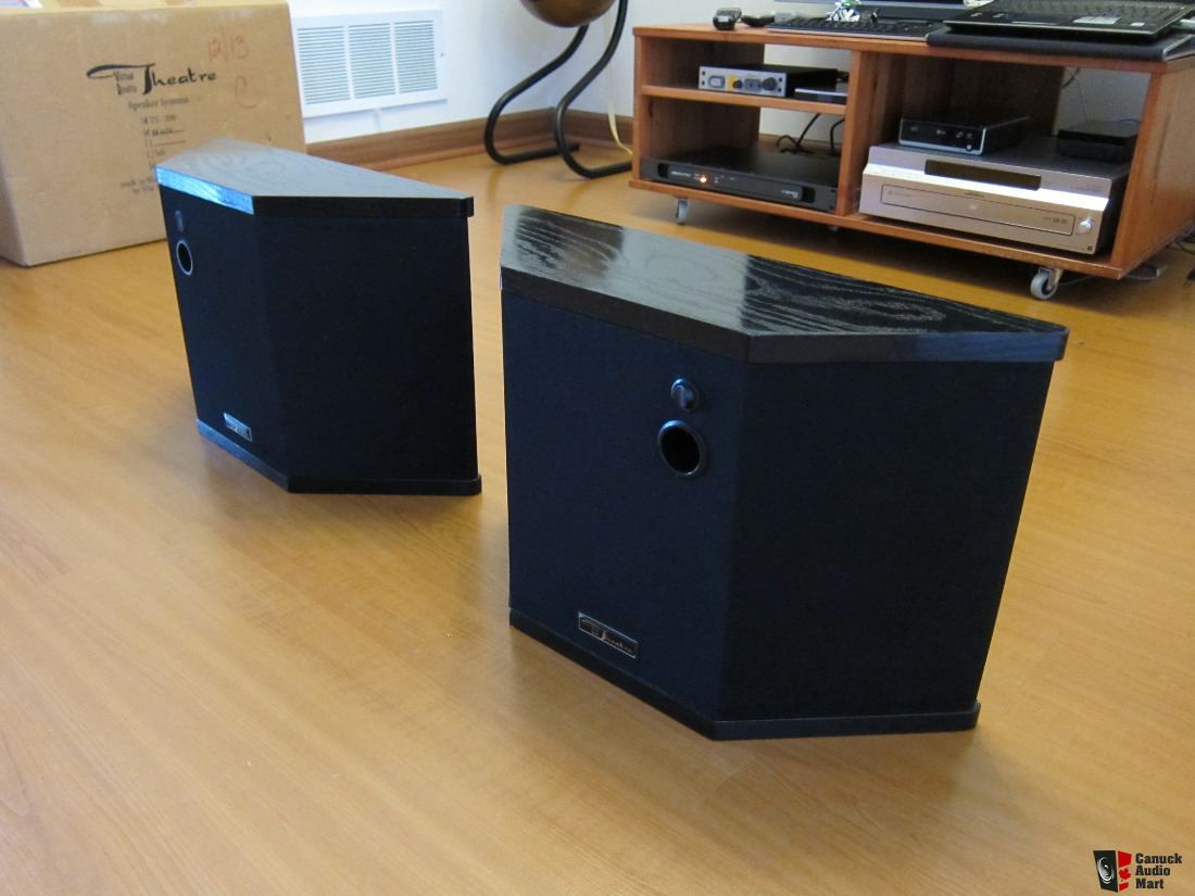

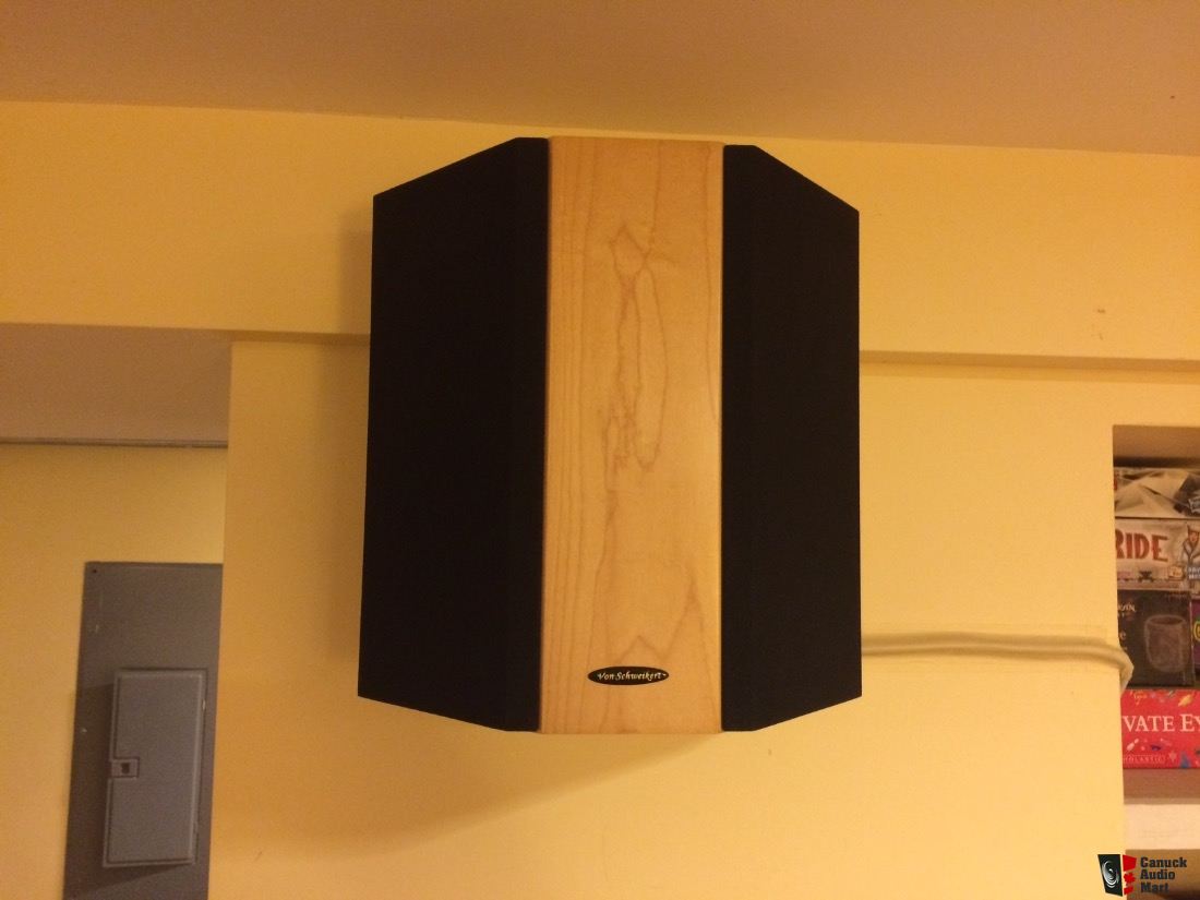

Your shape on the wallspeaker, is the shape my guru Albert Von Schweikert used in his 2 largest wallspeaker.First very rough measurements
Name on them is TS-200 and TS-150, and i have both of them.
Virtual Reality series from 1998-2003.
They are switchable between monopole and dipole operation via a switch, which allows tailoring the expansiveness / openness of the sound depending on the program materials.
The smaller TS-150 have 2 x 5,5" ported and 2 x tweeter, in two directions. (Dipole/monopole selection switch)
Power Handling: 200 watts nominal input (music power).
Crossover: Our proprietary Global Axis Differential Network enables either in-phase (monopole) or out-of-phase (dipole null) radiation patterns. Crossover point is 2.2 kHz.
Frequency Response: 40Hz to 25kHz +/- 3dB, (60Hz to 20kHz +/- 1.5dB) 20 kg
I have not find the manual for the TS-200, but its twice the seize and a "killer"
TS-200 has 3 x 6" ported and 3 tweeter, playing in 3 directions. (monopole / dipole surround speakers)

They are surround speakers, not front L and R.the shape my guru Albert Von Schweikert used in his 2 largest wallspeaker.

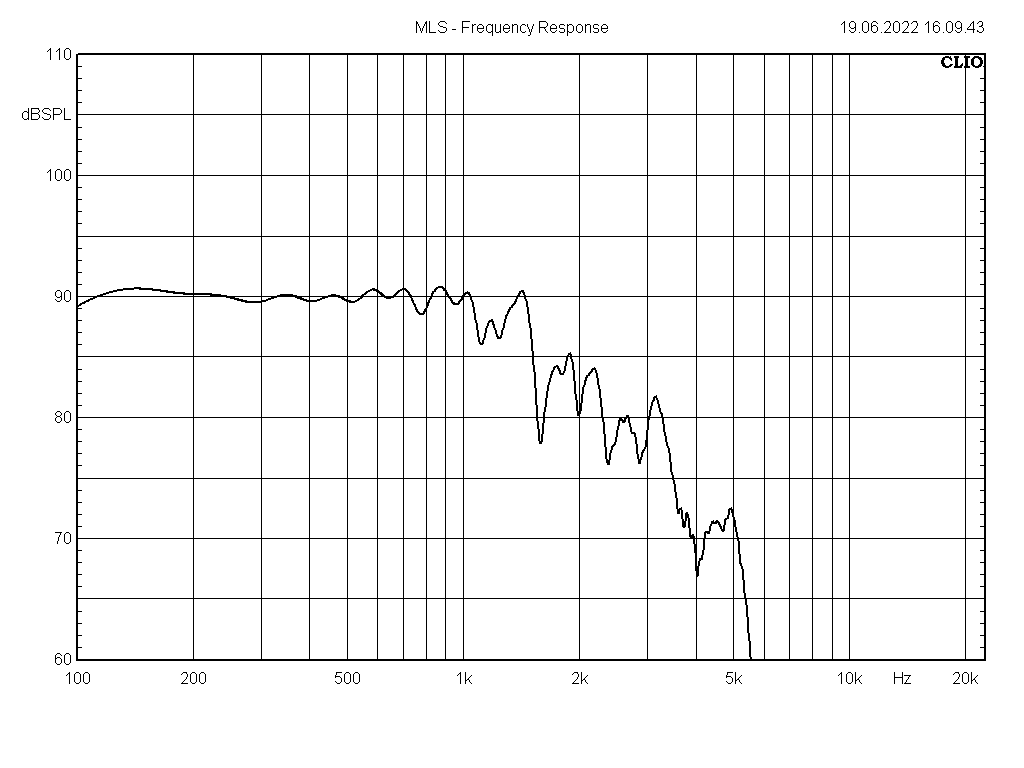

This depends very much on the design of the enclosure and the eventual phase plug - compare frequency responses in Fig. 7 and 8 to Fig. 10 and 11 in the paper from post #149. They are measured directly in front of the speaker ("on axis", 0 degrees), but with adequate phase plug (not fully optimized here) measurement at 30 degrees (not presented in the paper) is very good also:
Here null is at 1580 Hz, but is very narrow, although enclosure is not-so-small 18 cm diameter globe. Integration with a tweeter high-passed at 2 kHz with Linkwitz-Riley filter is very easy, leaving only very narrow and shallow notch at 1580 Hz.
