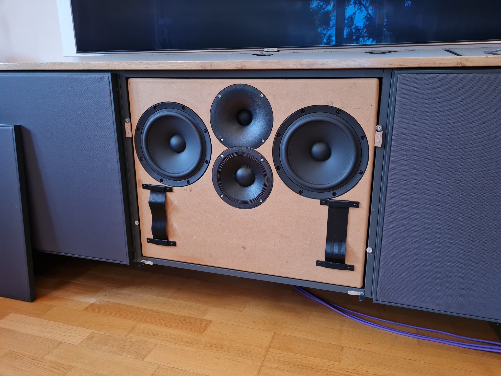

Hi guys, did you finish this project? working on onwall speakers right now (similar like in the description in the first post of this topic - home theatre LCR speakers, closed box with 2x SB acoustic SB23NRXS, Lavoce MAN061.80 as mid and Dayton RST28F in WG300 waveguide) and it will be nice to have a chance to gain from your experiences.
Boxes are integrated in the cabinet below tv - see photo below - making everything even little bit more challanging (diffractions - but the frame in front of the speakers solve most of it and tweeter response is very flat). The biggest issues are caused by SBIR - front of the speaker is about 38 cm from the back wall. Second problematic reflection is from the floor (will be solved by absortive coffe table).
I can share *.mdat horizontal measurements and geometry details - are you open to help me with that? I am interested in sim vs real word measurements comparison and latter on I will be interested in tips how to compensate at in the passive crossover design.

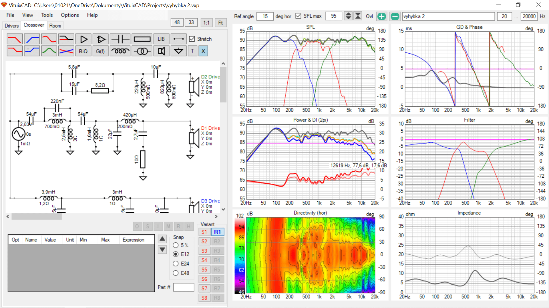

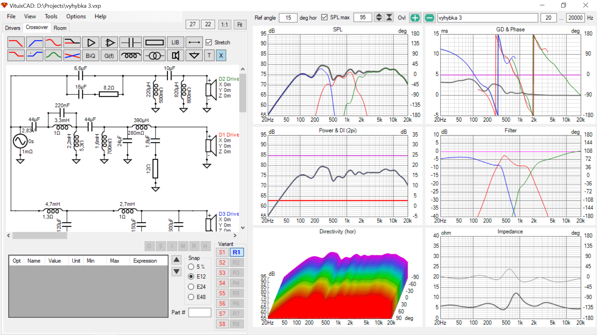

thanks for reply. For me, practical implementation is what really matters. My observation is, that it is beneficial to have 2 woofers and maybe 4 woofers will be beneficial - aim is to control directivity in problematic region. Also, crossover works better with higher order filters. From directivity point of view, mids region is the problematic one - directivity is too wide. My idea was to compensate it it by pushing that region little bit down on axis. Will see, how well it works - parts for CO are already ordered.
Check simulations below - there is horizontal simulation (like 1,6m from speaker) and on axis at MLP (like 4m). Both measurements were done in the final position (onwall). I did not measure verticals, but my idea is, that in vertical plane, woofers will play with very wide directivity and compensate the drop of the power response in the 200-450Hz region.
My design use little bit different onwall speaker approach - usually it is beneficial to make as shallow bafle as posiible and problems in 600Hz+ region solve by absorption. This was not possible in my scenario - speakers are hidden in the bookshalve with 400mm depth. So I am trying to adress SBIR problems with multiple speakers playing all (woofers + mid) in the problematic region (200-400Hz) and counting with the floor bounce (speakers are low)

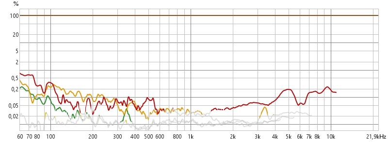

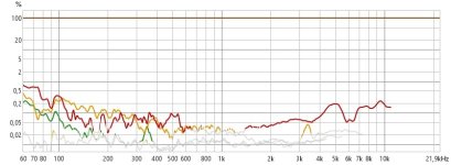

So crossover is done and I have some first impressions.
  • fantastic concert like dynamics
  • sound is bright (metal sounds, female voices...), too forward (sounds clean, but like this kind of sounds is louder, then others)
Any ideas what to focus on? Distortion profile is clear, so is burst decay. Shoud I tilt down fr. response more?

Our perception of high frequency level is significantly influenced by beam width and the level of high frequency absorption in the room. Some rooms have soft furnishing, thick curtains, thick carpets,... leading to large amounts of high frequency absorption and speakers with a wider beamwidth tending to sound better balanced. The same speakers in a room with wooden floors, leather furniture, blinds instead of curtains,... is likely to be perceived as having high frequencies at too high a level and a mild downward slope of the on-axis response preferably. Alternatively a speaker with a strongly narrowing high frequency will sound better balanced in a hard room and a bit dull in a soft room.
