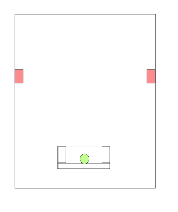

One of the absolute best reproduction I have heard comes from a system where the speakers where "on wall" but placed not on the walls in front of you but in the side walls. These where Beweridge SW2.

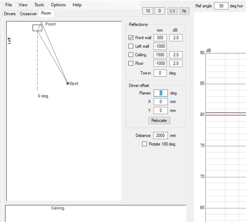

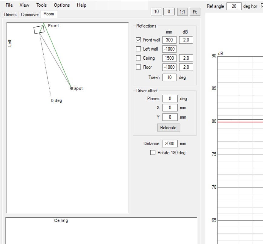

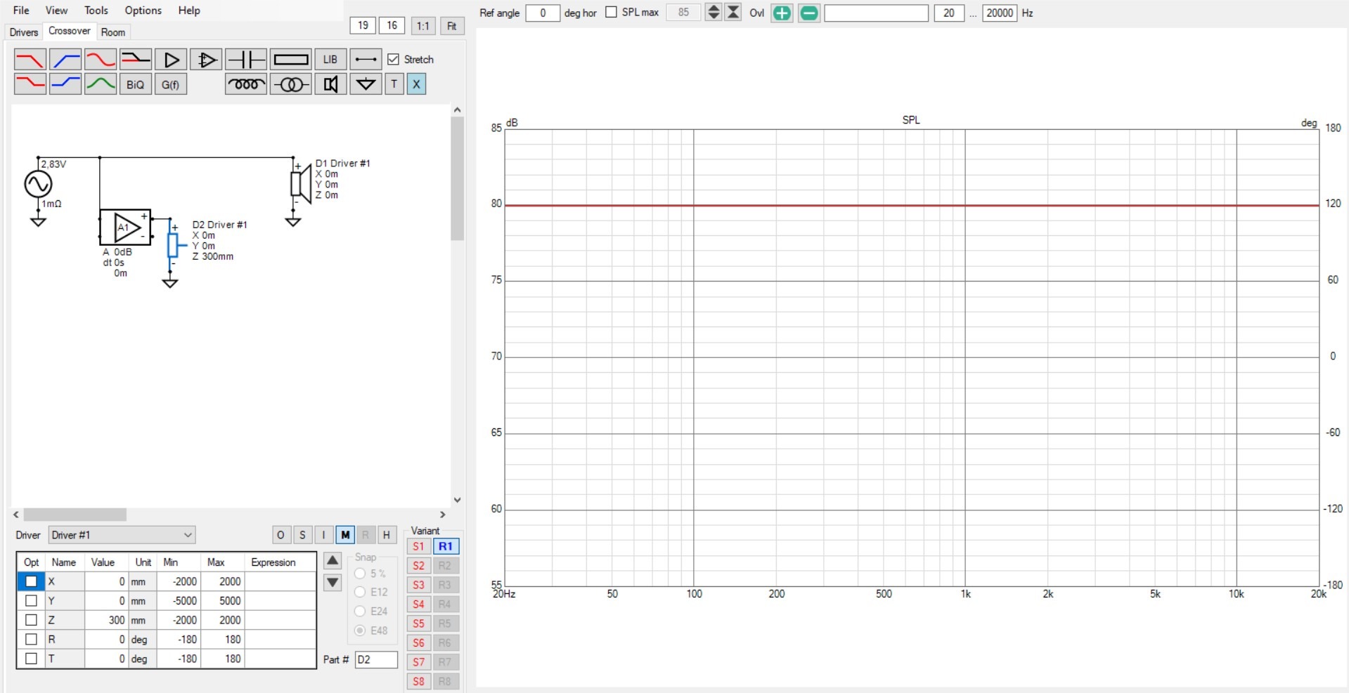

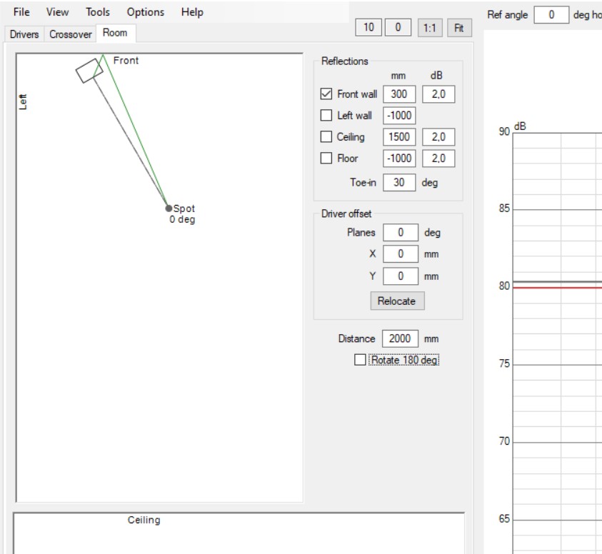

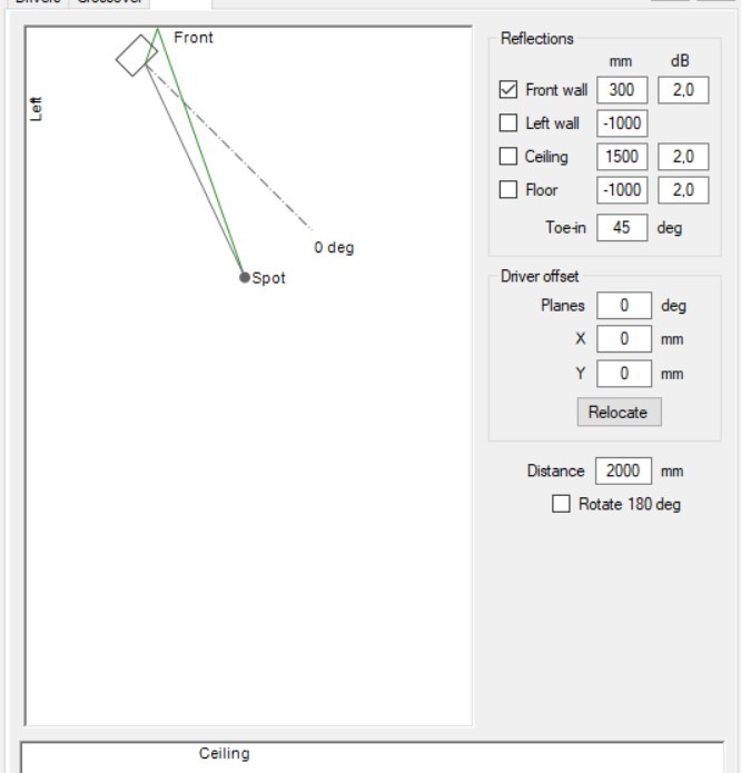

First 4 attachments are speaker toe in from 0 to 45 in relation to front wall first reflection point to the listening spot with 60-60-60 stereo listening triangle. From the attachments we see the line to first reflection point is roughly ~160-90 degrees, depending on the toe in, depth of the speaker and listening distance and what not. These angles we want to manage one way or another, simplified it is the back quadrant we need the attenuation for reduce the reflection. And it looks like something like ~130 degrees would be perhaps on the middle of this range, so lets use that in the example.

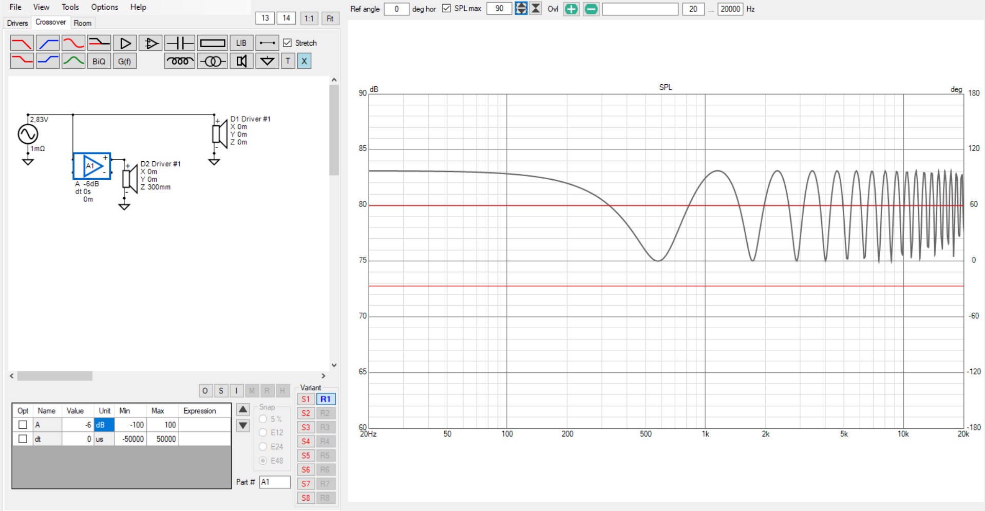

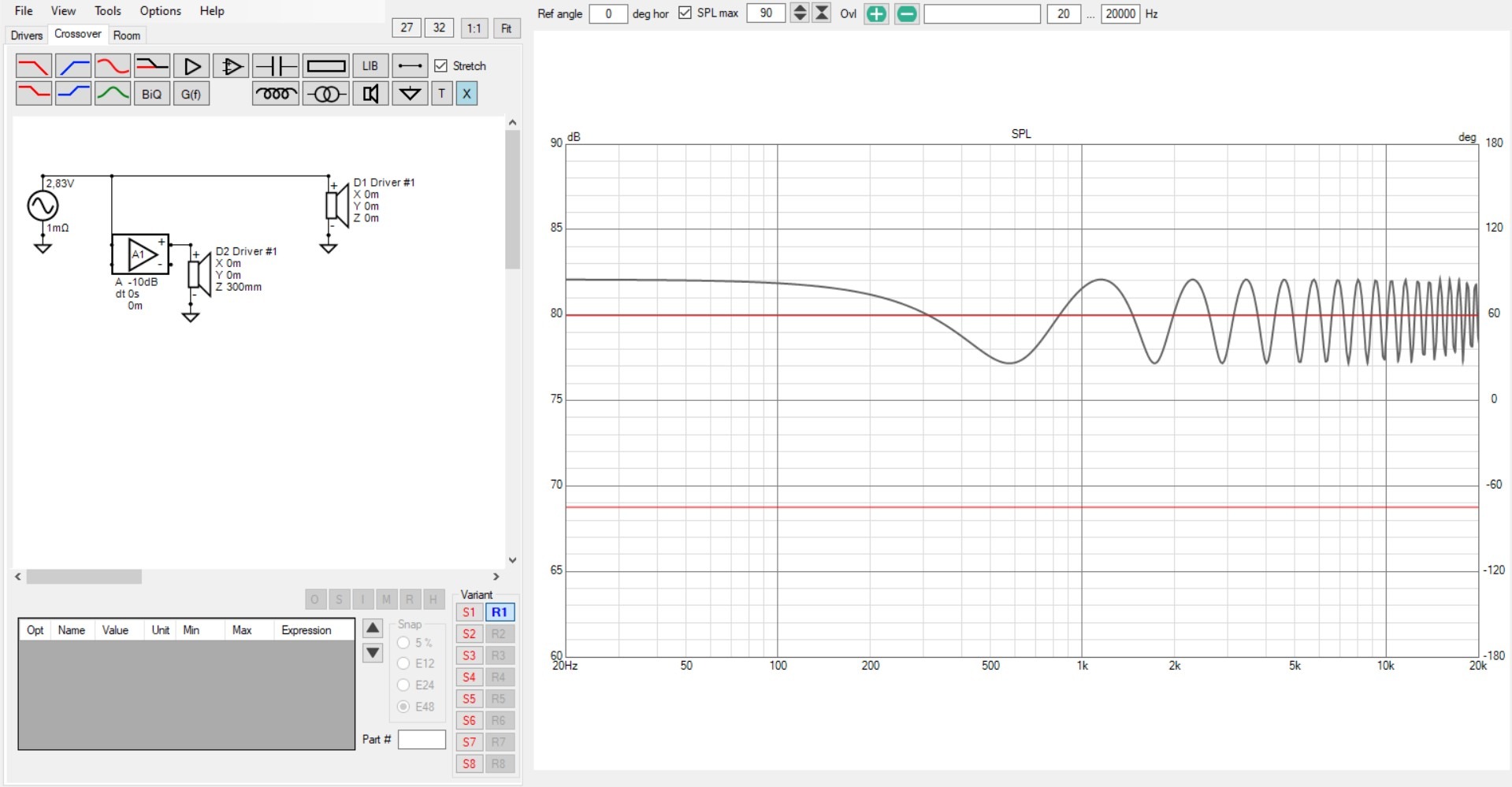

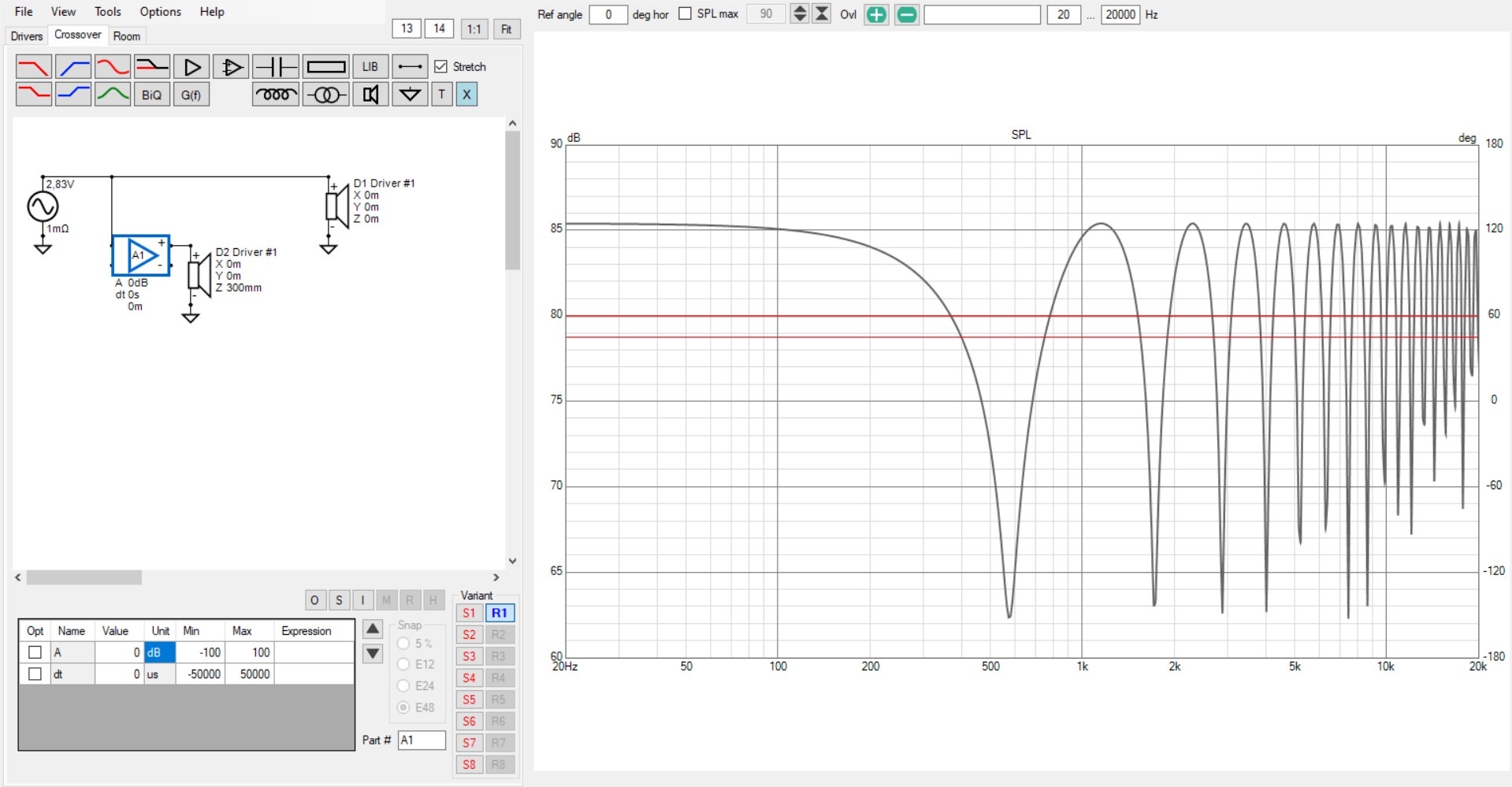

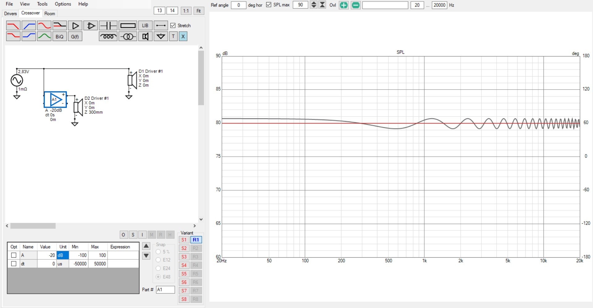

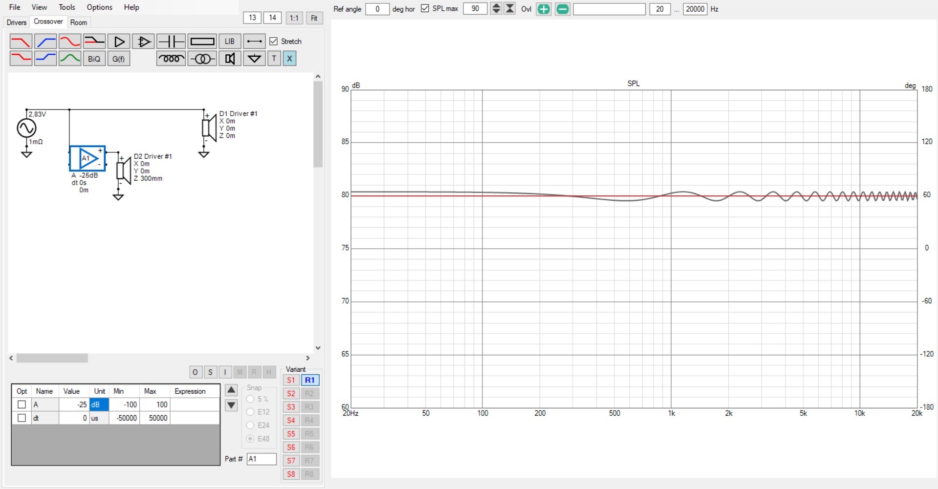

How much to reduce sound from the reflection? Why? The reflection from the front wall will superimpose to direct sound at listening spot. Next attachments are a simple test how much attenuation for the secondary sound source is required to reduce the interference pattern that emerges when the two sounds combine.
One could get more accurate graphs with BEM but is there more info gained so that we can estimate what kind of system structure would provide sufficient attenuation at any particular frequency to the front wall? Yes and no. Because, as it looks like we have to attenuate the reflection ~20db to get the interference below +-1dB. Anything less attenuation and the interference gets bigger. Without any attenuation at all there is ~6db of constructive interference and perhaps similar amount or more of destructive interference in reality, so roughly +-6db.
For nice sound I've seen on the internet that something like +-1 db target for loudspeaker measured response is considered very good, many can't do +-3dB. If we reflect to this we would likely want to have as much attenuation to front wall as we possibly can for the bandwidth that suffers the destructive interference, eg. wavelenghts shorter than distance from the source to wall, to have as good sound as possible.

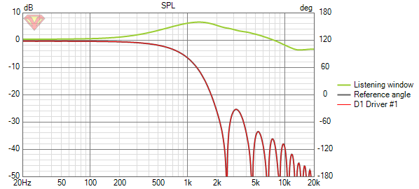

If you look at what the wavelengths are, on the simple tests 30cm distance from wall the interference happens > 400Hz. From this we can now reason it is not possible to use waveguide alone, since sufficient pattern control down to 400Hz would make very big device. Last attachment is measurements of my ~20cm square waveguide with 90 degrees nominal pattern. From this it looks like ~20db attenuation is achieved to angles past 90 degrees so this would be enough, but it is only roughly above 2kHz where the waveguide still has proper control of the sound. Can't extend the pattern control down to 400Hz without greatly increasing the size of the device and thus distance from the wall which in turn would mean the interference to start even lower in frequency and we'd be chasing our own tail. Reasoning from this we need physically small device that can do attenuation to back quadrant and this is the cardioidish variety. Cardioidish from the frequency up that depends on distance to front wall. Cardioidish can do 2 octaves with ease, 3 with reduced SPL capability so it has to be waveguide above that, or another cardioid.
It is just matter of doing as good cardioidish design with max attenuation to Design angle (towards reflection point) to achieve least interference due to the front wall. You could use BEM to come into same or similar concept, to find out what kind of system works near wall for minimal effect / interference to overall sound 😀 I'm not sure if we need more info than this? to be able to select suitable options for over all concept? If you can think of some other concept then you could model it and verify by BEM, but I'm not sure what that would be? Peace

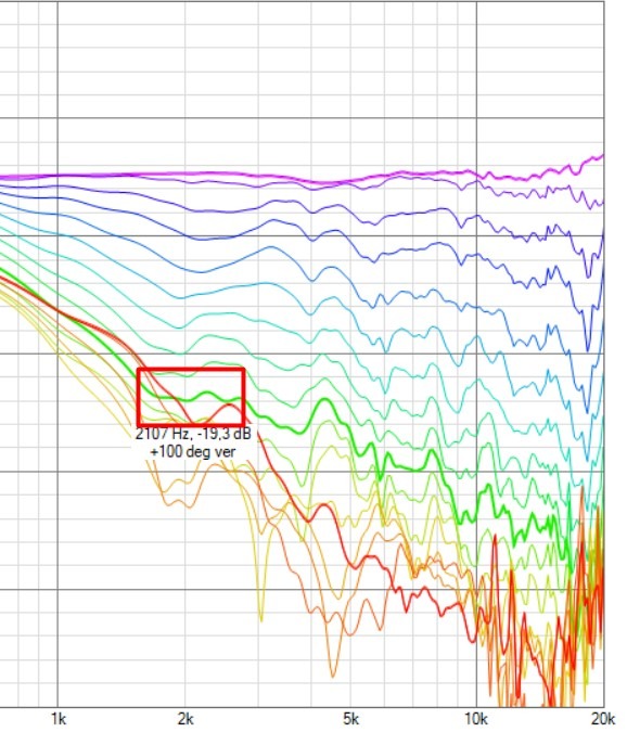

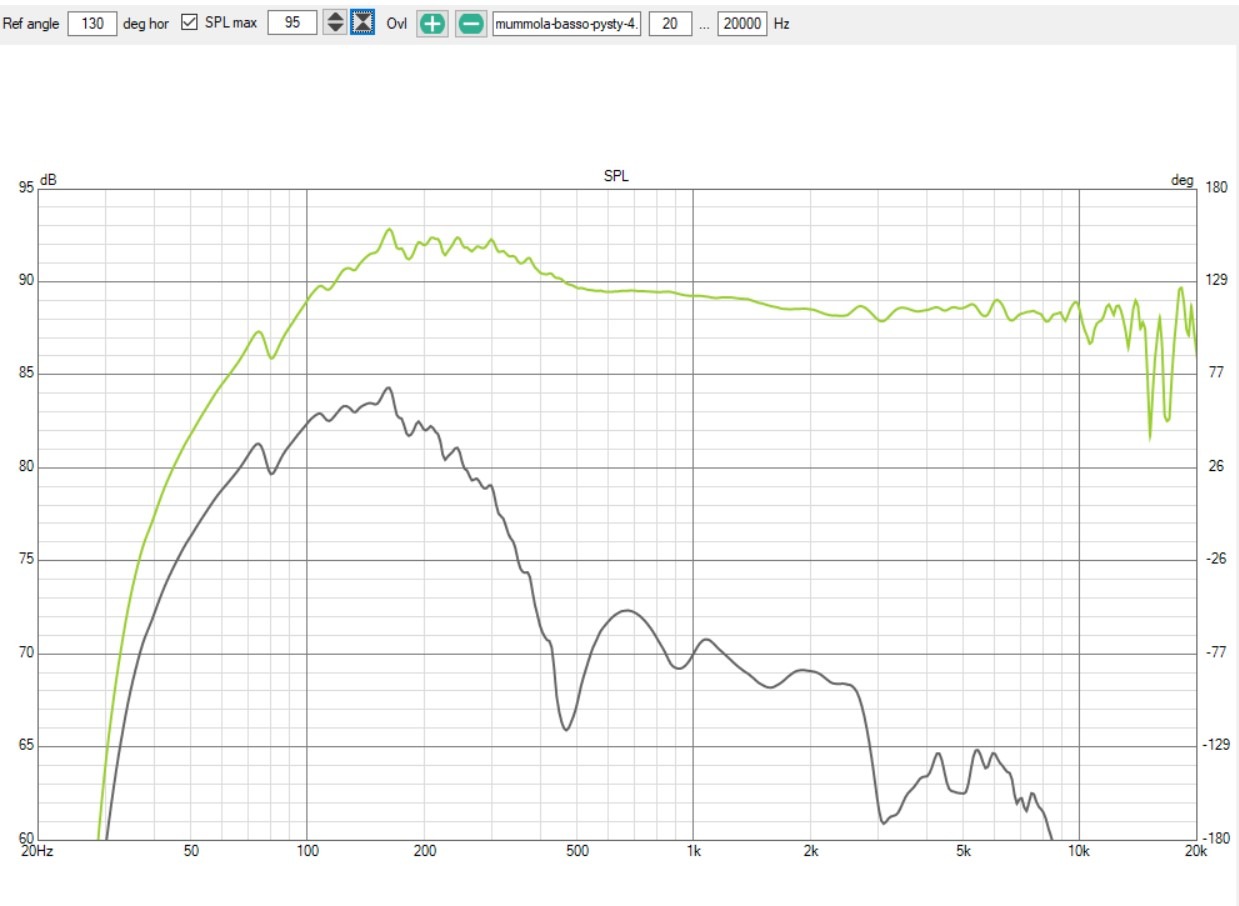

Here is simulation from measurements showing frequency response to 130 degrees and listening window. Sound to the front wall is roughly ~15db or more down in comparison to direct sound. This is 20cm waveguide, 8" cardioidish mid, flat bass. I'm not sure why the bass is attenuated here, it is wide baffle though and full space simulation. Anyway, it looks like the cardioid + waveguide can have -10db or more attenuation to front wall, which would make the interference at listening spot +-3db or less.

@tmuikku, do you see how the reflection is drawn through the middle of the cabinet from the driver..
VC makes a good guiding tool for speaker placement. You get these results from traditional techniques.
However there is a frequency dependent diffraction component which needs to be considered for an on-wall design, which VituixCad is not suited for.
Yes, hence estimate off 90-160 degrees of axis depending how the system is implemented, where the reflection happens. Reflection angle can be found out more specifically, but the system could be adjustable and thus change. Hence back quadrant. Diffraction we would like to minimize anyway, that is just part of any loudspeaker design in my opinion. Unless maximum sound quality is not the most important objective. Attached is ideal 8" driver on a very smallest possible baffle, showing response to 130 degrees and the listening window. As you see there is only frequencies that are relatively long to the baffle size, the ones that you see with bafflestep, to the 130 degrees and anything above is just beaming and making interference. And you would not want to crossover any higher in any case, in any conventional speaker design close to wall or not. So I don't see what you mean with frequency dependent diffraction component being somehow different here? Do you mean if there was sufficiently small transducers so that the construct would be very close to the wall, like within few centimeters instead of tens centimeters?
Anyway, I found it rather hard to steer max attenuation of cardioidish to the 130 degree territory. Cardioid is the easiest (max attenuation ~180 degrees), hyper and super cardioidish more difficult but not impossible. I'm not ruling out other solutions, I just haven't been able to figure out what those might be given the premise we have some kind of physical object close to wall, not inside the wall, while considering diffraction and polars and what not, basics of good loudspeaker.
