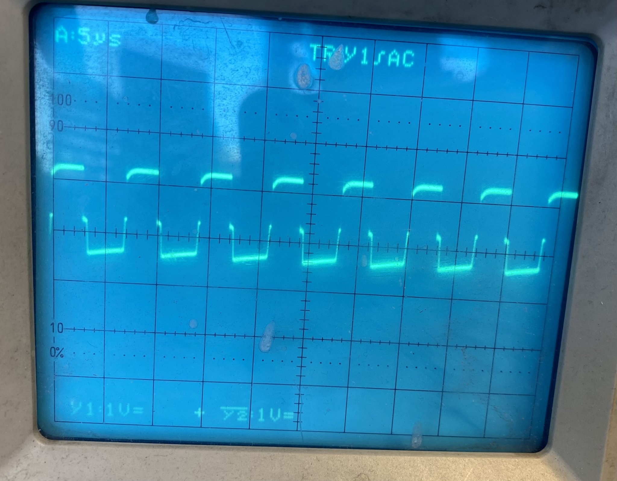

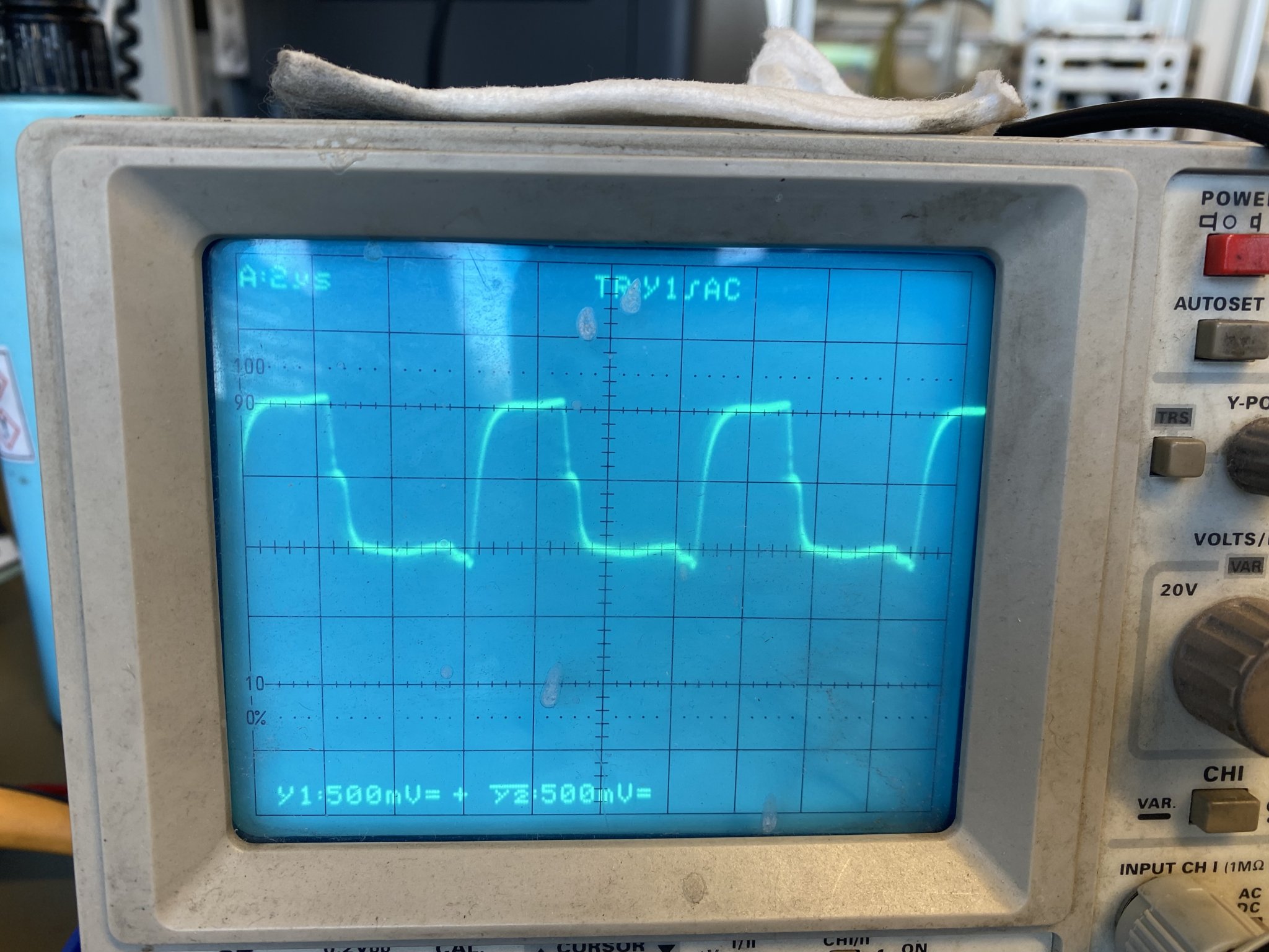

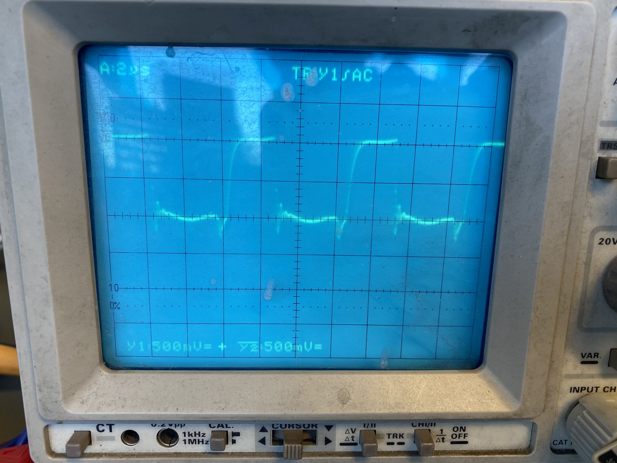

Does the scope have an isolated ground for one or more inputs? I've never seen that on a mains powered scope.
It has a common ground.
With the digital scope to measure correctly the oscilloscope wants/needs a groundconnection to the source, to measure correctly in the base set up for pseudo differential measuring.

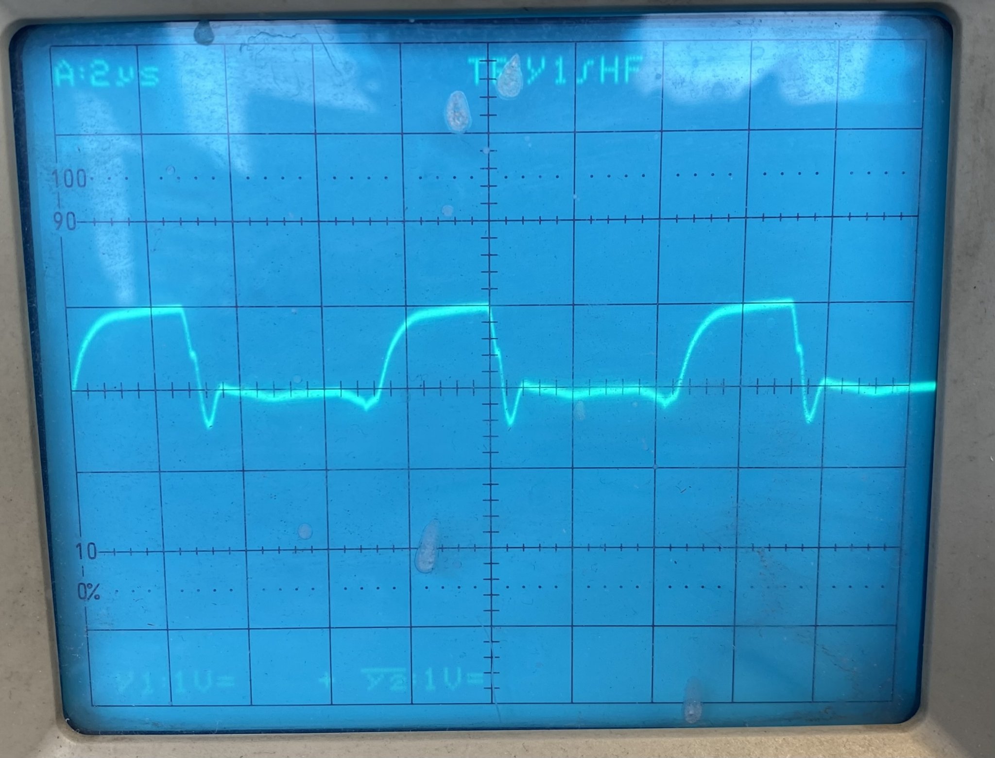

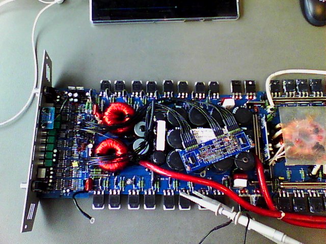

Up and down with the 12V source and no jump with both leads connected to +.
I measured the high side again, with the probes switched.
i noticed that the probe didn´t make good contact in the channel 1 connector (didn´t switch to 10:1 setting auto)
The First Pic is the low side
The second pic is the high side now

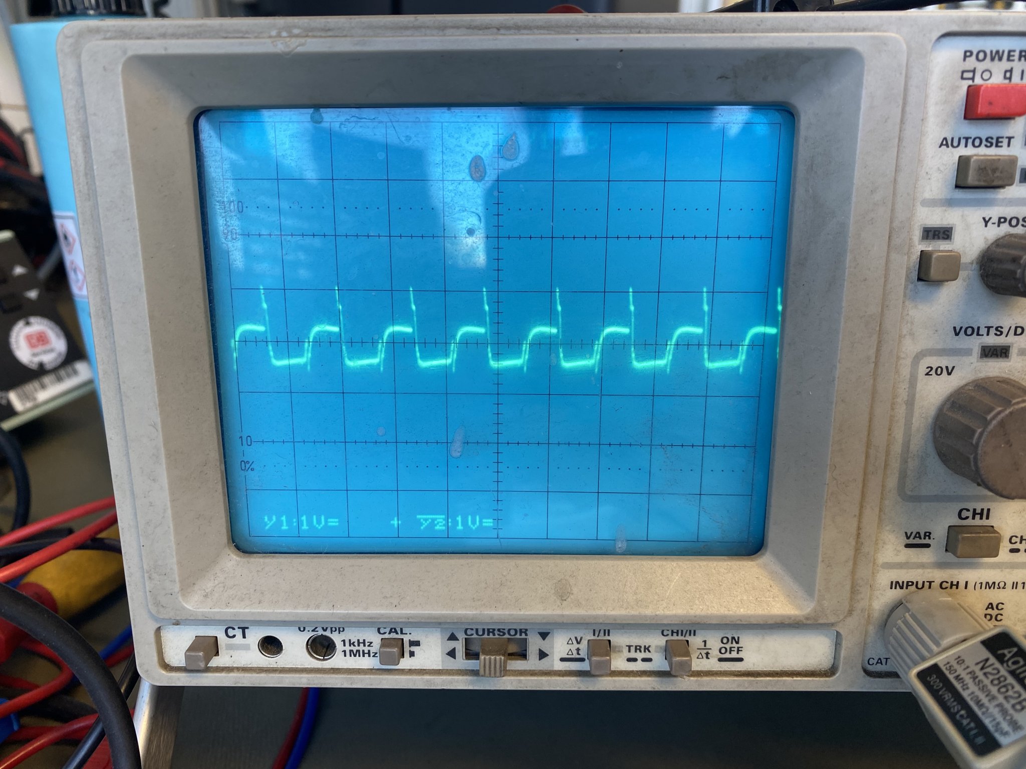

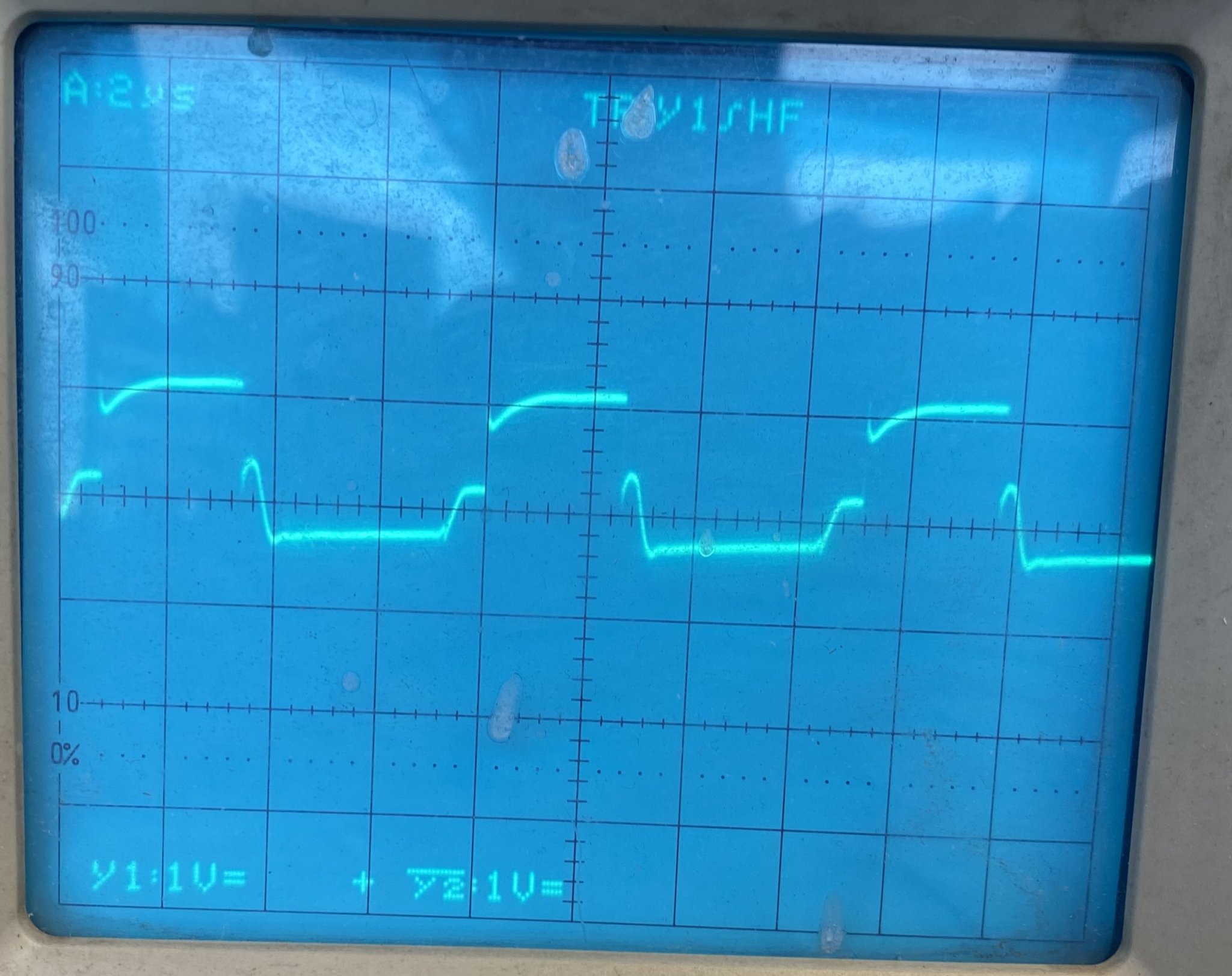

The low-side is correct. The high-side shouldn't be going below the reference. The waveform in post #35 is mostly right but the falling side of the waveform should fall farther before the notch.
Are the FETs you're using the factory original part number?

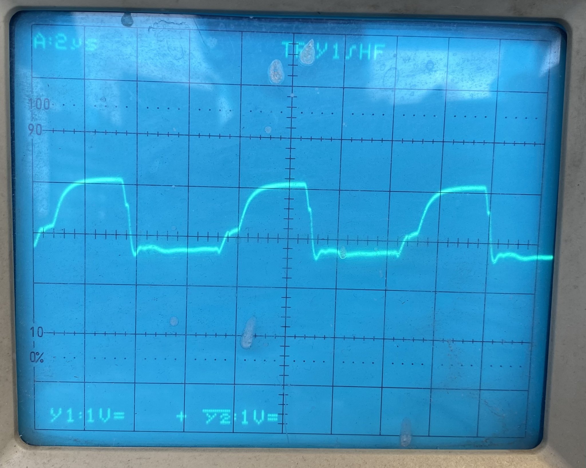

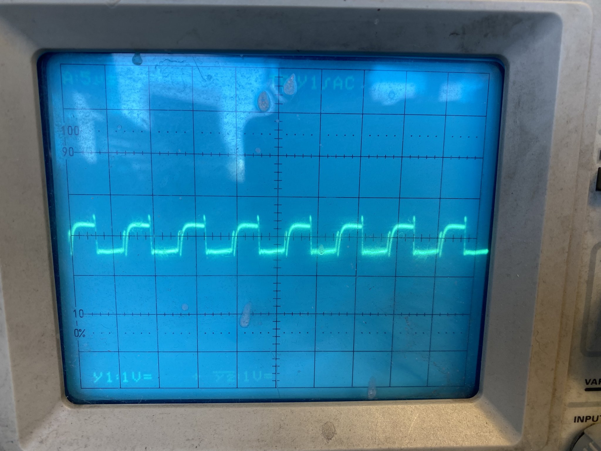

What could cause the driver to give out that signal, the outputs should be symmetrical in amplitude?
The poor high-side signal could be due to a bad driver or the wrong FETs but Mouser is a reliable distributor.
Are the gate resistors within tolerance?
Post #46: Was this at the output of the driver IC or was it at the output transistor?
Post #46 was measured directly at the driver outputs.

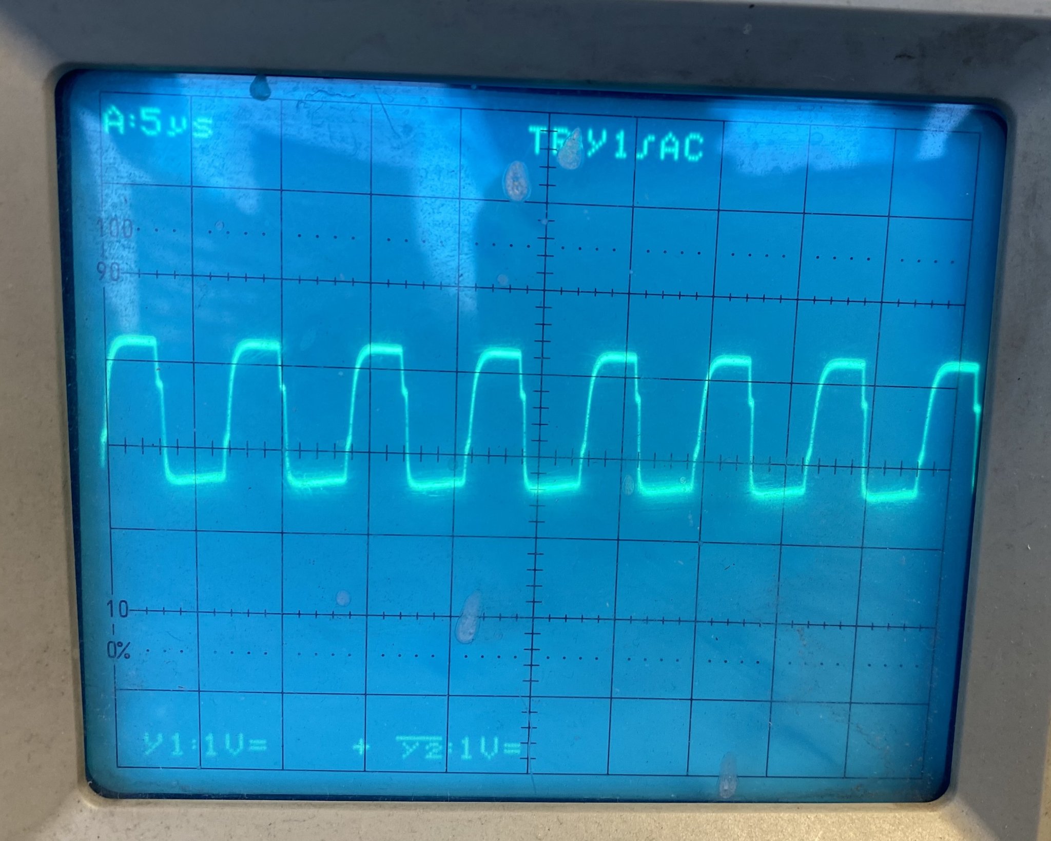

Looking at all of the waveforms and cherry picking them, I think the deadtime may be the problem. Before I'd make any modifications, I'd suggest installing all of the outputs for one driver IC and comparing the heating to the other two (incomplete) banks of FETs.

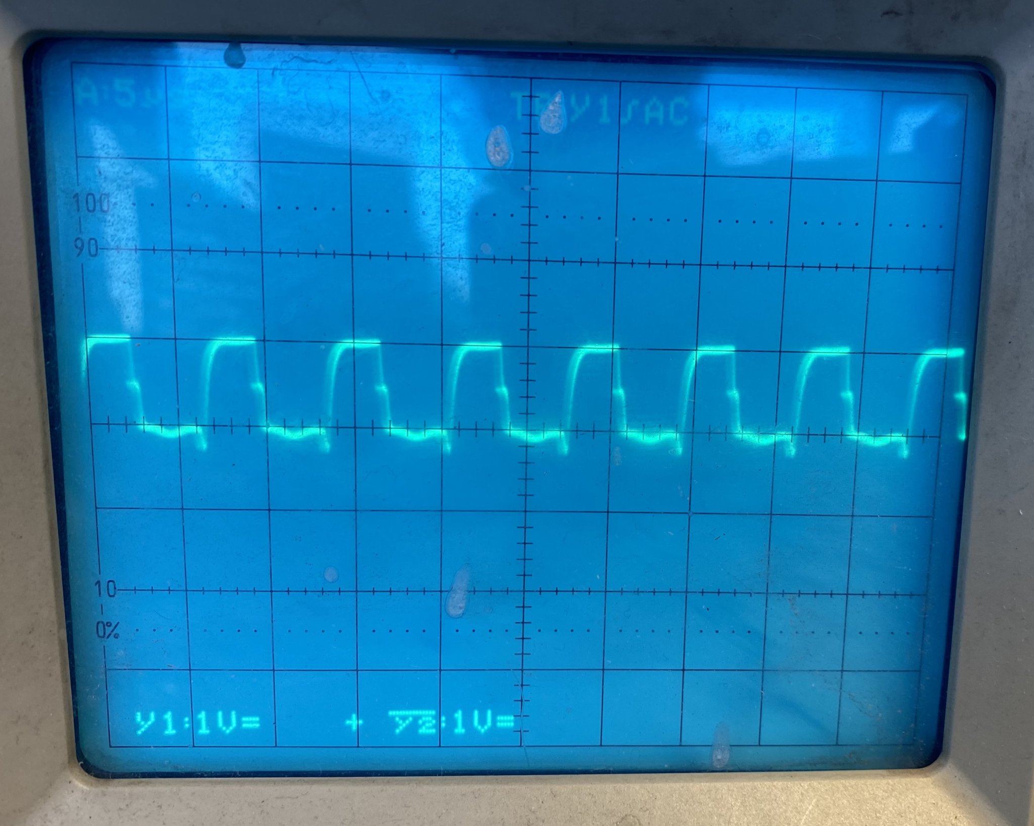

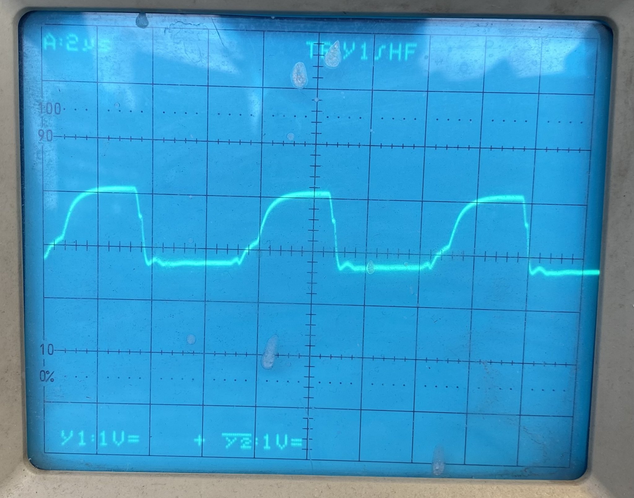

With ultra fast diodes over the gate resistors the GS-waveform look like this.
This reduces the turn off spike, and the turn off flank.
The fets get less hot.

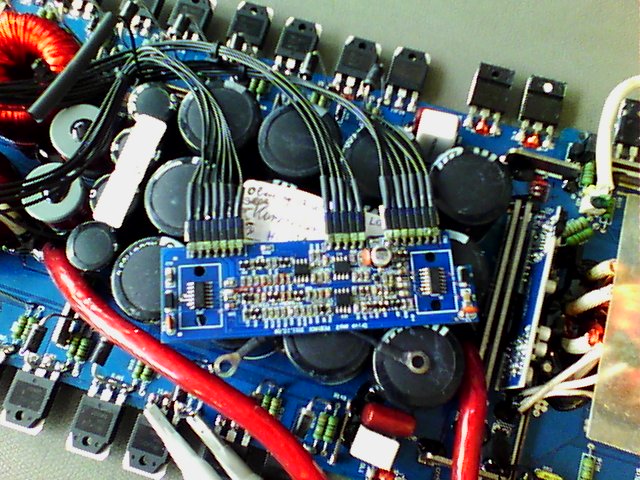

Drive

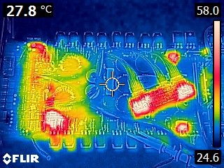

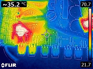

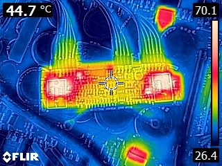

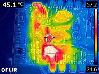

with diodes the driver get´s less hot, but still both get to hot to touch.

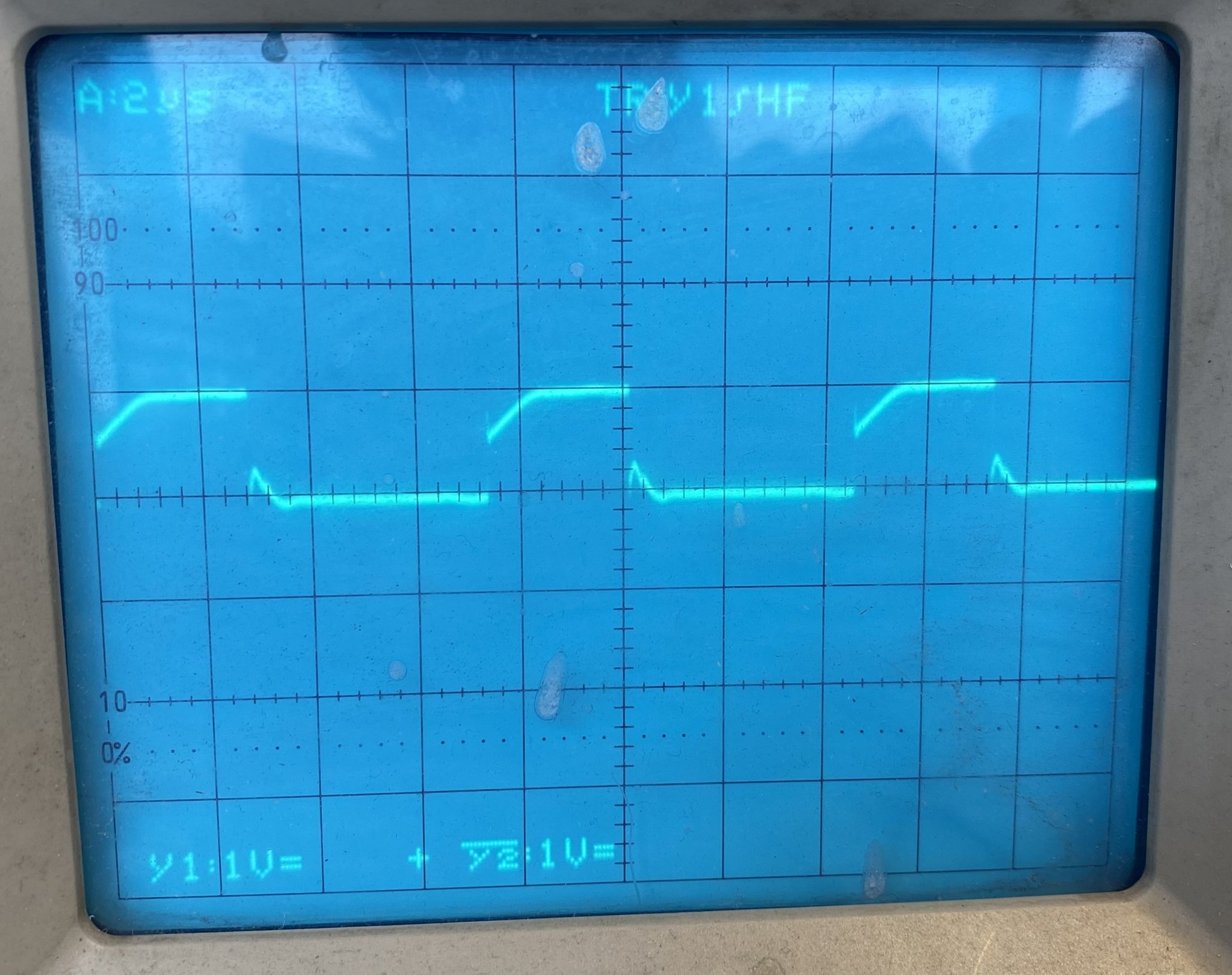

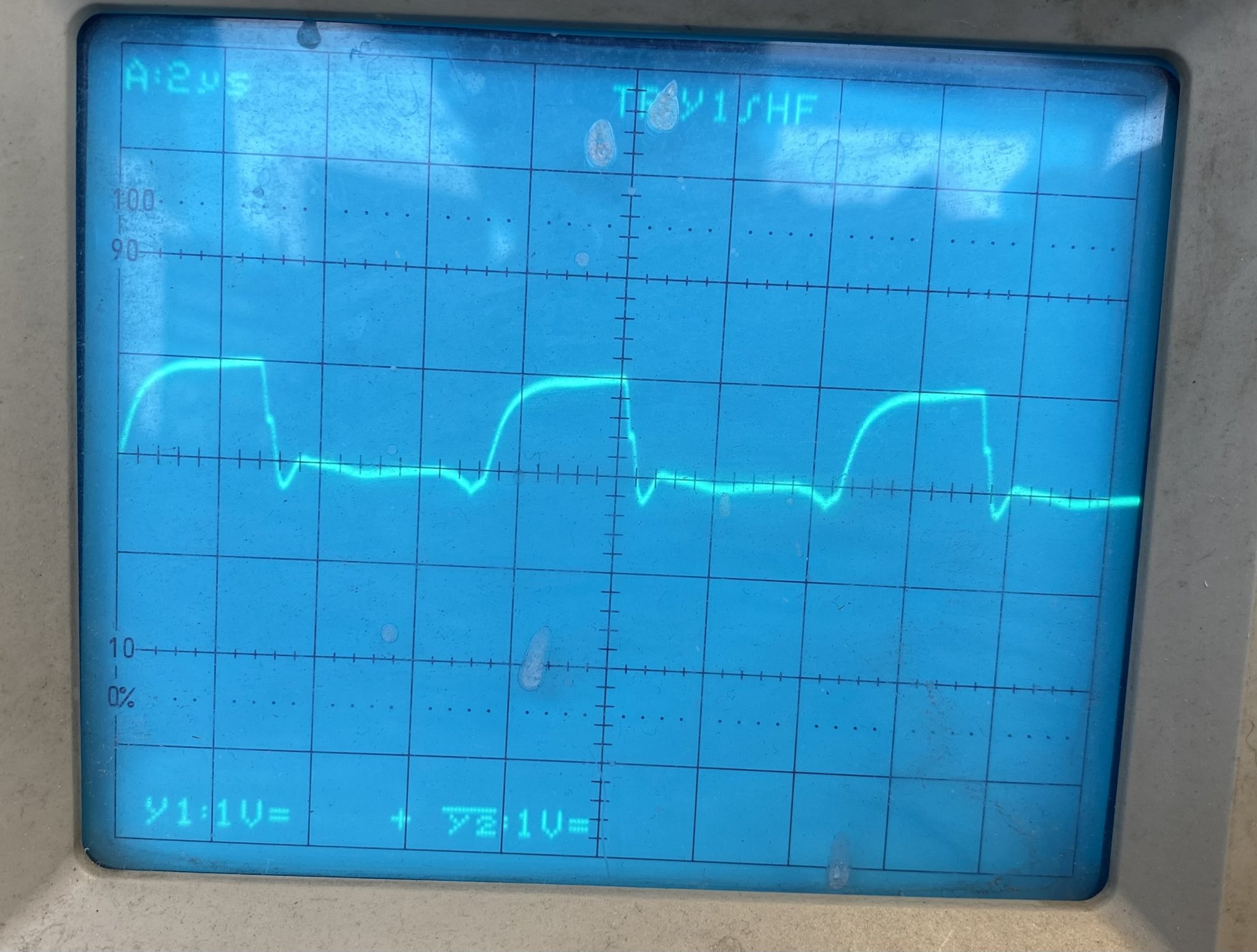

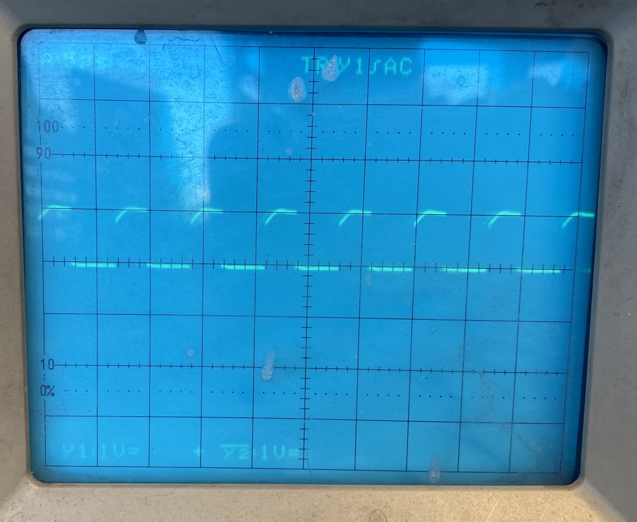

Picture 3 is High Side directly at the driver and Picture 5 is low-side.
The output fet´s don´t get hot, but the bottom left side fet is getting hotter than the others.
I desoldered the Turn On and Turn Off resistors, they all show 33R2 and 99,8kOhm at this row.

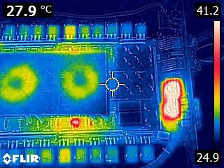

If only one FET is heating more than others, swap its position with one that's in parallel with it to see if the heating follows the transistor.

cherry picking my last scope-photos again does it seems better that way with the dead time?
The fact that the outputs are running cool means things are OK. The drive signals look better. It's hard to believe that the driver driving the FETs with diodes is running cooler. The lack of a resistor between the gate and the drive is tough on a driver.

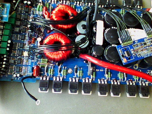

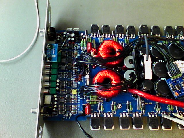

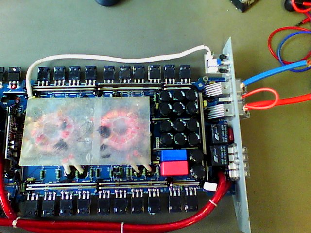

The board has holes for a heatsink. If you don't have a heatsink, you might want to make a heatsink from a piece of aluminum or copper stock to install on the driver ICs.
