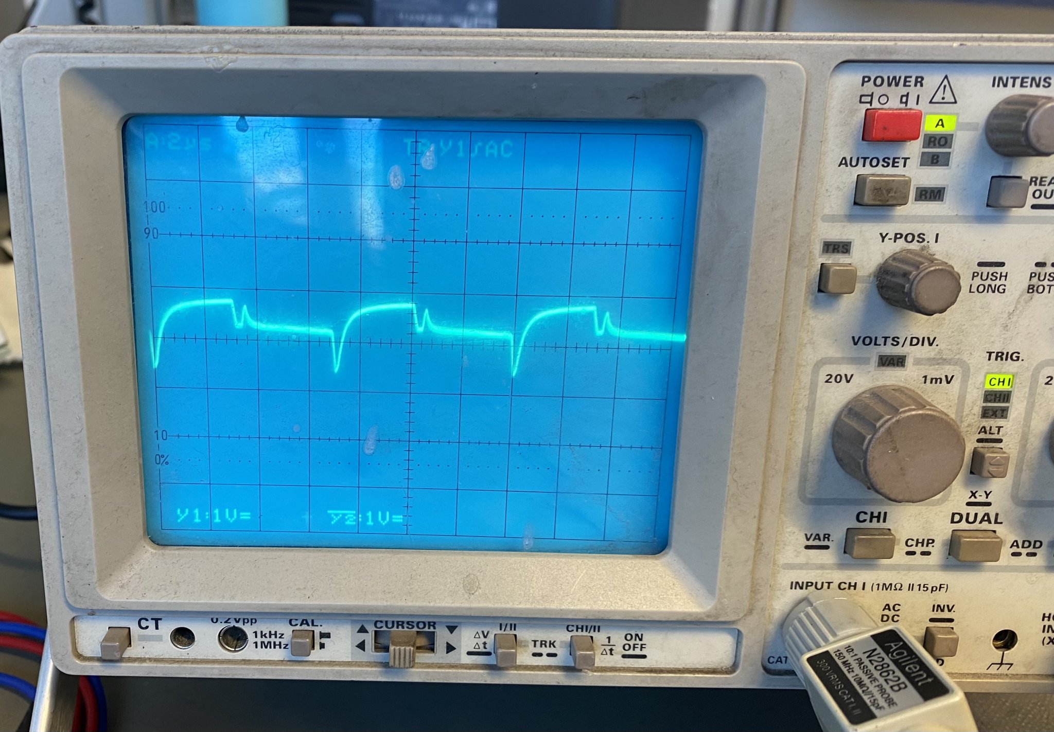

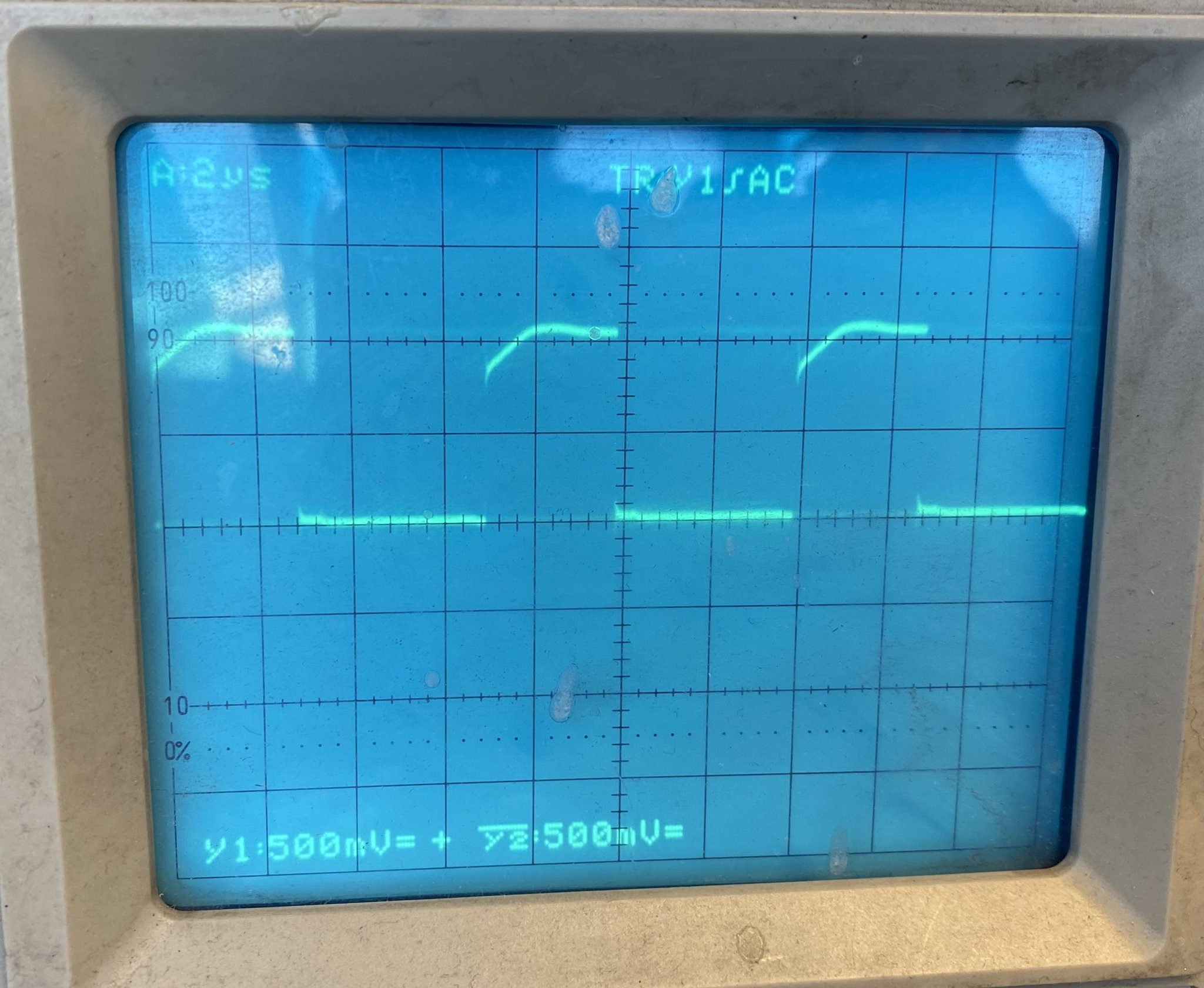

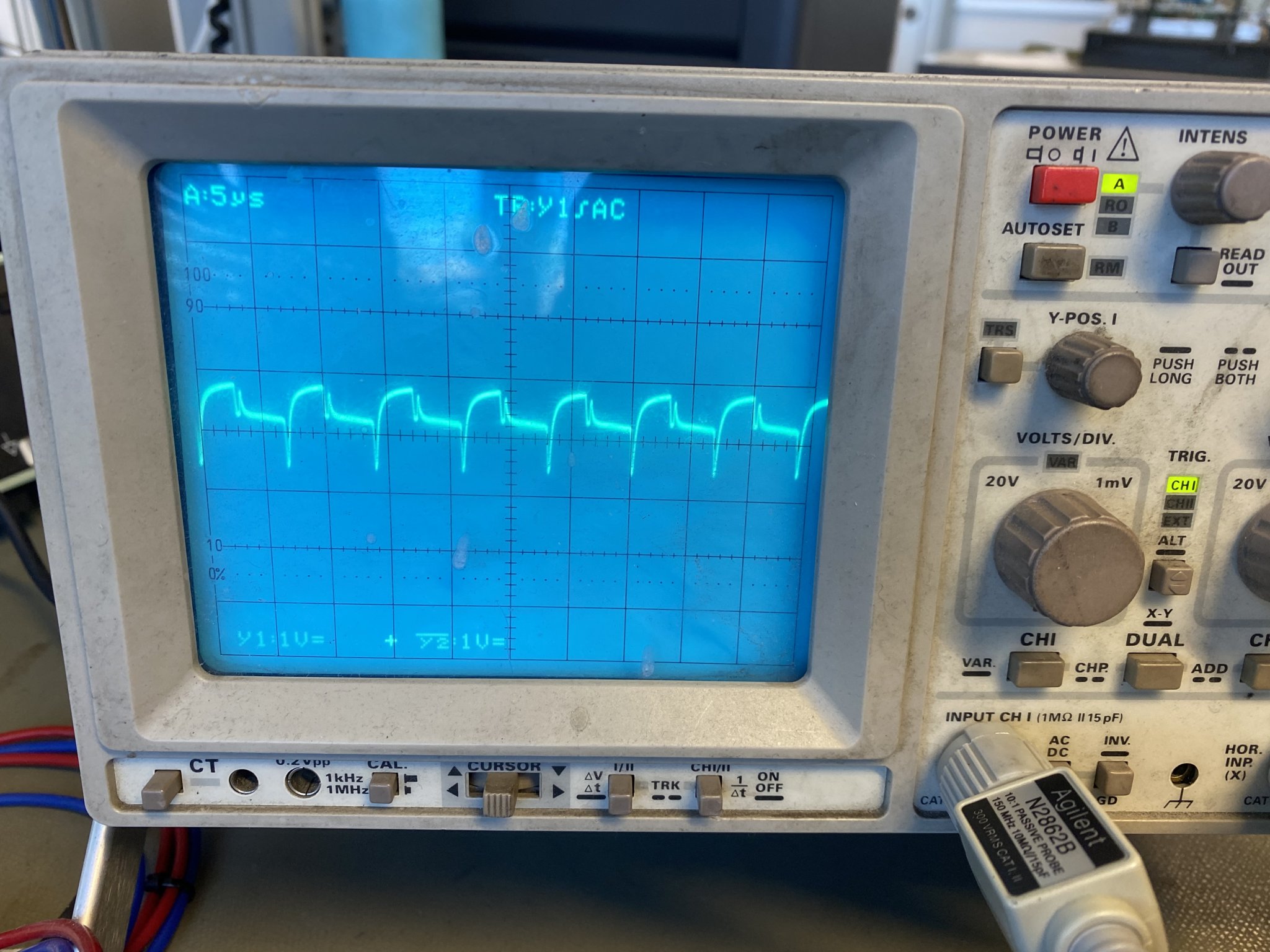

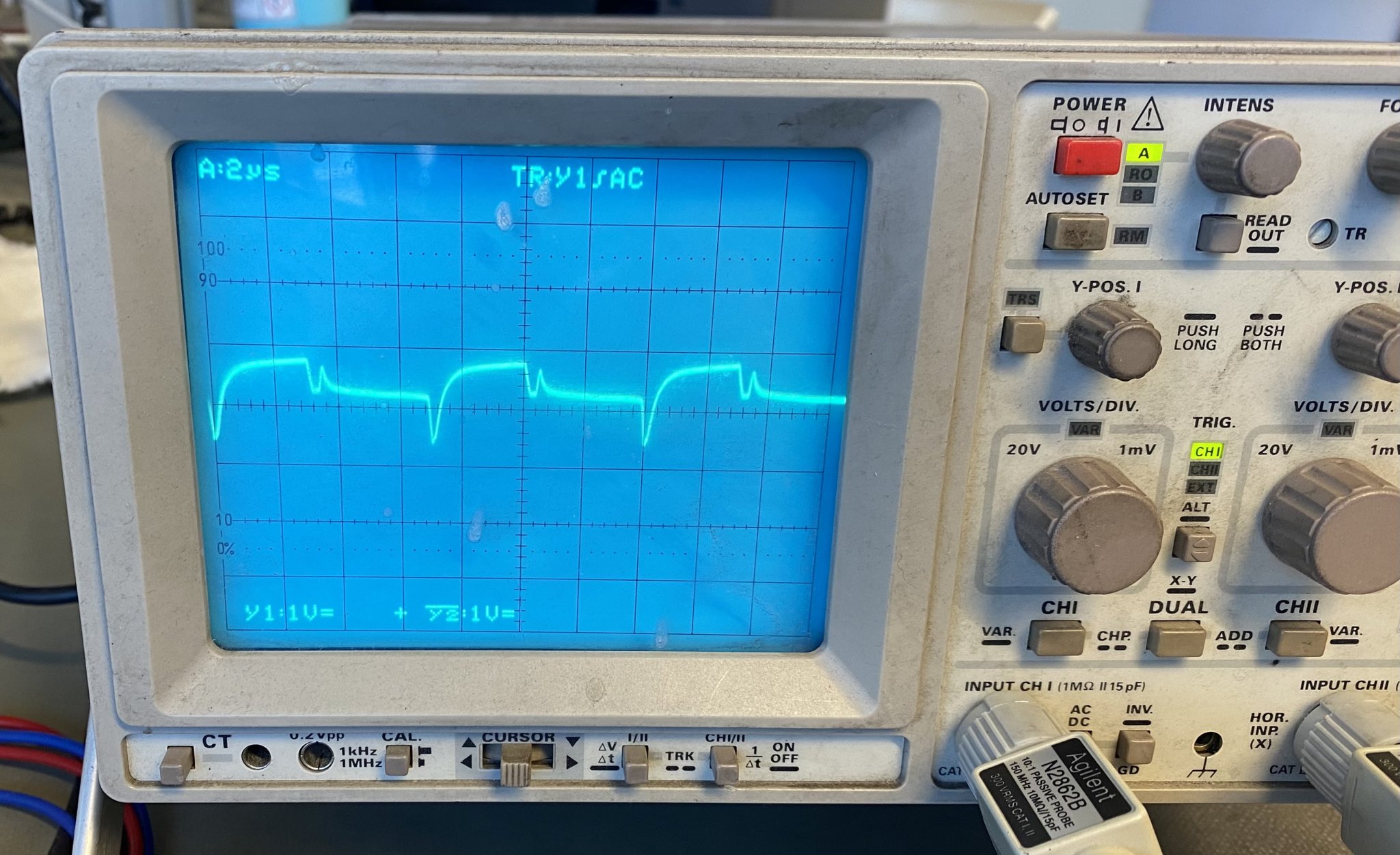

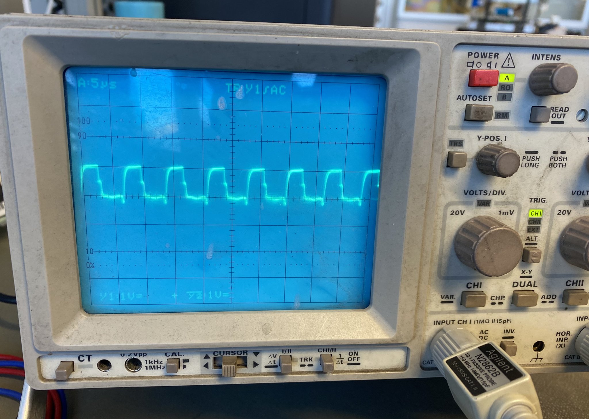

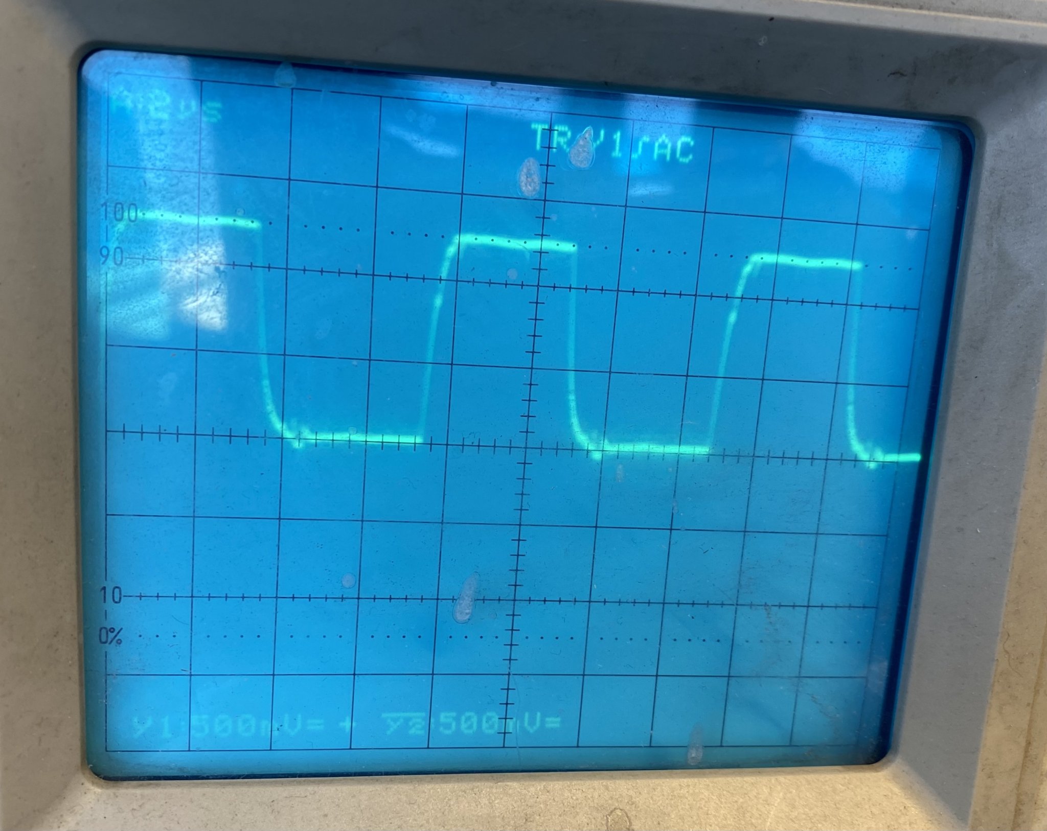

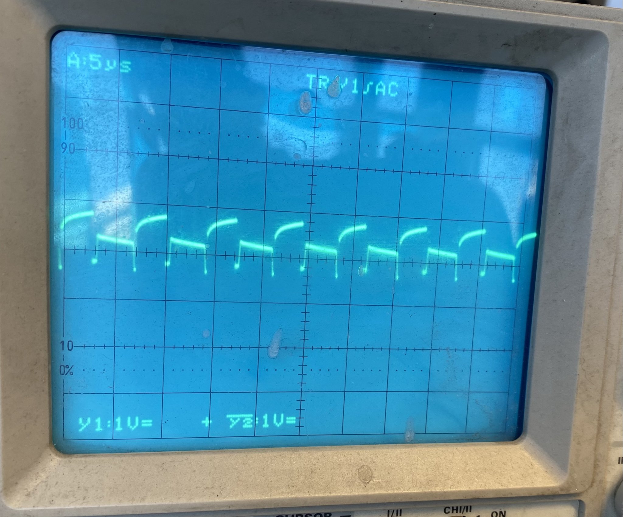

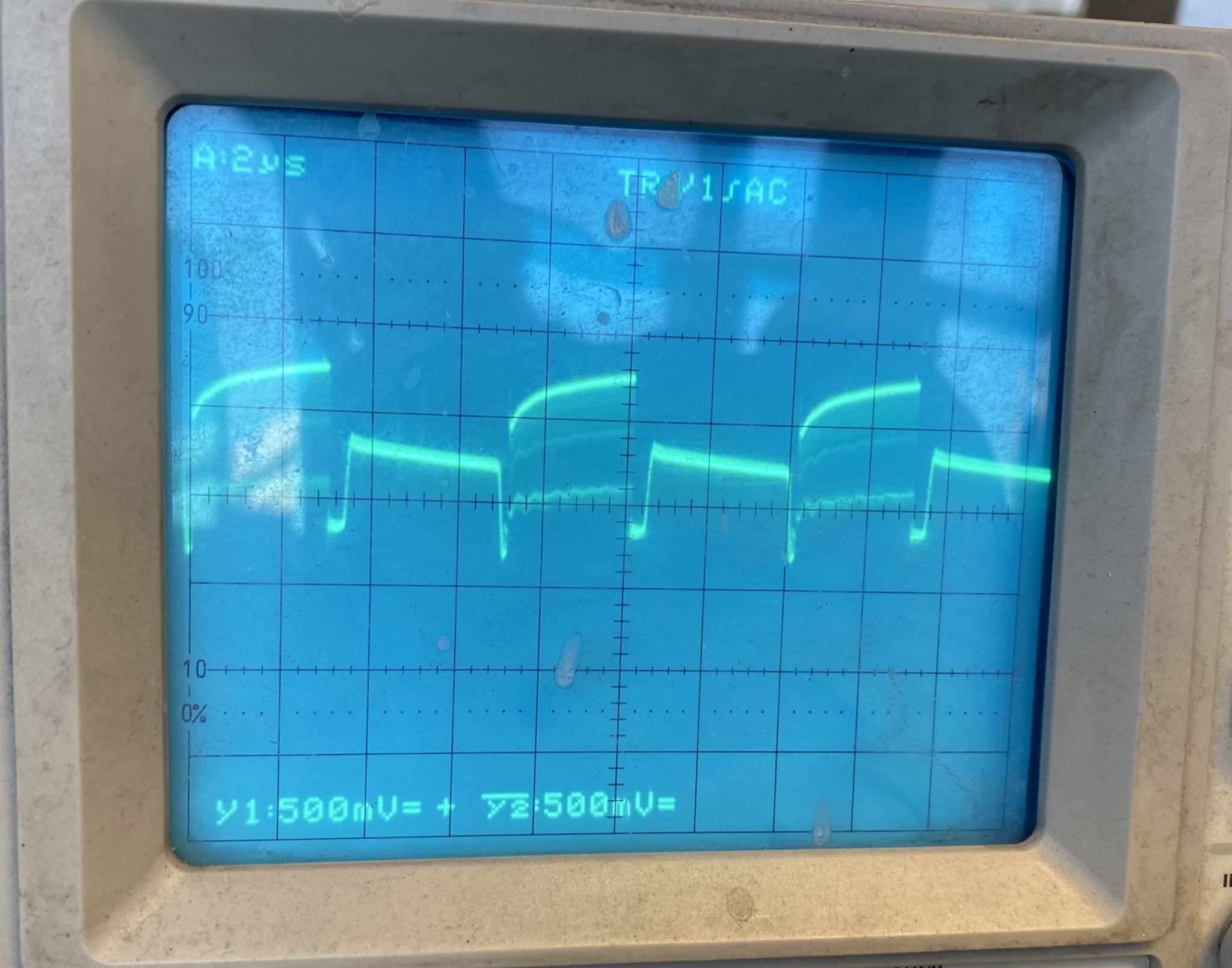

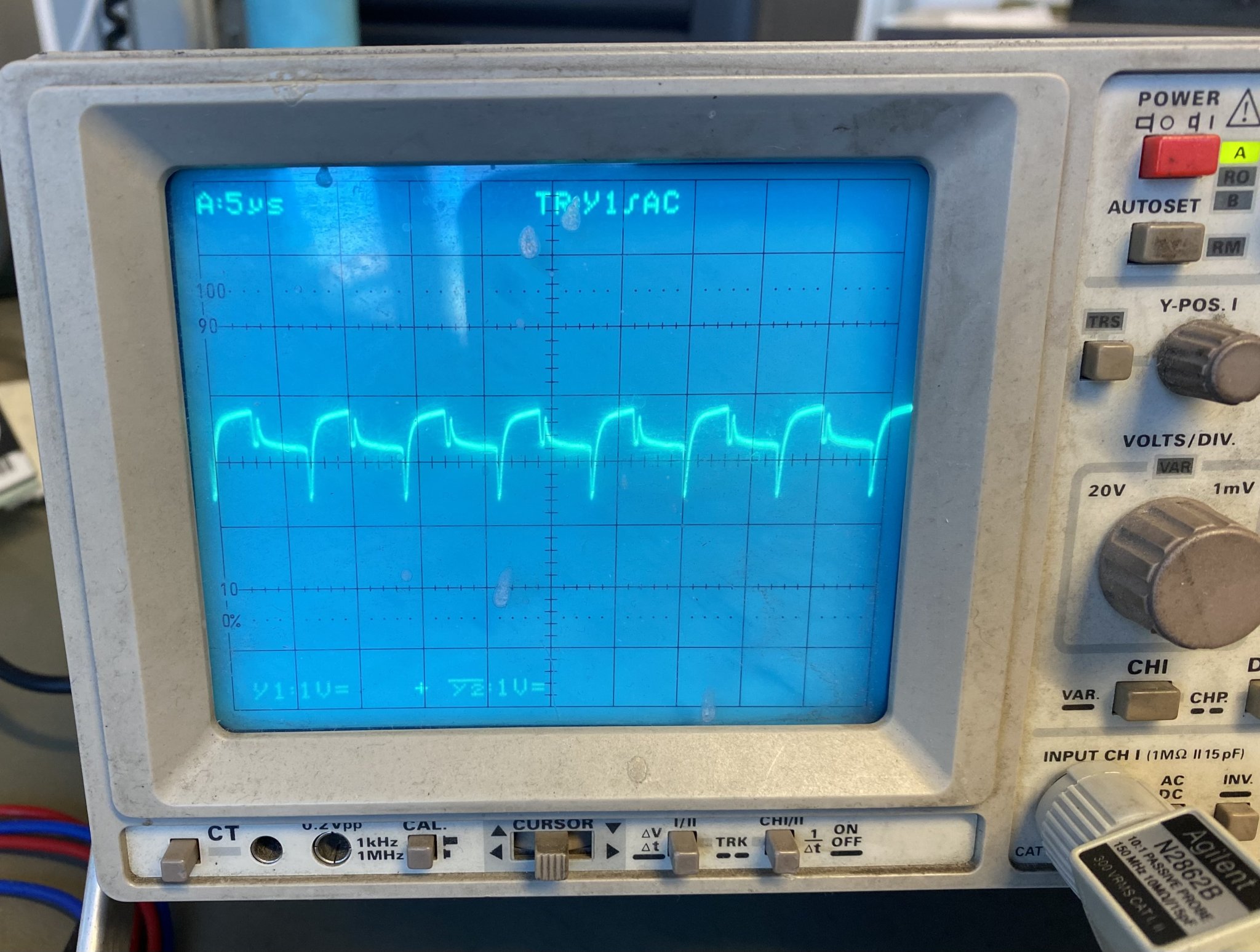

The amp made a clean output, but it breaks down before the rated power.

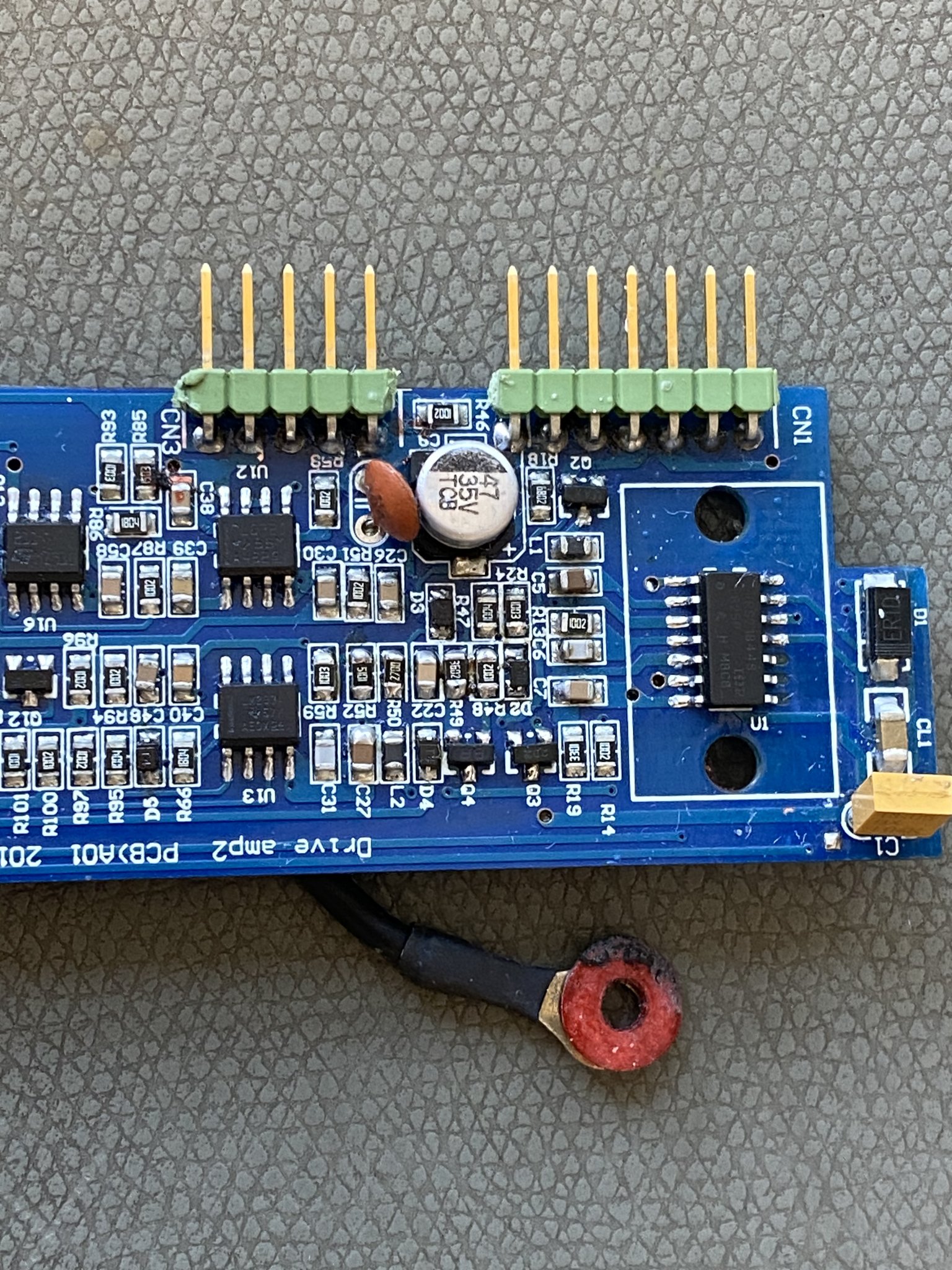

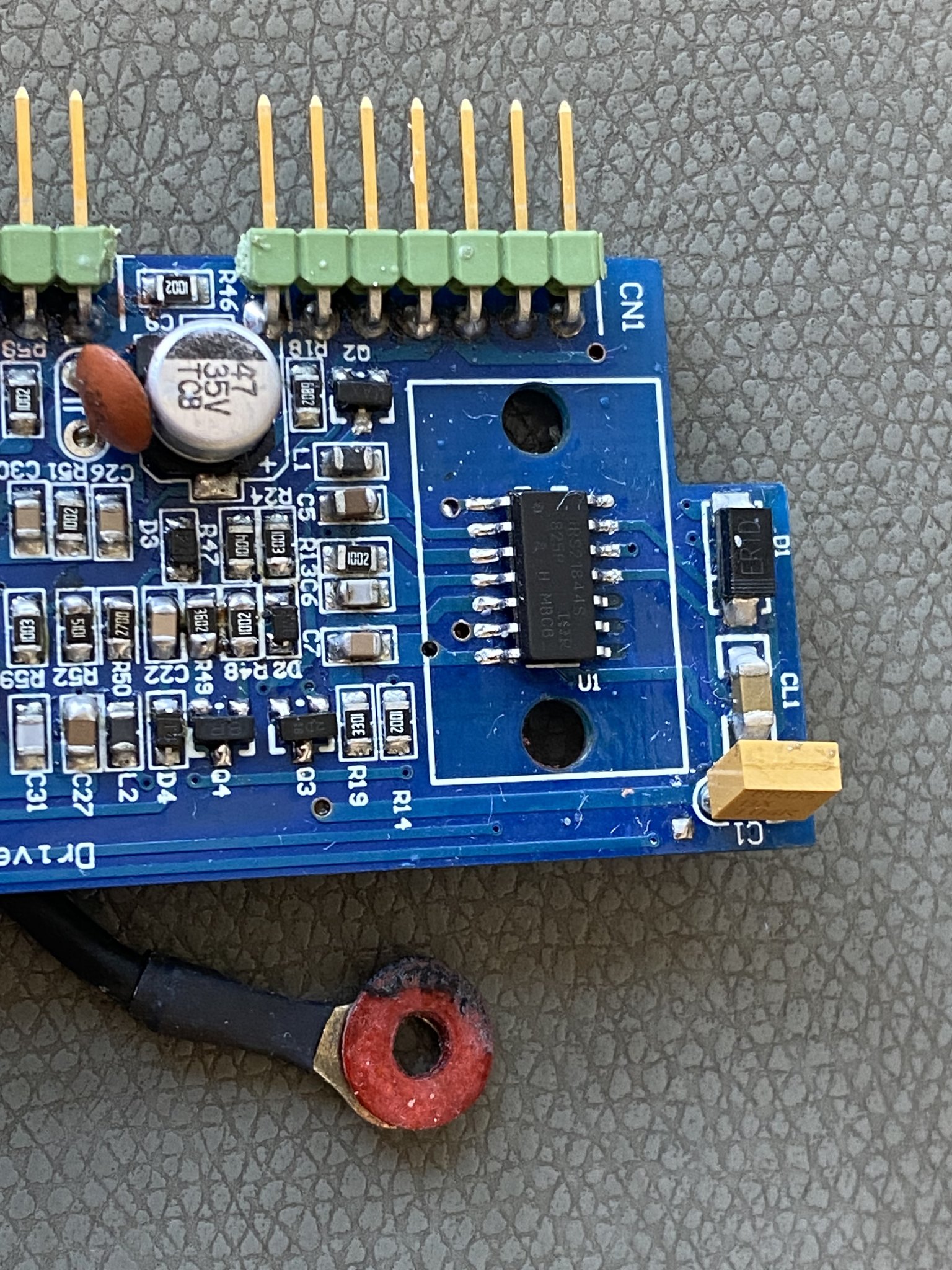

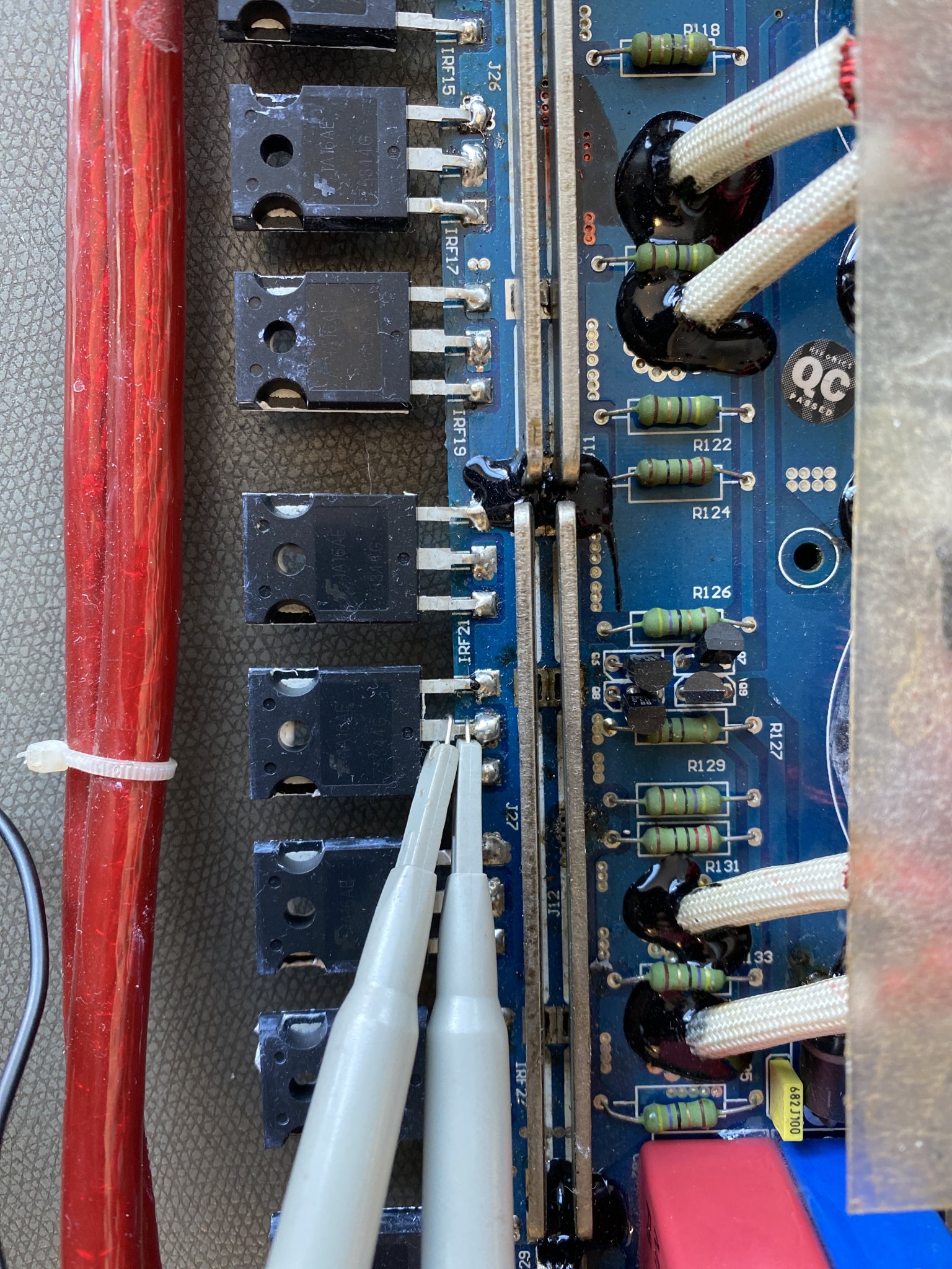

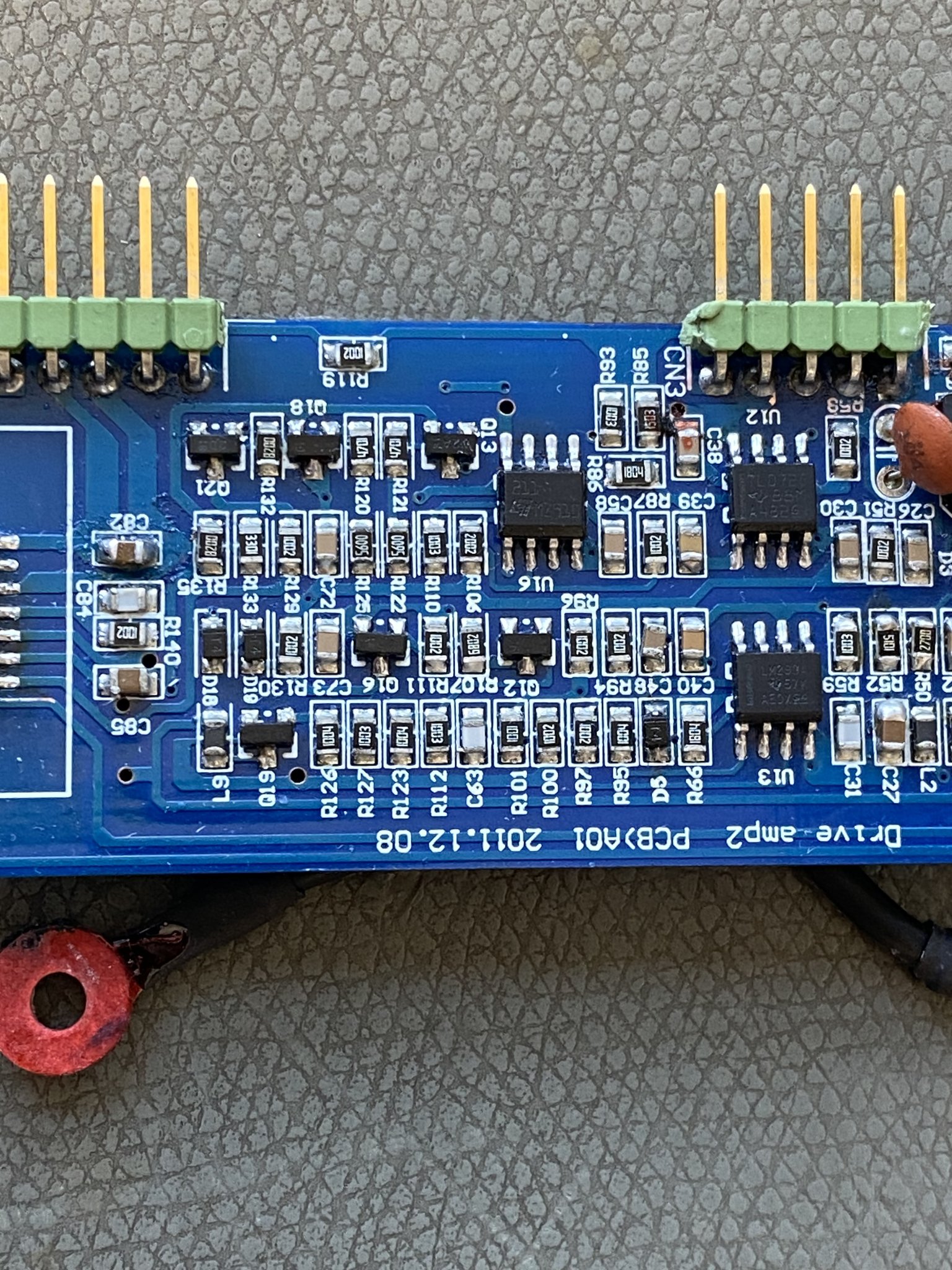

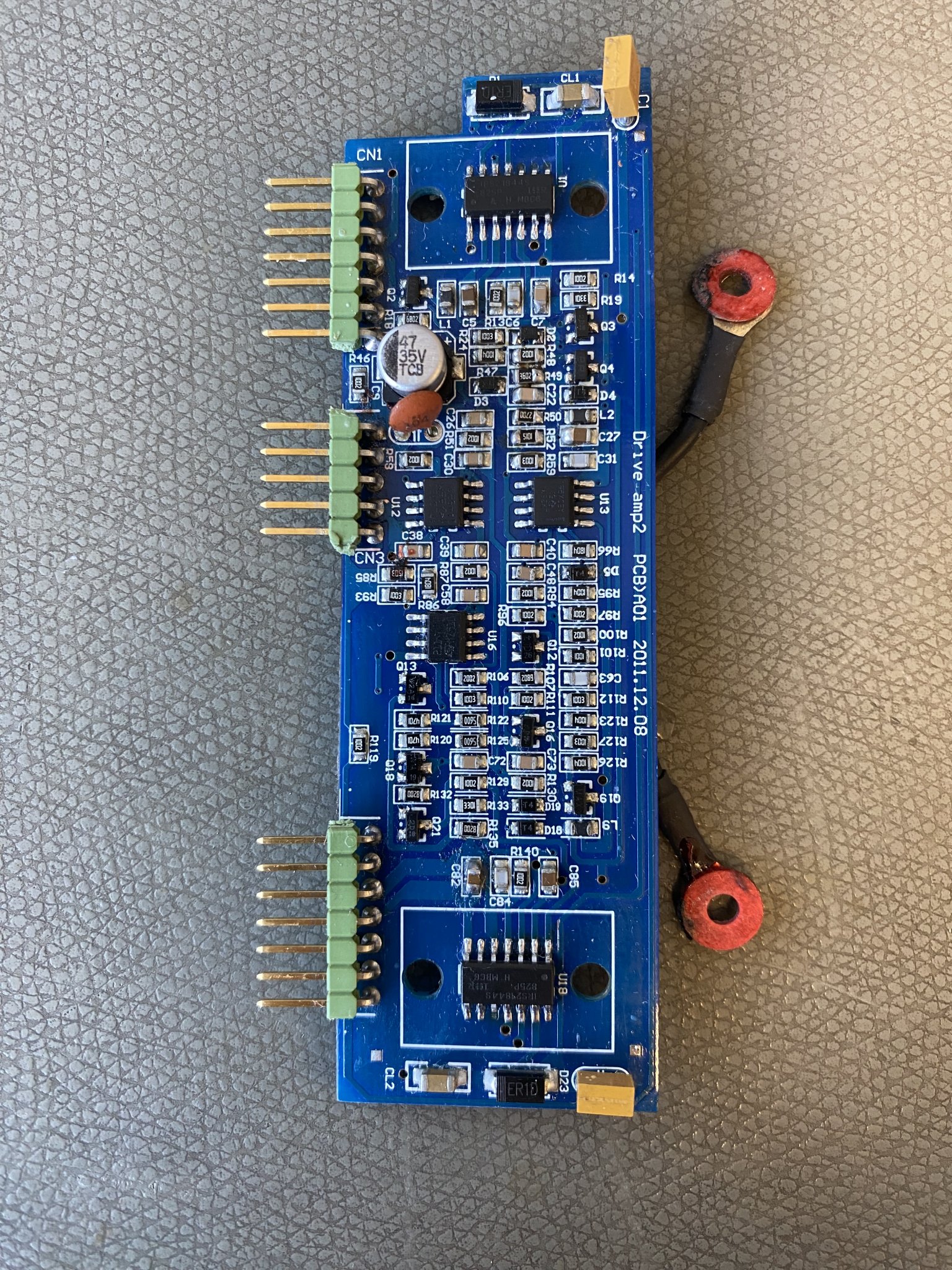

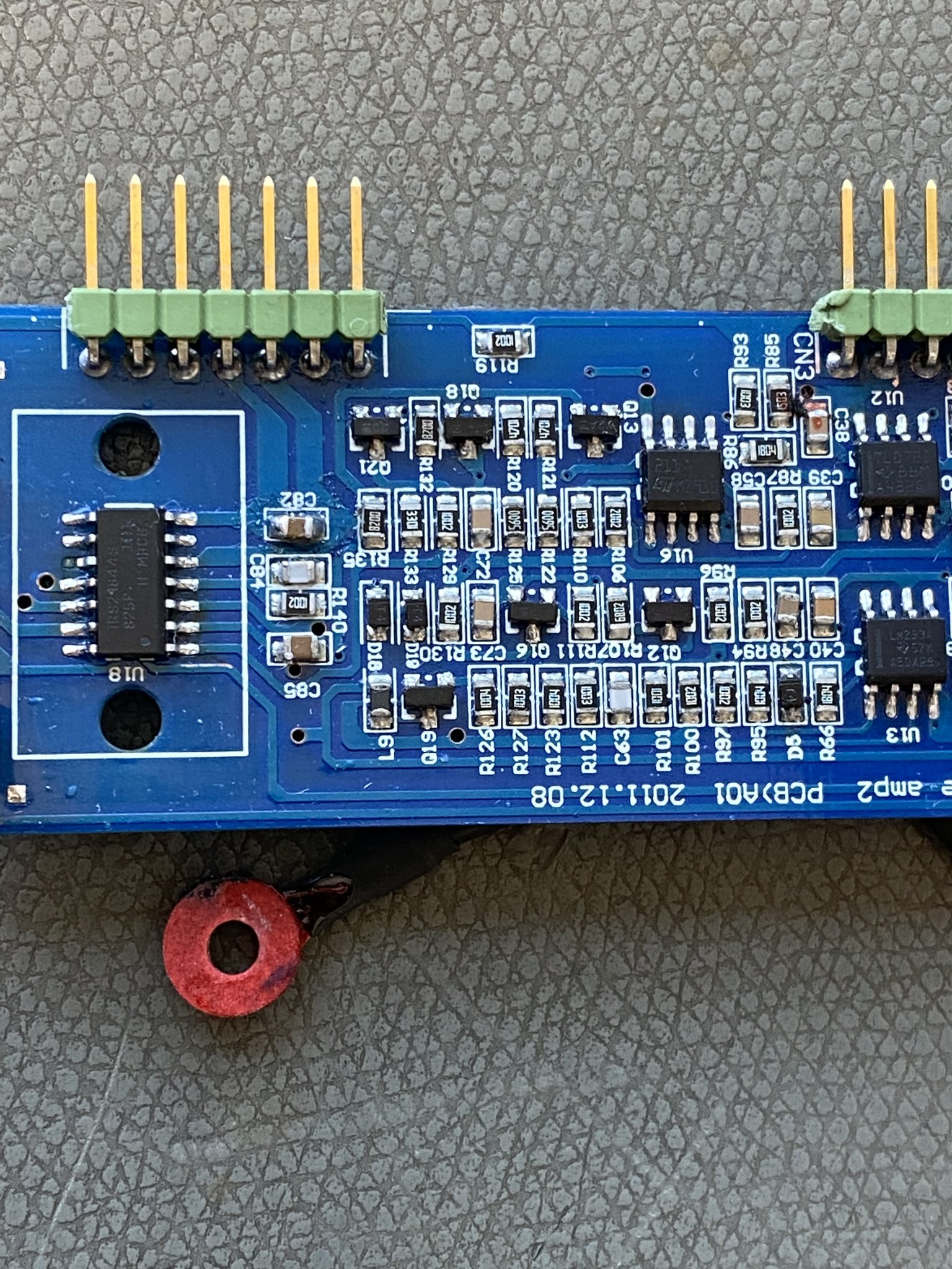

It seems to be more of a problem with the driver board, with the waveform that is more on the bad side at high side (going below 0V), where the high side fet´s were destroyed, 0Ohm between the outer leg´s. The low side Fet´s still measue ok.
The same bank broke first again. The one that U18 is driving.
Try flexing the main and driver boards in various ways to see if the idle current ever changes.
If not, try heating and cooling the various components on the driver board and in the audio section to see if the idle current ever changes.
Try pushing/pulling/twisting the output filter inductors while at idle to see if the idle current changes.

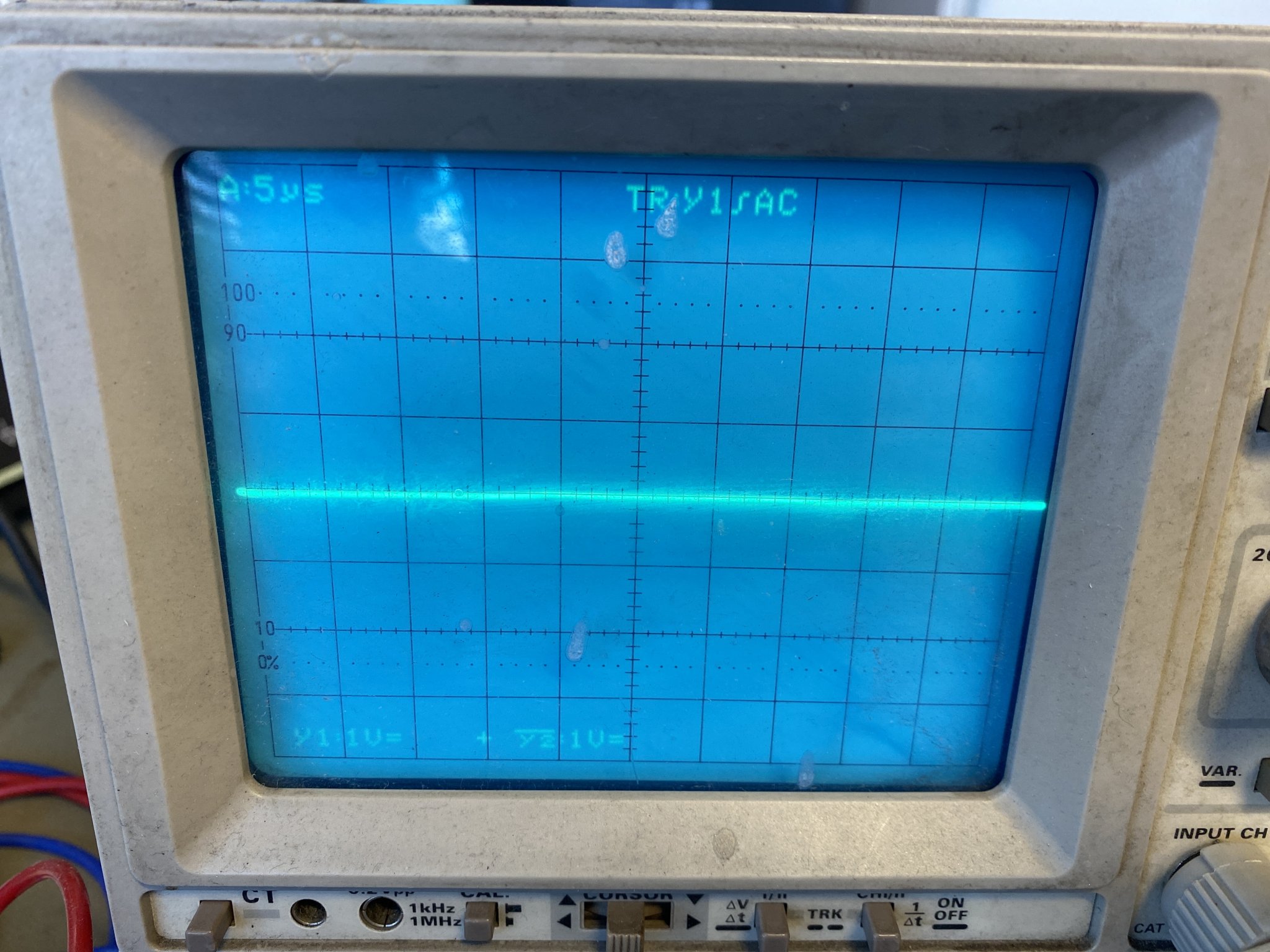

High current till rail is loaded, then 2,67A when the relays are engaging which falls to 2,54 - 2,51A and stays there.
