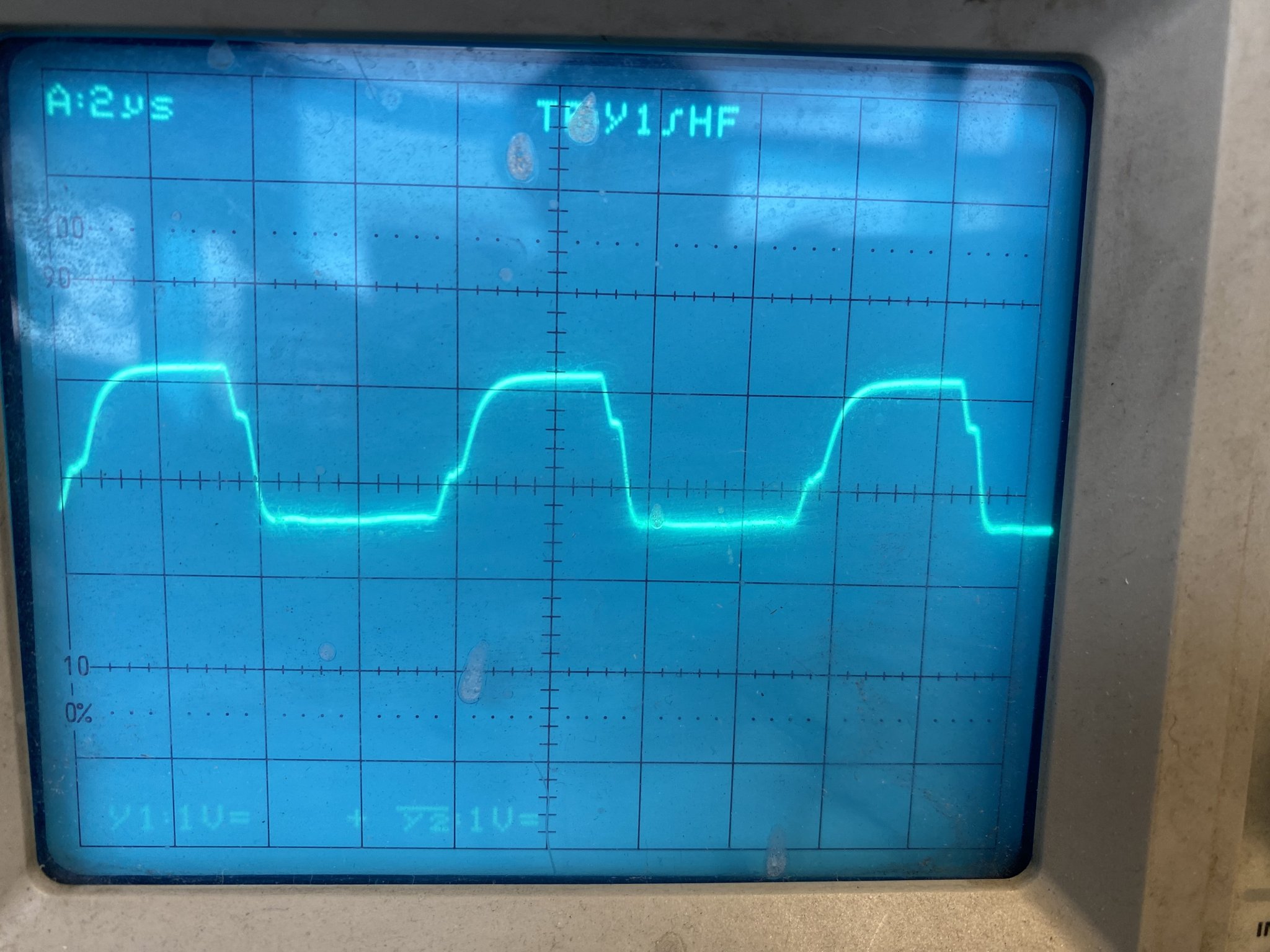

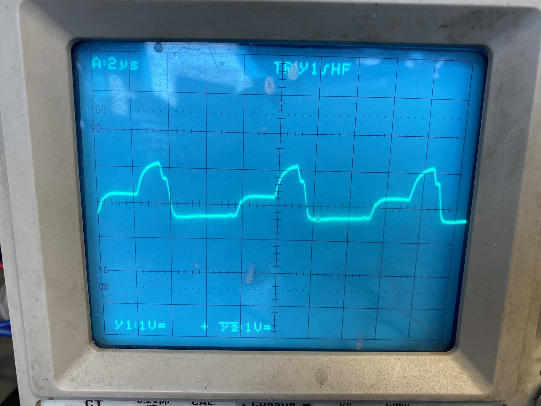

Hifonics BXi 8000D - good waveforms?
Deadtime increase is interesting, it cuts into the waveform.

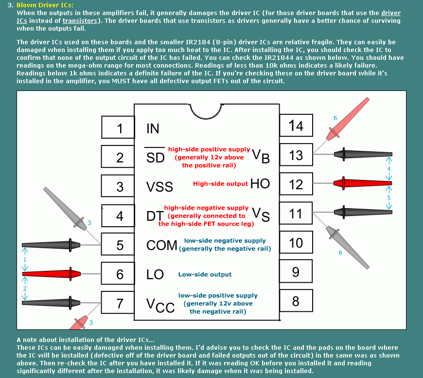

U1 is in circuit and working (generating the drive signals), with just the U18 driver disabled it doesn´t start working.
I desoldered the High-Side Fet´s of the U18 driver, this way it starts generating the drive signals.
U18 was defective (Ohm Range), both produced clean audio (a good looking sine wave), it just broke way before rated power.
It is the right side with the U18 that breaks first.
I will need to wait for new Drivers and output fet´s, they should come in the ninth month.
I will play a little bit with the remaining bank in the meantime.
