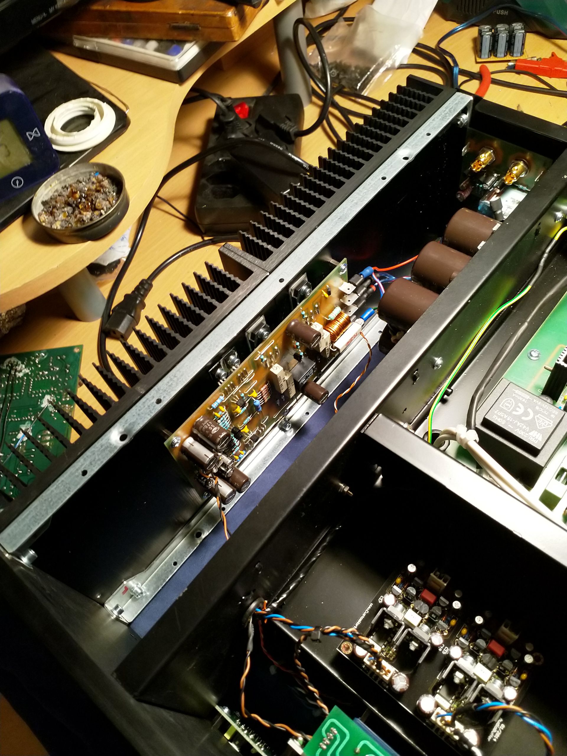

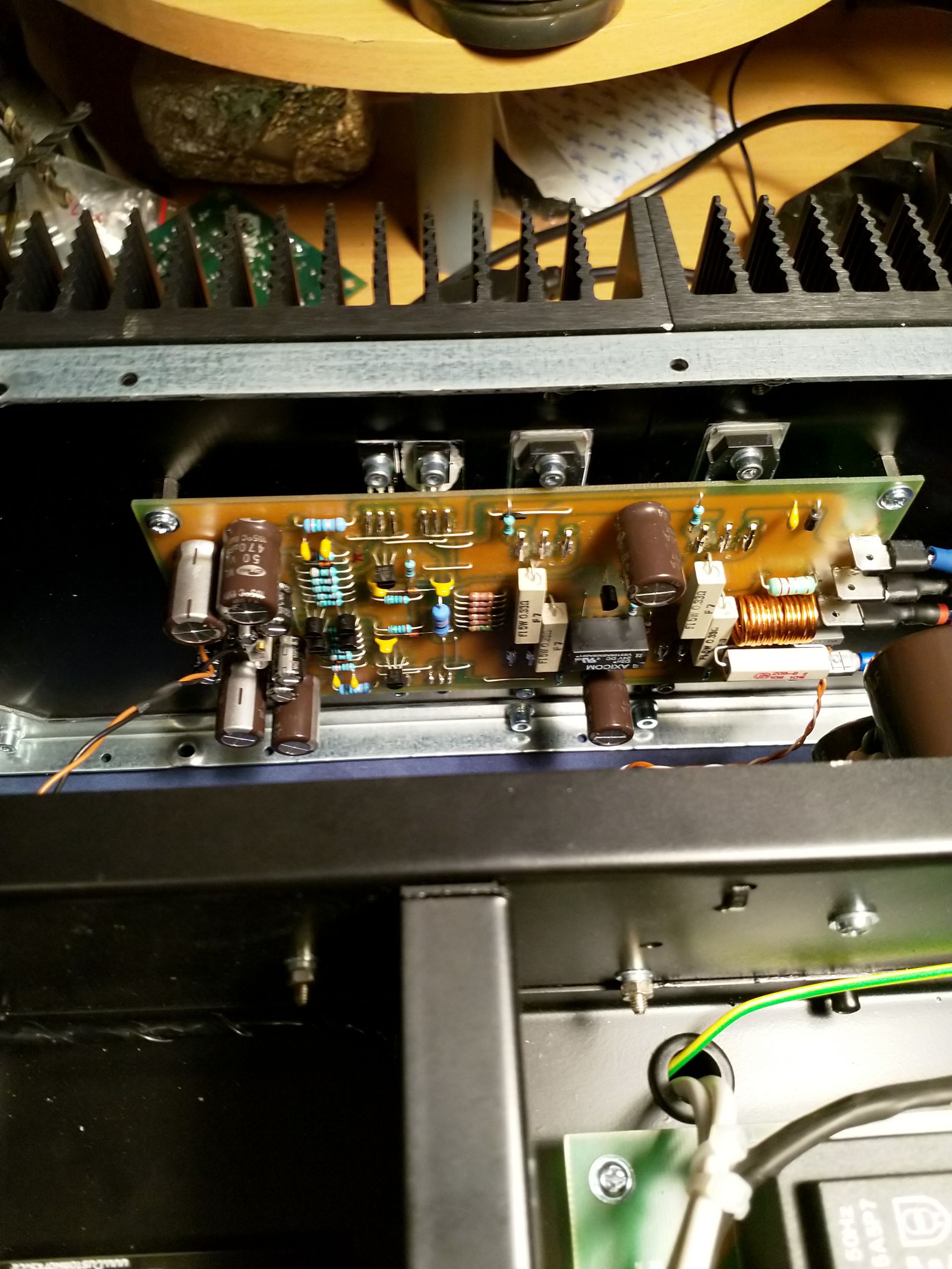

Hi guys....i would like to show up pictures of one functional channel of my KX amp...soundig beautiful, voice of Carol Duboc - Walk on By.....sooo sweet, smooth...I am very satisfied...but at the weekend I will connect both channel to my Visaton speakers and will hear how it is sounding...

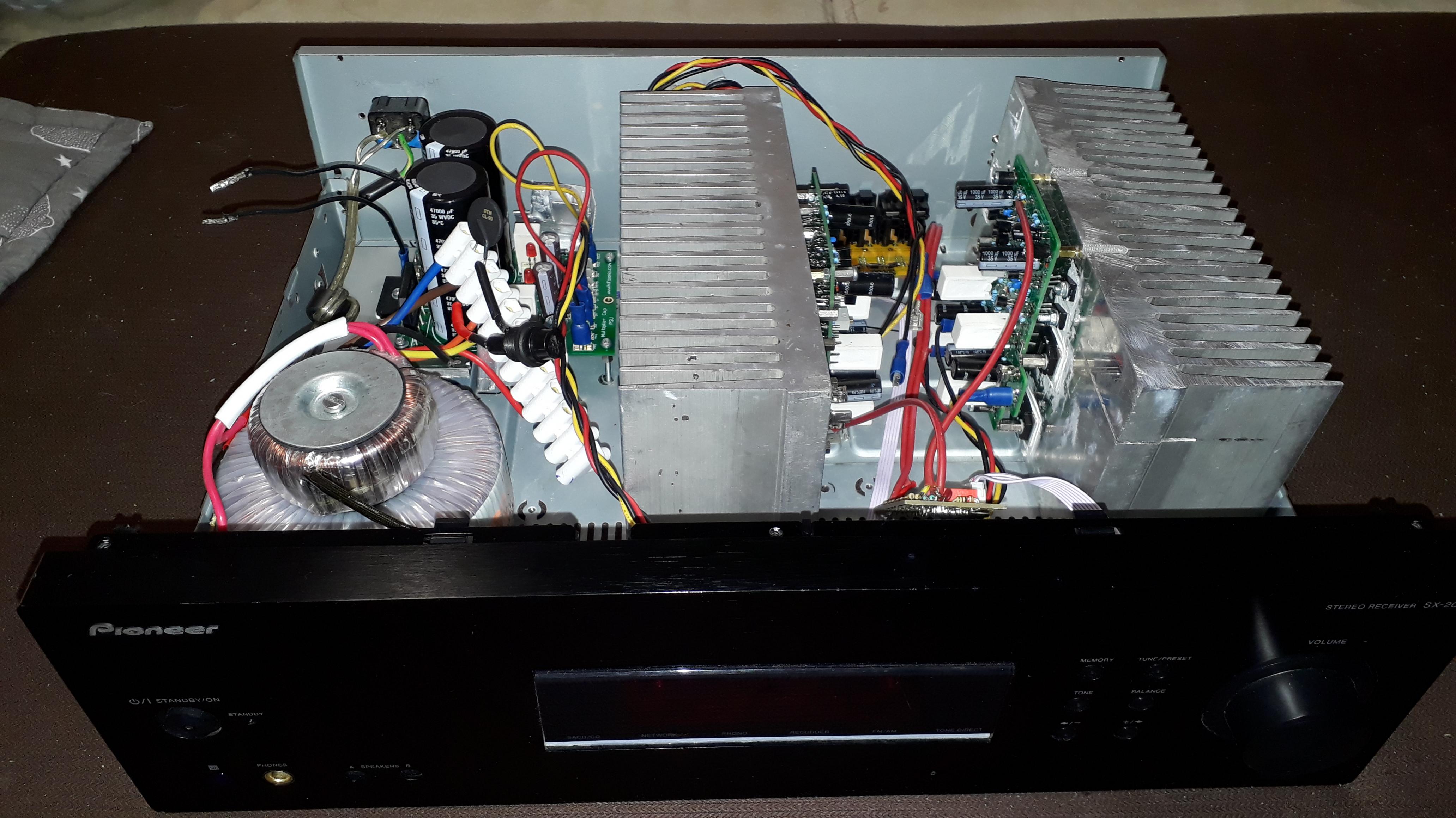

I've almost finished. Hardest part was to cut radiators and make holes. I have not threaded them

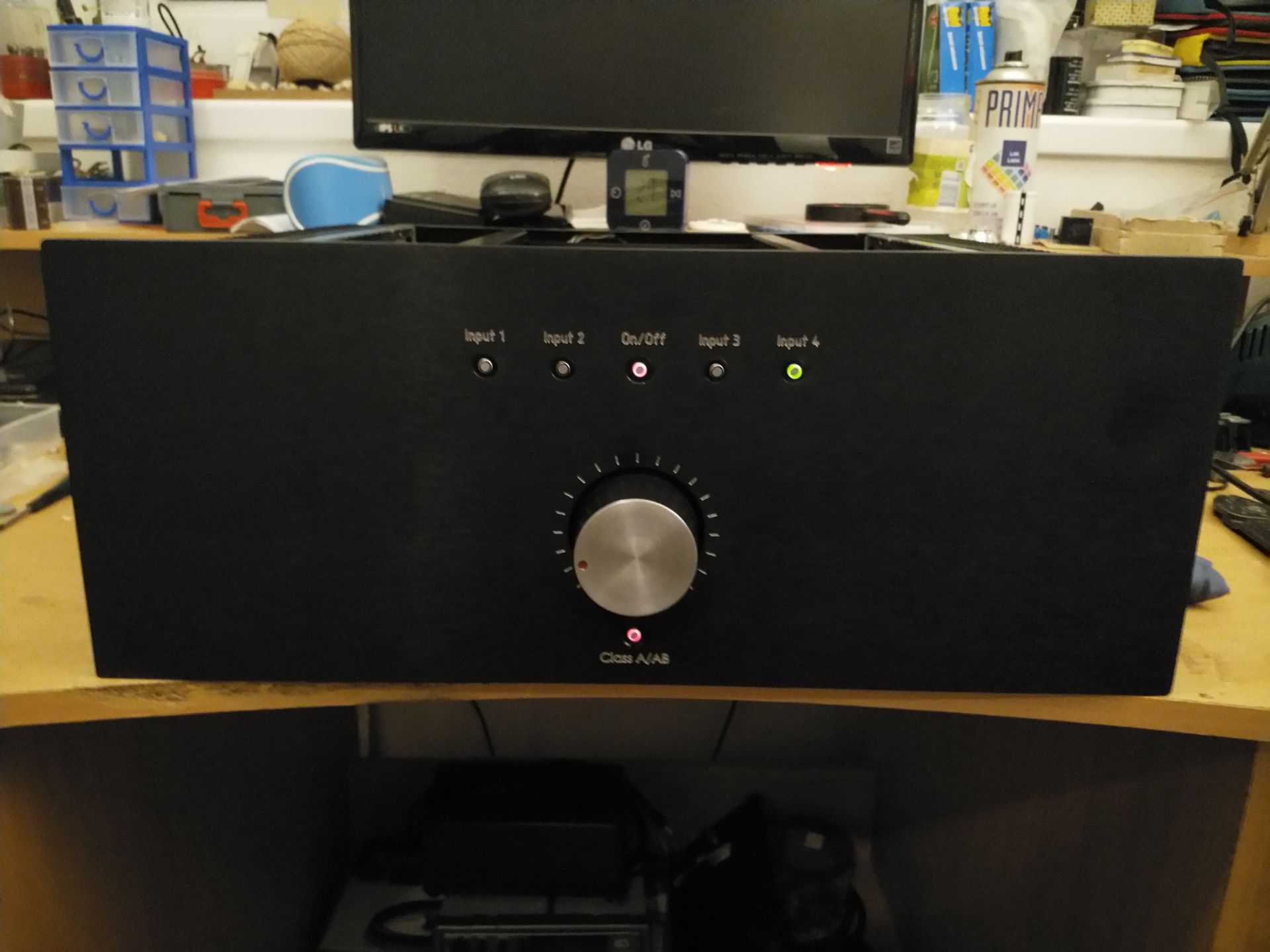

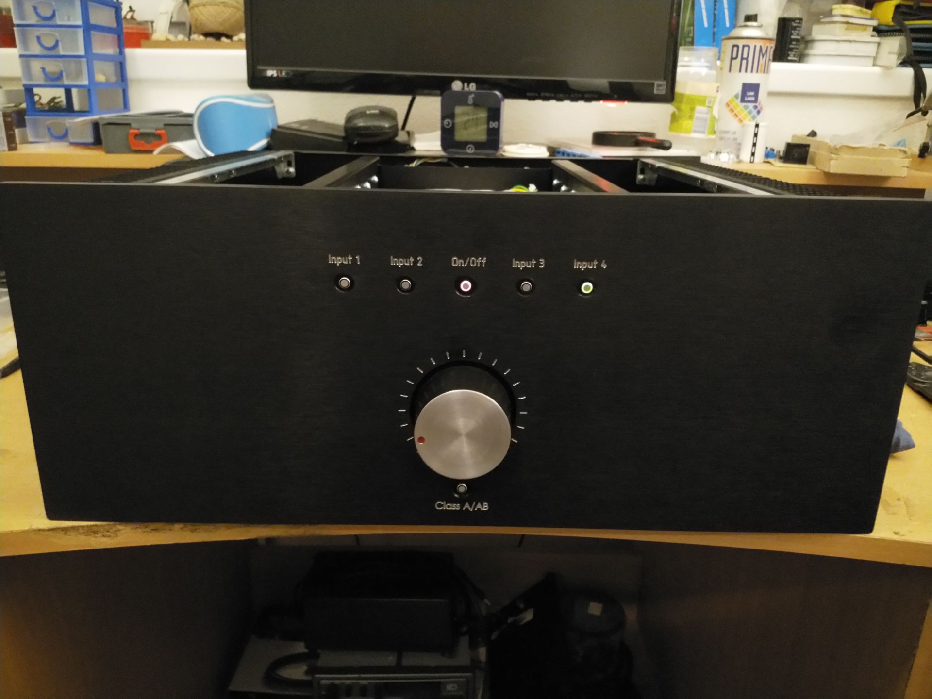

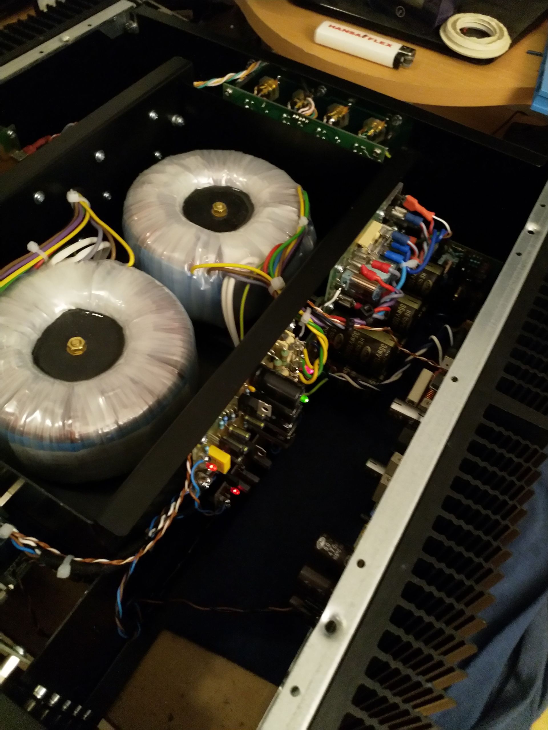

hi all ...the end of the assembly is so so near

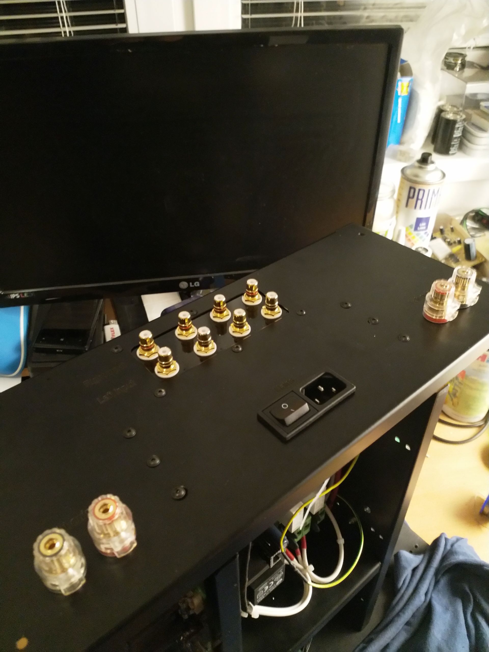

I have good news, the electric assembly was done...amplifier working...need to finish the housing...but only tomorrow....I am tired...
Answer to Bonsai aka Mr.Russel
Hello Mr.Russel. The amp sounding amazingly, but I ordered toroids from "crap" company, they are hum so much.The speakers are quiet, but not absolutely, need to play with wire traces ect...I will order toroids from Poland /audio grade kind/ then I will make some upgrades. Would like to build inside an audio buffer from customworks.cz. My question is: Better to feed with power this audio buffer from separate supply or made voltage stabiliser feeded from main supply of amplifier? Best Regards and thx for this amazing schematic....

I personally would design a small separate supply since it appears that this audio buffer requires a bipolar +/- 12 to +/- 15V supply. Linear or very clean switcher. Many options there. I do this a lot in my own builds since I use balanced/differential inputs. There are also other options for an input buffer such as AMB Audio alpha 24 and also Neurochrome’s new buffer which will be coming soon (all SMD and fully built).

Question 1: Before powering up, I have interchange the main fuses 5A/T to classic light bulbs /200W-230V type/ these bulbs are connected to the blowed "old" fuses with wires...bulbs limiting the flowing current, if something go wrong...then,if amplifier pass this first check, I replace this "live it up" instrument with predescribed fuses, and doing more tests...
Question 2: coil, create a new one, its a simple and easy...create coil, which is described in the building manual....cheers...

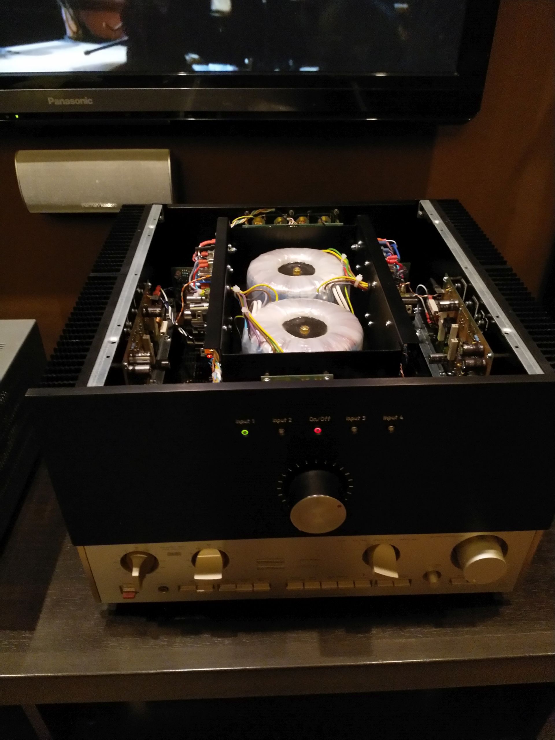

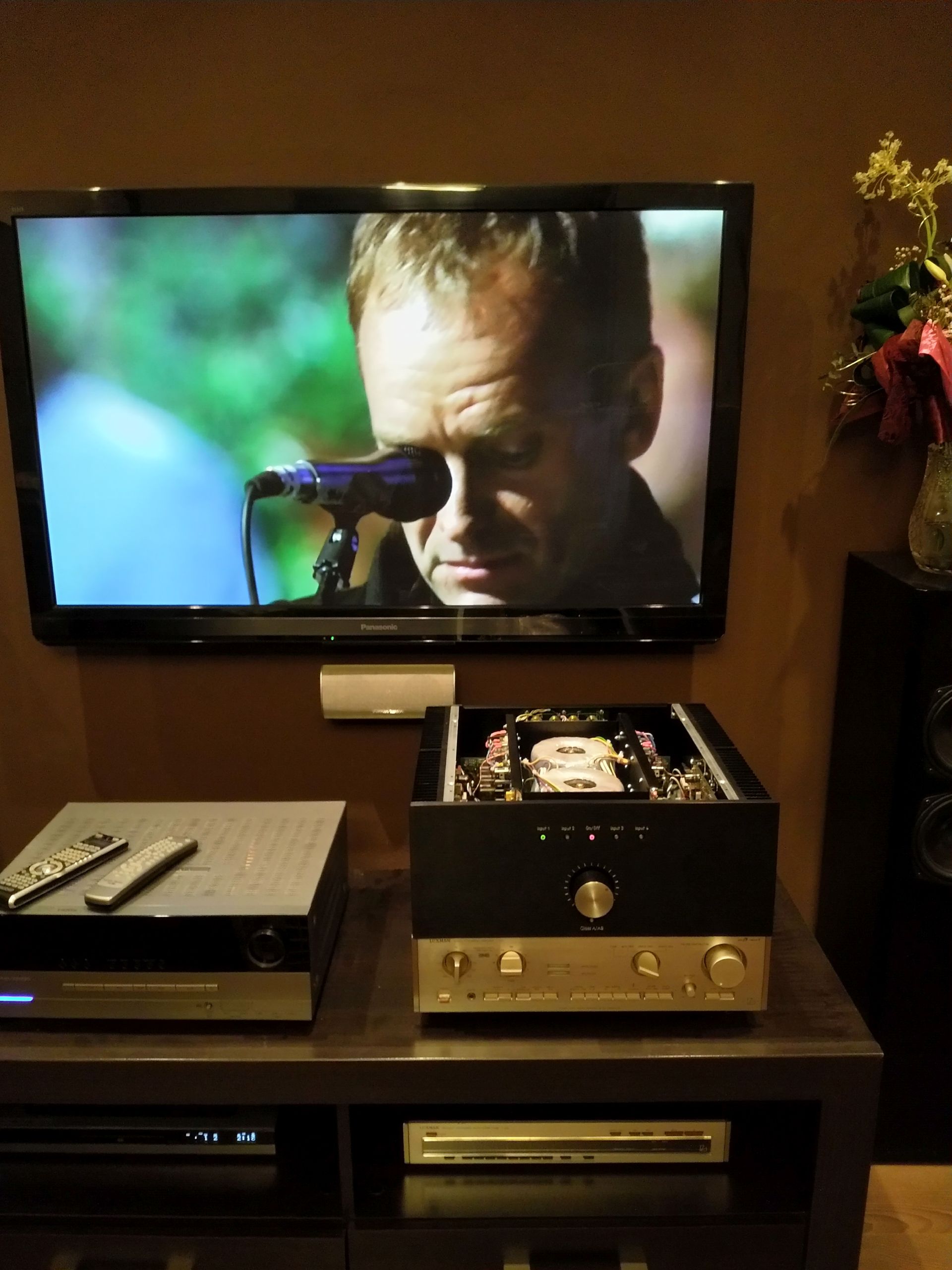

Hi guys. I will show up some pictures, yesterday evening my KX amp passed some listening tests. First of all...Sting - Live DVD....source HK DVD-37 player...was pleasant time...I enjoyed so much what came from speakers...
