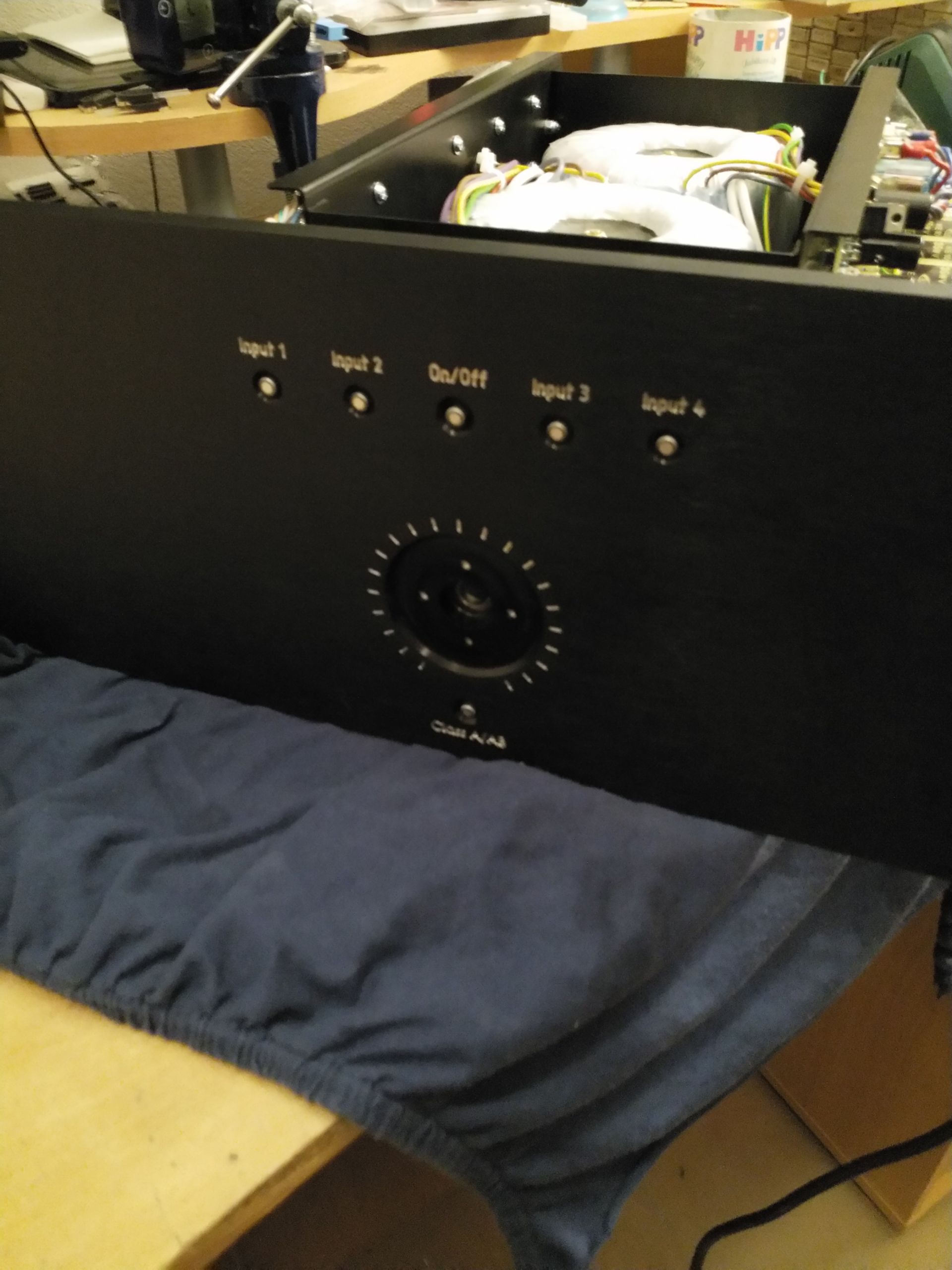

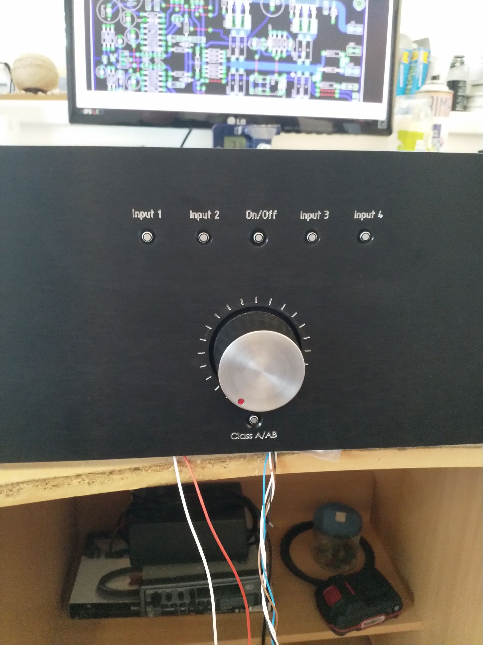

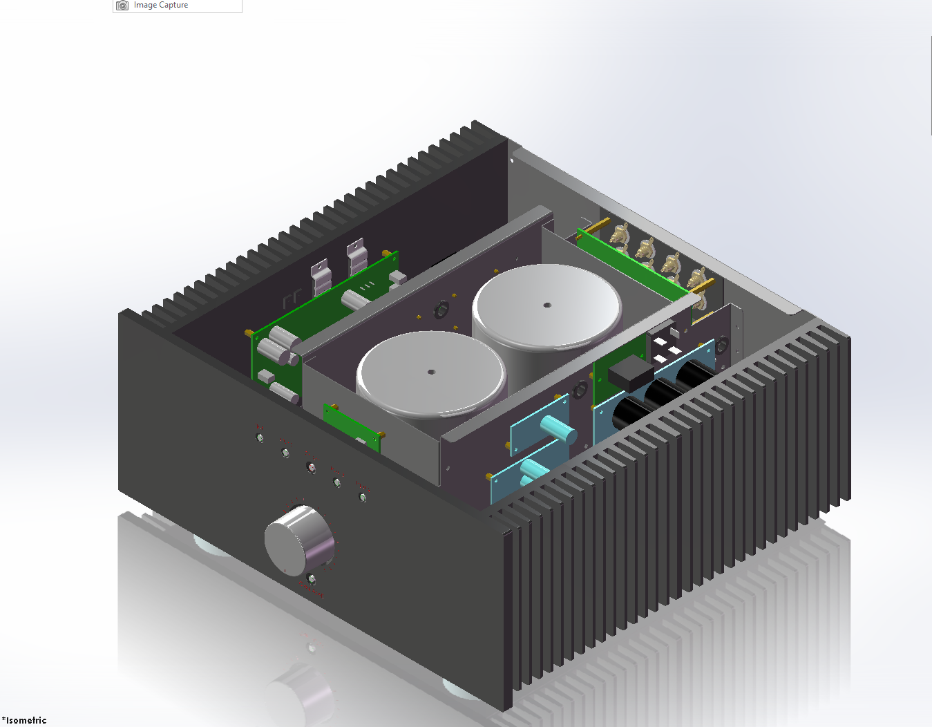

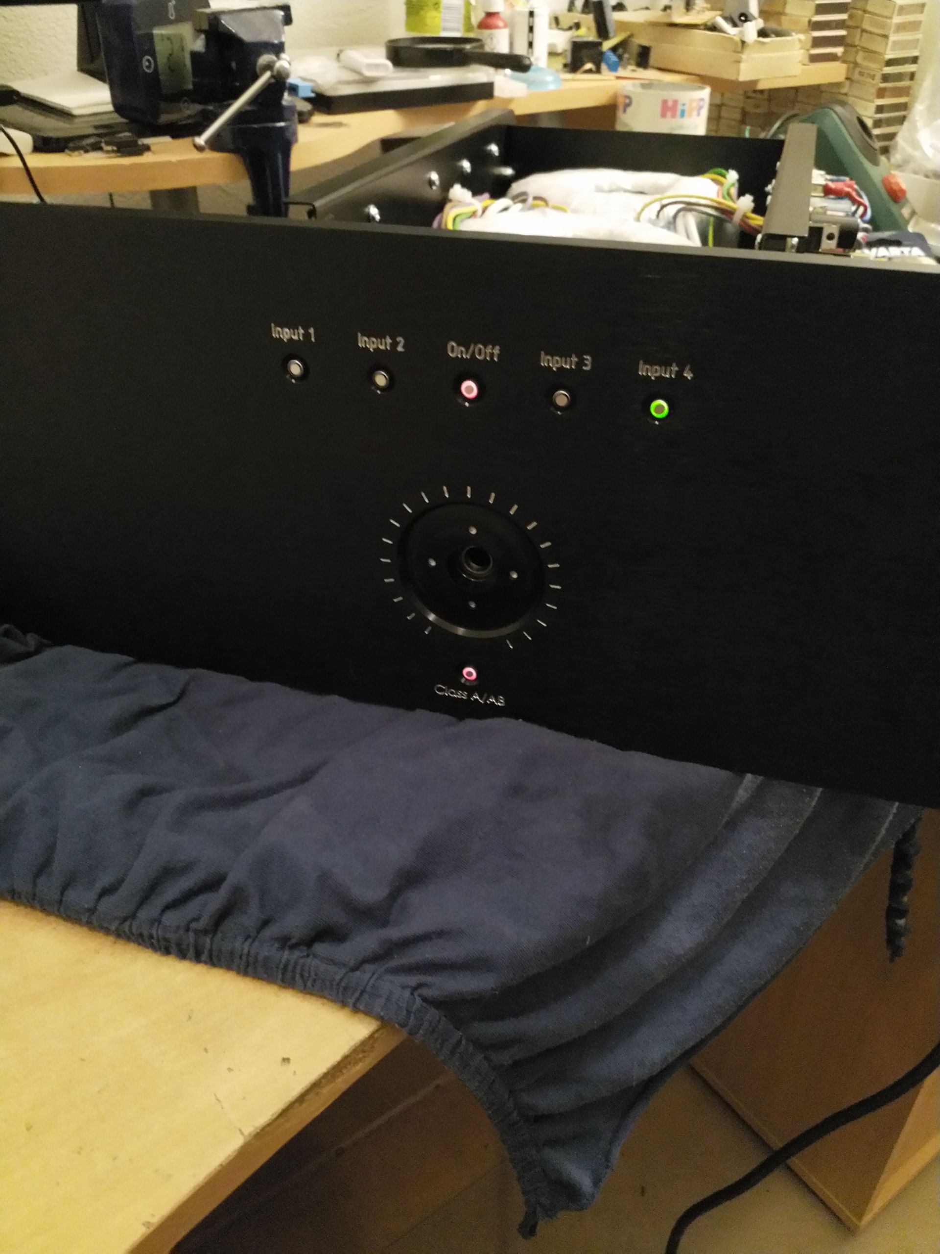

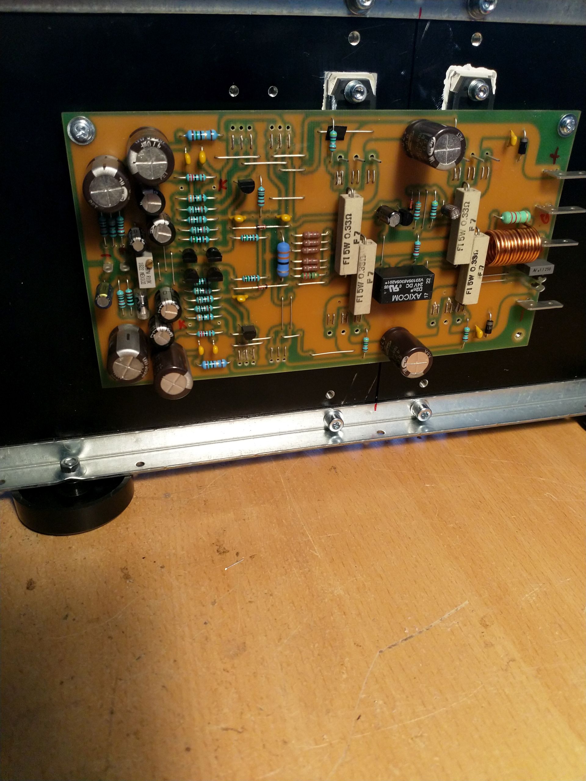

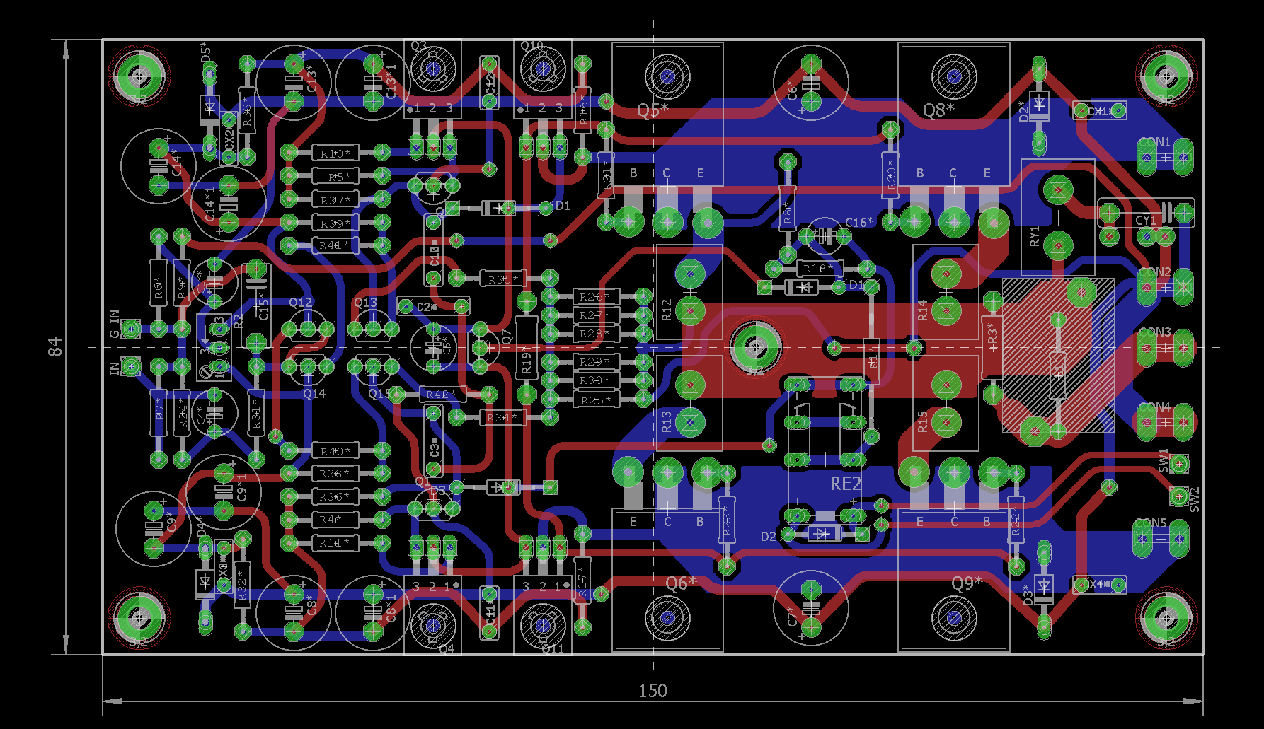

my project based on KX amp

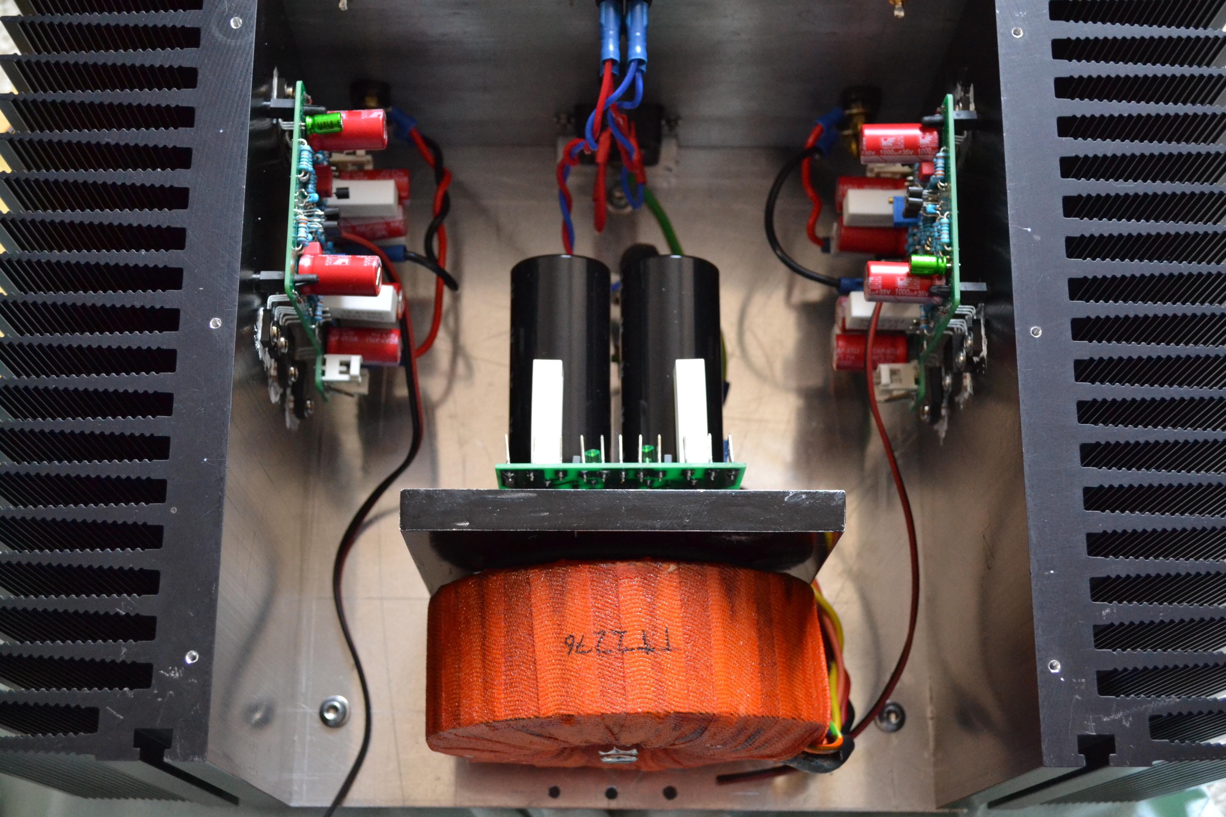

Hi guys. I would like to show my work on famous project "KX Amp" by Bonsai aka Mr.Russell,
First picture show my amplifier, based on chassis made by Hifi2000, its a 4U chassis with black anonized coolers. Then I created a 4 input circuit, which is controlled by simple circuit and microswitches. Myself I redesigned the main PCB, which is dual layer and its designed to have fine rounded traces. And finally the design is dual mono, absolutly isolated two channels. Only the ground lifters or breakers are connected to the common safety ground.
All comments are welcome.

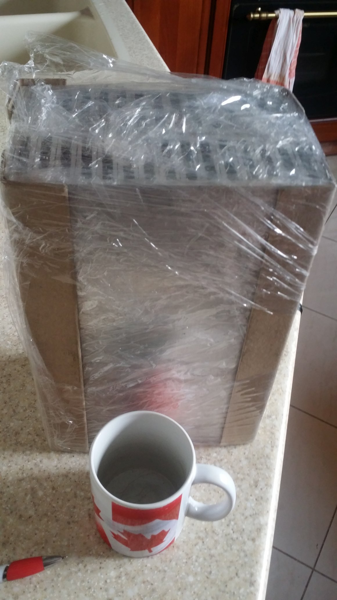

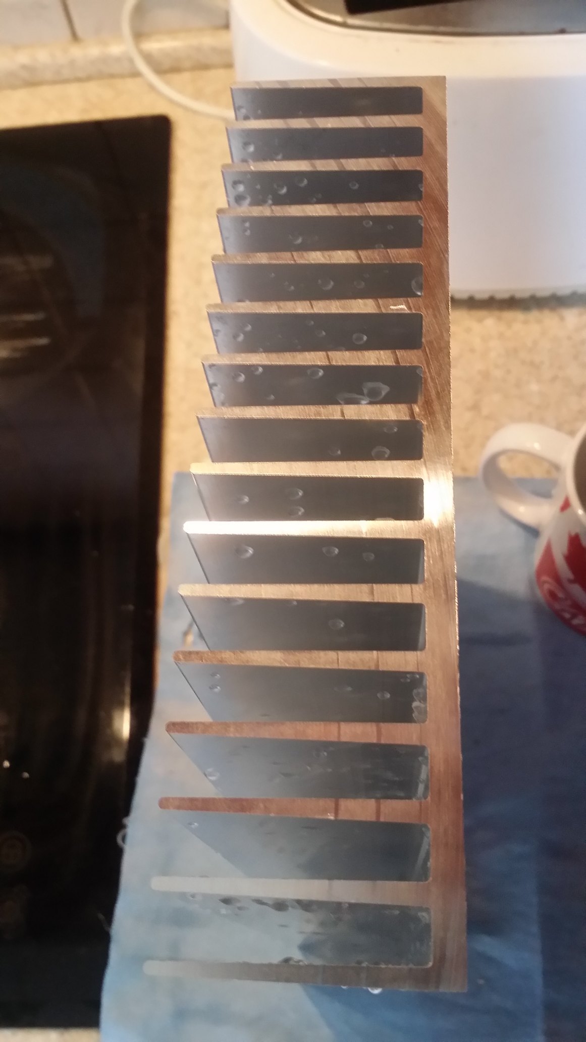

A 10kg parcel arrived today. Contents unpacked. Then went straight under a shower with strong jet stream of water. Needed to get rid of the filings, which were still between the fins. Dried up. The edges are nicely cut(*). I am very happy about how they prepared these. Four pieces of such profile: 30 cm long, 19 cm wide. The fins are 5 cm high.
I am considering making two separate monoblocks, bridged, in a "Tower Fashion", similar to a high PC enclosure. The length of the heat-sink determines height of Tower: 30 cm.
(*) They are normally NOT nicely cut. With less than perfect tolerances of 2mm.
But I asked them very very nicely, not to pack stuff off the ready goods shelf, but to prepare them separately for me. Will wait a few extra days. Asked to set the length to absolutely as precise as they can get it, set the cutting machine to slow forward go, and then to even out the edges. So they did. Better than I expected.
Radiator aluminiowy A6023 192x50x300mm Led-Byt.pl
... the exchange rate is roughly 4 zl into 1 USD.

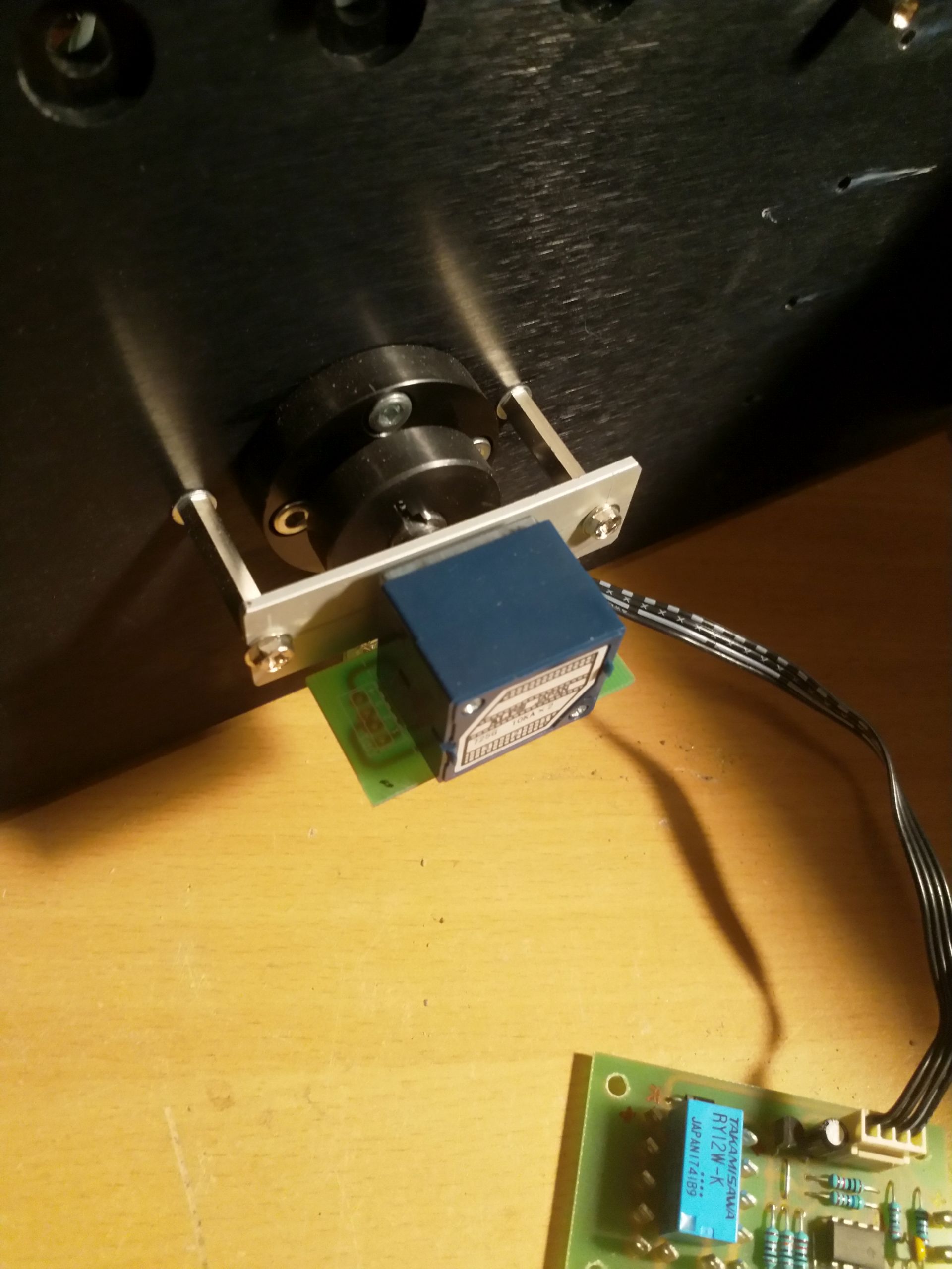

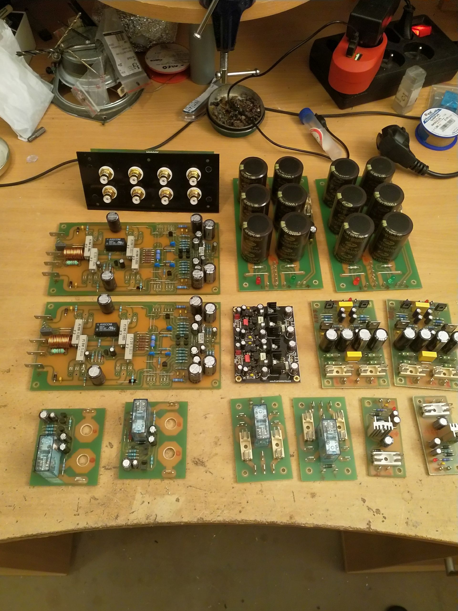

Hi guys. I will show more pictures....the "bowels" and detail to the potentiometer...i will replace them in the future by TKD CP2500 type potentiometer...but everything depends on money...

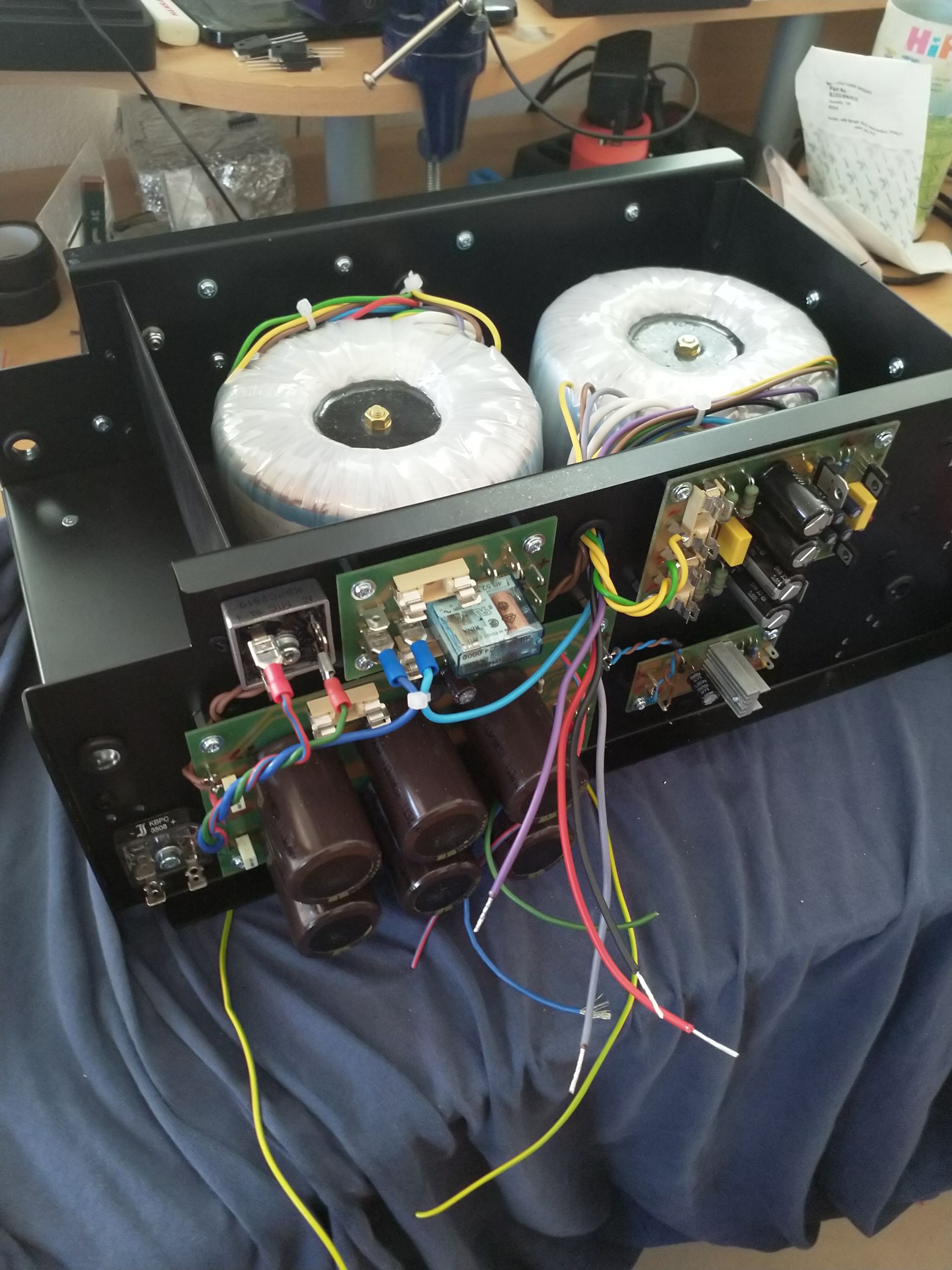

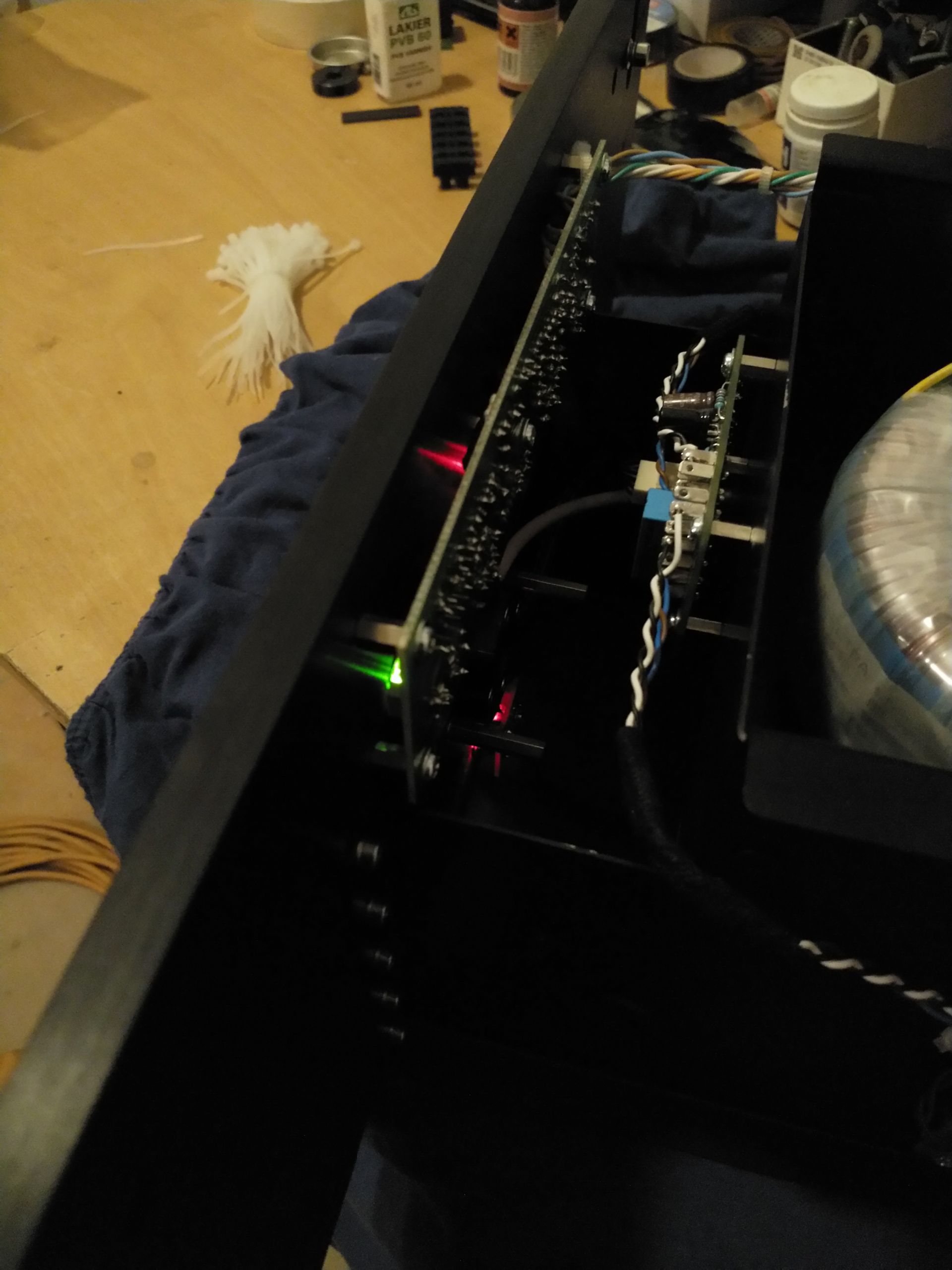

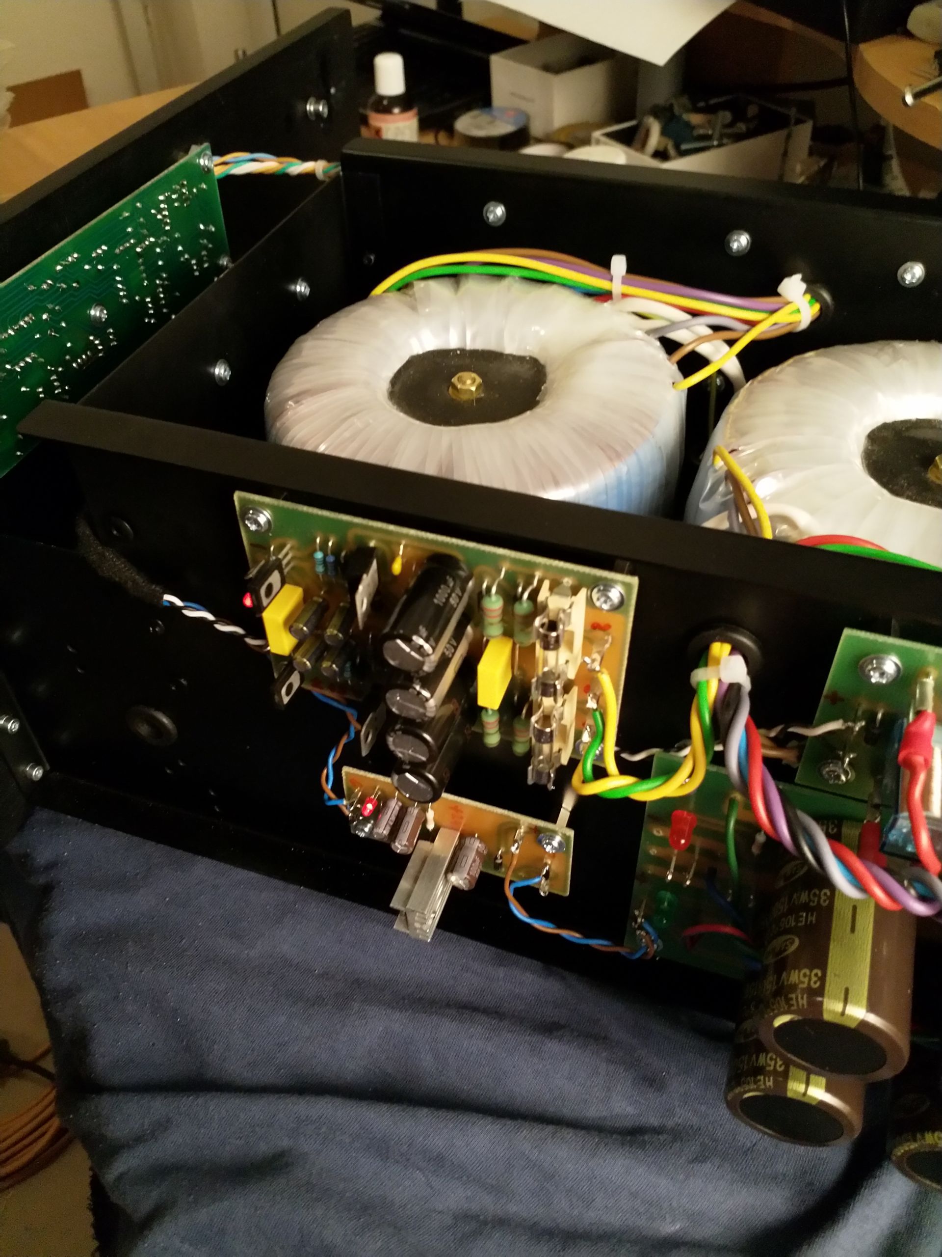

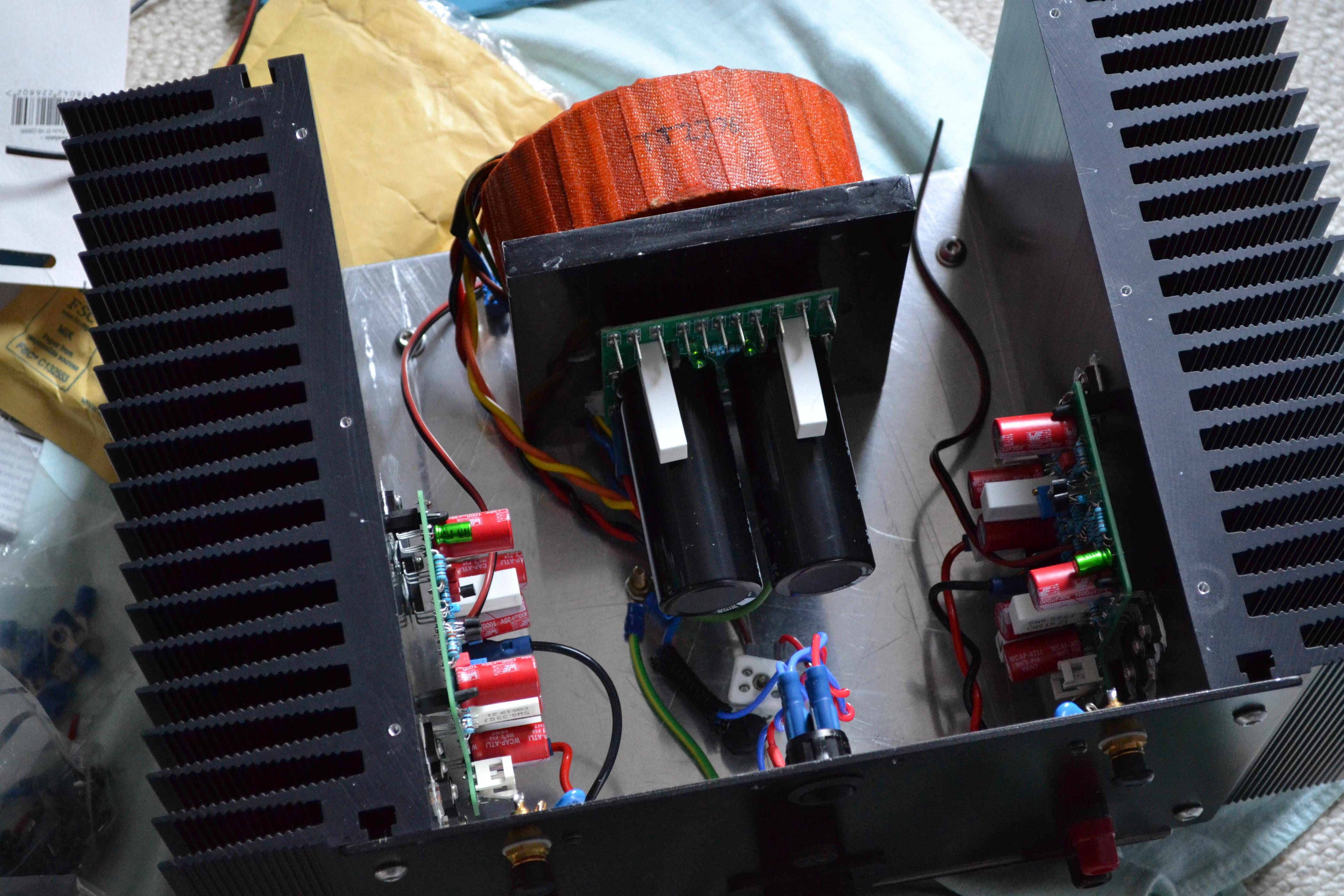

another step of assembling...
Hi guys, another pictures of assembling, the voltage stabilizers, input microswitches, A/AB switch are working/liting. The wiring to be done. Next step is assembly the amplifier PCB`s and speaker protectors...then the relay based input switch PCB...
