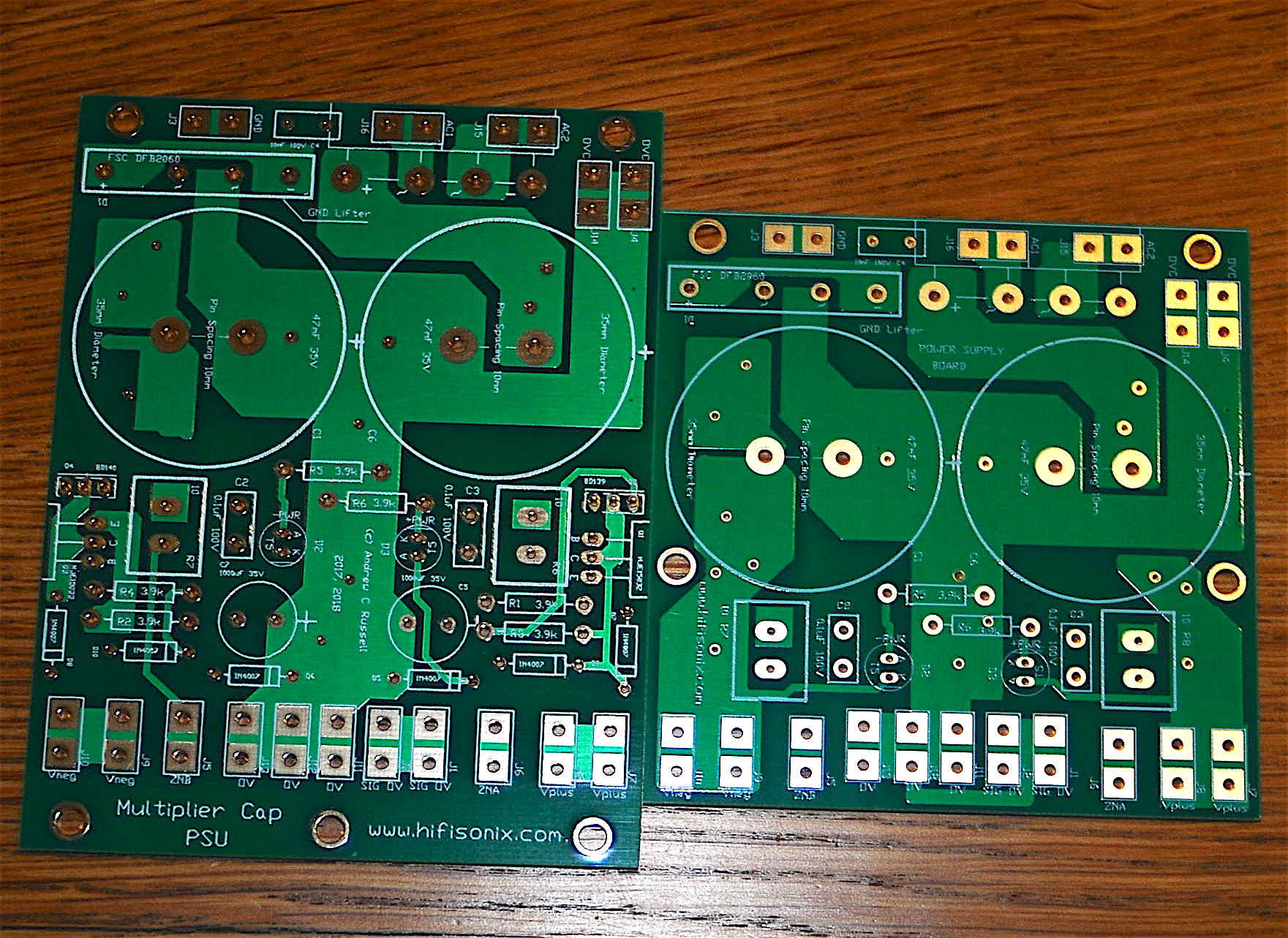

@ polsol are the psu boards supplied with the kx amp boards not different from the ripple eater boards sold seperately. I know that Jim's audio do sell the kx psu pcb on its own as I have just ordered one as I intend to make monoblocks at some point. It is an excellent sounding amp with just the one psu board.
Looking at the pics on Jim's both boards (sold separately and with the kx) are named as 'Multiplier Cap PSU' so it seems they are the same. A quick look seems to confirm that but as the boards are inverted between the two items so it's a little difficult to compare visually.
There might be component differences though.
Bonsai will probably confirm your question.
