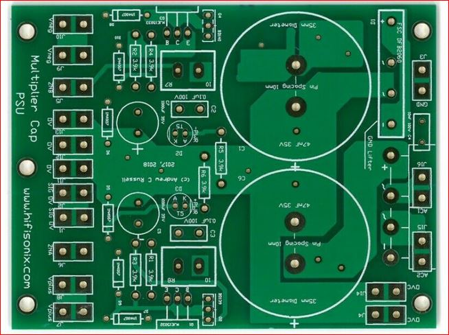

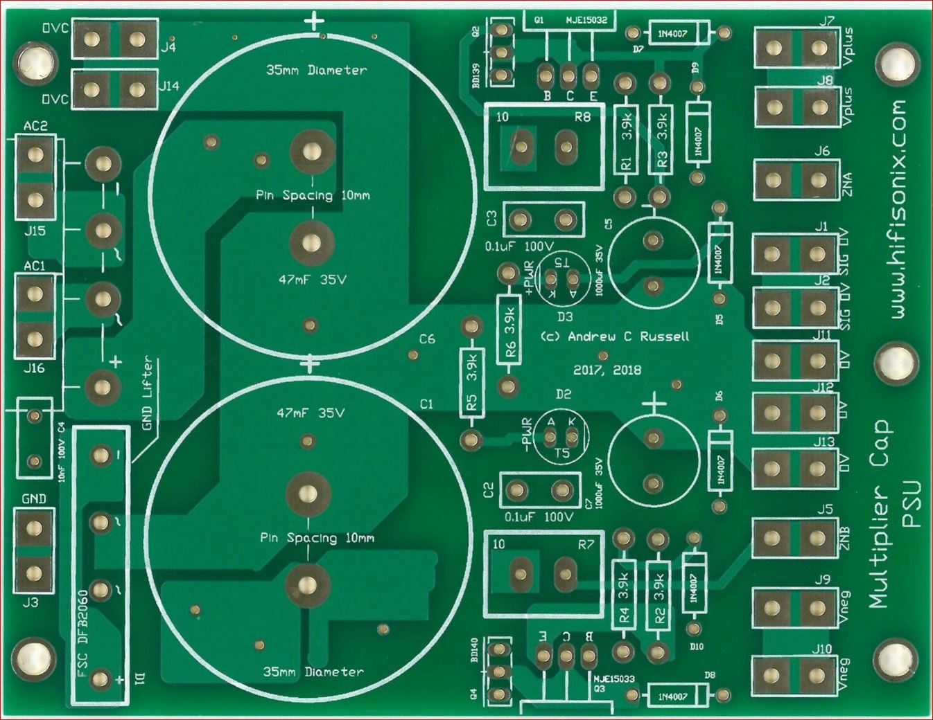

In bianco's picture, the LHS board is the ripple eater and the RHS board is the basic PSU board that comes with the kx-Amp board set (and the sx-Amp as well).
There are no ripple eater components on the actual kx-Amplifier module PCB's - its just the amplifier part.
If you want the ripple eater, you need to buy the PCB separately ($11.99 IIRC).
The ripple eater was designed after the kx-Amp and is designed to be used with any class A amp up to about 25-30Watts peak. please see the write up here for further info
Seems the pictures on Jims are wrong - as I had suggested they could be - unless I'm missing something.
BTW, Hovering over the two pics (above) will confirm which is which picture.

no. The kx-Amp is supplied with the very basic PSU with just the filter caps, rectifiers and Zobel.
If you want a ripple eater PSU, you should order that separately from Jim's Audio (link on the Ripple Eater page on my website)

Looks like the pics from Jim's Audio are the same just that one image is rotated by 90 degrees - this is the Ripple Eater board
Thank you I had confused myself after reading about the ripple eater.

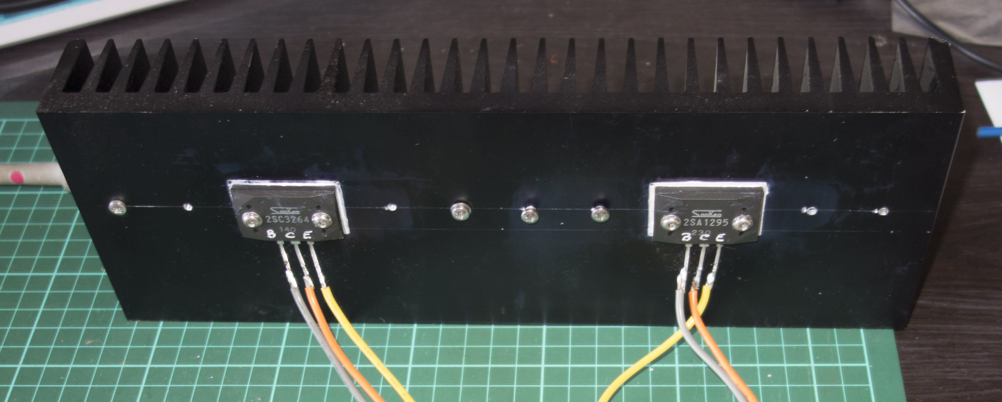

Just wondering whether I can substitute the NJW3281G/NJW1302G with 2SC3264/2SA1295 output transistors which are pin for pin replacements?
Reason being I have quite a few of them in my box trays and currently putting together my 'shopping list'.
Never mind, scrub the use of these output transistors as they won't fit the PCB if directly connected.
Also it seems the NJW are highly recommended.
Should have properly read the design notes first 😱
I took a look at the Sanken devices- they look good and I would think they would work in this design.
But, the devil is of course in the detail, so there is no guarantee that there would not be be some OPS HF parasitic oscillation as these transistors are spec’d at 60 MHz fT which is double the devices specified in the design.

Well I have a 0.4°C heat sink (300x100x40) that I use for testing amp boards before fitting into a chassis so maybe I could try this out with the 2SC/2SA output transistors and 'see what happens'.
I have a basic dual 60 MHz Instek 'scope but it might not be good enough. The Fourier maths is somewhat 'iffy'.
You could try that - a 60 MHz scope should be fine to check for HF oscillations.
