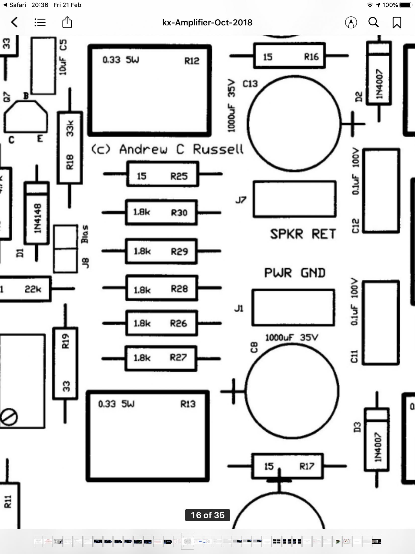

As per Page 15 of 24/01/17 PDF:
Only 5 paralleled 1K8 resistors (R26 - R30) are shown but there are 6 on the PCB (and P16 Overlay) so one more per channel needs adding to the BOM. Will this also change the 'gain' settings with R25 values as indicated on Page 15 (assuming only 5 by 1k8 were used in the calculation)?
P.S. Many thanks for the project and sorry for the '100 questions'.
