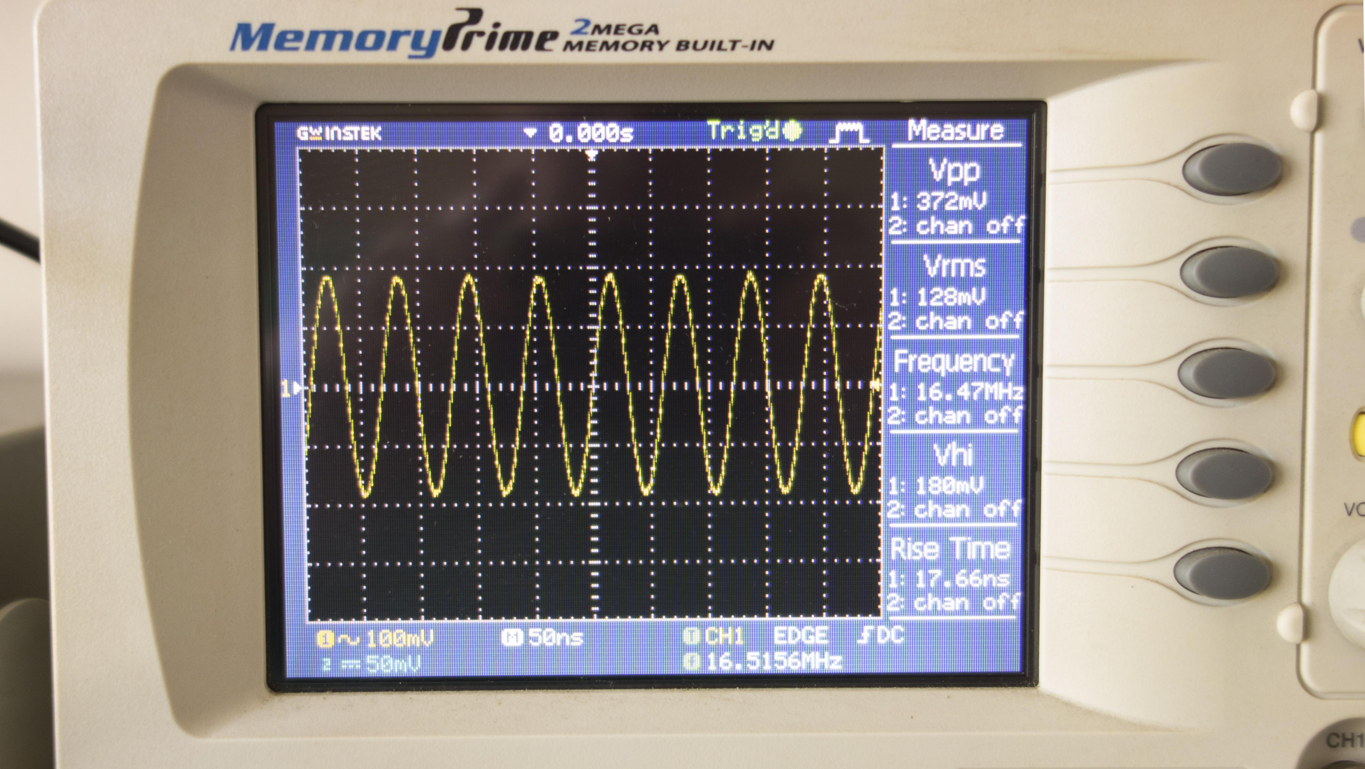

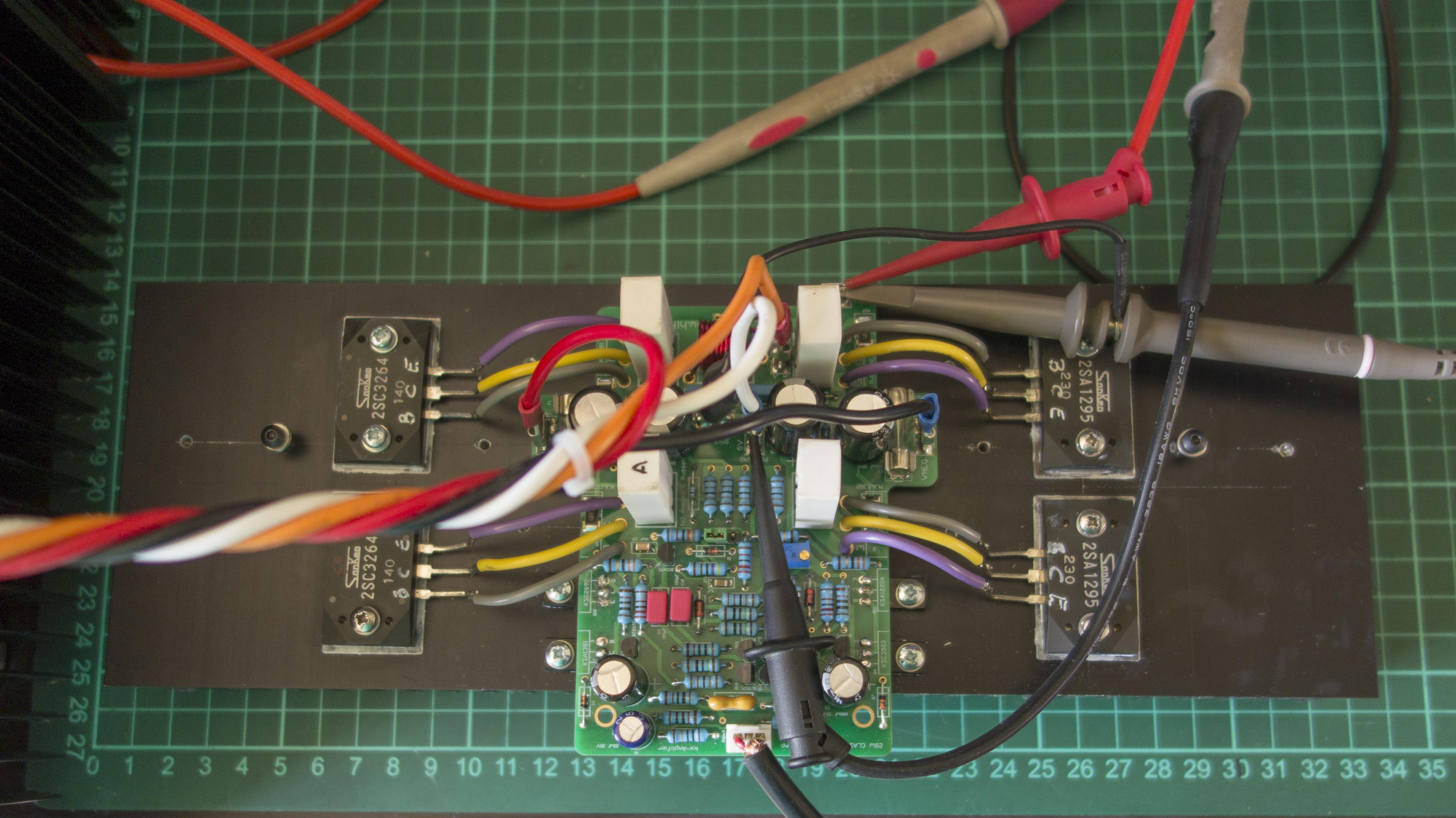

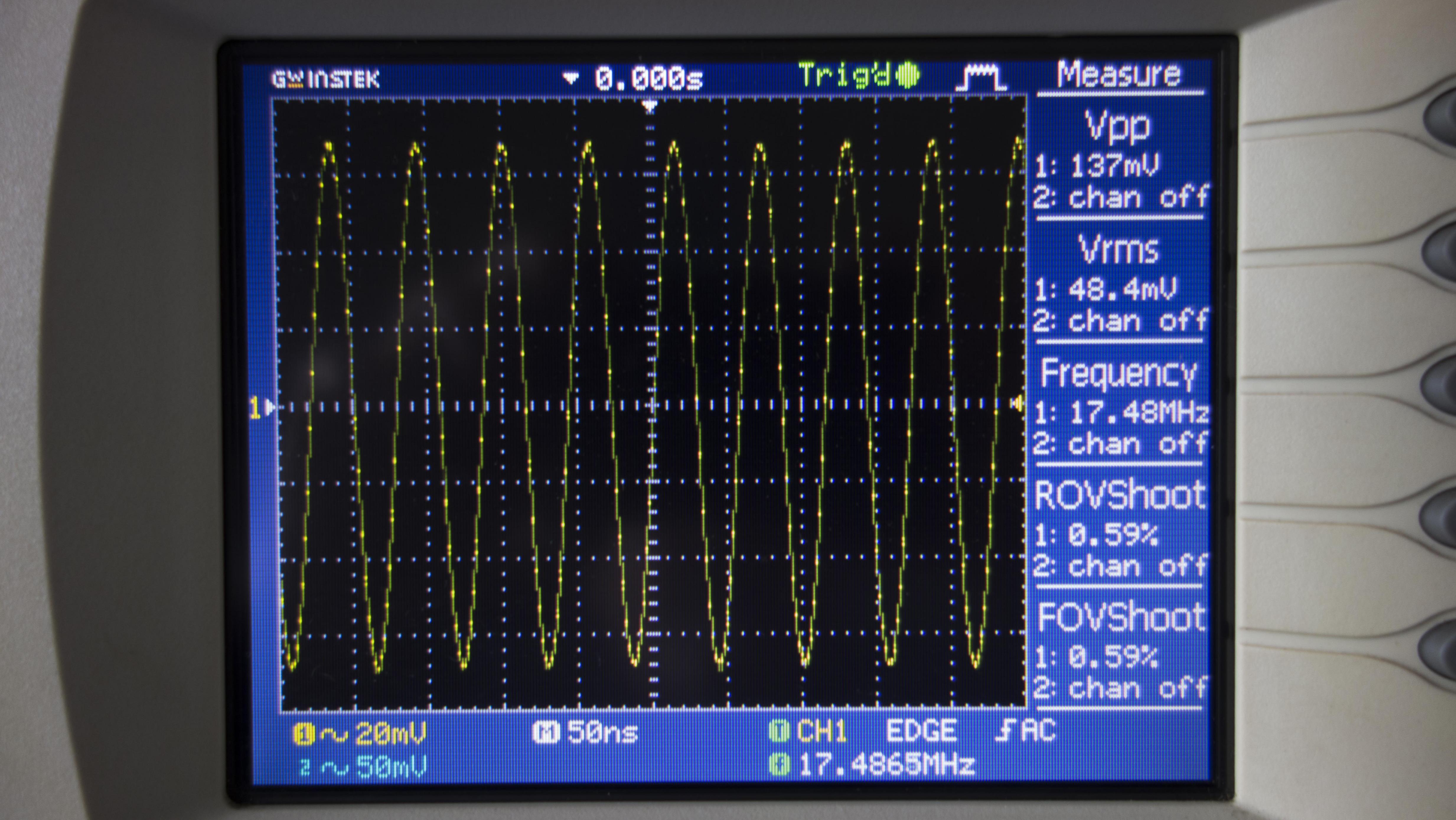

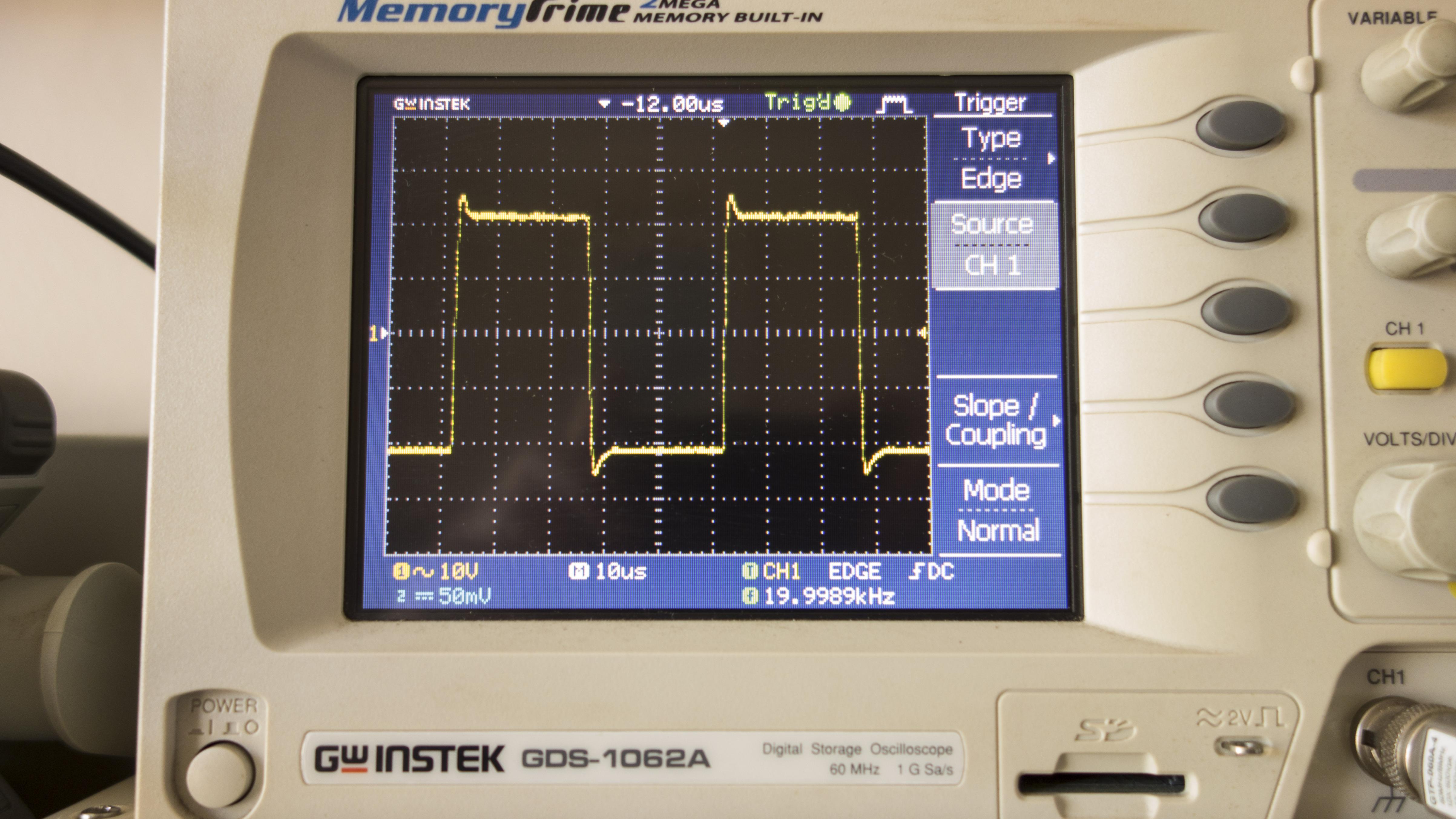

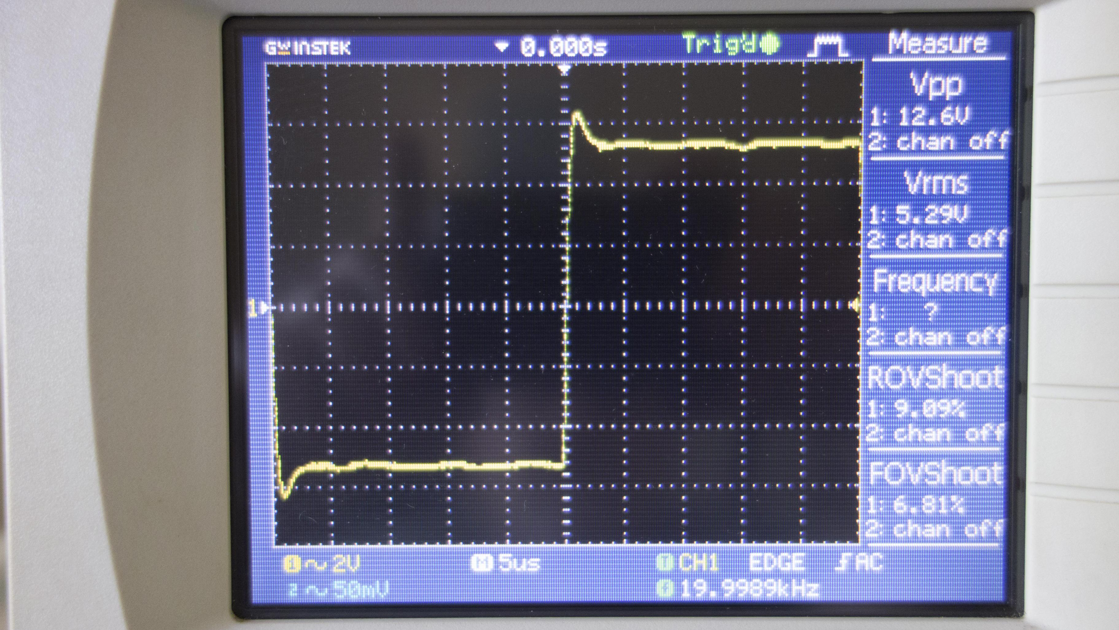

Here's one channel of my xK amplifier. Mounted on my test heatsink (0.4°C/W) and attached the 2SA/2SC output transistors. Power is from a Ripple Eater @ ± 32.5V per channel.
All measured voltages pretty much in line with the specs other than R10/R11 at ± 655 mV (vs 400 - 500 mV spec)
Square wave at 1V RMS shows some over and undershoot. Not sure if this is a problem?
Without an input signal (input shorted to earth) there's also a signal appearing at 16.5 MHz which I need to try and find out where it comes from.
Otherwise as per attached pictures.
Comments?

Hmm. You should not have that oscillation there. I’ll take a look at the output device specs - looks like that’s where there may be an issue. The 16MHz oscillation is a bit too high for it to be a feedback loop related issue. Looks more like an output stage parasitic oscillation problem.
Can you send a close-up pic of the two compensation caps you are using - if those were too low in value, you would have the problems you see with the overshoot. This looks like a loop compensation problem.

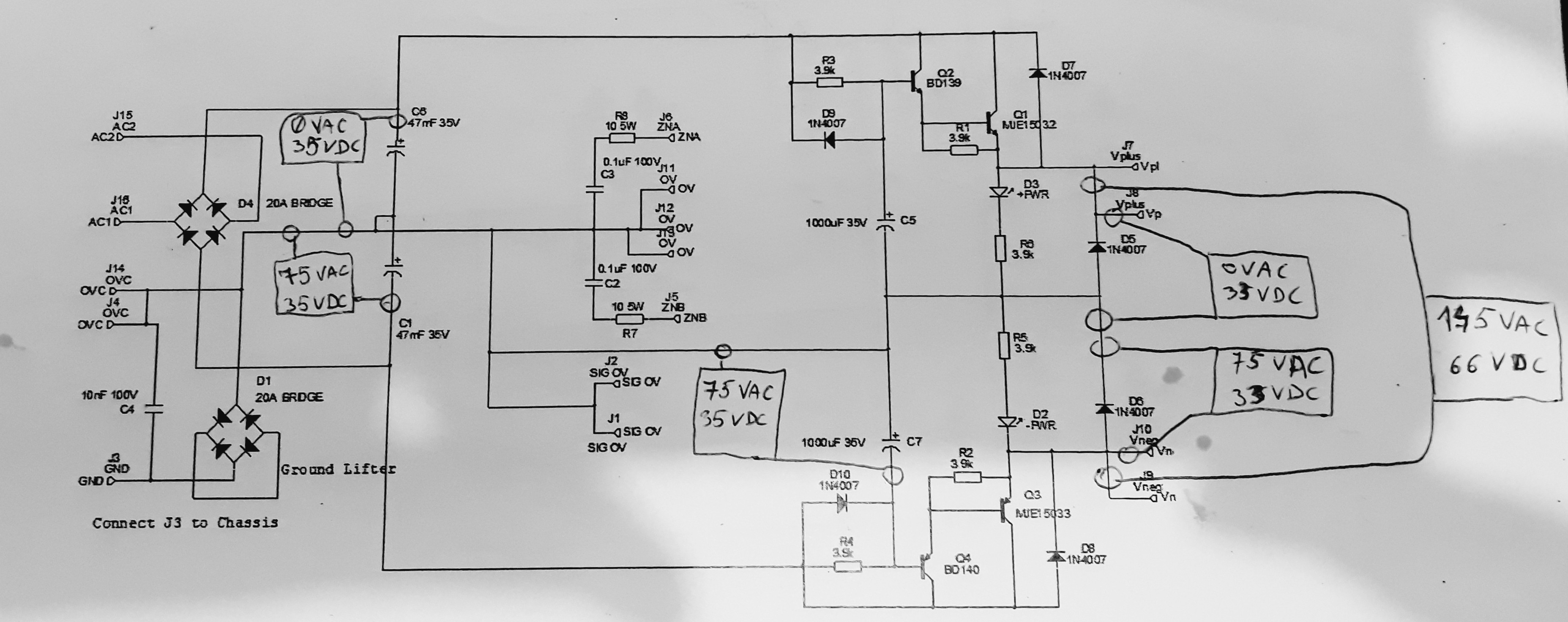

Here's measurements of ripple eater.
I desoldered c5 and c7 and checked theyr'e fine.
Measurement on image is done with inverted probes polarity, when I set to proper probe polarity measurements are the same, but on second half of RE.

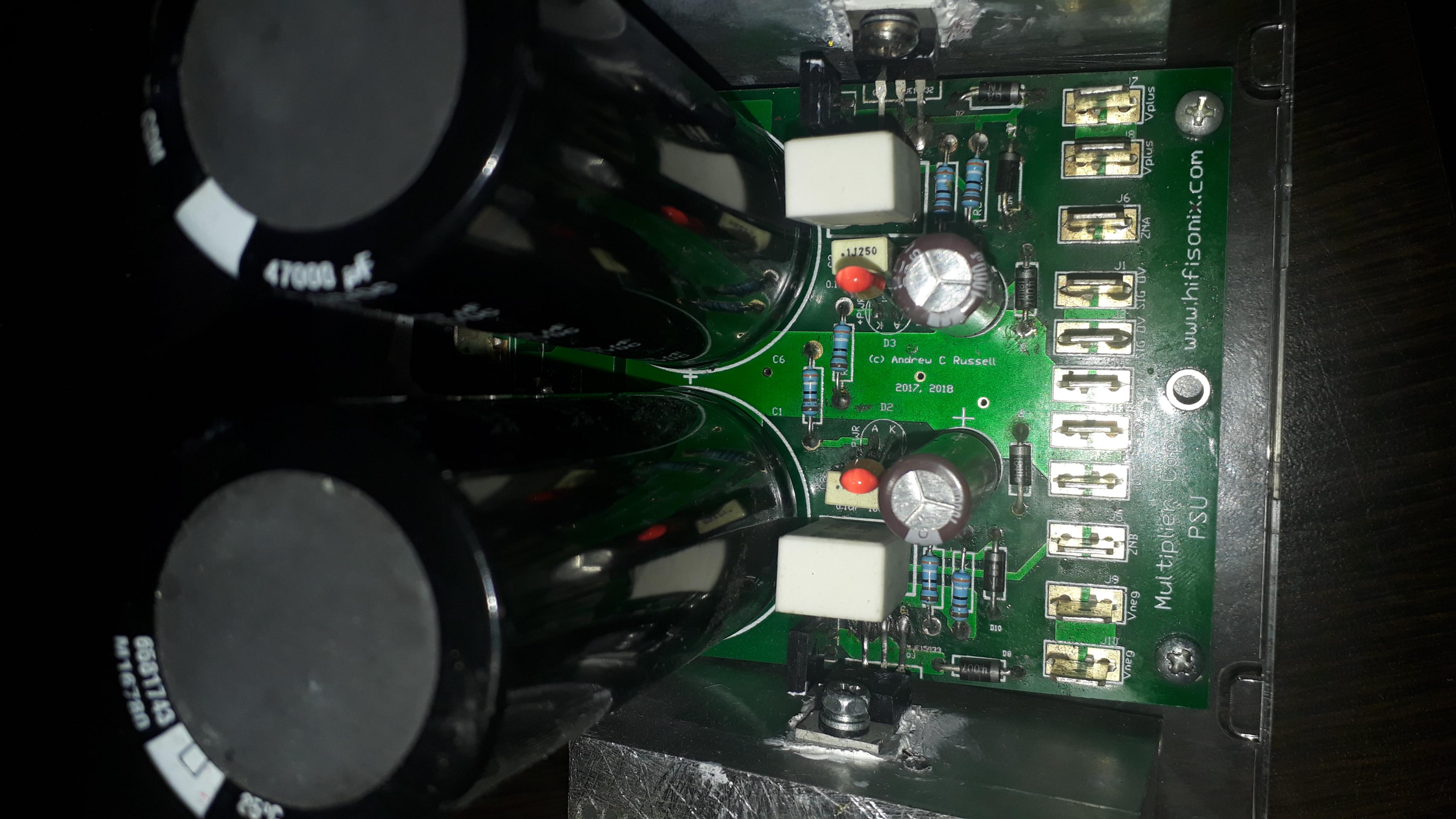

Hi again.
Thanks for patience. 'Ima special case...
You shouldn't have any AC on the output of your bridge rectifier D4 - only DC.
Therefore AFAIK:
  • The bridge rectifier is the wrong type (i.e. with different pinouts)
  • The Bridge rectifier is inserted the wrong way round.
  • The Bridge is 'blown' or otherwise faulty
  • You have 'bridged' solder joints allowing AC through
Why not post a picture of your board with top and bottom views?

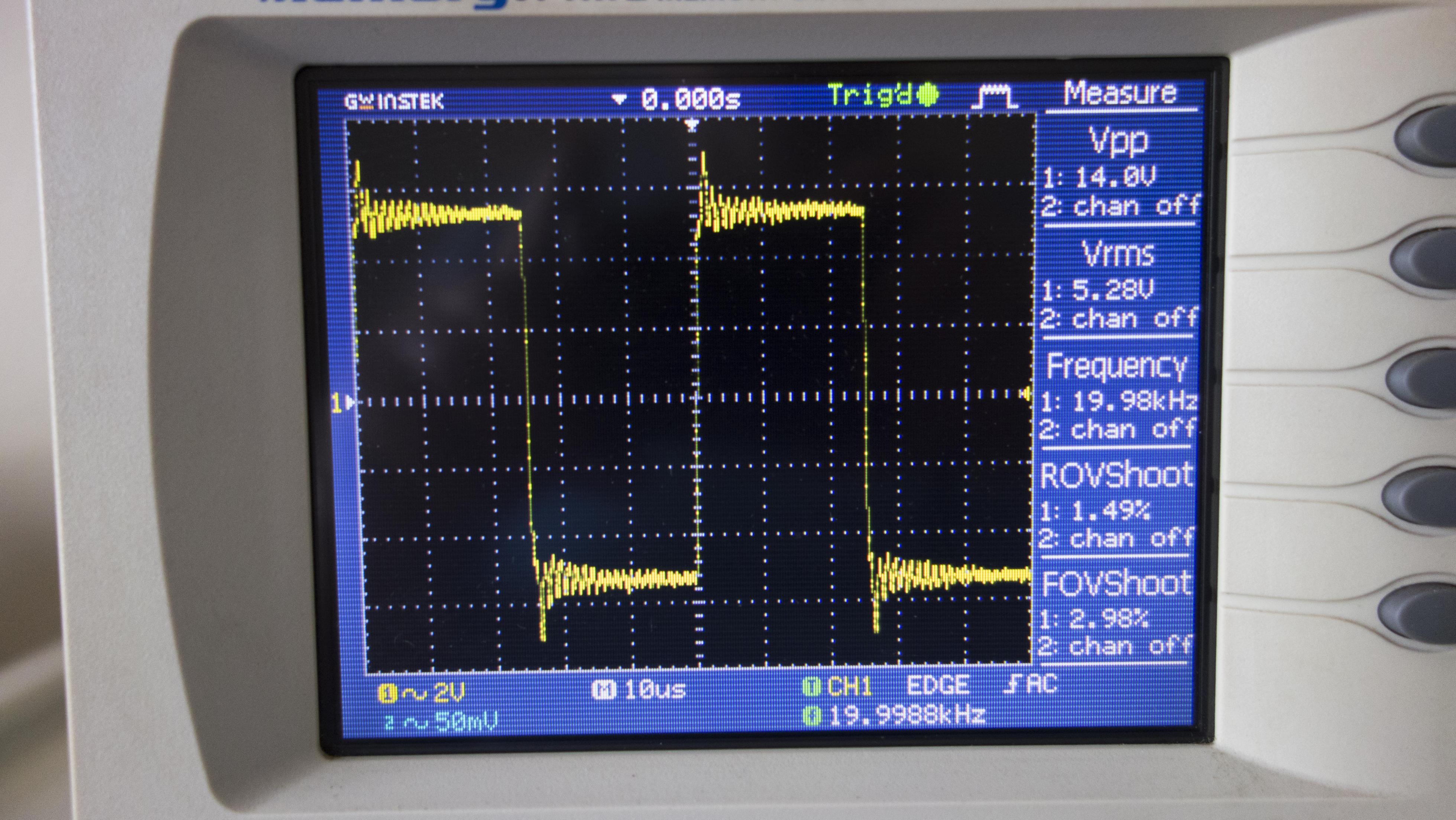

So finally the NJW trannies arrived. Installed 'on-board' to the second Amp board and fed with ±32V and input shorted the voltage 'check point's were all in spec other than R10/R11 voltages @ 566/577 mV (450 ±50 mV spec) due, presumably, to the higher supply line voltages.
The amp board was connected to a ripple eater and the zobel network connected - but no 8 Ohm output resistor.
Unfortunately the ±17 MHz spurious wave still persists as per the 2SA/2SC transistors (connected 'off-board') as previously reported. (Picture)
Applying a 250 mV RMS 20 kHz square wave results in severe ringing'/oscillation. (Picture)
Adding a 50W 8.2 Ohm 'dummy load' to the output blows the power supply fuses (5A) - both when the load is attached 'live' or when it's already attached at 'power-up'.
In the first instance (input shorted) touching the '0V' side of either the R36/R37 resistors with a DVM probe 'collapses' the 17 mHz spurious waveform.
This ± 17 mHz signal is detected at the bases of Q10/Q11 and the NJW bases but not on Q3/Q4 bases.
In the second instance, (20kHz Sq Wave) touching R36/R37 with the DVM probe makes no difference as to the ringing on the wave (that I can see). Didn't check up at 17 mHz.
BTW Connecting or disconnecting the Zobel network doesn't seem to affect the 17 MHz wave.
The spurious oscillation varies from around 16.2 to 17.5 MHz or so. Rarely seems to be the same twice.

Tony,
Apologies for the delayed response. Clearly there is some serious issue here.
I am tied up today but will come back to you later to try to help you sort it out.
As a first step, can you short out the bias generator Q7 collector to emitter and then drive the amp. You will have very bad cross-over distortion, but I want to make sure it’s not opening up for some reason and causing high currents to flow. While testing and setting up the amp, do not use the ripple eater. Only connect that in circuit one everything is running ok To do this, short out the ripple eater pass transistors.
Please recheck the values for C2, C3, C10 and R42 - if these compensation values are not correct, they will lead to problems.

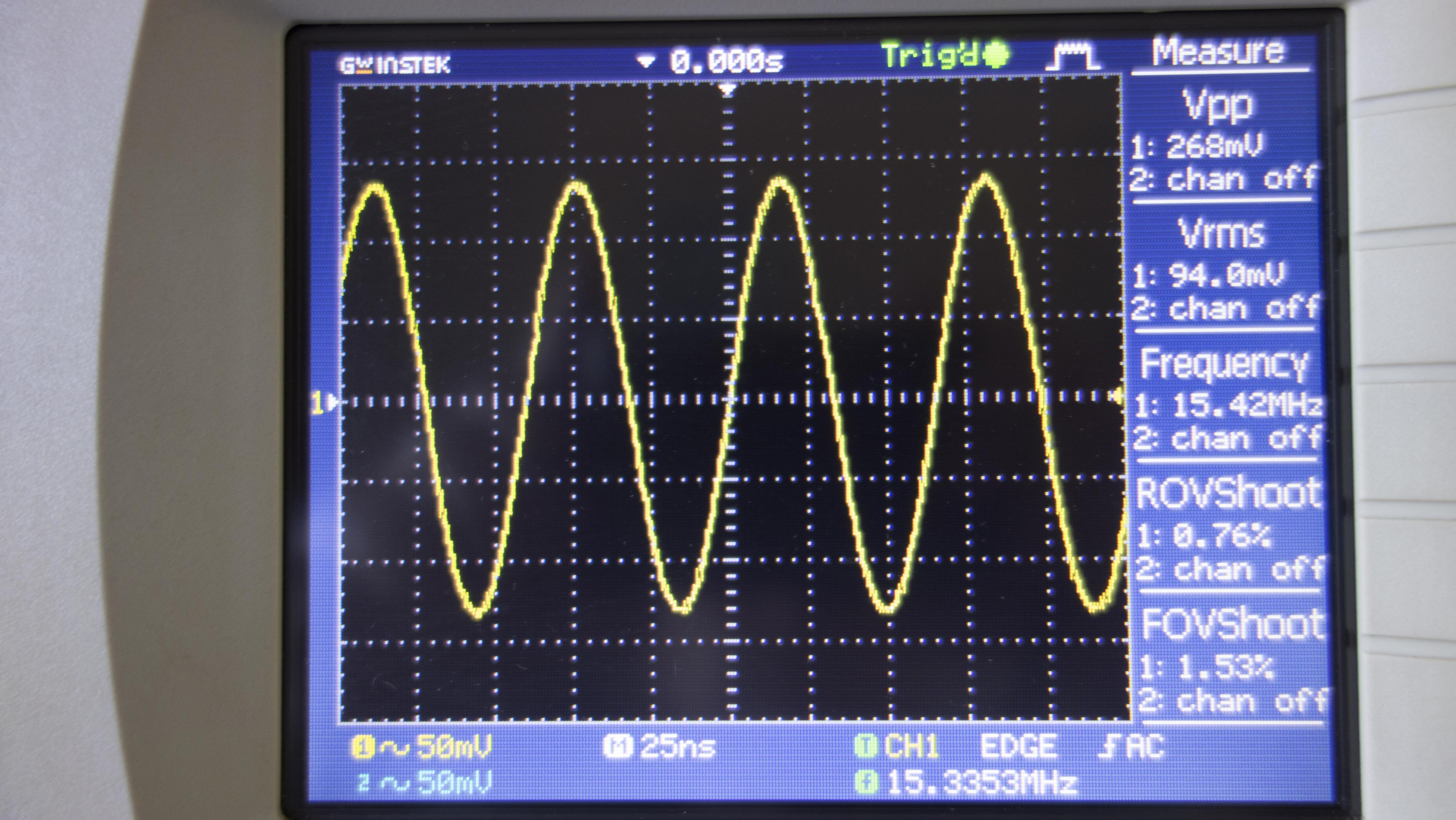

Some measurements using the Digimess power supply. Voltage doesn't set accurately and can vary (maybe the pot) but it does also have amps out which seems to work OK.
No ZN or 8R dummy load attached.
Circuit board with NJW's 'as is'
Input shorted, ±22V supply and output adjusted to <5mV
Current draw 500 mA. Spurious signal @ 15.3 mHz and 94 mV RMS output as per picture

Definite signs of instability on 1 and 20 kHz square waves but signs of over/undershoot
Sine waves at 1 & 20 kHz look 'noisy'.

1 kHz sine looks 'ok' but square wave ('normal shape' - i.e. rectangular) has overshoot
20 Khz sine wave looks 'OK', if somewhat 'noisy', square wave noisy with overshoot.

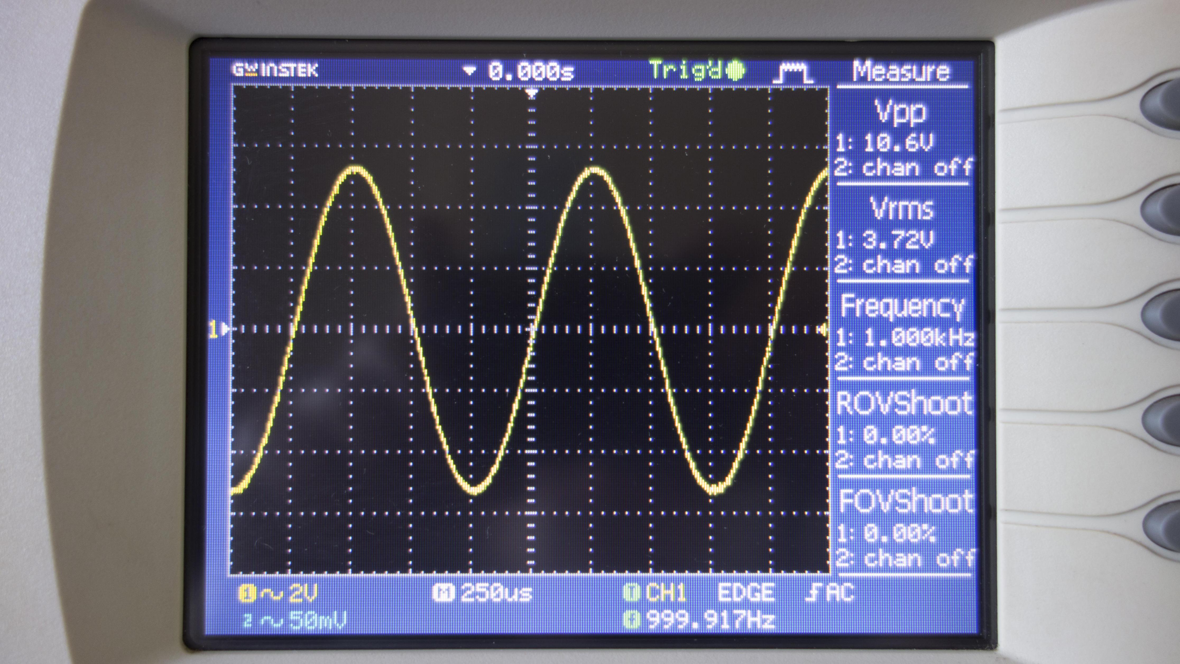

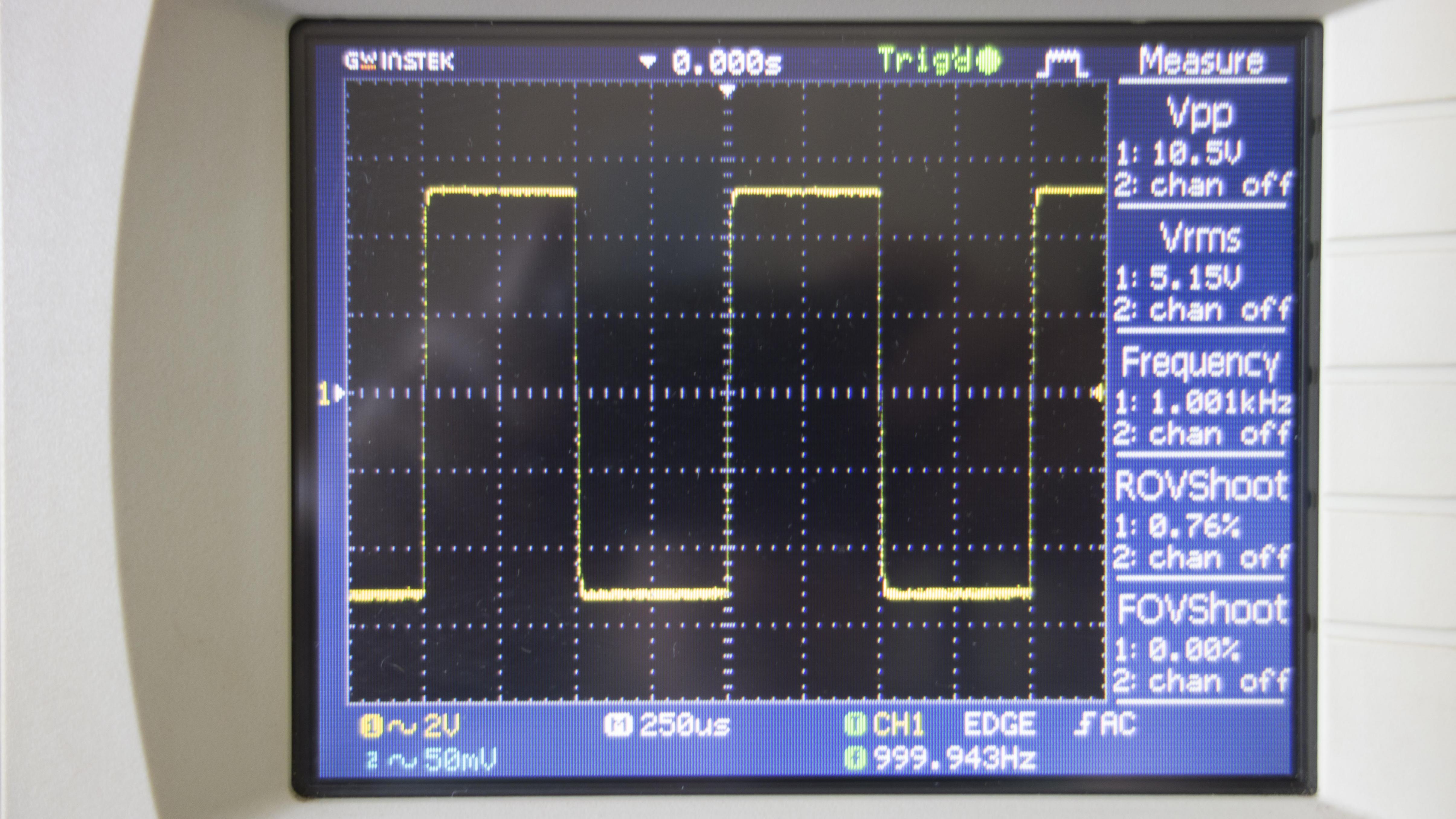

As requested:
Q3/Q4 collectors joined (i.e. Q7 C/E shorted out):
Input shorted
Current draw 20 mA (!) at ± 19.5V. No spurious signal at ± 17 mHz
250 mV signals applied:
Current Draw 30 mA at ± 23V
Sine 1 kHZ looks 'OK', Square wave has overshoot (Pictures)
Sine at 20 kHz looks 'Wobbly' as does the square wave plus overshoot (Picture)
NB: No signs of cross over distortion
I'll keep on seeing what I can find but looks like the bias circuit has a problem?

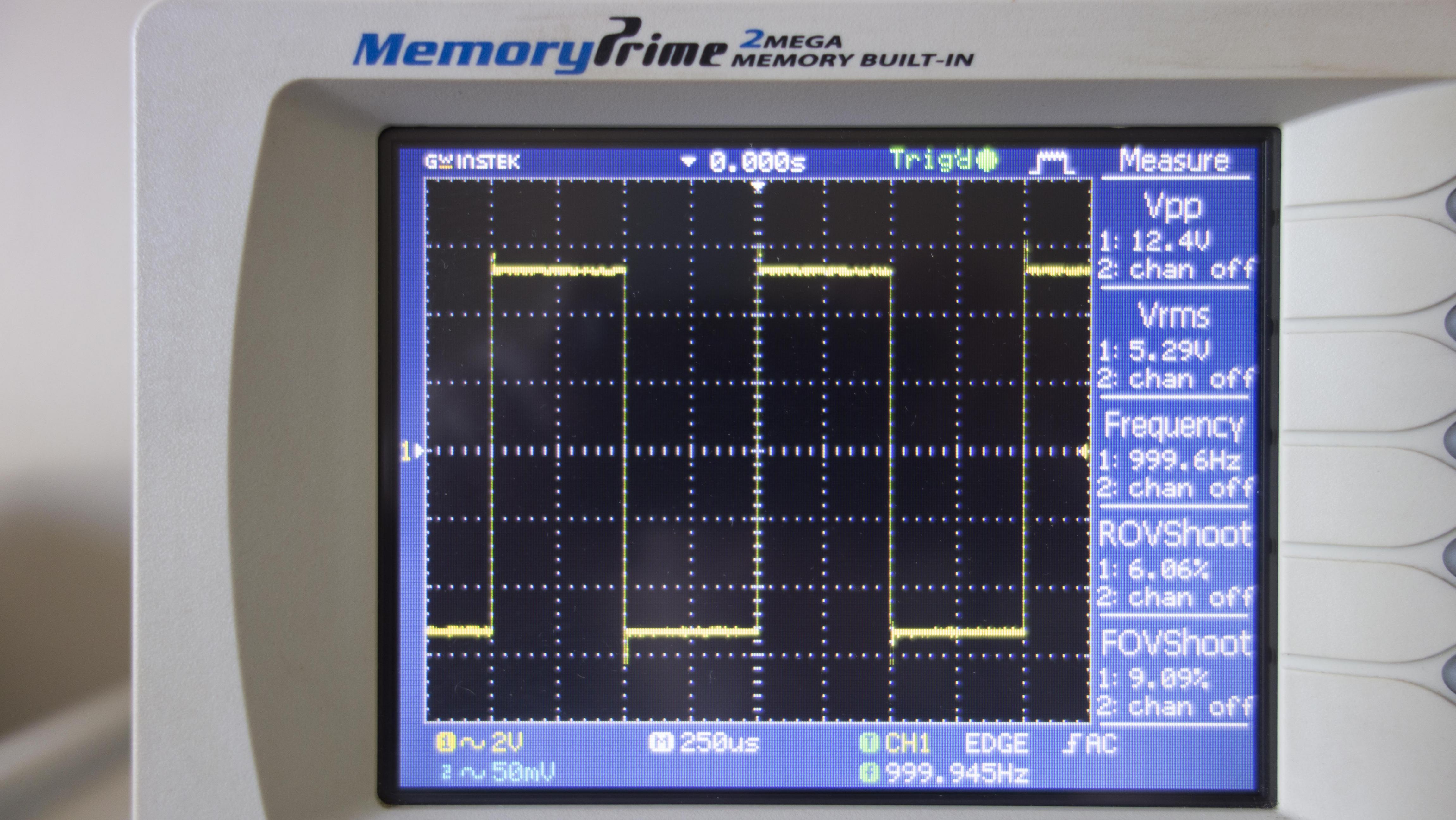

The low supply current with bias transistor Q7 shorted collector to emitter is correct. Can you check Q7 carefully - make sure it is the correct type and not inadvertently a PNP. Can you measure the voltage across the devices base - emitter junction. It should be about 0.6V

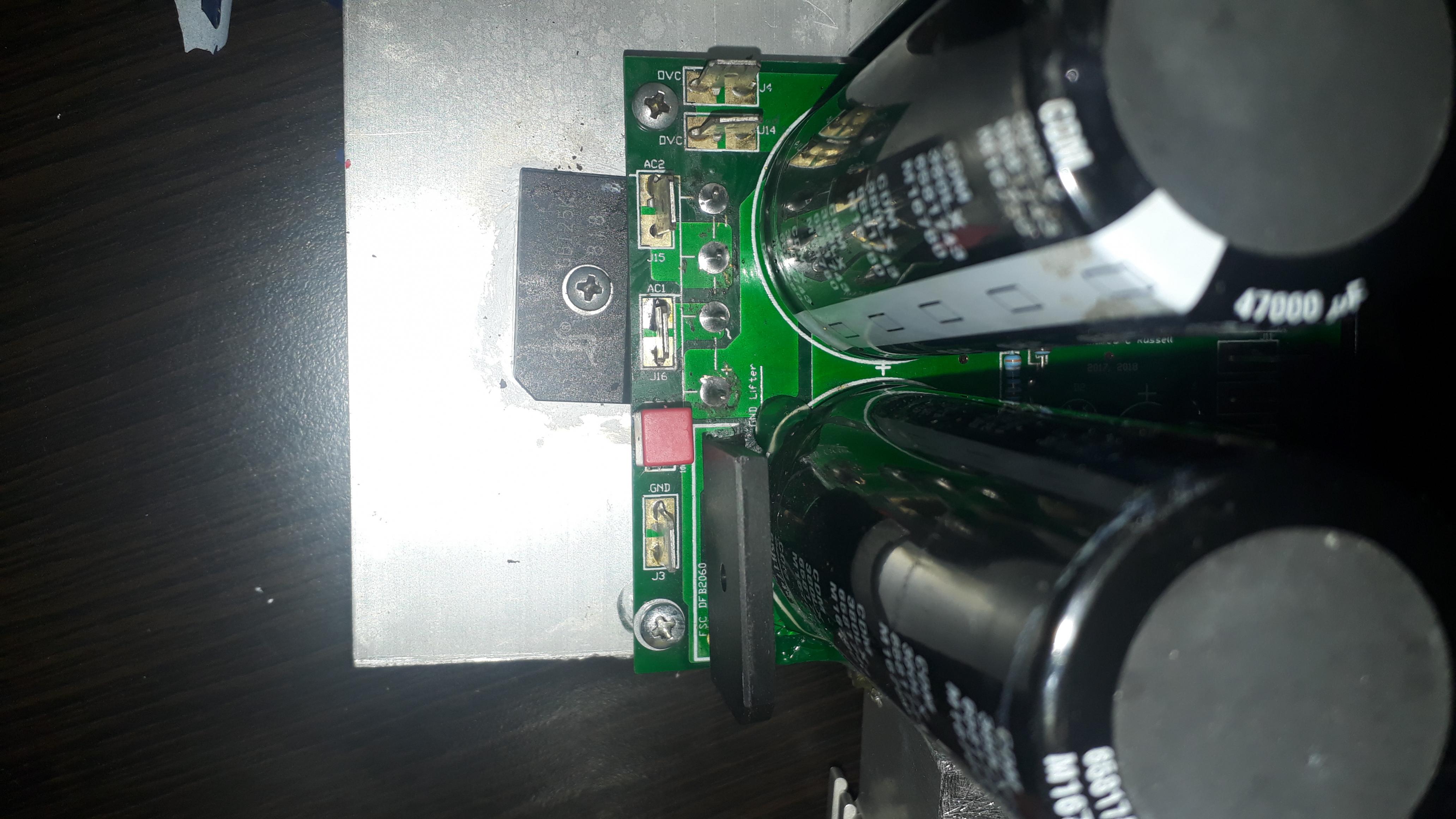

Hey. 'Smee again.
I've replaced bridge. I've left gnd lifter untouched. Still have 140v ac on vpos-vneg. Nothing changed.
Can anyone check if you have ac between these terminals?
Here are pics. But I've really looked for one hour with torch and glass to find any shorted solder, nothing found. I start to suspect c1 and c6, but those were last pair at Digikey. And pricey.
Rgrds.
Clean up your PCB first... It's a mess!
With 140VAC (!) on the output you will likely see a nice firework from the capacitors... Also there must be something terribly wrong and building a sort of a voltage multiplier... Are you shure your DMM isn't broken or the battery is low?
