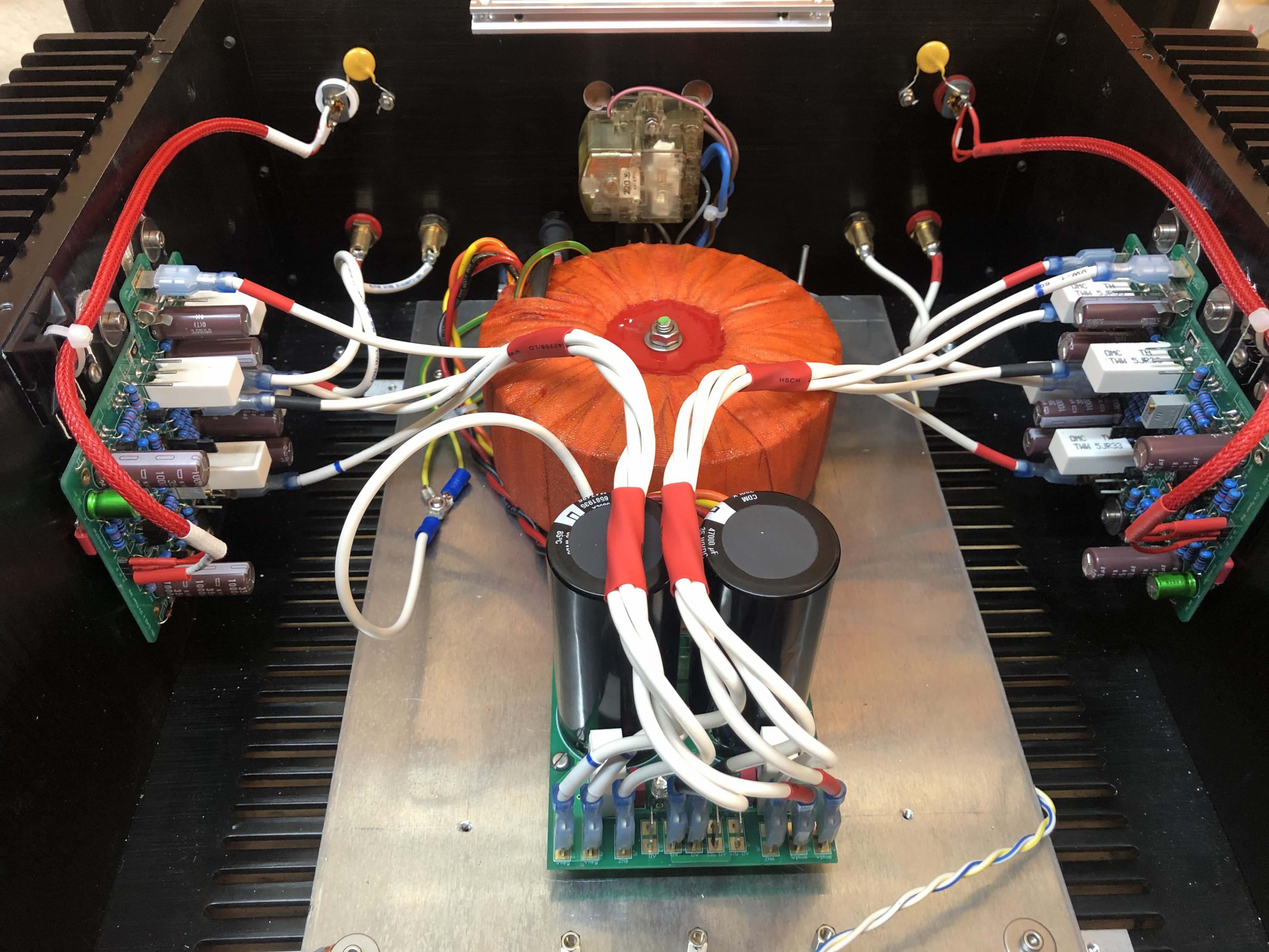

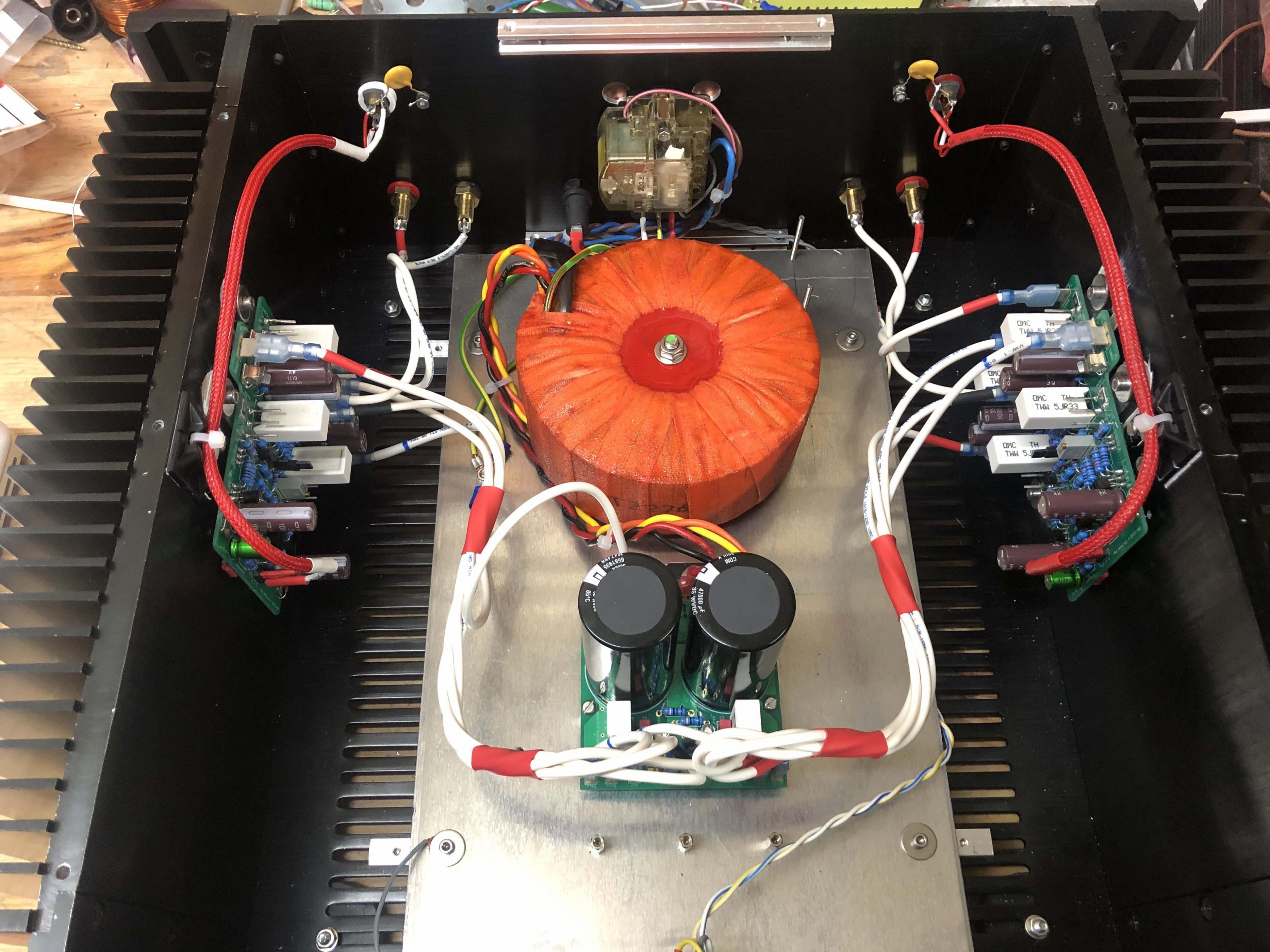

At first run of the amplifier (after individual trials of each boards with lab power supply), I got a little bzzz with the two channels inputs connected (no noise at all with inputs disconnected or shorted). The noise was small (I can only hear it by putting my head close to the loudspeaker).
After dressing of the main cables to the boards: no noise at all (2705 pic)

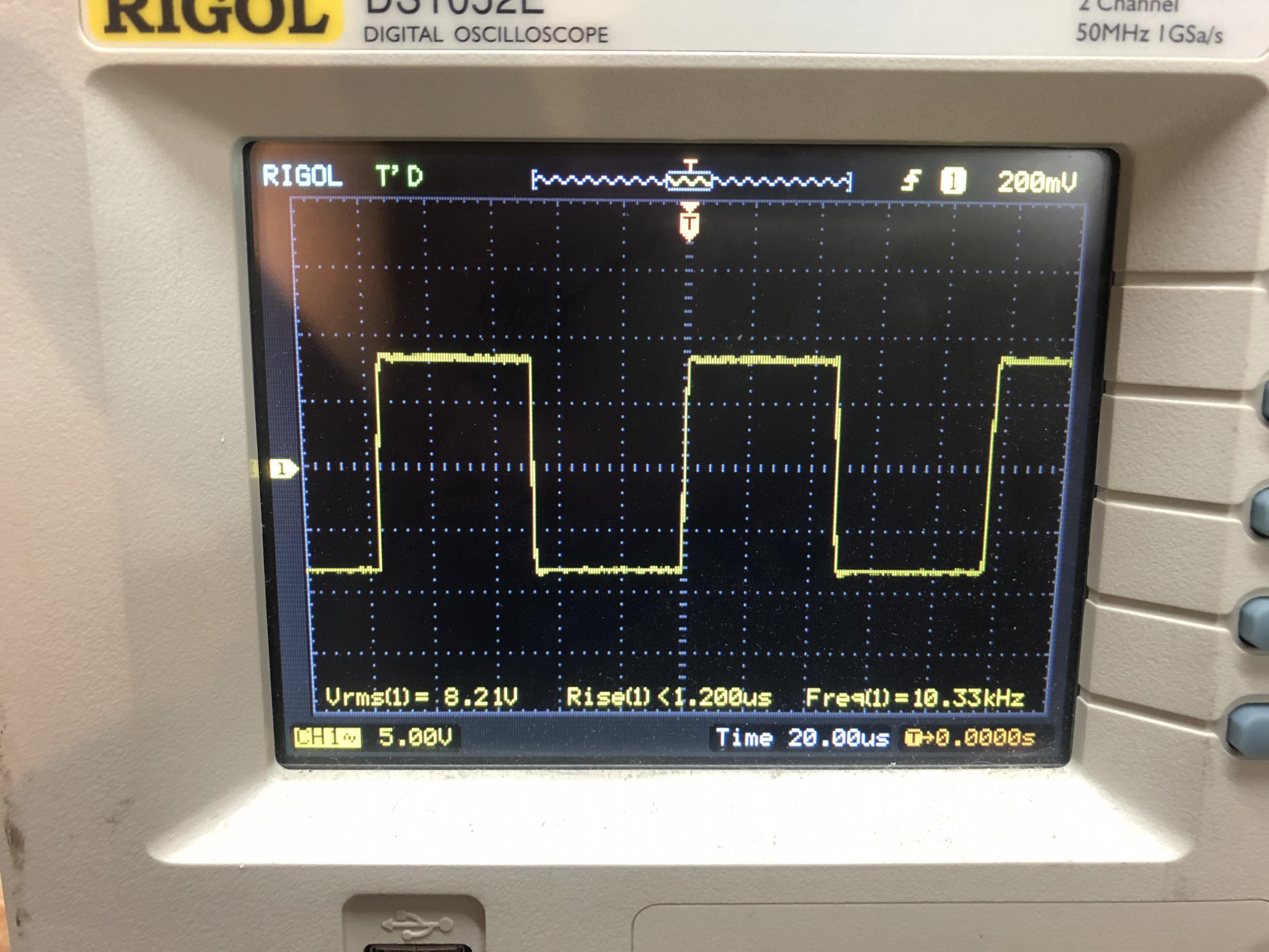

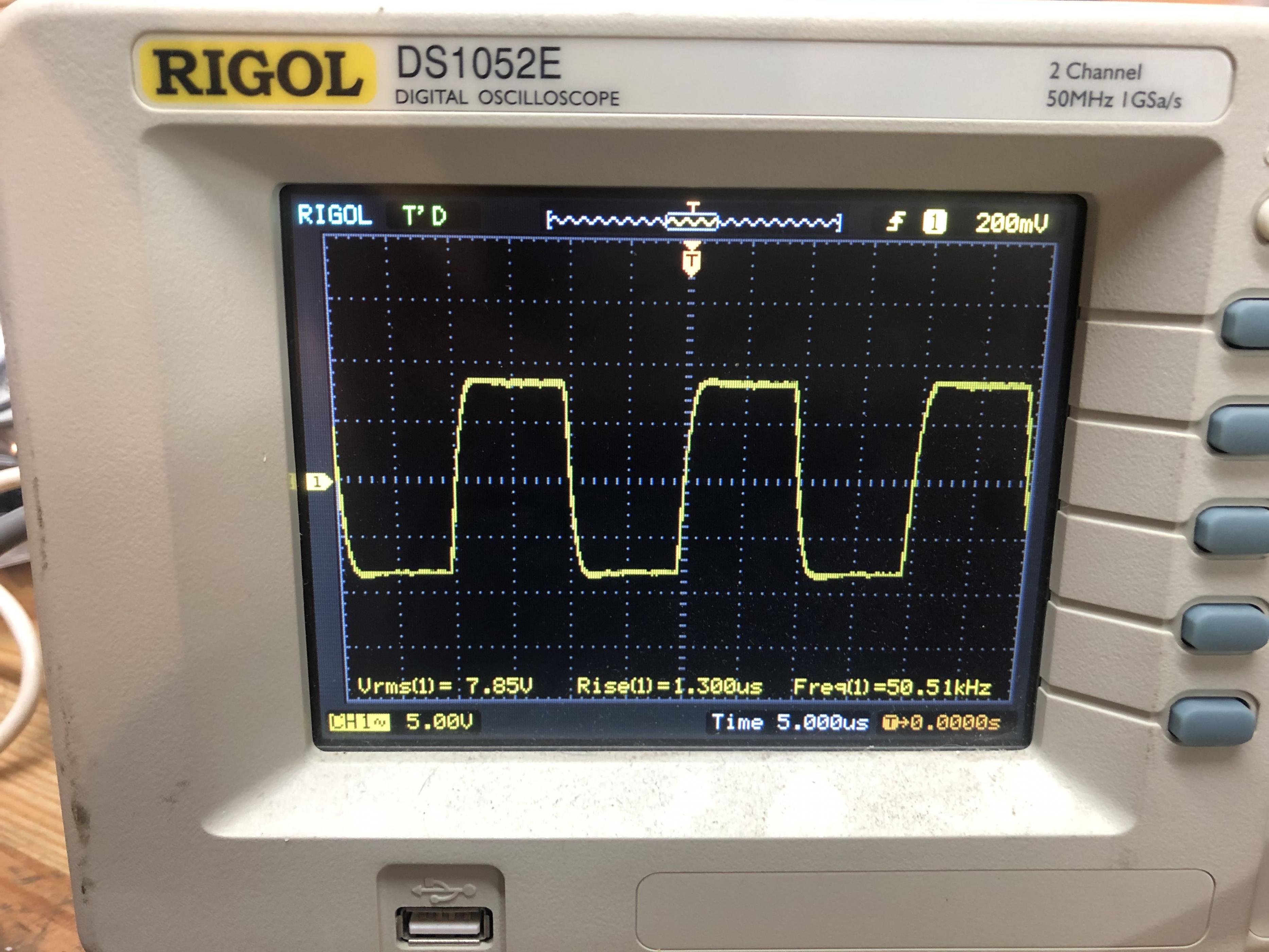

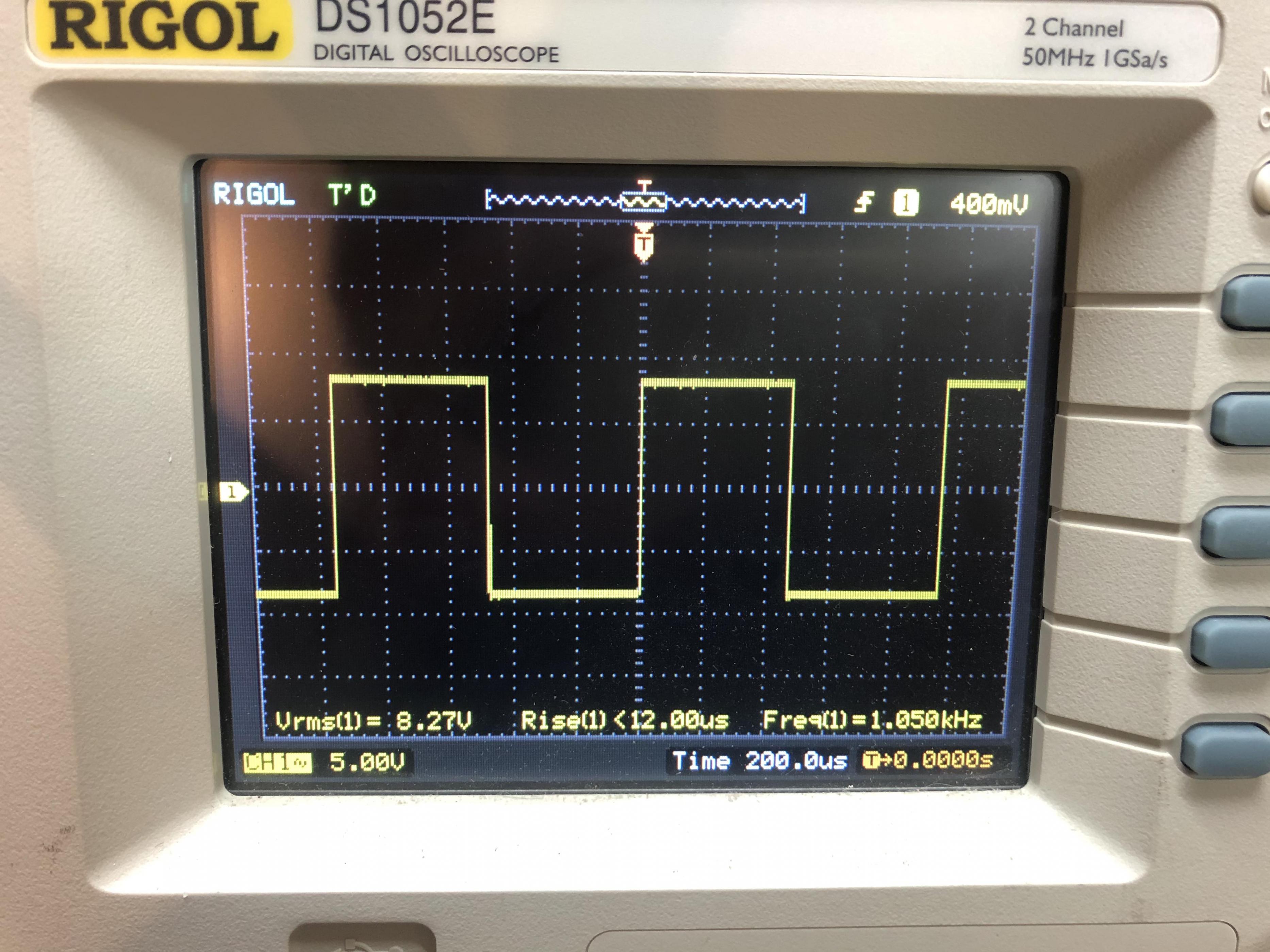

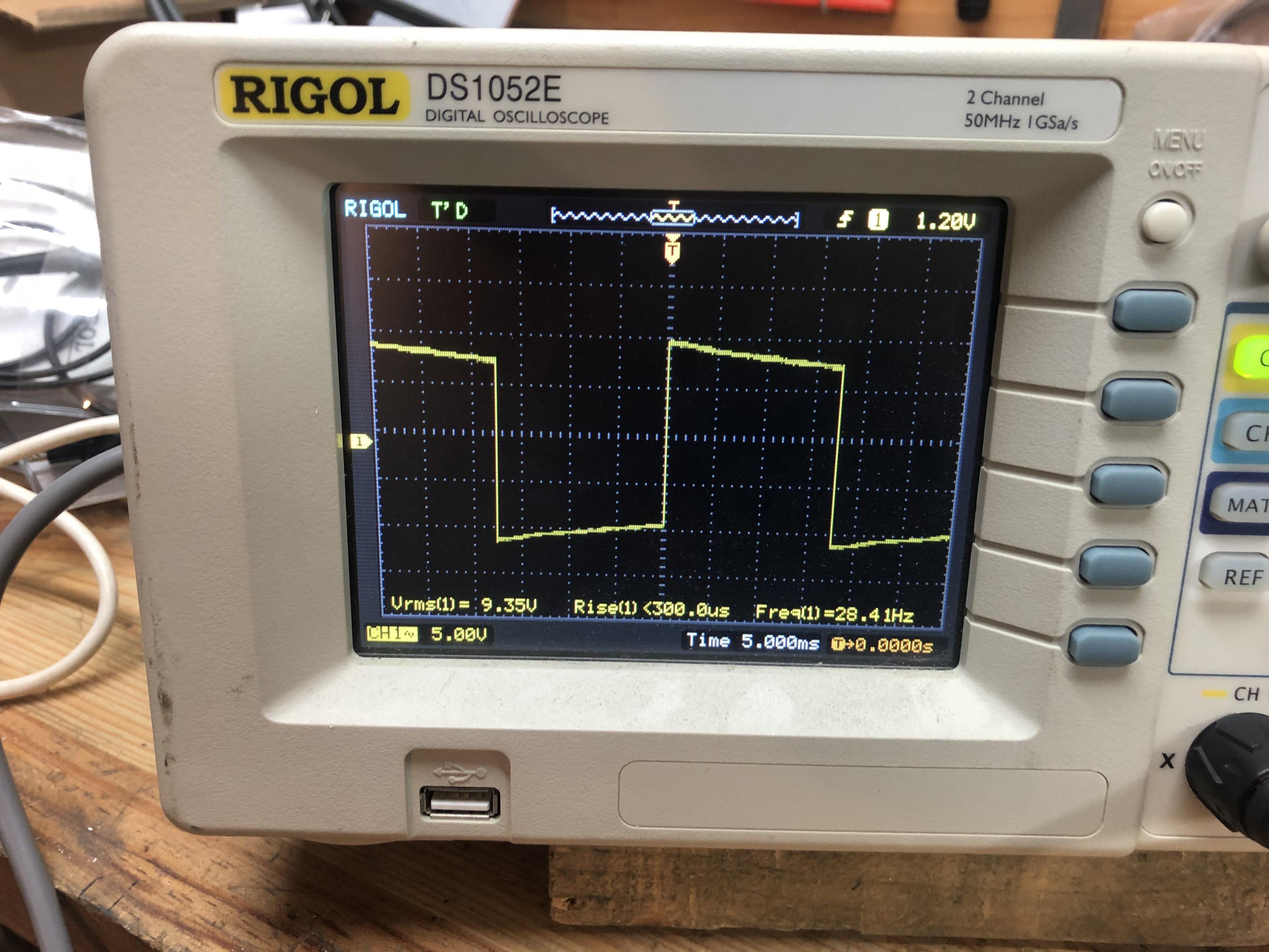

I have also pics of the 1k, 10k and 50k square wave

Square wave 8V 1kHz
Square wave 8V 10 kHz
Square wave 8V 50khz
Square wave 8V 30hz

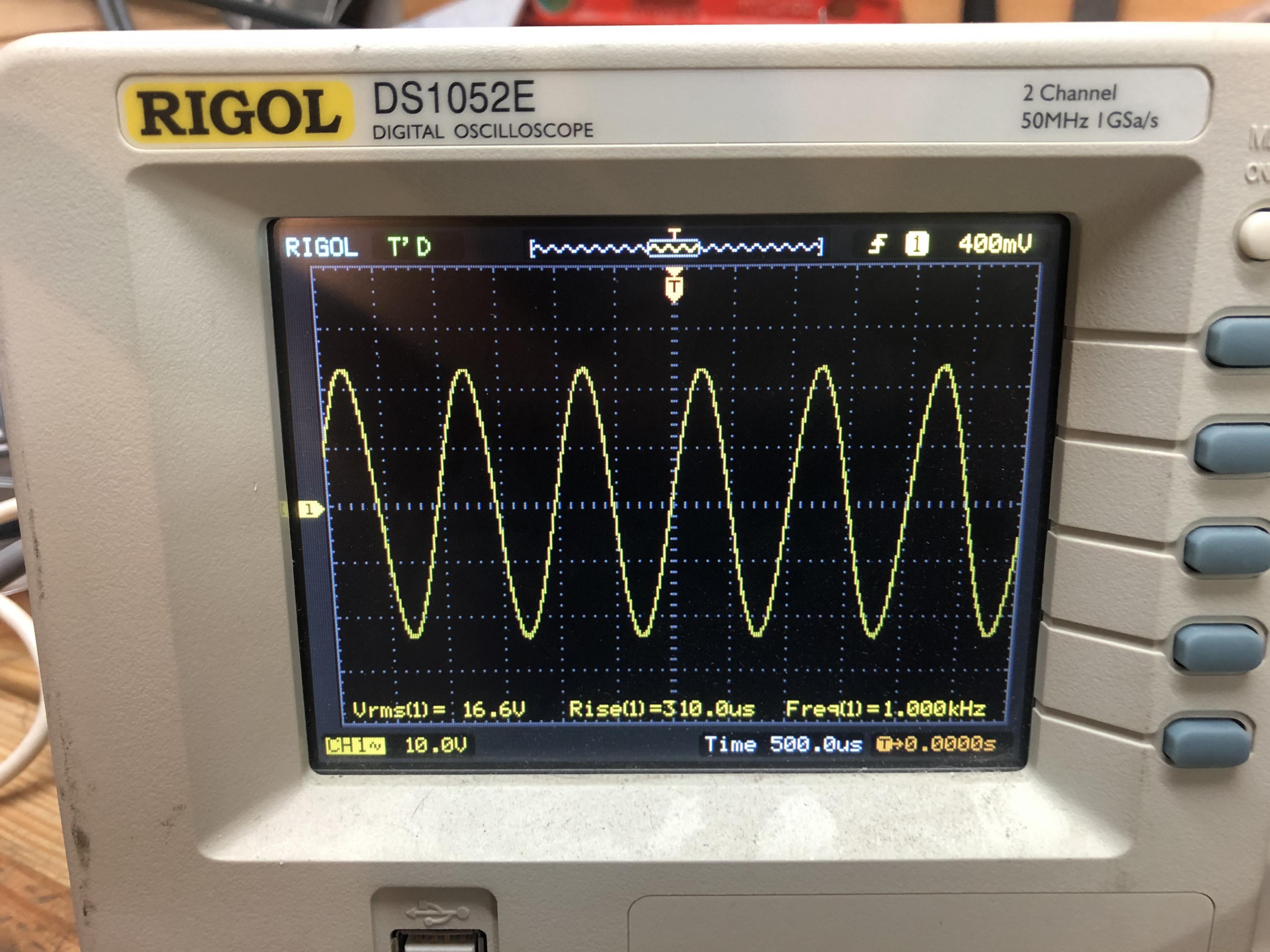

Sine wave just before clipping 16,6V rms
All measurements into 8 ohm dummy load

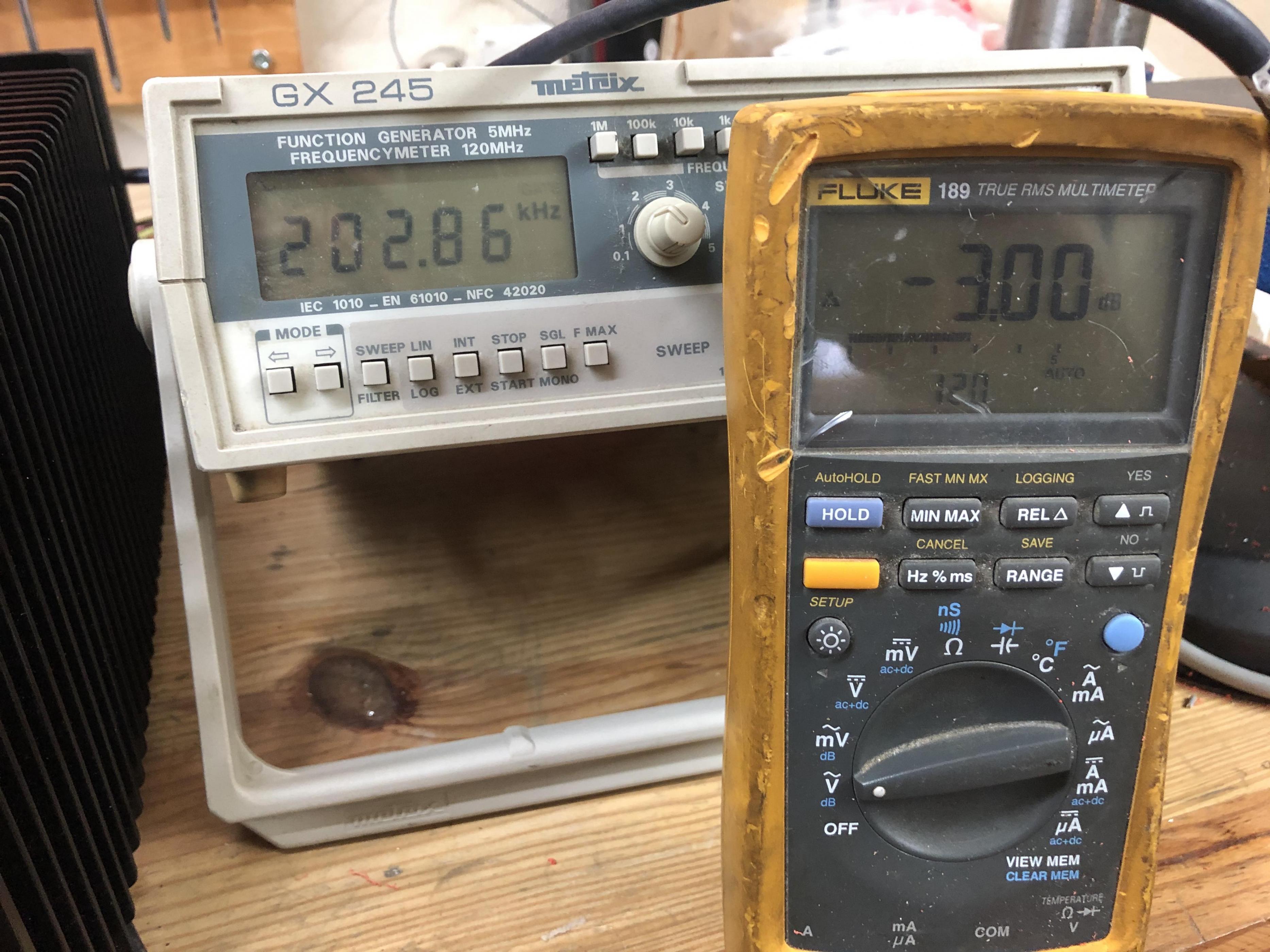

@Anand
It's easy with Fluke db features. So the process was:
amplifier on dummy load 8ohm
1hkz sine wave input to have a few volt on load
Set the fluke on db
Set reference value (db rel)--->0 db rel (at 1 kHz)
Don't move level on generator and increase frequency up to -3db on load
You can see the pic: -3db at 202khz

To be more accurate, you must inspect generator level output during test.
Not all generators are stable level output when frequency vary.
True and it depends on the load. But most generators should handle the bandwidth of this amp I hope. 1MHZ would be decent.
Best to have a second RMS multimeter attached to the generator output to verify the voltage hasn’t dropped.
Which is why I use a scope with BODE plot capabilities and track input and output waveforms.
