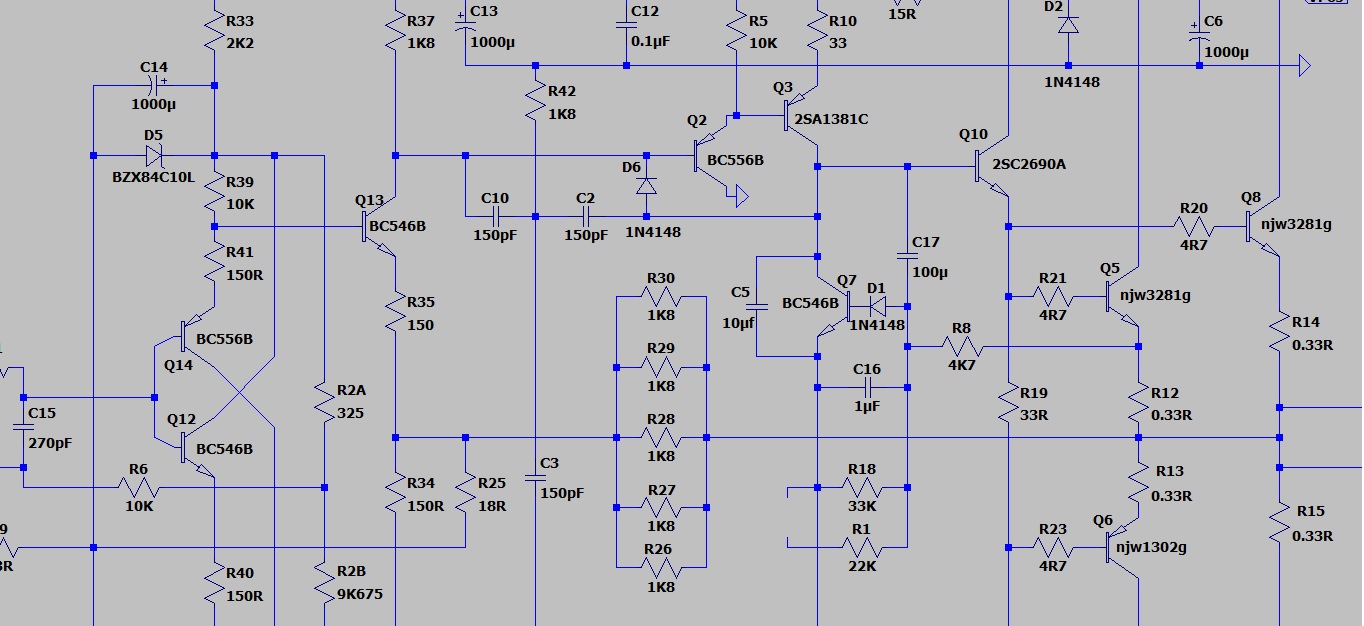

From stability simulation I got some idea to try and play with increasing R42 too.
I tried 8k in sim which gave some peaking, but better phase margin. Oscillation seems to be in the area with less than 20dB OLG and not great phase margin. However my sim differs from yours, I get higher gain, and lower bandwith in my sim. Anyway, it gives me some idea on what I can tweak.
Maybe I'll even try removing R42 completely if nothing else helps, -going single pole, that seems to give great stability margins (with other trade-offs of course).

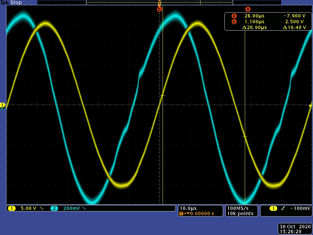

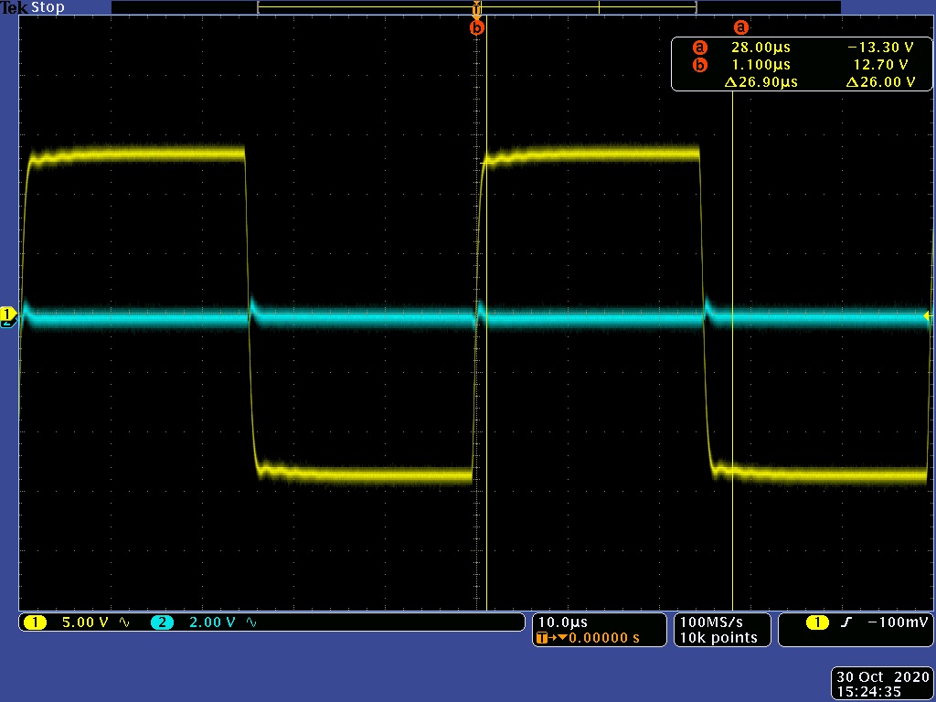

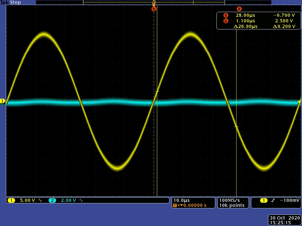

I made some measurements, and things are looking better I think. I'm surprised to see the high emitter current spikes on the flanks of the square wave. I never measured that before, so I have no reference. There is some asymmetry on the emitter currents as seen on the sine.
Yellow trace is Vout, and blue trace is diff probe on emitter resistor(s). If you read the file name Vetoe is voltage over two emitter resistors(emitter to emitter), and VetoVout is over one emitter resistor.

Just so I understand
Pic 1 and pic 2 are sine wave into resistive load (they look the same to me)?
Pic 3 - I expect some current overshoot and fast rise rise times because you are charging and then discharging the Zobel which at HF is 2x the LF current. You will not ever see this with a music signal since the rise/fall times are 10us or thereabouts. I assume your Zobel is 10 ohms and 0.1 uF.
Pic 3 ?
Pic 5 and pic 3. You are seeing HF ringing on the waveform tops, again unlikely you will ever see this with a music signal, but it is a good test of the quality of your PSU, cabling and local decoupling. You have quite a bit of inductance in your power cabling and the 1000uF decoupling caps have ESR and EL (same inside your lab PSU as well BTW) that will be contributing to this. You could try soldering a 0.1 to 1uF SMD ceramic cap across the 1000uF caps under the board. With the actual PSU this problem should not be present - driving <1us ruse times at high power is a brutal test for the amp+Lab PSU combo.
1&2 7ohm load but voltages over different emitter resistors (upper & lower)
3 Ok, I never lookaed at this before, so I had no reference, was only a bit surprised to see such high current peaks at the transitions (I'm learning here 🙂 )
5 I would say is the shoot-through current seen on the small blips on the blue trace.
Just some basic tests to see that it looks ok. Lab supply actually seems very stable in these tests until current limit is reached. If I lower the frequency, the current limit kicks in on the current peaks.

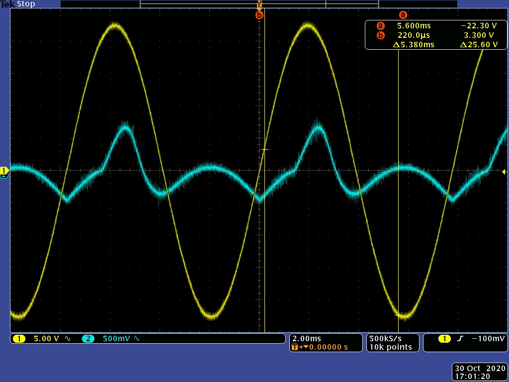

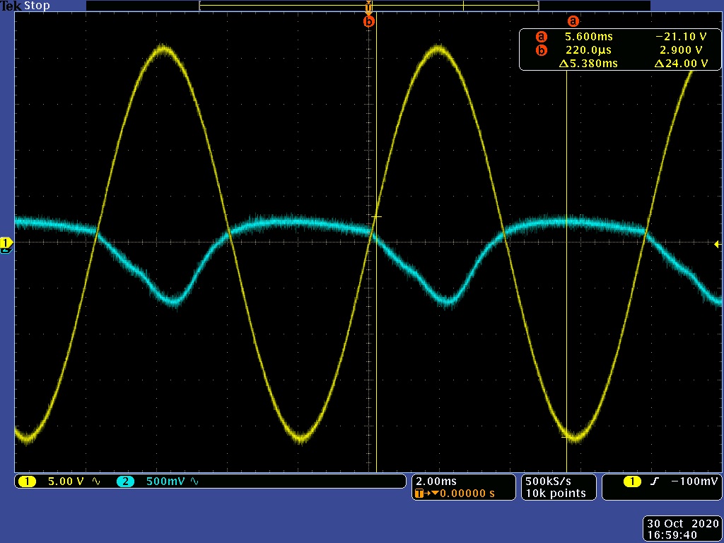

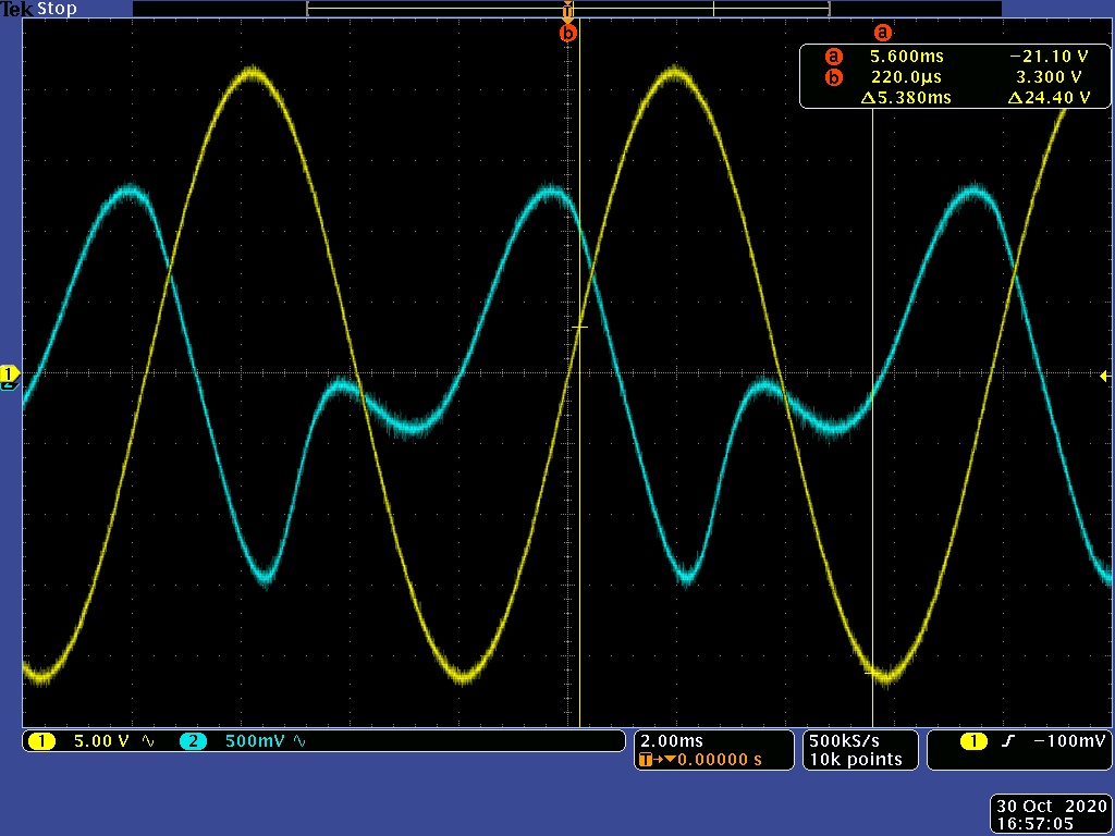

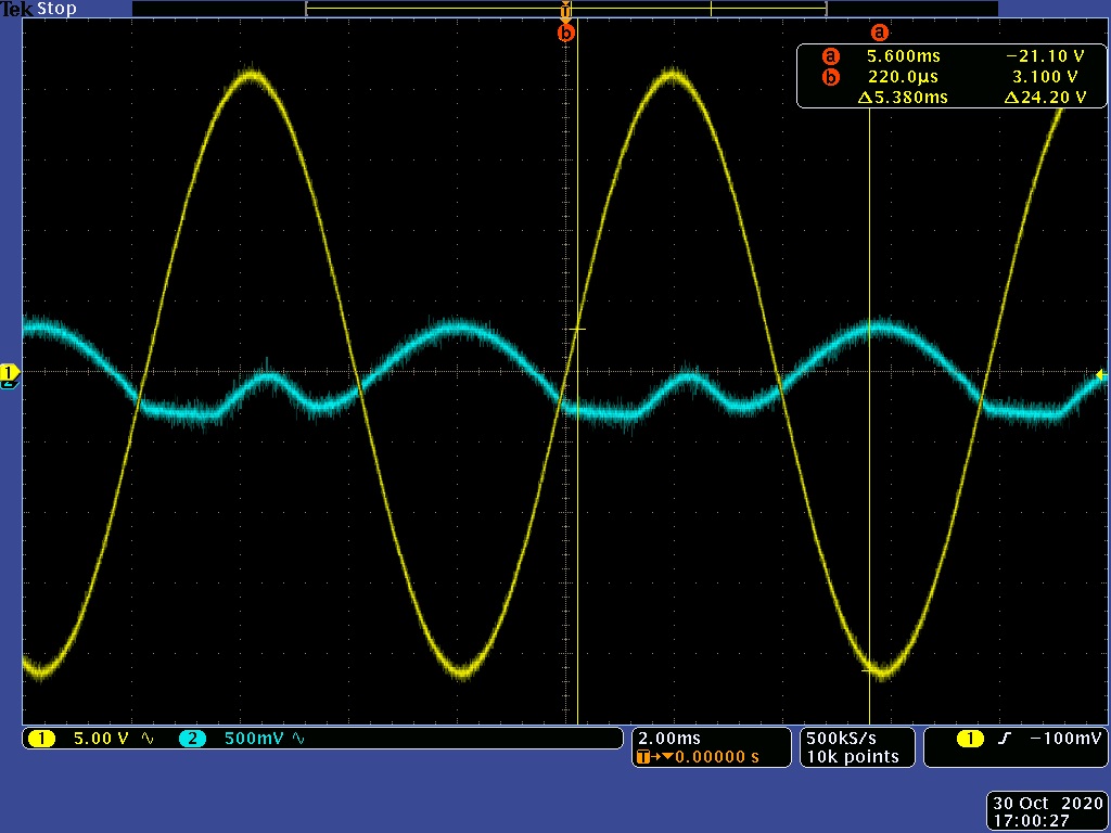

So, I wanted to test the simulated current sharing I posted before. Here the amp is driven harder into class B, still in low bias mode. I changed to a switched 26V supply that can deliver enough current. Load is 7ohm resistor. Input is 120Hz sine. Yellow trace is Vout, blue is the diff probe placed in different locations (see file name for picture for description).
Blue trace:
1 voltage over Q7
2 voltage over one emitter resistor (cant remember if it's upper or lower)
3 voltage over opposite emitter resistor
4 voltage over both emitter resistors (one upper and one lower)
I did not keep track of the polarity of the diff probe.. sorry..
This seems a bit similar to my simulation. I hope you can have a look at this. I played around with a 10-100u cap from D1 to Q7 collector in sim, and that seems to even it up, but I have not tried it on the bench.
There definitely seems to be something going on with the bias circuit with current in R12, and possibly due to some voltage drop over R21 too?

I've just checked my sims. If I look at the current through just one of the 0.33 Ohms resistors, I get a clean sine wave.
If I look at the current across two of the resistors as in eg across R14 and R15, I get exactly the same current waveform you are showing.
Your amplifier is working correctly. I should have plotted the total current across two resistors in my write-up, but never thought about this so thanks for raising it. I will come back with a full explanation after I have studied it a bit.

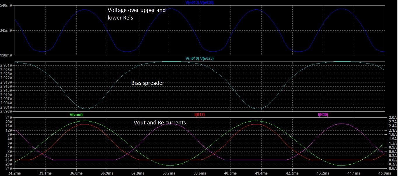

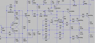

Are you running the sim at abt full power (far into class B)? Try to look at the bias spreader voltage in this situation, like pic1. From what I know it should ideally be constant (only vary slightly to regulate DC current), but here it seems to be modulated by the output current. Only slightly modulated when working in class A, but heavily modulated when going to class B. I think this means the total current from rail to tail will be 'pumping' with the varying bias voltage.
Putting the cap as I mentioned, I figured it could be 'dc coupled' to sense the DC current from the emitter resistor as I think you intended, but not modulated by AC current in the resistor (more like a normal bias spreader at AC). For some reason my sim sometimes got into slow motion depending on the cap value I entered, so I lost my patience with it. I think it got worse at LF too, so I was running the sim at 10Hz.

I'm sorry, I think I was looking at it the wrong way, the 'Vbe-loop' for the bias circuit is the lower half, so both upper and lower Re voltage drops are in the loop, right?
I'm no expert, it only behaves a bit odd. All that extra 'work' done by the outputs and odd currents circulating would probably cause some extra distortion at high output?
Here is a sim example of another high bias AB with standard bias spreader, this is what I would expect. Some minor modulation of bias voltage, but not much.¨
Edit: more traces on the graph

I went back to my simulation on the added cap (C17), and it did not look too good after all. The currents look good, but when I send a burst of 10 cycles at 20Hz to the amp, the cap slowly discharges during the burst, and when the burst stops, there is a dc offset at the output until the cap is charged again. 🙁
EDIT: I tried the same without the cap, and get a DC offset after the burst too.. maybe input cap or something doing this.
