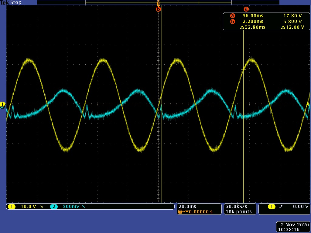

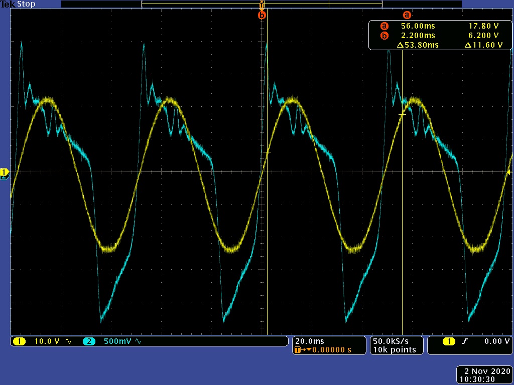

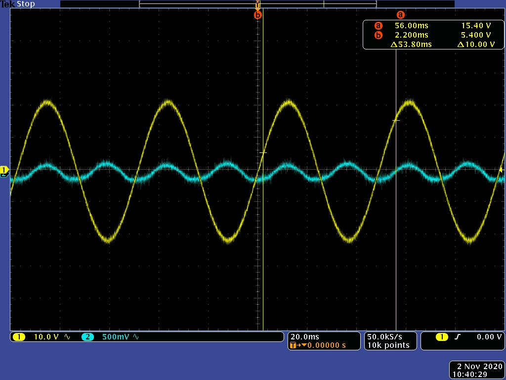

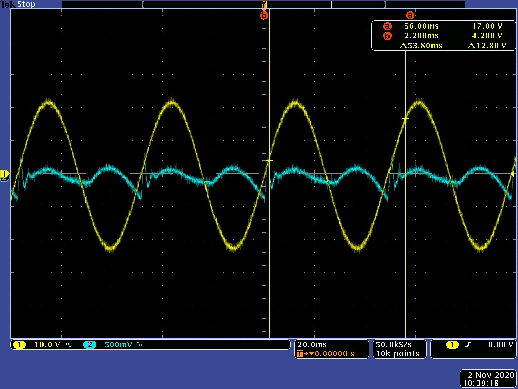

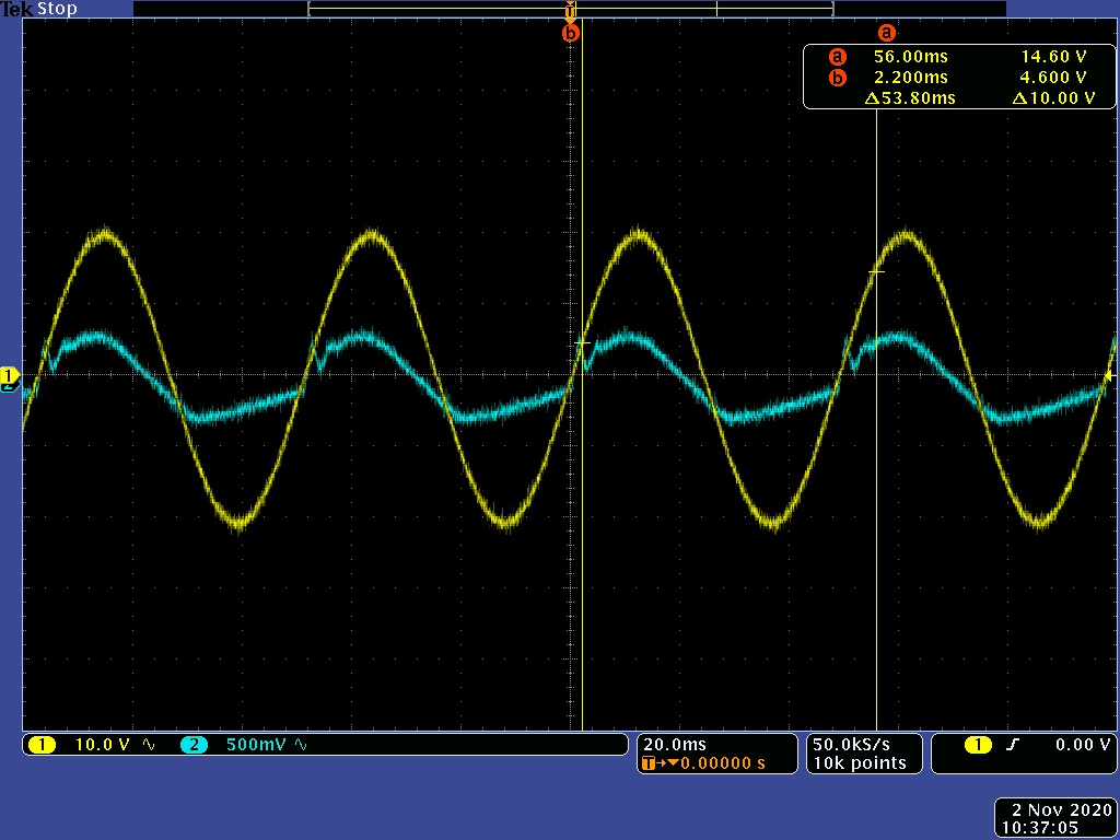

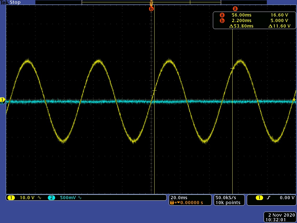

I decided to try a C17 cap and measure it. I just took what I had and it happened to be a 220u. I fed it with 20Hz a little below clipping (26V supply).
If you hover with the pointer over the pictures you can see the description in the file name.
I feel better using C17, but I will probably measure distortion with and without it later just to verify.
The yellow trace is always Vout.
Blue trace(diff probe):
Pic1 Bias voltage without C17
Pic2 Bias voltage with 220u C17
Pic3 Upper Re without C17
Pic4 Lower Re without C17
Pic5 Emitter to emitter voltage (upper and lower emitter resistors) without C17
Pic6 Same as above but with C17
I am assuming all of these pics are with the amp in class A.
It is definitely smoother with C17. If you are happy with It, then I’d just go for it. This is DIY 😉
In sims the distortion is unaffected by adding it, so it will be good to see what you get practically.
No, this in 'low bias mode' because of limited heat sink I have on my desk. I guess I could do some short test in high bias mode too, and let it cool in between.

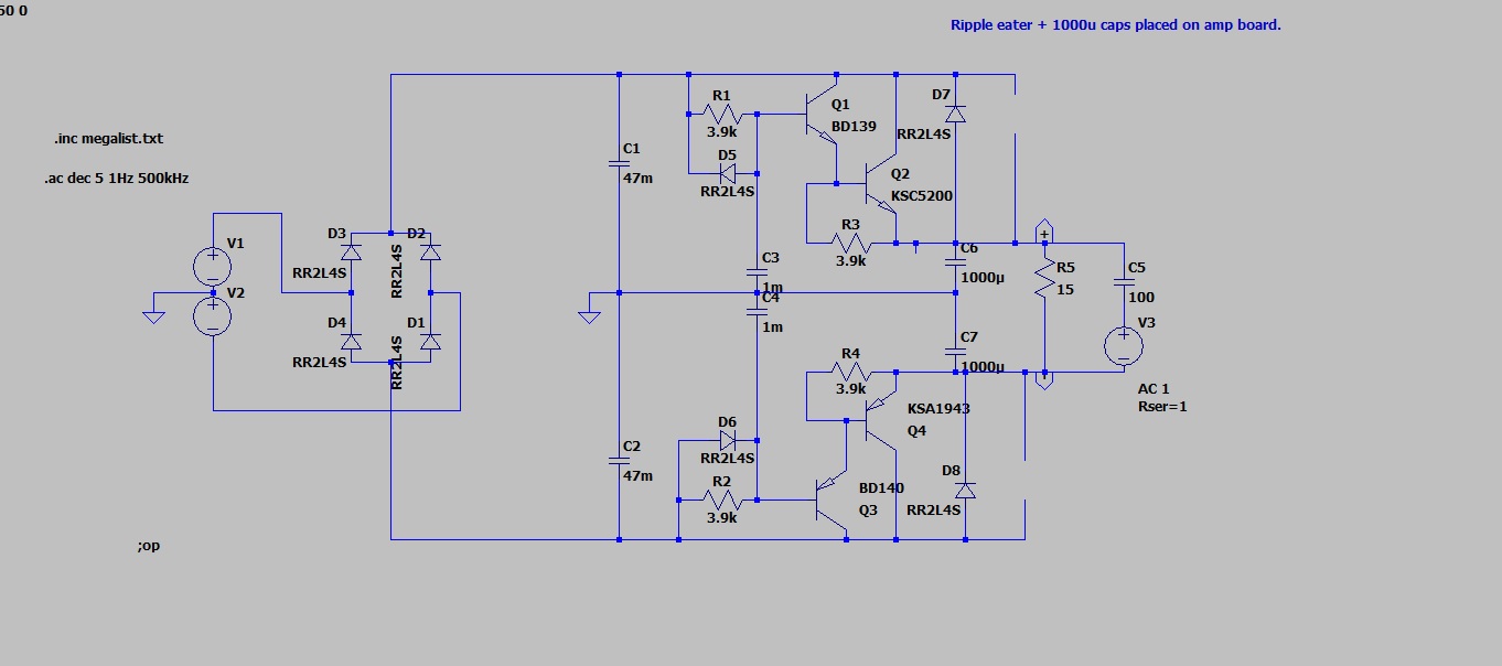

I have also started some simulation on the ripple eater, looking at output impedance.
I tried some different 'outputs' (1943/5200) on that and found that it seems to reduce output impedance in the audio range (abt 130mOhm to abt 50mOhm AC) This was with abt 2A DC load. Could this be correct?

I've looked at the waveforms at 20 Hz this morning with the amp transitioning to class B. The output voltage waveforms are clean with and without C17. The simulated waveforms are very close to those that you actually measured.
However, at LF there is a significant improvement of the current waveforms (ie. they are very clean) through the degeneration resistors and the bias controller stand-off voltage, so indeed I think C17 = 100uF is a good improvement to this amp.

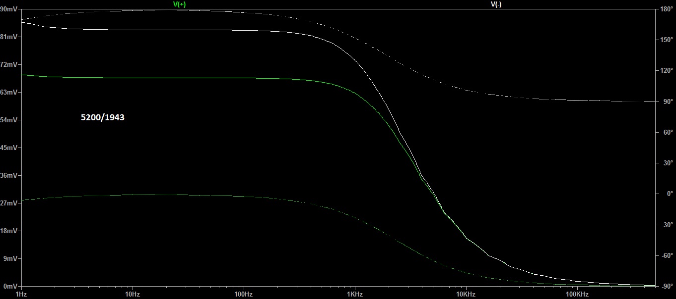

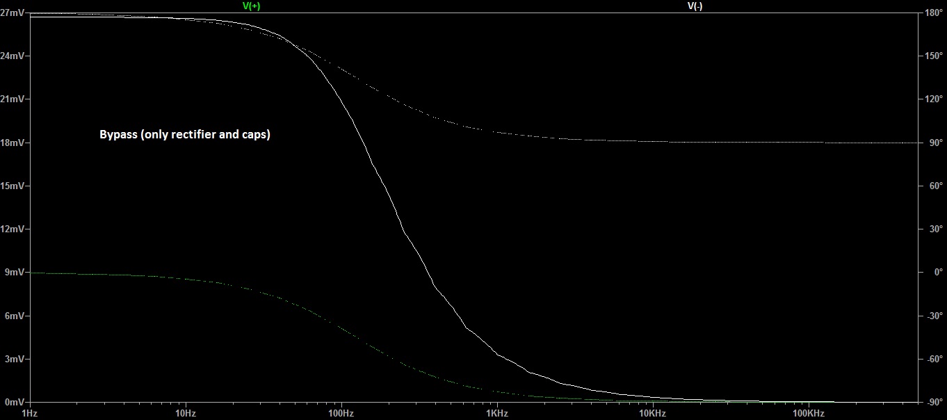

Do you mind if I post some simulations on that too? I know I'm being a difficult student again (just as in school) 🙂
🙂 Thought it's better to ask before I fill the thread with my simulations and stupid questions!

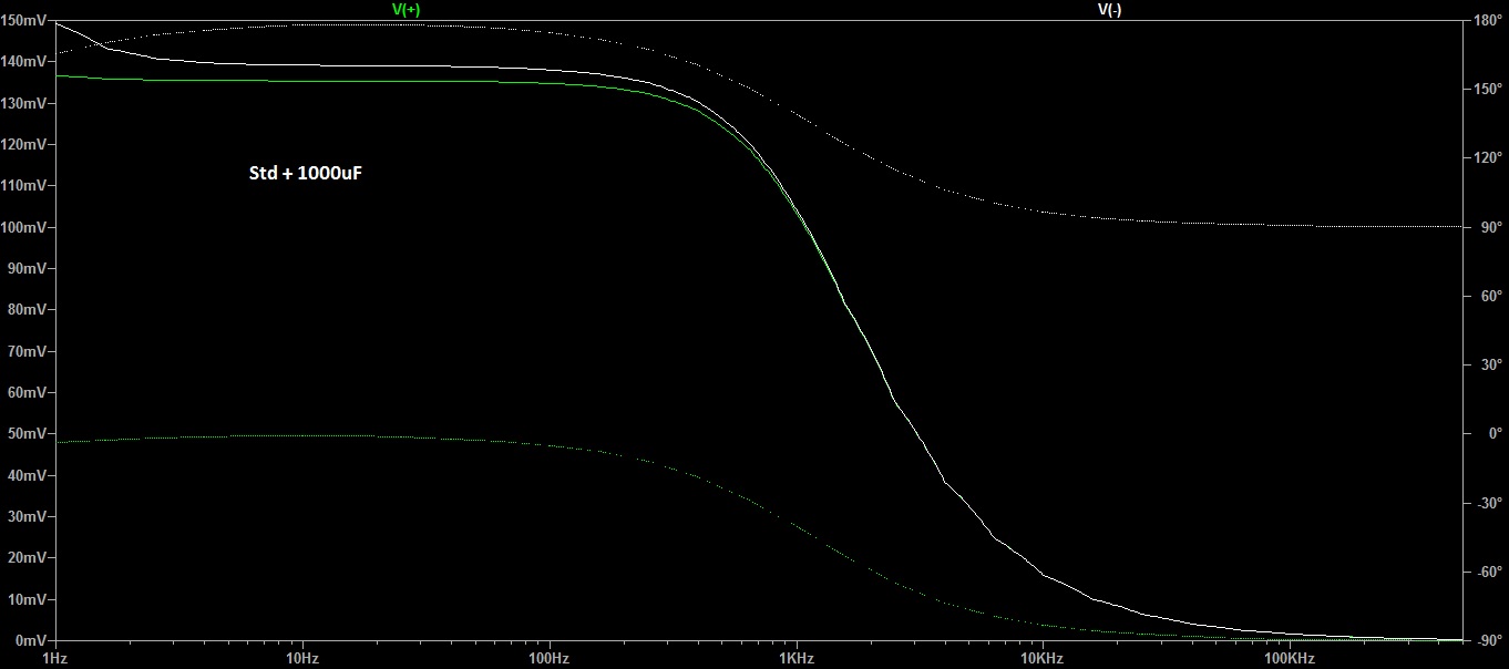

Anyway, I made a quick simulation with a resistor as DC load (abt 3A in this case) and a AC source with 1ohm impedance and 1V output in series with a big cap to simulate AC load. This should give the impedance of the 'output' where mV equals mOhm.
Below is what I did and what I found. Please correct me if the simulation method is wrong.
Pic1: Sim setup
Pic2: Bode plot of standard config
Pic3: bypassed (normal rectifier/caps)

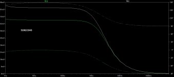

Pic4: beefier outputs
Not sure of the reason for lower output impedance, if it's the more constant Hfe/current of the transistors, or what is actually giving the improvement. Maybe higher hfe on all the transistors would do the same?
BTW, the 1000u caps are giving the low impedance above 1kHz, without them the curve is pretty flat in the audio band.
