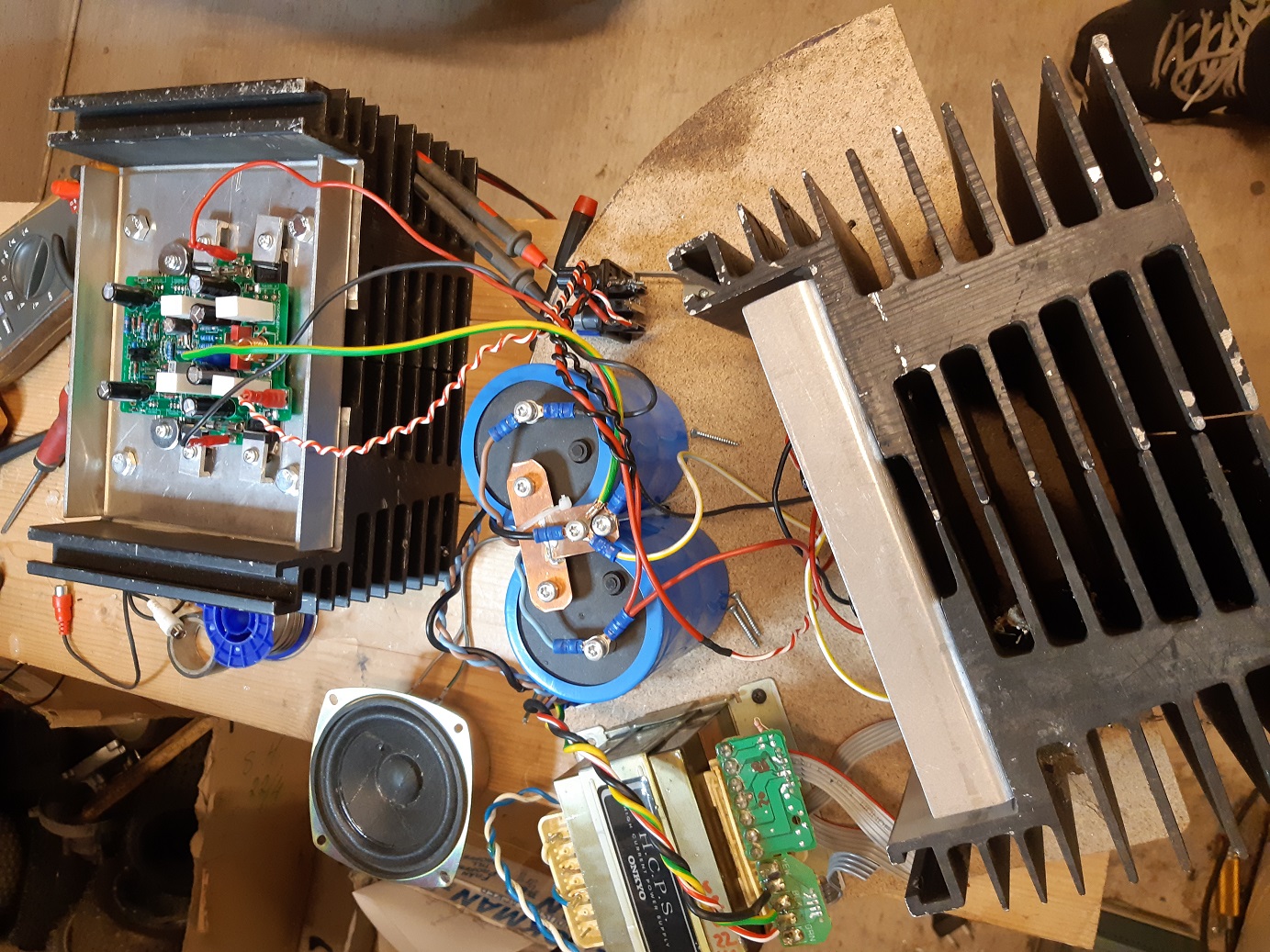

Made some progress with the build this weekend. Got some heat sinks from a friend. Was planning to use one for each channel, but my gut feeling told me I needed more, so I paired them up with two per channel.
I have done some 'heat tests' today and have no worries about the heat sinks. Case temp on the hottest output was abt 70deg C, and heat sinks around 40deg.
However transformer is abt 55deg C after abt 30min in high bias mode supplying both channels.. there is also some buzzing from the transformer under load, but I think it's tolerable.
I also checked the other similar Onkyo transformer I have, and core seems to be the same, but voltage is 20VAC on that one, and 22VAC on the one in the picture, so I donät think I can parallel them even with separate rectifiers. Not sure about the VA rating, but the marked power on the amp it was in is just over 500W. Here it will be asked to supply abt 200W continuous power, and that might be on the limit. I have some thoughts on adjusting the 'high bias' resistors to lower it a bit, and make it work with what I have. I rarely use more than a few watts when listening to music, so the the low bias mode would almost be enough for my needs. High bias seems to be almost 2A/channel.
I could also hear a fair bit of hum connecting a small speaker, but there is definitely a lot of pickup in that arrangement 🙂
DC offset seems stable, only varying a few mV. Current sharing between outputs is ok, but one pair has a diff of just over 10%, which I think is a bit much. Case temp is notably higher on the device carrying more current.

The power transformer in a class A amp is critical because of the heavy constant load. Transformers for commercial class AB amps usually won’t cut it. These run with low constant load, and only have to provide high currents (over and above the reservoir cap charging currents) on high signal levels. For this reason, they usually won’t buzz when the amp is idling and only make mechanical noise at high volume levels. However, if you test with a load resistor at high power levels you often hear it. They are often run at high flux densities and with significant temperature rise even with low load to keep the cost down.
The transformer in my kx-amp is rated at 400VA, is double vacuum impregnated and cloth bound on a stabilized core (there’s a pri-sec screen and a GOSS band as well). The temperature rise after a few hours is about 10~15C above ambient.
So, an expensive item at about $80 in the UK but worth it.
Re the hum/noise, you obviously have big loops looking at the pictures eg DC from caps to module these need to be twisted together as well. Note also you will have very large EM fields off an EI transformer a d this could also be an issue.

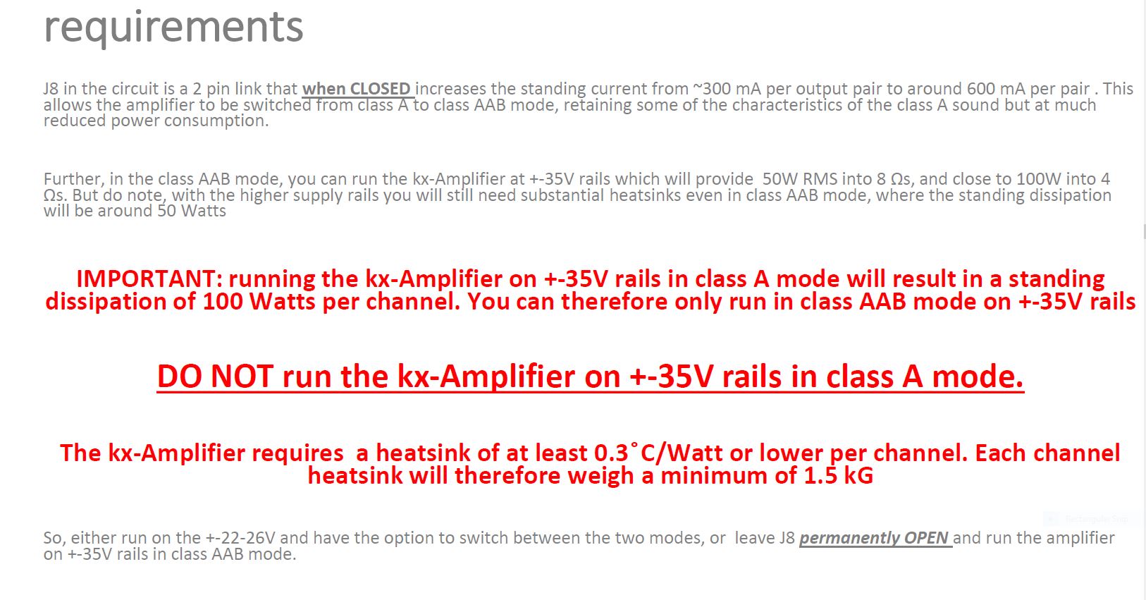

Hi Bonsai I'm doing a layout from the schematic and I want to know something here, this part of the PDF tells me that to run in class A the supply is @22-26V DC rails and J8 is pins are connected but if I want to chose class AAB then supply @35V DC rails and J8 pins are open I'm correct here? sorry for the silly question English is my second language and I sometimes need to be sure in things that I do when I read

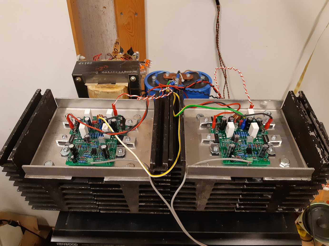

Some progress on this build again 🙂
Amps have been playing all day in the garage in low bias mode to keep PSU noise down. There is some noise with this setup, and also a minor constant oscillation visible on the scope, but it's just a temporary setup so far.
I did a quick distortion measurement with 7ohm load, but no distortion was visible above the PS induced harmonics around -80dB @ 1kHz (-60dB @50-150Hz area).
7+8k IMD seemed really clean, I think the best I have seen, with first harmonics around -80dB. Also multitone looked clean in the higher frequencies where PSU noise was lower. Promising!

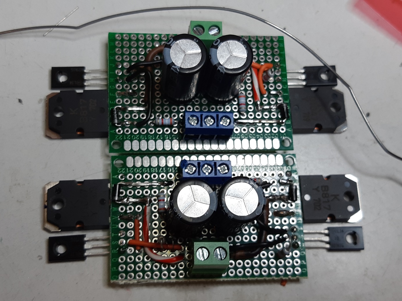

I went ahead and built two ripple eaters true DIY-style, using some beefier output transistors. Did a quick 'functional test' at 2A without any heat sink, and that was no problem. Transistors did not seem to heat at all.
I belong to those who think bass is improved with bigger PS caps, so I care about the impedance of the PS. I figured using double ripple eaters with bigger transistors should give the lowest possible supply impedance to the amps.
However I'm still thinking about the transformer and caps. A friend offered some beefy transformer he thought he had as left over, but could not find it, so I was back to what I have.
I was going to order the specified caps, but could not find more than one in stock when ordering other parts. Seems the european sellers normally don't stock these big snap in caps.
I do however have 4 new 33mF 50V caps, so I'm leaning toward double sets of rectifiers and caps using what I have. I have some basic PCB's for this too.
If the rest is double, I'm thinking it would be nice to double the transformers too.. I have the earlier mentioned Onkyo transformers with 22 & 20V secondaries..-I started thinking a Zener over each cap in the ripple eaters could limit the voltage to get equal voltages on both channels.
I have not simulated this, but I'm thinking my double ripple eaters with beefier transistors should cope with the extra dissipation if the voltage drop is sensible and cooling is ok.
I like dual mono, but on a budget 🙂
Comments are welcome!

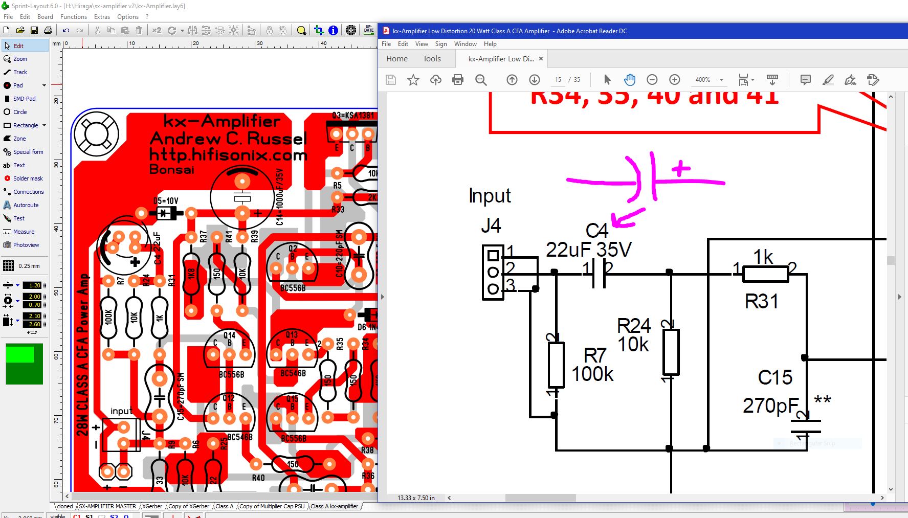

C4 input cap polarity question
hi question, I'm diy the PCB using the shape of the original PCB and circuit schematic and C4 I'm not sure if the negative goes first for the input cap or + first
then negative side to R31 1KΩ
