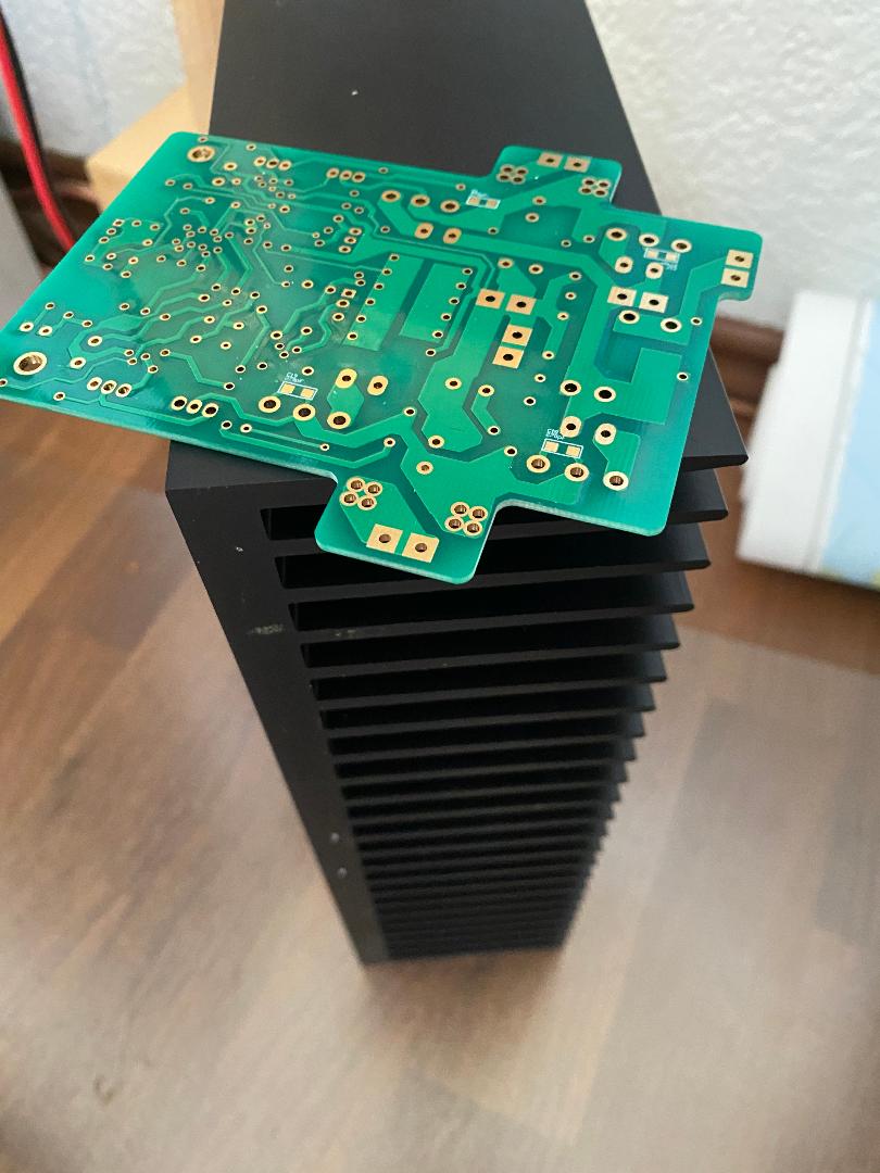

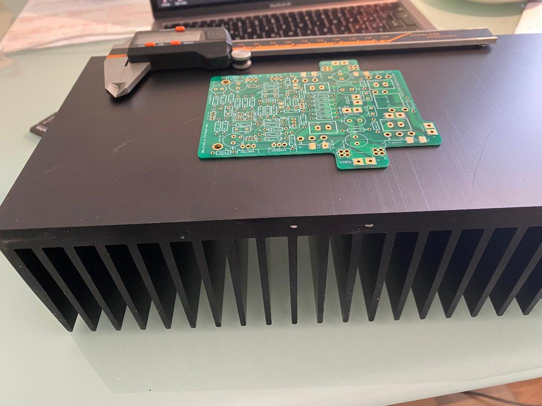

My PCB's finally arrived, and in my stock I "found" some old, and really heavy heatsinks. Size is 150mmX300mmX80mm (LXBXH)...
Are these too much for this amp ? I always struggle in sizing heatsinks. What I know out of the manual are the recommended specs...

When room temperature is?
About 23C. I run the amp in class AA/B in the summer.

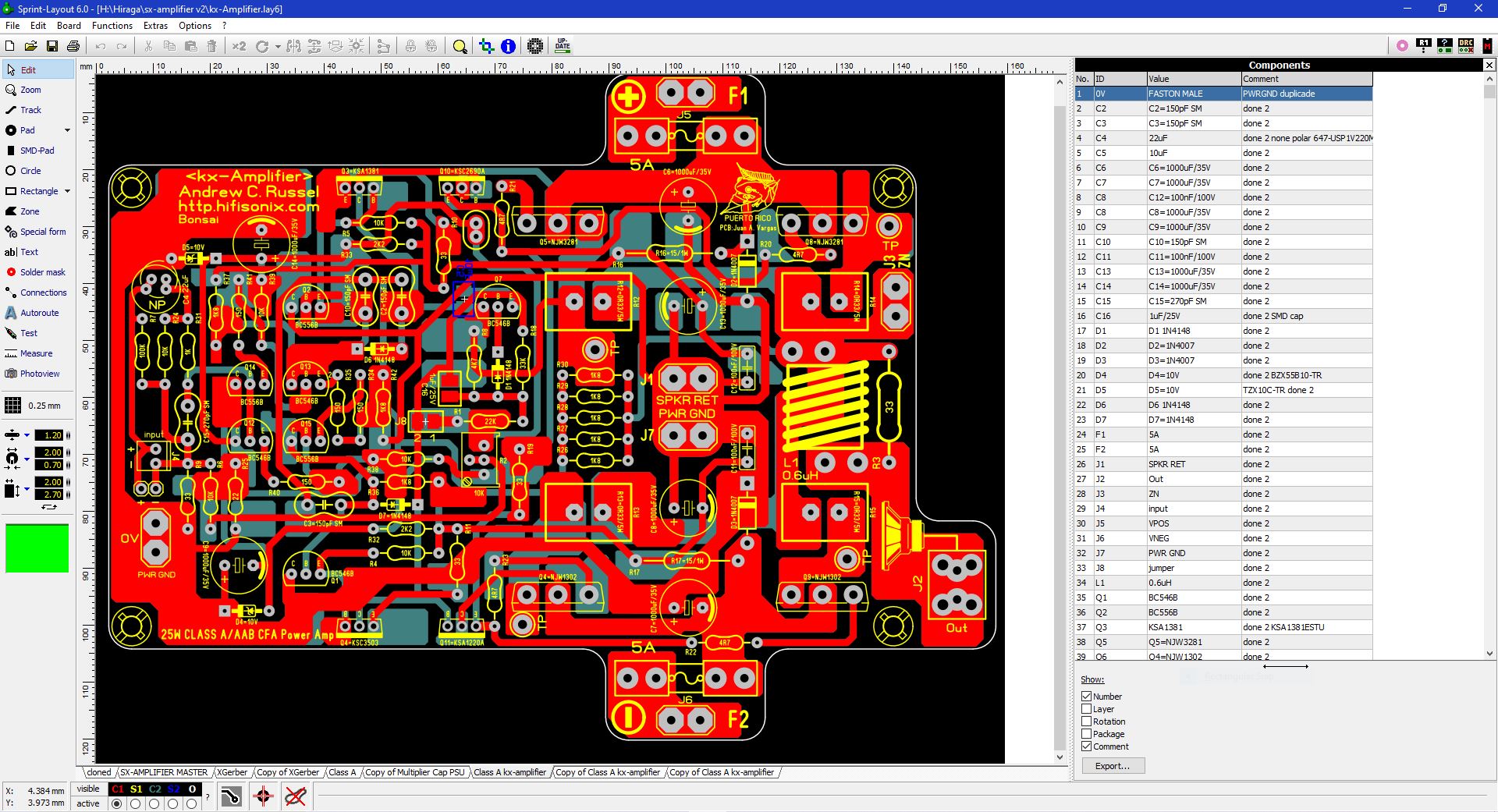

rocksteady can you put pictures of what you did? I'm making my own diy board from the data that Bonsai provide and yes I know is "only for personal use not for sale I agree on that ", I'm gonna check all one more time just to be sure all is 100% correct I just found a few errors on the kx-maplifier and I need to check the PSU too
