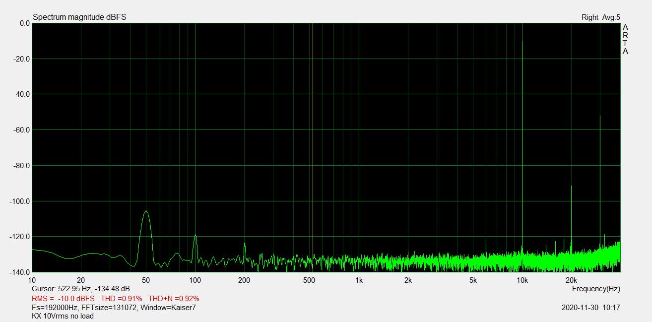

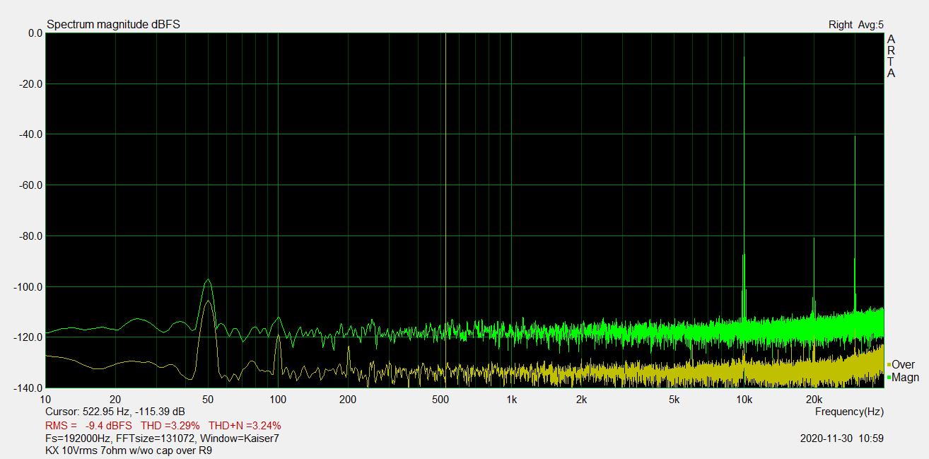

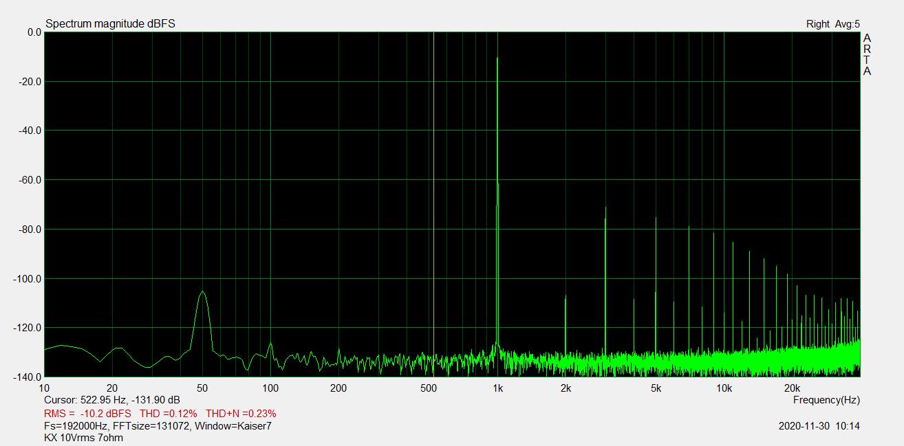

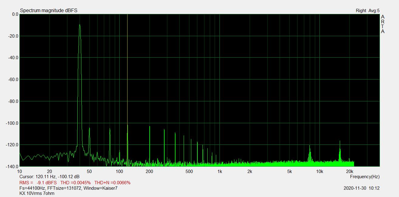

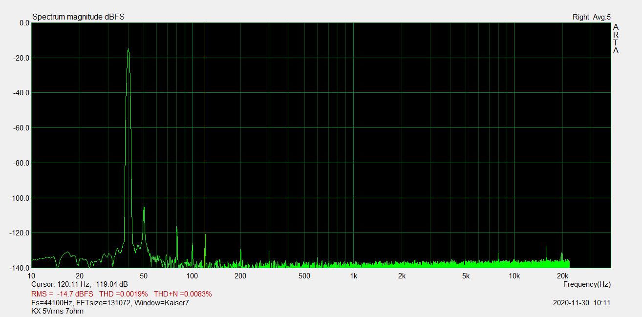

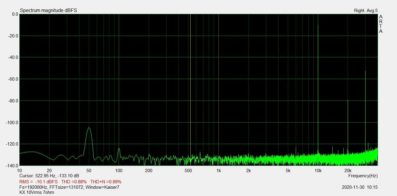

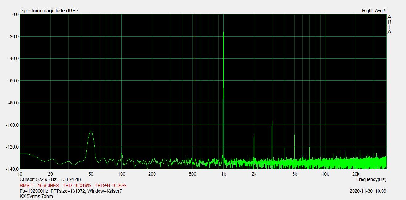

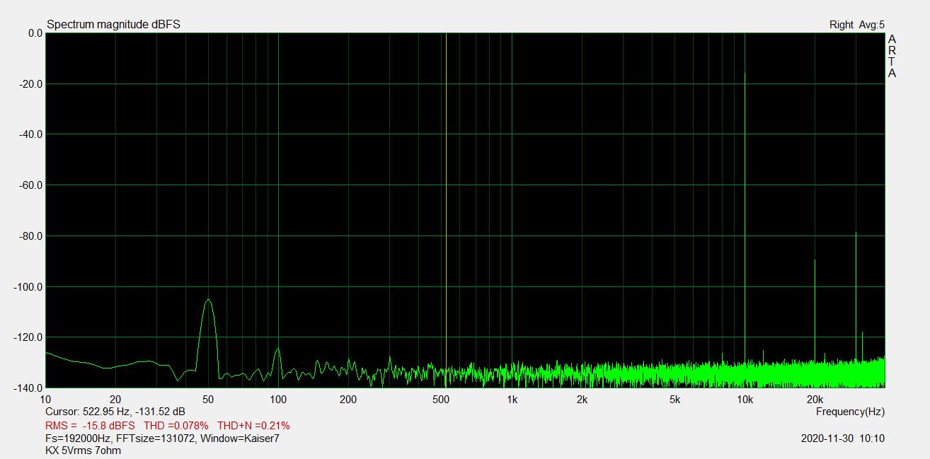

After adding a cap over R9, my hum went down a lot since IMHO any voltage over this resistor will be amplified by the amp. Hum reduction was even enough to make me try bypassing the ripple eater, and looking at the FFT, now I can hardly see any change in PSU noise on the output with or without it. This is of course running single channel (dual mono) setup.
I had some question marks before about distortion, and now I added 10x more damping to the input on the sound card just to rule out an overloaded input, but the result is the same. Increased amplitude gives a lot of harmonics, and it is independent of current (load), and gets worse with higher frequencies.
This is full Iq mode, no ripple eater.
If your amp is prone to instability, that must be sorted first before doing anything else.
I will finish my tests later today and put the changes up. On.y after that can you address any other issues in your build.
R9 is a hum breaking resistor Rallyfinnen- it’s there to reduce cross channel ground loop currents. If you are getting hum with it in situ, please check for other noise sources but only after the above issue is fixed.
