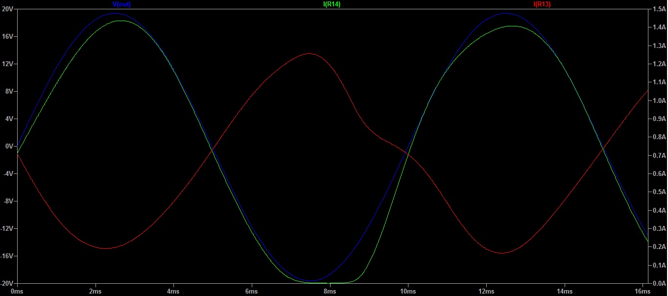

I have tried some simulation of the amp.. I'm not an experienced 'simulator', so there could be some things wrong here. I'm just looking at current sharing between upper and lower halves with different input levels, and it all seems fine in class A, but seems to get a bit unbalanced when it moves to class B? Maybe it is not relevant at all, or even normal, I'm just curious
I attach a graph of one upper and one lower emitter resistor and output voltage with 8ohm load.

If that’s the emitter degen resistor current, then it’s not correct. Assuming a sine wave input, the output current will be a clean sine wave in class A and when it moves to class AB, you get the typical class AB half sine wave. There are some plots of this in the write-up.
Yes, the currents were from the emitter resistors, it seemed a bit strange to me too.
I have to check the schematic.
I used most of the models that comes with LTspice, except Q3-4, Q10-11 from Cordell and outputs models from Mouser. Maybe I should get all the models from Mouser on the components I ordered instead.

I could not find any faults in the model, so I don't understand the strange current sharing. Just for peace of mind, maybe I will measure it on the finished amps. I also tried simulating the OLG, and it indicates a lower -3dB point (I think it was abt 8kHz) than the documentation. Not sure if that's because of transistor models or something.

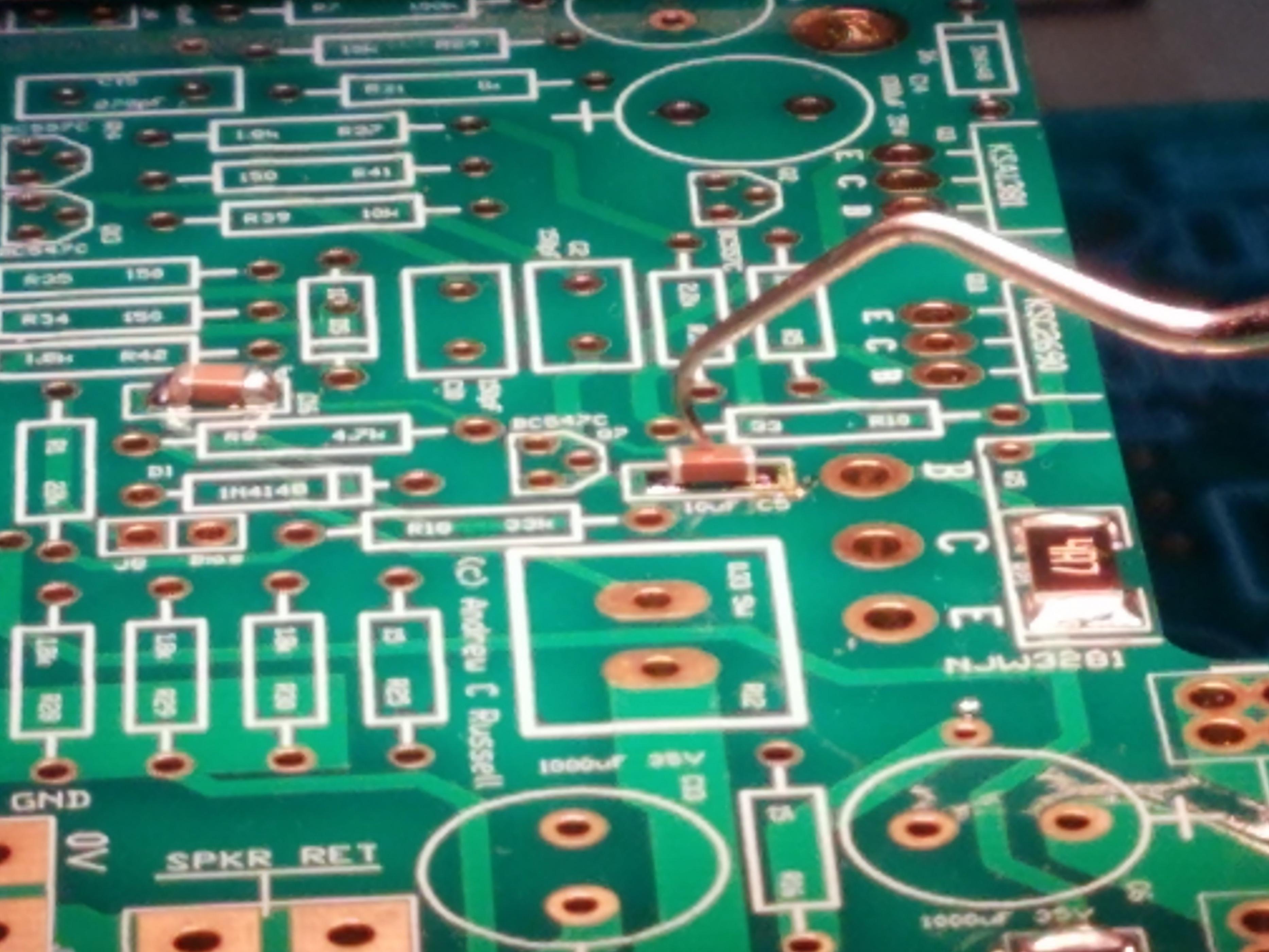

Finally getting around to posting some build pictures.
1) In general I tried to mount components based on their height off the board. So first off I mounted the surface mount caps. First is a picture of a dental pick holding down one of the small caps on the back side of the board.

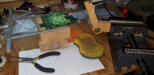

2) Next is a picture of the jig that holds the pick. It worked fairly well, but tended to move the cap forward and backwards quite a bit.

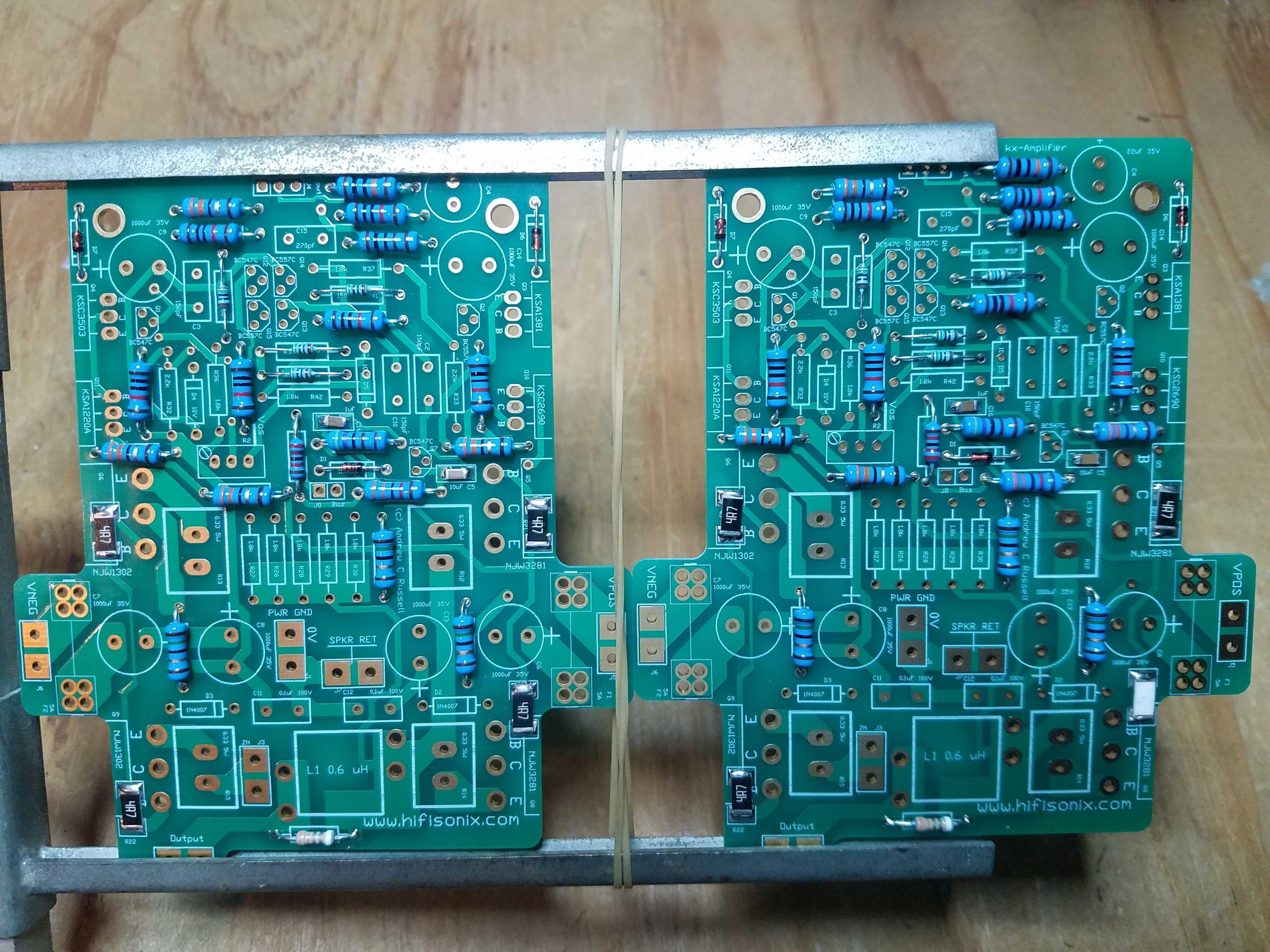

3) Next up is a picture showing most of the resistors mounted.

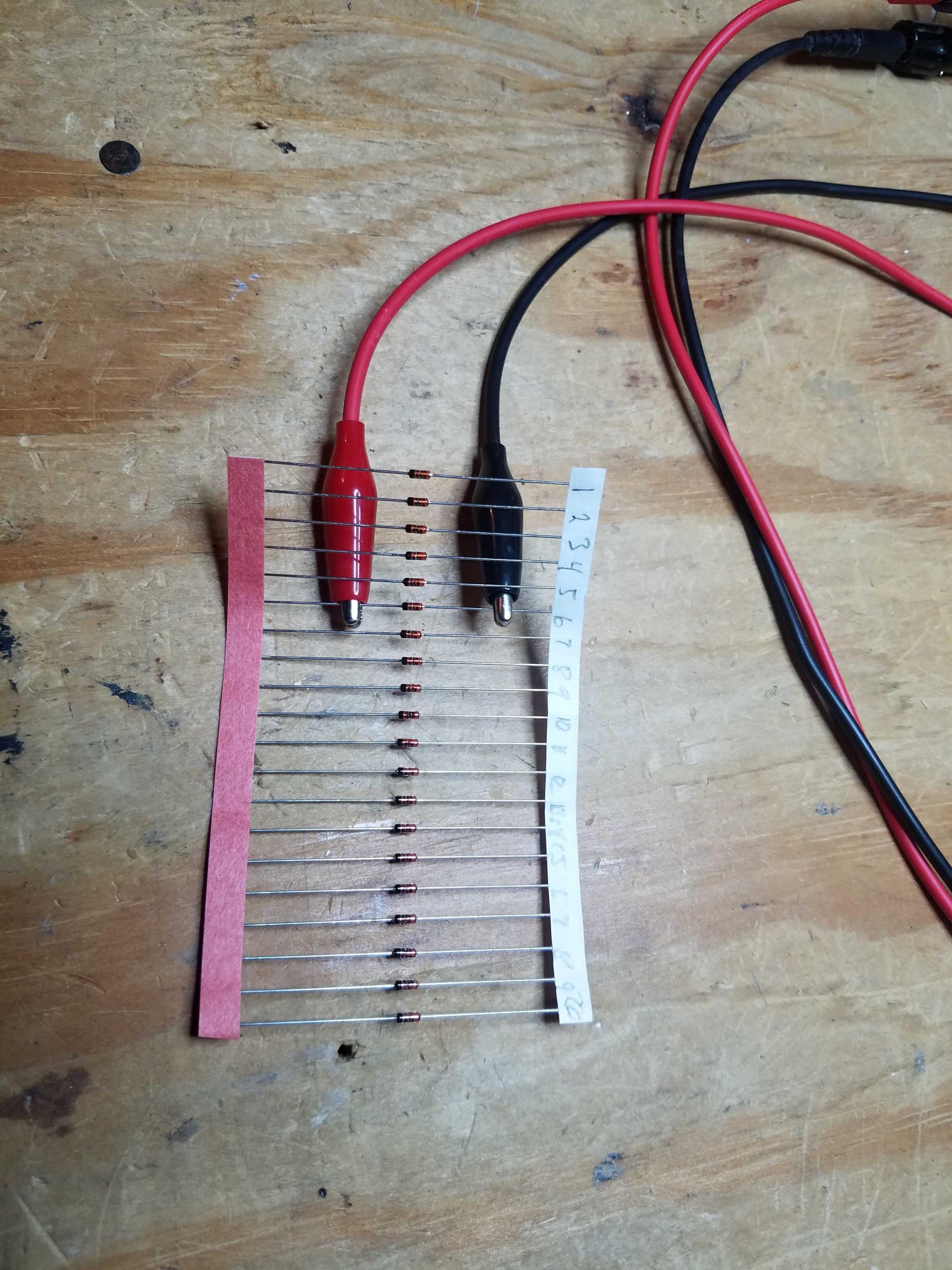

4) I ordered 20 Zener diodes for D4 and D5. I left them attached to the tape and numbered them. Then I measured each one and recorded the values. This allowed for easy matching to get two matched pairs.

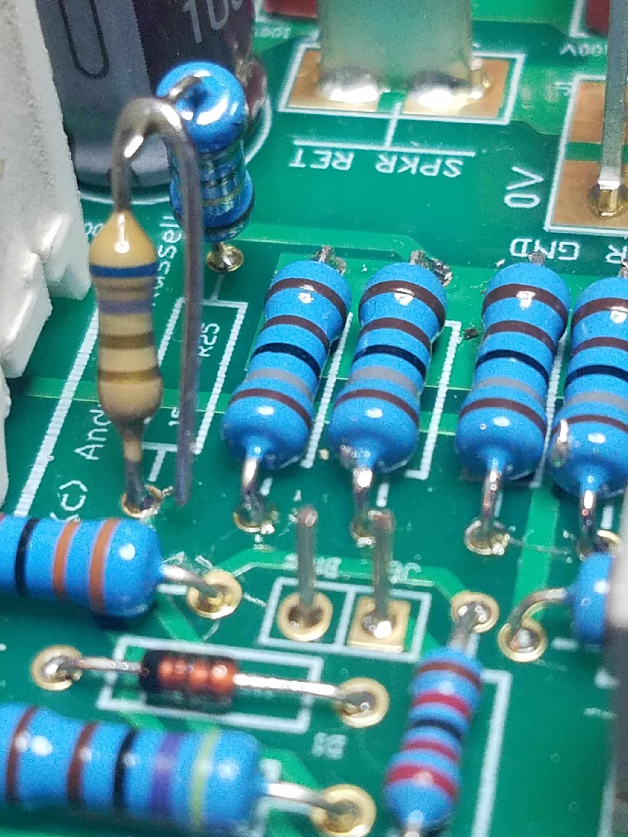

5) Not knowing what gain I wanted, for R25 I used a 15 ohm resistor in series with a 7 ohm one, connecting them in midair. I left one lead of the 7 ohm resistor long and folded it back along the resistor body to allow for easy shorting out of the 7 ohm resistor to easily change the gain without changing parts.

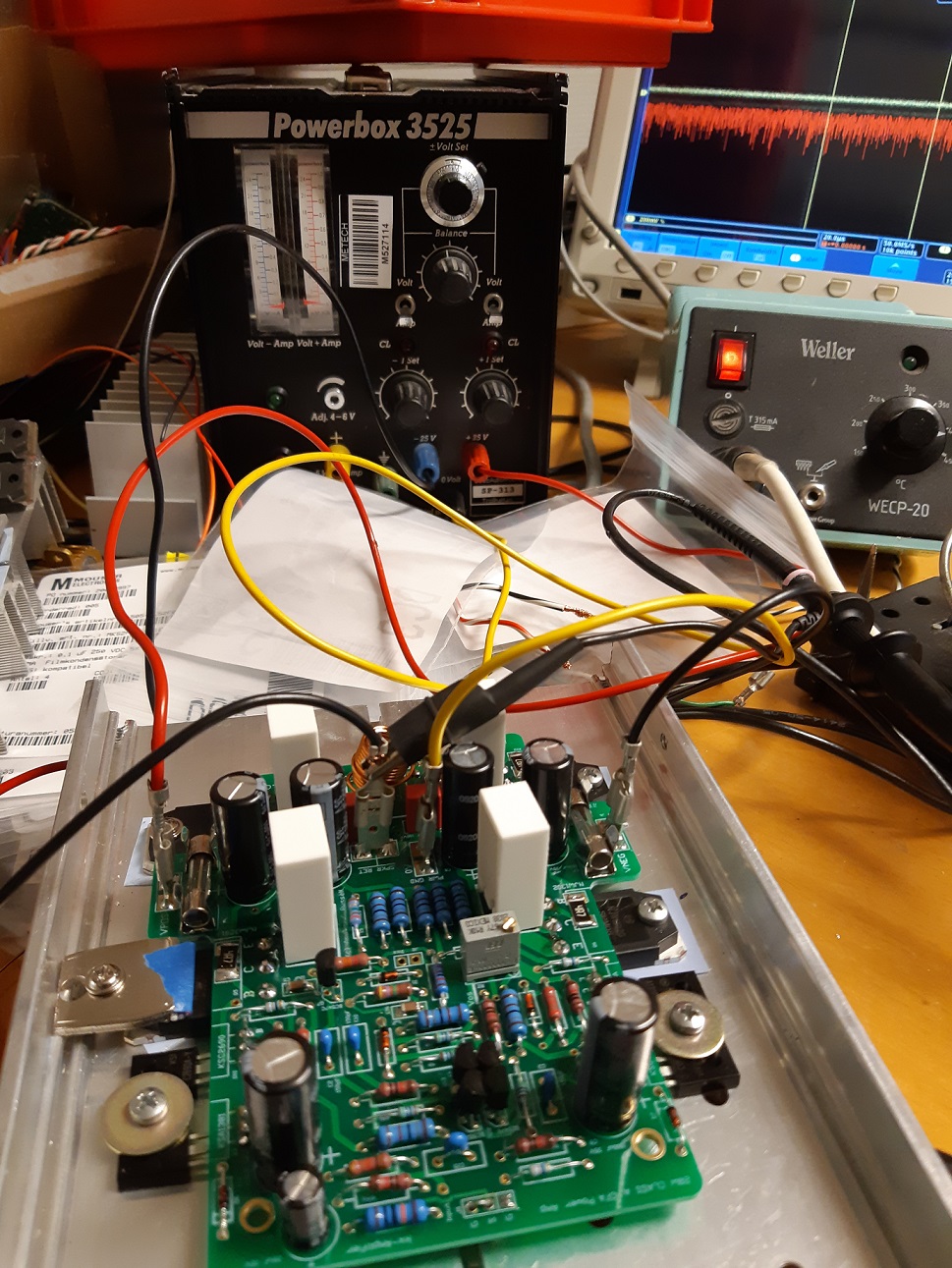

Both amp boards completed. However, both seem to have oscillation of abt 400mVpp in the 100-200kHz area. Frequency varies with heat, and also jumps around when I touch the legs of the output transistors. If I connect a 7ohm load, frequency also jumps up a bit. This is with regulated bench supply and input shorted.
If I adjust the supply voltage, frequency changes too.
Suggestions?
