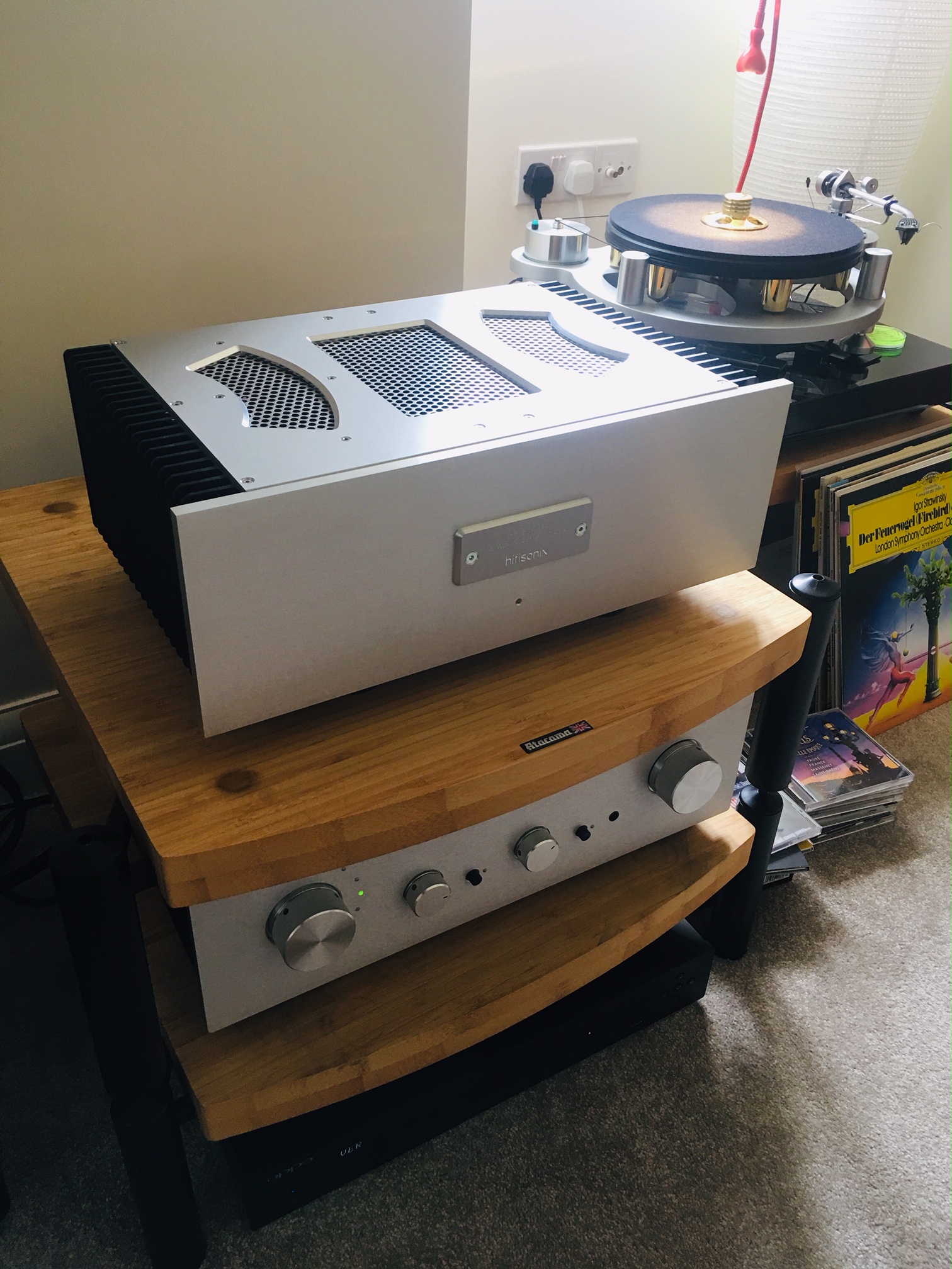

re AFEC. You really need to taylor AFEC for the amplifier and its not something I would recommend just adding on to an existing amplifier. If you look at my commercial site, there is an amplifier there (Model 1721) that uses AFEC. It took a lot of work to optimize it, and to make sure that it worked from unit to unit and works first time when I build it for a customer.
The kx-Amp distortion (measured) is already very good and the biggest issue - cross over distortion - is not there because its class A so my recommendation is that you just go with it as it is. I have only heard good feedback about it from those that have built it and BTW this is my amplifier I use every day:-

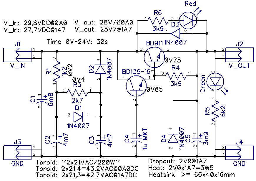

Ripple Eater - uses Darlington, loosing 2x Vbe on the way, but ensuring low output impedance.
How would a Complementary (Sziklai) version work out, for comparisons sake?
Probably, we would gain a slightly smaller dropout, 1 x Vbe + 1 x Vce_sat, but on the other hand, we loose on the output impedance. Something lost, something gained?
Overall, would a Sziklai-complementary version of the ripple eater be worth testing?

I have not tried the Sziklai in the Ripple eater so unfortunately cannot comment at this stage.
I am using a ripple eater with my kx-Amp. The current draw on a class A amp is high, so you get high ripple on the rails. The ripple eater reduced 1.5V ripple to about 14mV ripple pk-pk. There are some scope pictures in the link below

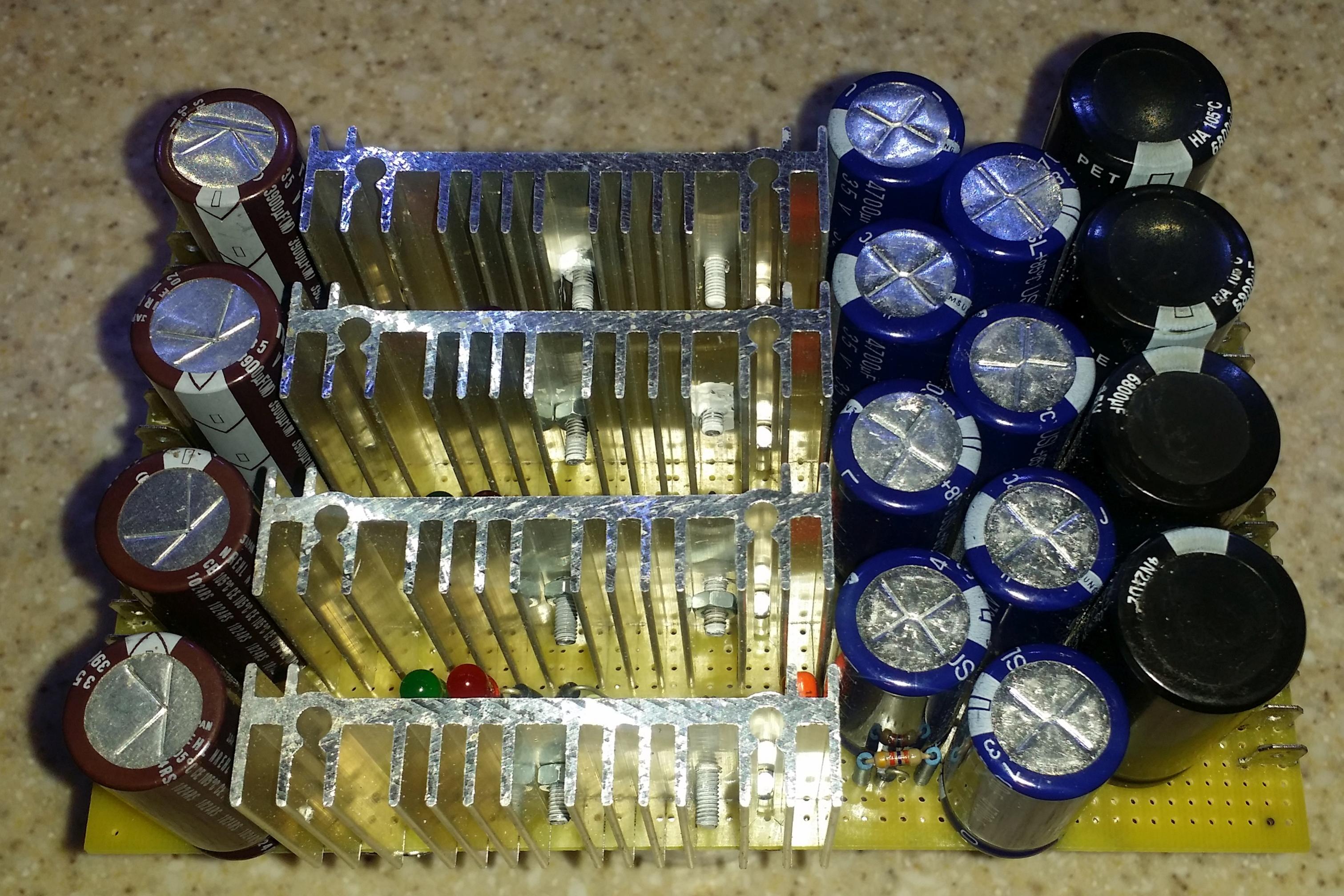

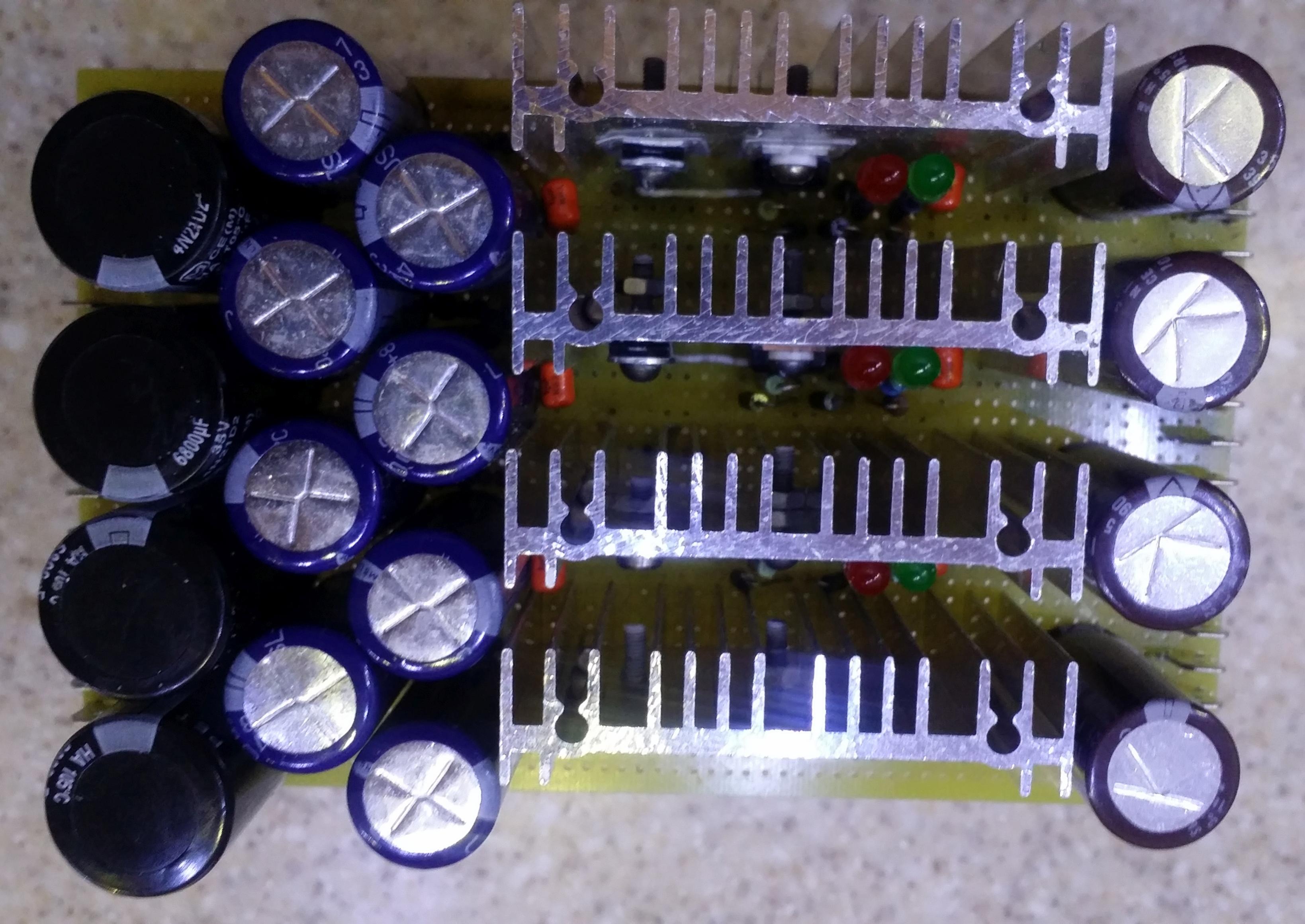

KX amplifier ... work is progressing.
As Jim's set of PCB's does not actually include/provide for a capacitance multiplier,
I came up with a separate lab PCB, on which I will be implementing four channels of something like this.
Actually powered up. Seems to work. Dummy Load was a set of resistors on heat sink, totaling 15 ohms.
Based on components found on the bottom of a drawer.
Well, yes, but the basic KX PCB set already has a PSU board, would be a pity not to use it, since included. That is the reason why a separate capacitance multiplier board. Four blocks, for PlusRight, PlusLeft, MinusRight, MinusLeft). Right and Left channels will have separate blocks.Have you checked eBay?
Fab
But there are those mega fat elko's on the preceding PSU board that comes as standard with the kit: 33000uF per rail. So these here are really just a fill in the blank, a bit of extra Capacitance on the input of the Capacitance Multiplier Board. Only because I had 3 spare cm of board from edge to the rest of the stuff thereon. The whole board is populated with elements of a height of 40mm, so as to achieve a compact form factor, that can be nicely fit into some limited space in a future enclosure / chassis.(C2 + C3) > C1
