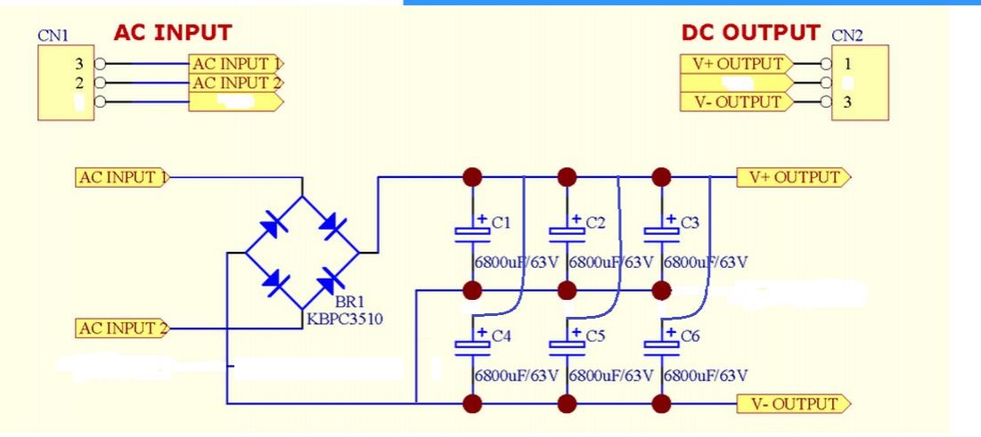

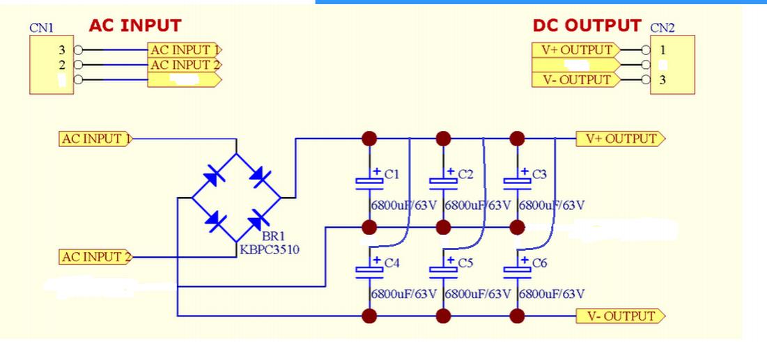

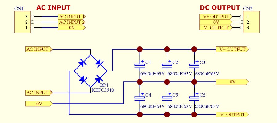

Am I wrong when I think that T4 accepts two DC types : asymmetrical (0/+) like from your Meanwell or symmetrical (+/0/-) like the offered power supply board ?
I wished I could comment it.Is it possible to modify the board and achieve the attached schematic?
See posting before from Nick. It looks like that your modifying is obviously not needed. On the other hand: if Nick is wrong you are in the game again😀
Why abuse the center-tap like that?
Attached are different schematics.
Edit: also make sure that you take a transformer like +-17.5v, not +-35v.
Basically the same thing I created...
No, 17.5 will not accomplish his goal. 35-0-35 toroidal with both secondaries tied together to achieve more amps.
At least that is what my approach is, BUT since you have not bought the board, don't do any of this 😀

Yes the board doesn't add much to it. there is already a rectifier on the T4, so if you want more capacitance, you could add more to the T4 board.
Indeed, the rectifier is not a bad one. My main issue is the soldering and integration of several caps (up to 20 pieces) into a chassis. It's senseless to design and build only one or two extra pcbs for it.
BTW: I would suggest to show before and after schematics for electronic dummies like us. It makes also comparing easier for everybody.
Before (for symmetrical DC out):
After - Whaleman's suggestion - (for asymmetrical DC out):
