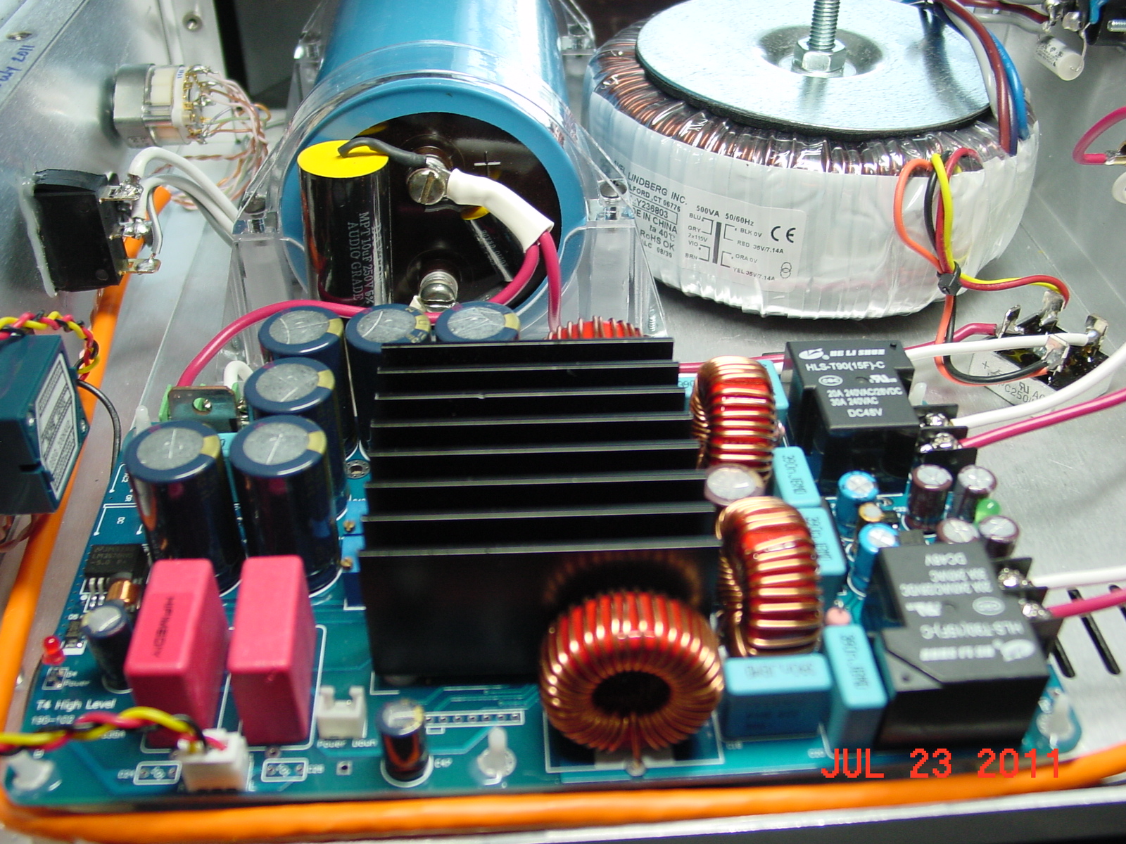

What do you think about? Can you compare it with some other amp?Finally got my T4 working after waiting for the SMPS module for three weeks
the only other amp that I have is an Onkyo AVR.
with T4, I'm hearing a more detailed sound (apologies as I do not know much of audio jargons).

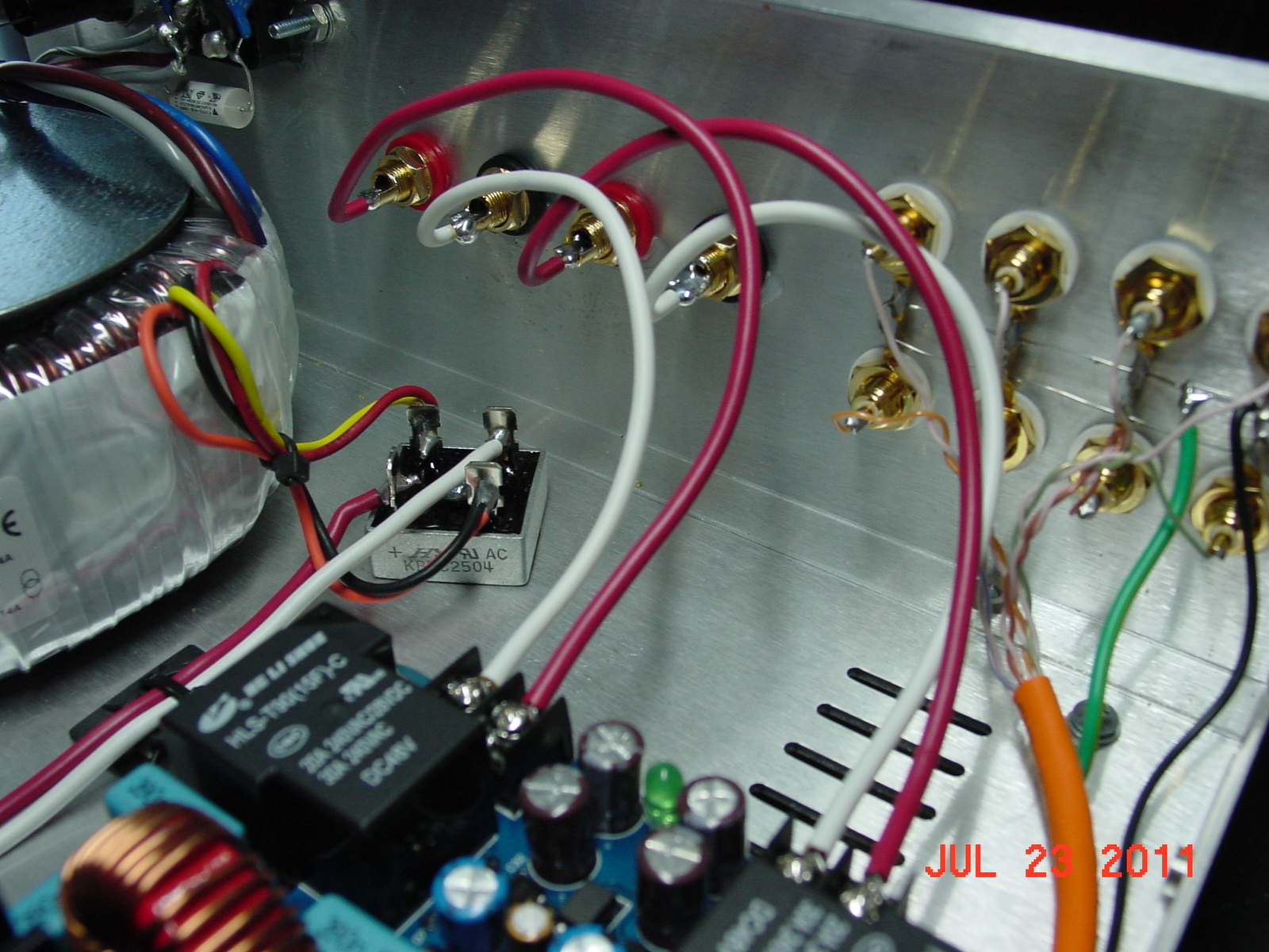

40 volts AC will rectify around 57 DC, you may too close or over I think. I use my own rectifier and feed the board DC.
With everything connected, I measure 49.9 VDC at the power connector with a 35-0-35 AC toroidal. I add 75,000 uF of capacitance outside the board, so my power on current rush is substancial and I have to use a bigger rectifier.
Double check your voltage before you buy the toroidal, those aren't cheap.
Though I know you pointed out this issue also in the other Hifimediy thread I am digging this Thread up again. It really belongs more into here.
I am using a 450 VA torroidal and the set up on the T4 board. First listenning impressions were O.K. but I got the strong impression that there is quality space above. So can you state the rectifier type you used ? Isn't it also better to split the total capacitance into smaller ones - i.e. 20 x 3500 uF ?? If I am not wrong you did not remove the standard T4 rectifier, or did you ?
The rectifier bridge I used is this one: 400V 25A Bridge Rectifier
I have done the power capacitors both ways, spread out and a single large one or two. I like the large one because it takes a while to drain and it is like running the amp on a battery. The T4 runs for 30 seconds after turn off with no power without any degradation to sound quality, which means that it is very well fed. I use bypasses on it. Also, I left the rectifier on board, I did not modify the T4 board at all. I think the unit is optimized and I don't see how it could sound any better, it is quite impressive. BTW, I used a 500 VA toroidal and an NTC thermistor as an inrush current limiter.
Here are both, one with a 75,000 uF capacitor, plus what is on the T4 and the early stages setup for the T1 with 4 x 12,000 uF capacitors in series and a intermodulation distortion reducing circuit I picked up from TNT audio. The thermistor for the T4 was added after these pictures.
