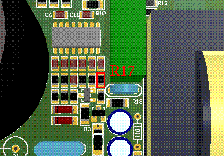

I have a similar problem. As in your case, the Connex500 doesn't manage to "kick" in the relay of the T4 when initially powered up. The read light is on, the green is not and the voltage out of the Connex is around 8V. Disconnected from the T4 the voltage is 48V.
However, after a while powered on (more than 10 minutes), the Connex suddenly will power up the T4 and everything is working fine. I'm not sure, but this might be due to the thermal resistor on the Connex that is designed to prevent to high current when the capacitors are beeing charged. Supporting this theory is the fact that a hairdryer pointed at the Connex helps it starts working! I have also emailed this issue to Steinar.

SMPS500RS-500 Protection
TORE, i just spokt with Steinar and he told me about your issue.
SMPS500RS has a lot of protections, maybe too many, and one of them prevent the power supply to operate properly.
From what you describe me, the over-current start-up protection kick-in when the power supply attempt to power on. Either the amplifier has more capacitance that the protection can handle, or there is a larger current draw during start-up. ayway, the power supply monitors the inrush current and if is too high will not start, entering in a latched over-current protection mode. to solve this, the resistor which sets this level should be increased. this is R17, can be seen in the attached image which one is it and the schematic is available here http://www.connexelectronic.com/documents/SMPS500R.pdf i suggest to increase to 22K, and not more than 47K, otherwise the protection might become ineffective in case of a short circuit at the output during start-up. I repeat, this detects only the start-up condition, for run-over-current there is another protection.
Another reason for not start-up properly could be the mains voltage value. if is too low, or too high, would not start properly. in this case, please measure the votlage values on the 2 small electrolytics which can be seen in the picture just below the blue ceramic capacitor. you can contact me by mail for more details.
