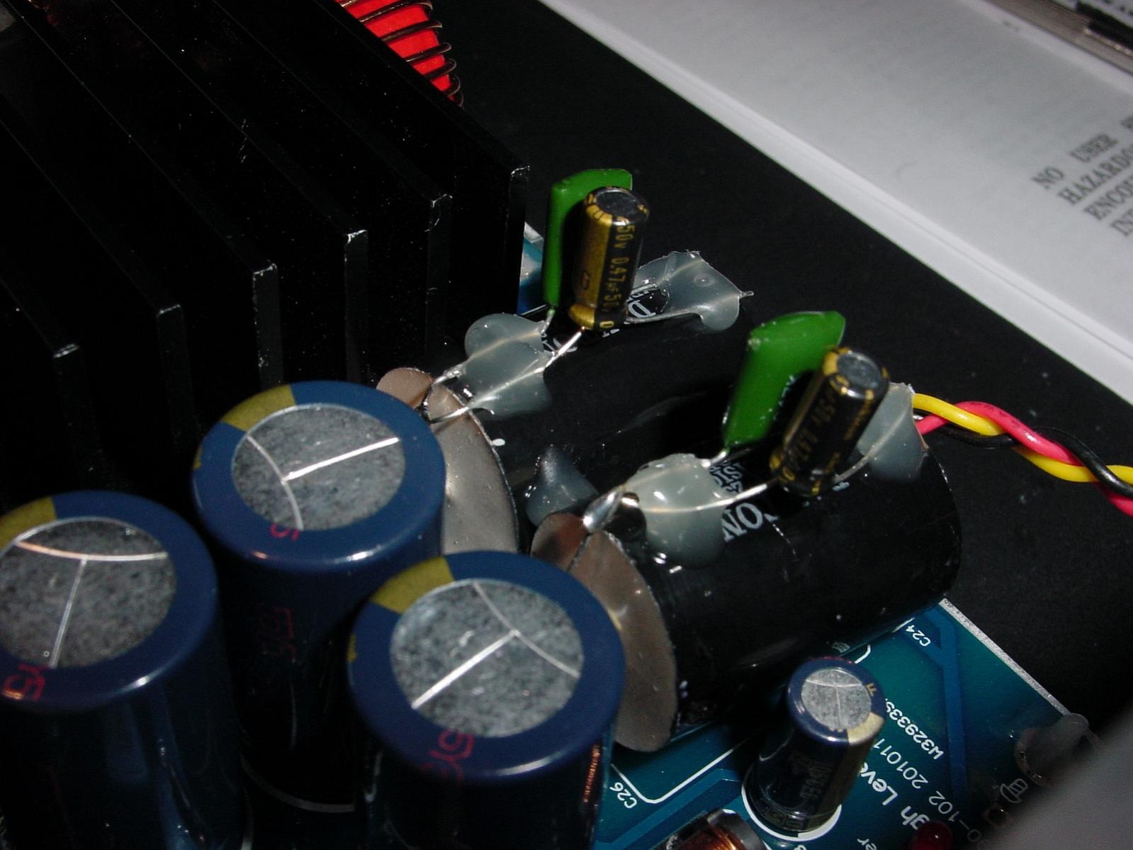

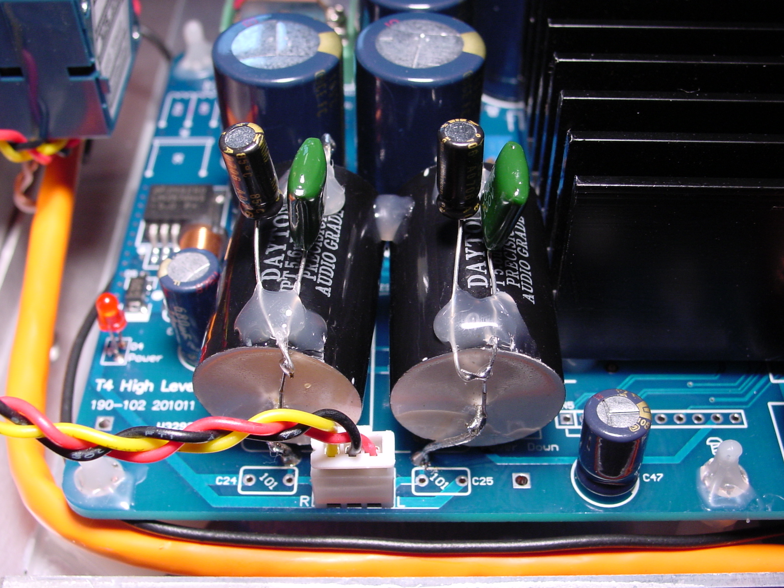

Mundorf caps? I was just searching for some Mundorf M cap Supremes for inputs on my T4. The WIMAs just wore me out, too much midrange and no texture, everything to me sounded glossy.
I settled for some Dayton 1% precision audio with polyester bypass and it is quite an improvement and may not even get the Mundorf now.
The T4 sounds astounding now and am having some friends over to show it off.

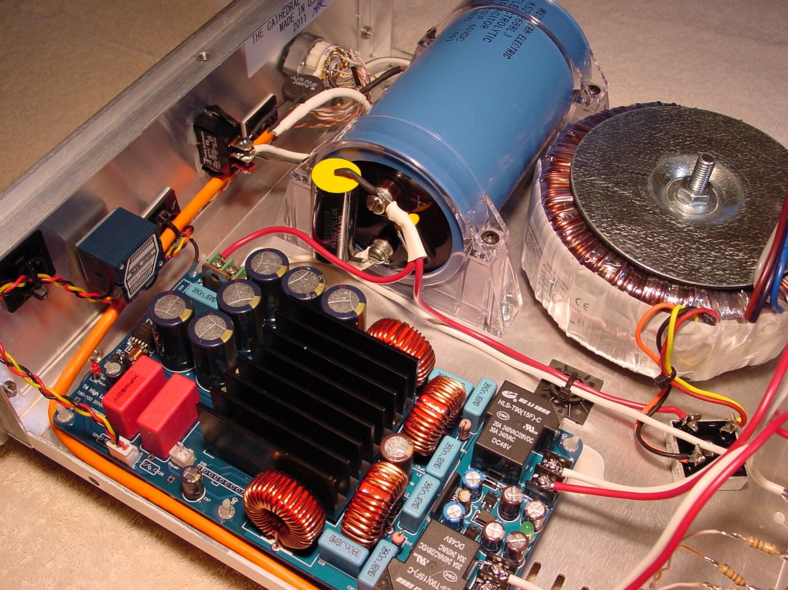

Almost 100,000 uF power reserve and a 500VA provide some generous and very tight bass, tighter than from anything else I own. There are some qualities in this amp that I just do not hear in anything else.
How did you connect the giant capacitor. I'm still figuring out how to connect mine.I got 3 go them (Philips 22000uF 100V).
connected 4 brand new 12v lead acid jet ski battries in series tested and got got a perfect 48v connected this (carefully) to my t4 also tried 350w meanwell clone and 500 connex to find any sound quality difference. Tested with a pair of polk TSI500's and a set of sony sp6000's tower speakers and the result to my i admit non audophile ears was essentially a draw . this was shocking to me because the battries were a perfect power source zero ripple zero power lag . Have decided to forget about torroidal power since there would be no point . have also decided to house amp and power supply in seperate enclosures with a six foot power cable so amp stands alone in its tiny enclosure blowing away any who listen to it . T4 came with mundorf caps and has so much useful power talking about bass punch seems moot .
I just connected positive to positive and neg to neg from the rectifier bridge to the big capacitor, then to the T4 power inputs. See pic.

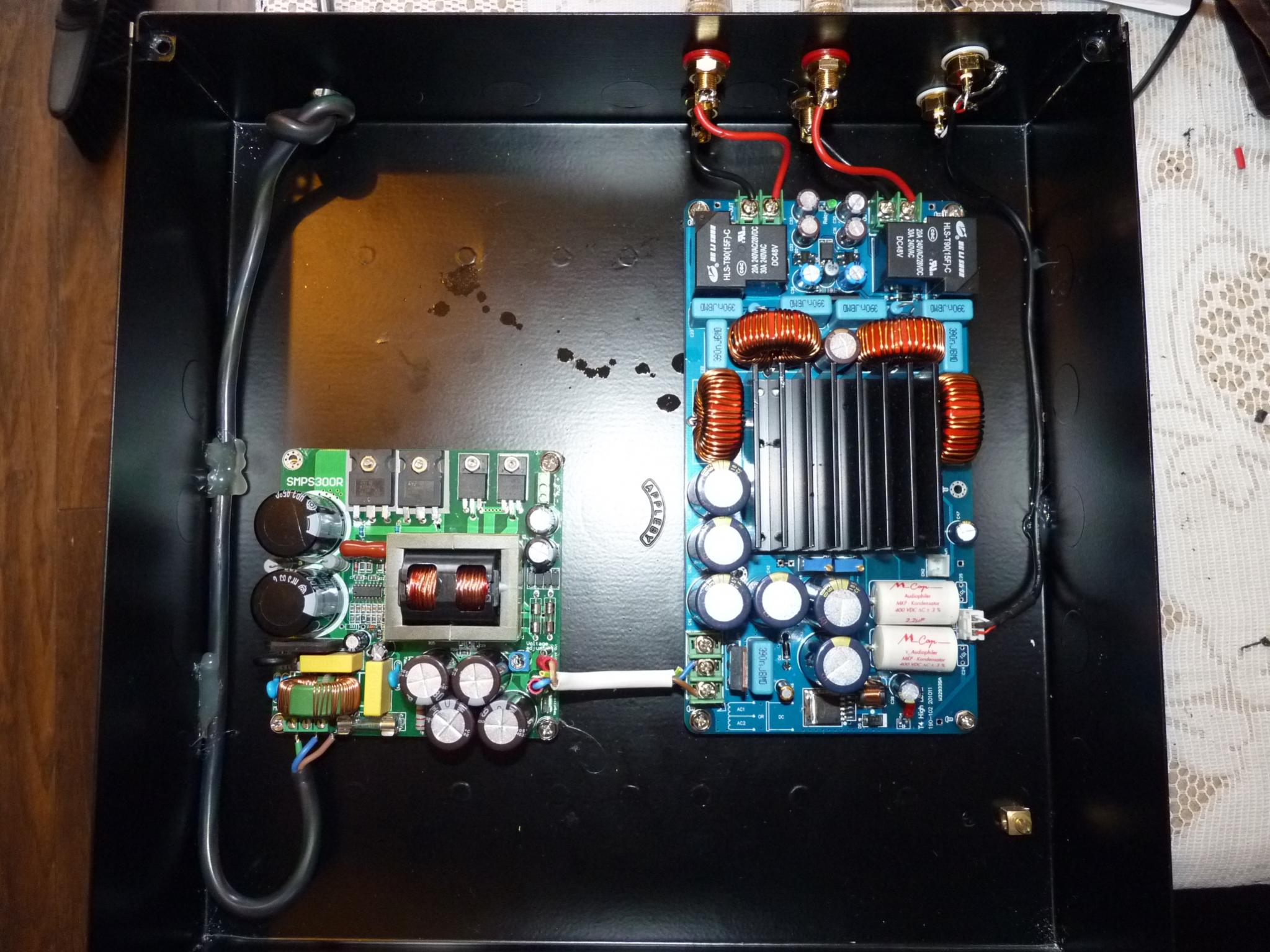

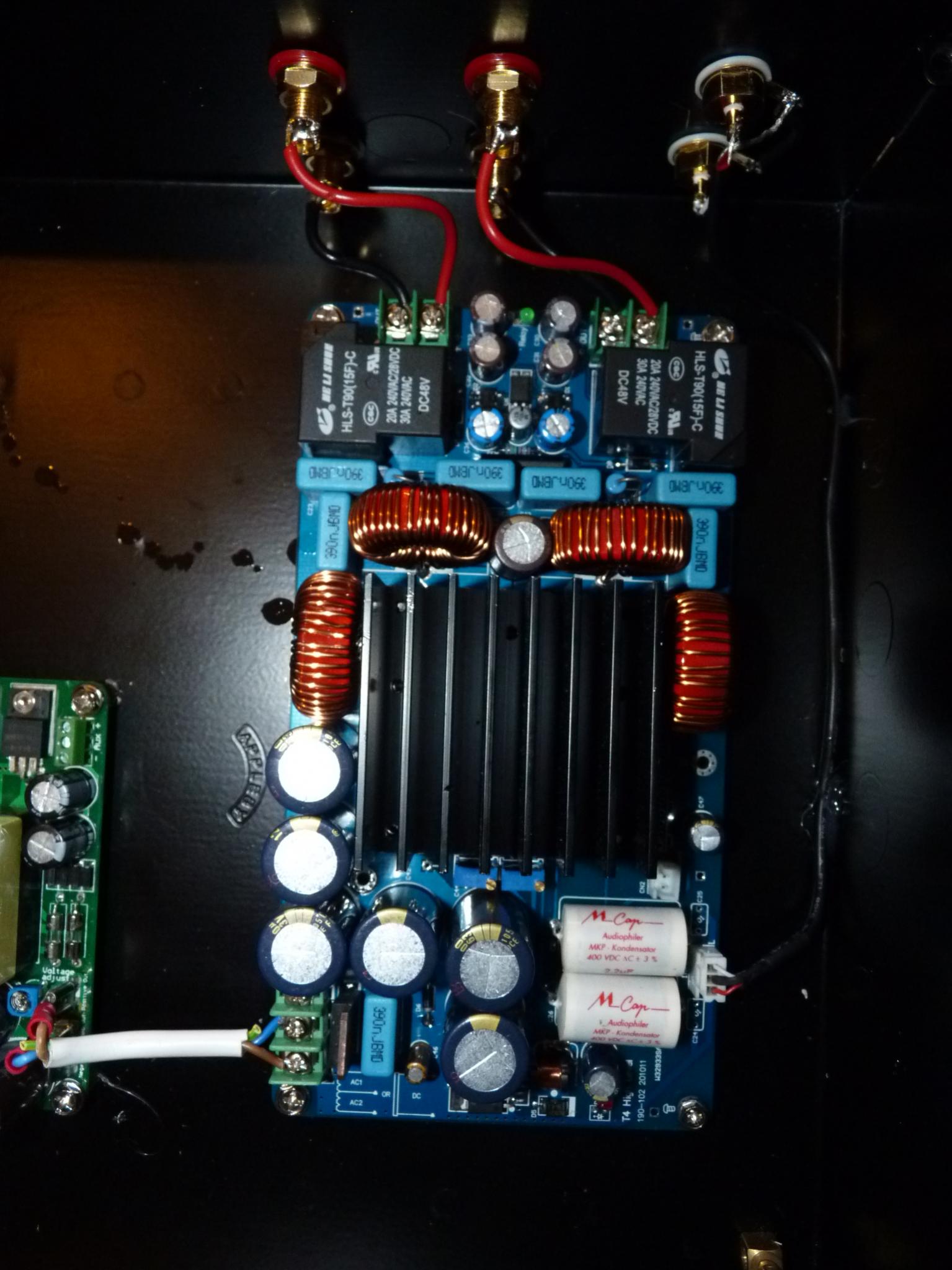

My first try at putting together this kit. apart from a little glitch connecting the power supply, it was an easy build for my first try.
i used the connexelectronics smps 300r 48v 230 volt. works a treat.
i would reccomend this to anyone wanting an easy first build

Very nice! Are you using it as a power amp? How do you like those Mundorfs? at least compared to the WIMA.

More mods, I decided to bypass the 5.6 uF input capacitors with .47 uF electrolytic and then a .047 uF polyester film. The outcome is pretty nice. The electrolytic provides a bit of nice texture to the film caps in the upper frequency. At least to my ears. The bass is really good too.
Get a couple of Mundorf M Supreme caps and probably wouldn't need any of this, but cost about $50--these bypass caps were already in my stock.
