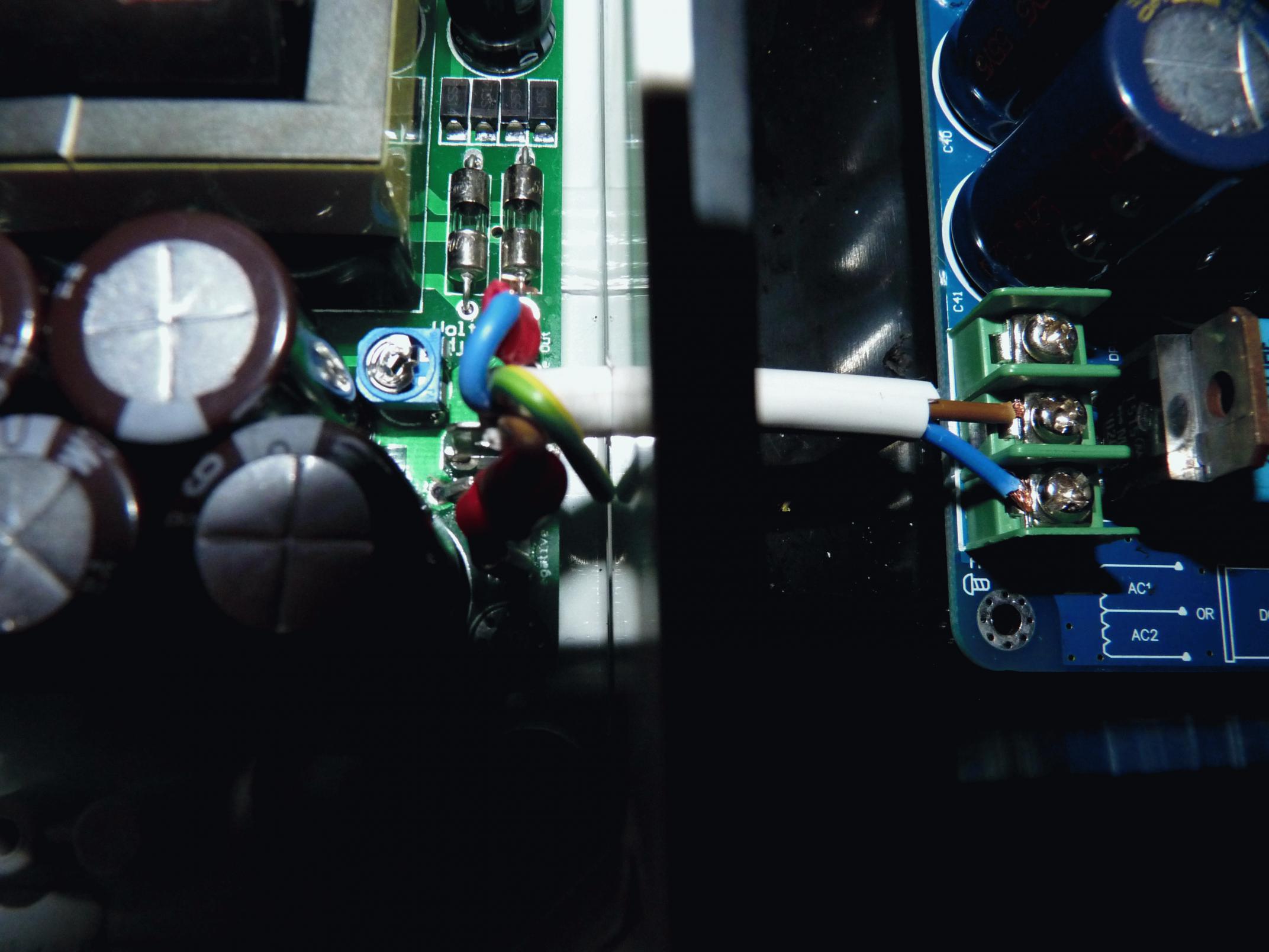

ok guys my Hifimediy T4 and Connexelectronic SMPS500R 48V 230V came today. I have wired it together as best i could, using some online pictures for help. The problem is that it is dead. there is no sound at all coming from the smps,I expected a little hum. none of the lights come on on the T4. can someone look at my wiring to see if I have connected it up right?
When I hold the SMPS with mains terminal in front of you, from left to right i have wired it Earth, Neutral, Live.ok guys my Hifimediy T4 and Connexelectronic SMPS500R 48V 230V came today. I have wired it together as best i could, using some online pictures for help. The problem is that it is dead. there is no sound at all coming from the smps,I expected a little hum. none of the lights come on on the T4. can someone look at my wiring to see if I have connected it up right?
I cannot see very clear but seems that the GND is not connected at all. if you are using the single voltage version, the GND is in the middle and the positive terminals are the first and third, which are connected together to double the output current capability. please read on the manual http://www.connexelectronic.com/documents/SMPS300R.pdf page 4 top.
another thing what i see, the output voltage adjust potentiometer lost it's hat. have you tried to adjust the voltage using a bigger screwdriver ? do not connect the smps to the amp yet, disconnect all the wires and check the output voltage without load. if the potentiometer was damaged, the output voltage might increase to about 120-130% of the nominal output voltage due to lack of feedback and the smps might enter in overvoltage protection mode.
if the voltage is fine, connect the amp, with correct polarity.
you was right Cristi. I connected the earth instead of the negative terminal at it began to work. Do I need to connect the negative terminal too, it appears to be working with just the positive and earth. Will this reduce the current or voltage if i leave unconnected?I cannot see very clear but seems that the GND is not connected at all. if you are using the single voltage version, the GND is in the middle and the positive terminals are the first and third, which are connected together to double the output current capability. please read on the manual .
I did try to adjust the voltage when it was not powering the T4. The white plastic cover popped off but the potentiometer still appears to work underneath. the white cover does not appear to clip back on.another thing what i see, the output voltage adjust potentiometer lost it's hat. have you tried to adjust the voltage using a bigger screwdriver

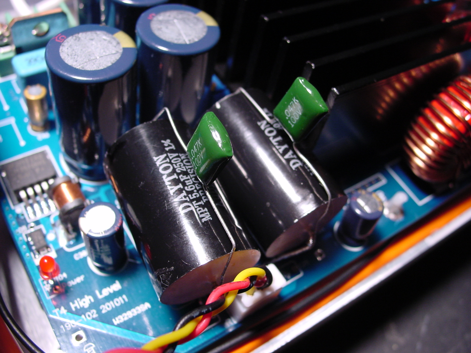

Mundorf caps? I was just searching for some Mundorf M cap Supremes for inputs on my T4. The WIMAs just wore me out, too much midrange and no texture, everything to me sounded glossy.
I settled for some Dayton 1% precision audio with polyester bypass and it is quite an improvement and may not even get the Mundorf now.
The T4 sounds astounding now and am having some friends over to show it off.

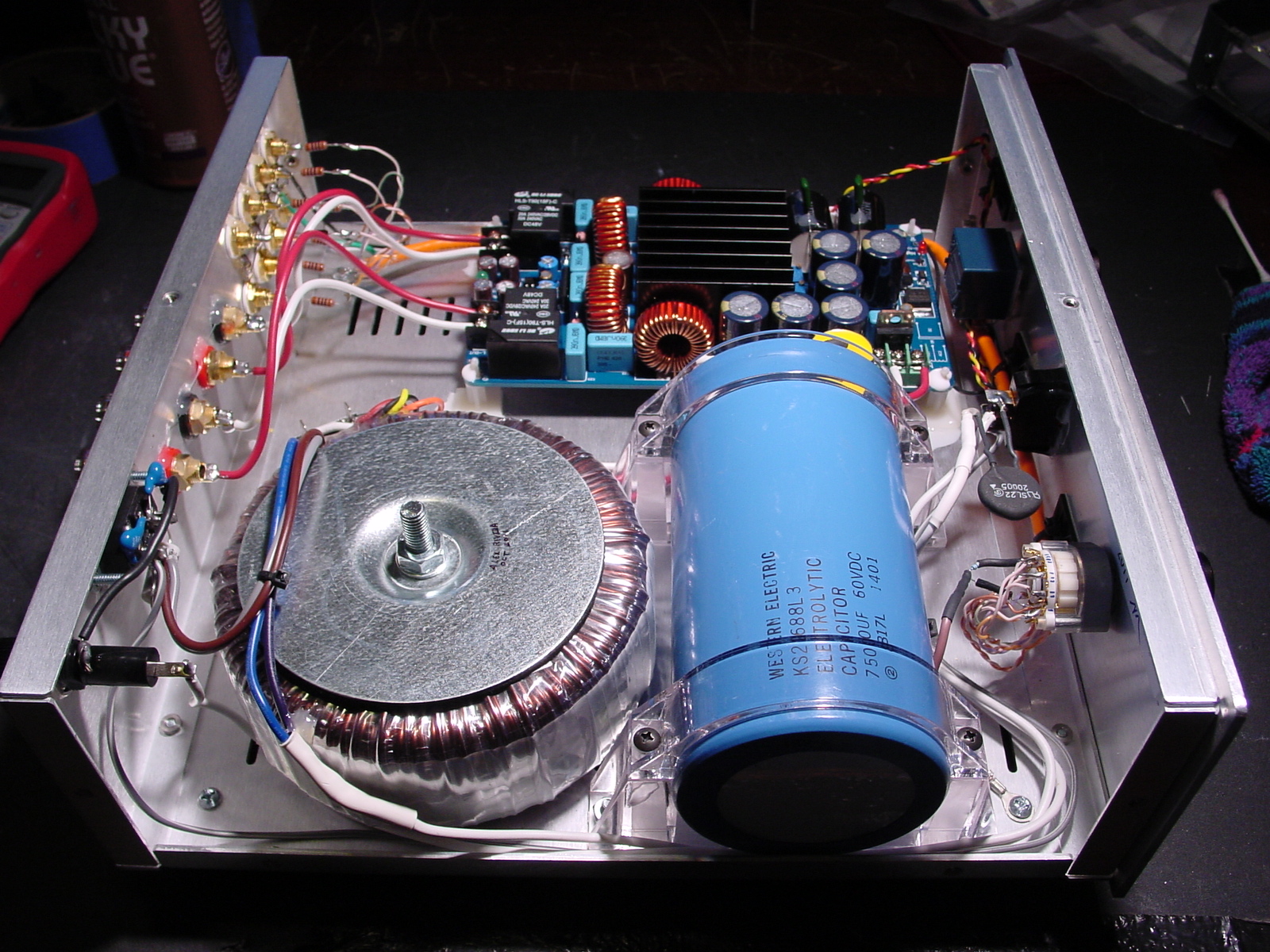

Almost 100,000 uF power reserve and a 500VA provide some generous and very tight bass, tighter than from anything else I own. There are some qualities in this amp that I just do not hear in anything else.
- Class D
- Hifimediy T4 board
