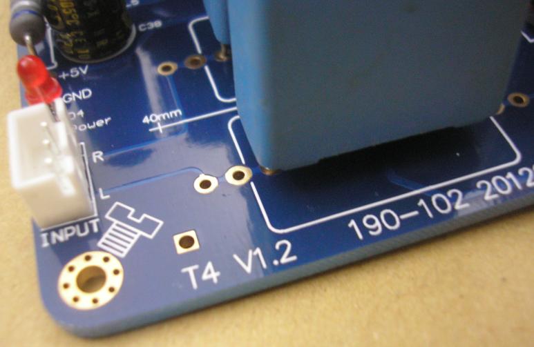

Hi Rod.
New version use same schematic as pre one.
Hi.
When will the new version be available? And what are the changes made (do you have a photo of the new version)? The board dimensions are the same as the original board?
I'm looking forward to buy this amp in the next few months but I'm wondering if I should hold the purchase back just to get the new version.
Best regards.
