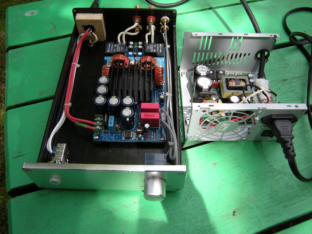

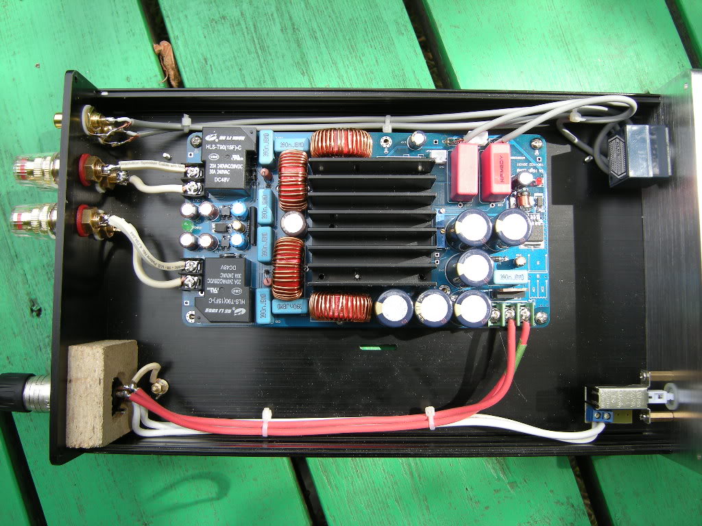

I recently got the HifimeDiy T4 amp and Connex SMPS300R 48v.
When googling for how to connect these, I cam across 2 project where the owners had posted pictures of the wiring. I am attaching 2 such pics.
One project is with a volume pot, and the other without.
I guess they must have done it properly as they seemed happy with their amps 🙂, but it does not hurt to check!
Can anyone please confirm if the wiring shown in the pics below is ok?
Also, any suggestions on the potentiometer value in case I want to connect one?
Thanks,
Zia

Hi zman01,
Please read alkasal's post with a diagram for SMPS300R to T2 connection. It can for your reference.
http://www.diyaudio.com/forums/class-d/164274-new-tk2050-board-197.html
Hifimediy T1 and T2 boards are using 50k potentiometer, I think you can use this value for the T4.

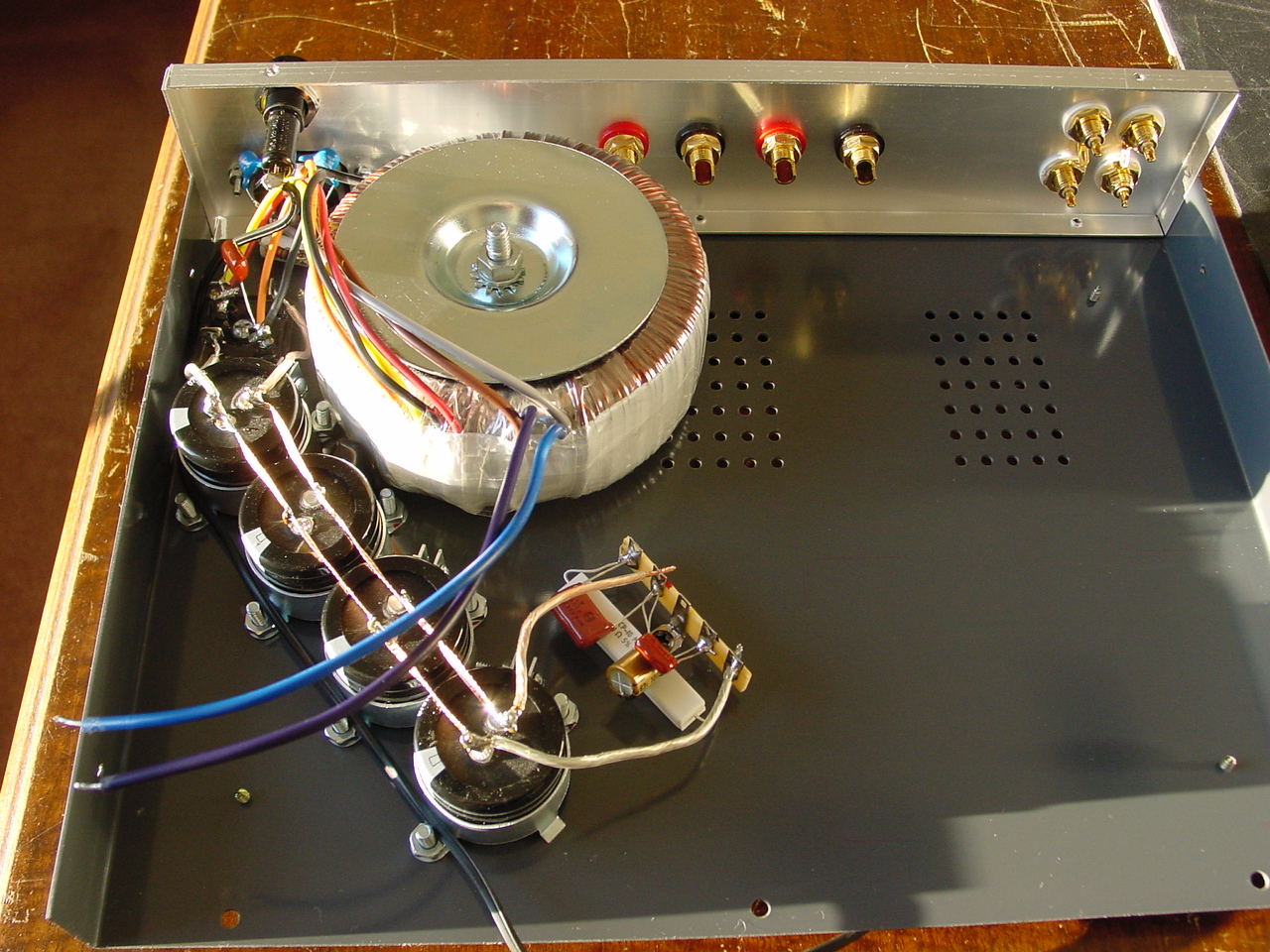

Well modified the toroid, removing a couple of windings. I was thinking about the nedt setup using two rectifiers, splicing the 0 volt wire. Use one 0 VAC with one 31.5 VAC on one rectifier and another 0 VAC with the other 31.5 VAC. Then each one to the big caps making aboutb 45 VDC each. Is it possible to combine the two to get the maximum current and thus power?
Hi CrashHouse,
I think the secondary output in your transformer will be like this; 34-0-34 and 0-18. You can check the wire/colour code label printed in the size of the transformer.
you can use "Full-wave rectifier, center tapper design" to produce above 34*1.41-2Vof rectifier dull~=45VDC for the T4.

Yes i checked and have two (modified) 31 volt leads, two 18 volt lead and one 0 volt lead. So if I only use one 31 volt lead with the 0 volt lead and rectify it this would make about 44 volt DC. But my main concern is would I make use of the maximum power of the 500 watt toroid if I don't use the other leads?
I think your transformer has 2 secondly AC output groups: the 1st group is 31-0-31, the 2nd group is 0-18. It is better if you can post the wire/colour code label to confirm.
You cannot use only one 31 volt land with the 0 volt lead to rectify a 44 volt DC. This is a Half-wave rectify and just provide half voltage. You should use both 31 volt leads and 0 volt lead to set up a Full-wave rectifier to product about 44VDC and fully utilize the maximum power of the transformer.

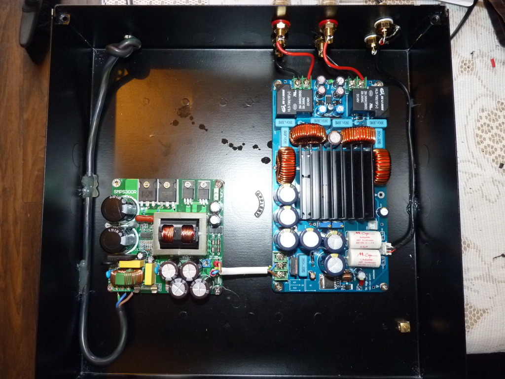

I built the power amp (without pot), working fineI recently got the HifimeDiy T4 amp and Connex SMPS300R 48v.
Thanks,
Zia
