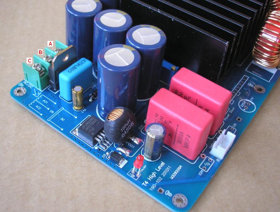

Can you folks help me identify DC + and -? I know it is terminals 1 and 3 but that is it. I am going to DC, AC is being fed now.
Thanks.
Thanks.
Do you mean onboard power terminals? I had the same problem 🙂 the picture near there is misleading... - in the middle and + in the right terminal;-)
P.S.:don't know why, but I cannot see the picture..

@ hifimedia: In the middle of your photo there exist 2 tiny little blue spindle potentiometers. Are they meant to adjust speakers DC-offset?
yes they are.

I got a second question: I found a good high end torroid with 2x40V 600VA
Highend Audio-RKT V-RKT-MS-SW vergossen - hifituning24.de
The 2x40V are load-voltage. The off-load-voltage might be higher, up to 2x45V, I guess. You mention that 2x40V is ok for the T4. Is this 2x40V what is printed on the torroid or is it real maximum voltage?
As the power consumption of the T4 is very low, the torroid will almost always run with 2x45V off-load-voltage. Are 2x45V too much for the T4?
Should I better purchase a 2x35V load-voltage torroid? This torroid would have off-load-voltage of 2x40V.

Hi, AC 40V is the limit of our board. it will be ok to use. But there is one thing you have to remember, some times the commercial power will be higher than normal, so, I think 35V will be safer.
Thank you.
I just studied some data sheets. A good 2x35V torroid has a no load voltage of 37,47V.
This is 7,05% more than load voltage.
The torroid is specified up to 253V input. This is 10% more than 230V.
With maximum input Voltage no load voltage is about 37,72V.
Both voltages are really near to the 38V the T4 is specified for and the T4 can stand them and there is a bit of reserve.
Using a 2x40V torroid there would be 43,03V no load voltage with a maximum of 43,34V at 253V.
This might kill the T4.
As a result this means that the diy builder if he chooses to go for a torroid should get a 2x35V type with as much power as possible and at least 450VA.
