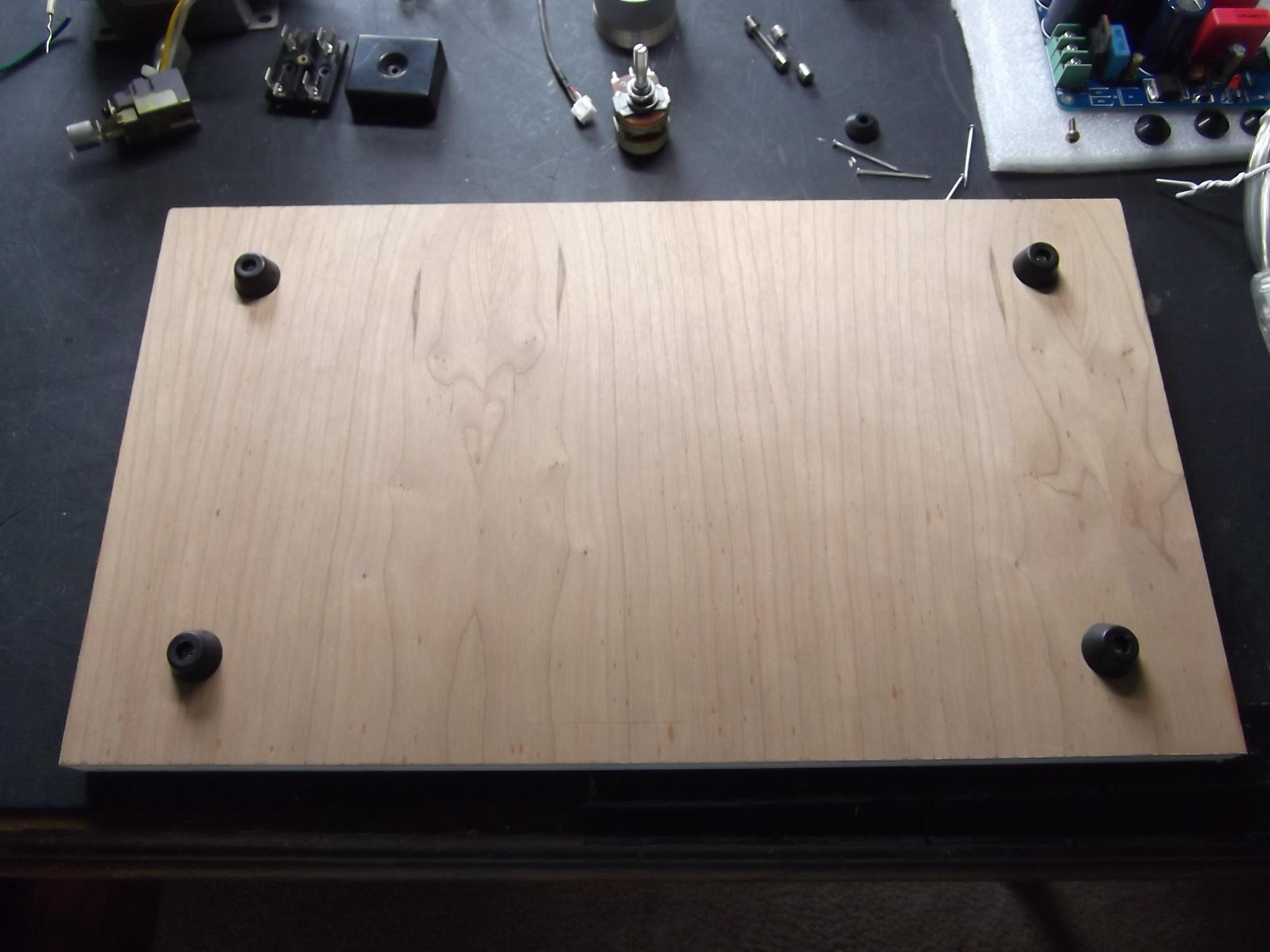

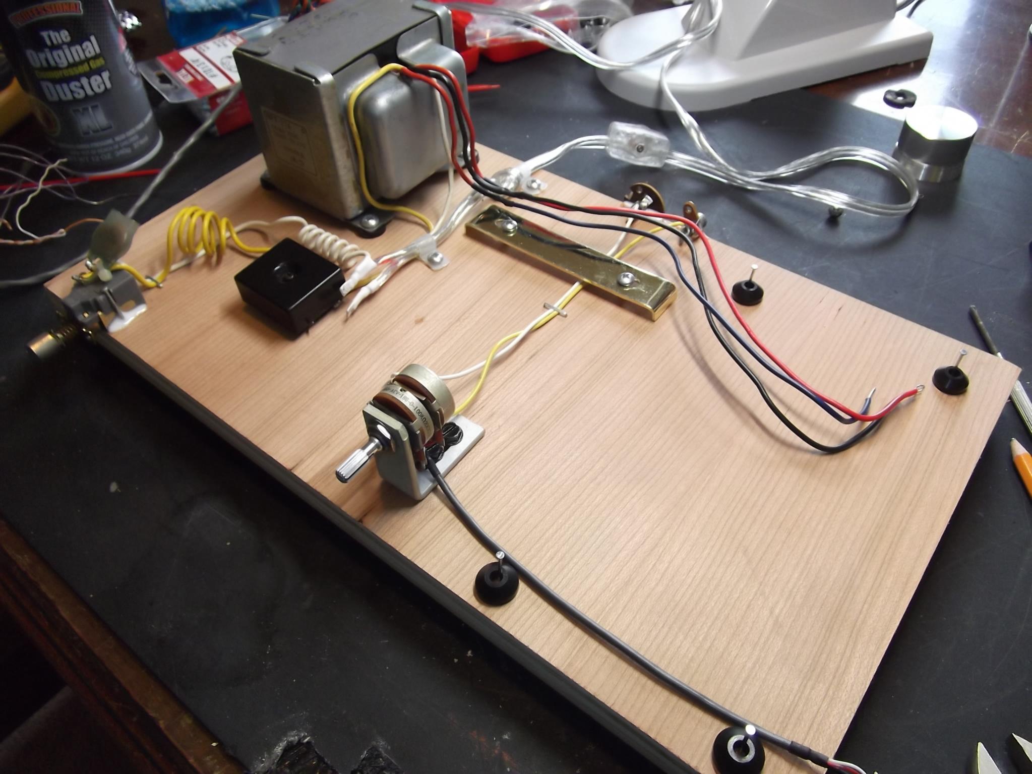

Recession Amplifier Ver. 1.1
The amp arrived yesterday...excellently packed.
While I select a case, toroidal, etc., I decided to go through my parts bin (junk pile) to build a costless prototype. I found a transformer on a broken Onkyo TX-31, has main output 31-0-31 AC, so cool, the T4 can work with this. Found ALPS switch and 100K ohm dual gang potentiometer probably from a vintage Sansui, some RCA inputs from a Hafler, an Aluminum knob from a Pioneer, and the ever necessary lamp cord. So here it is, 100% recycled parts prototype except for the HIFIMeDIY T4 amp board.
Tested voltage and set DC offset to zero, very easy and steady.
How does it sound? Incredibly good and powerful! 😀
The transformer is a bit warmer than I like, but it has no metal case to take the heat away.
Nice "Frankenstein-like"(because of the parts gathering!) implementation! I whish I had access to all these electronic materials!
Wait about 80-100h and you will see what this amp is capable of...;-)

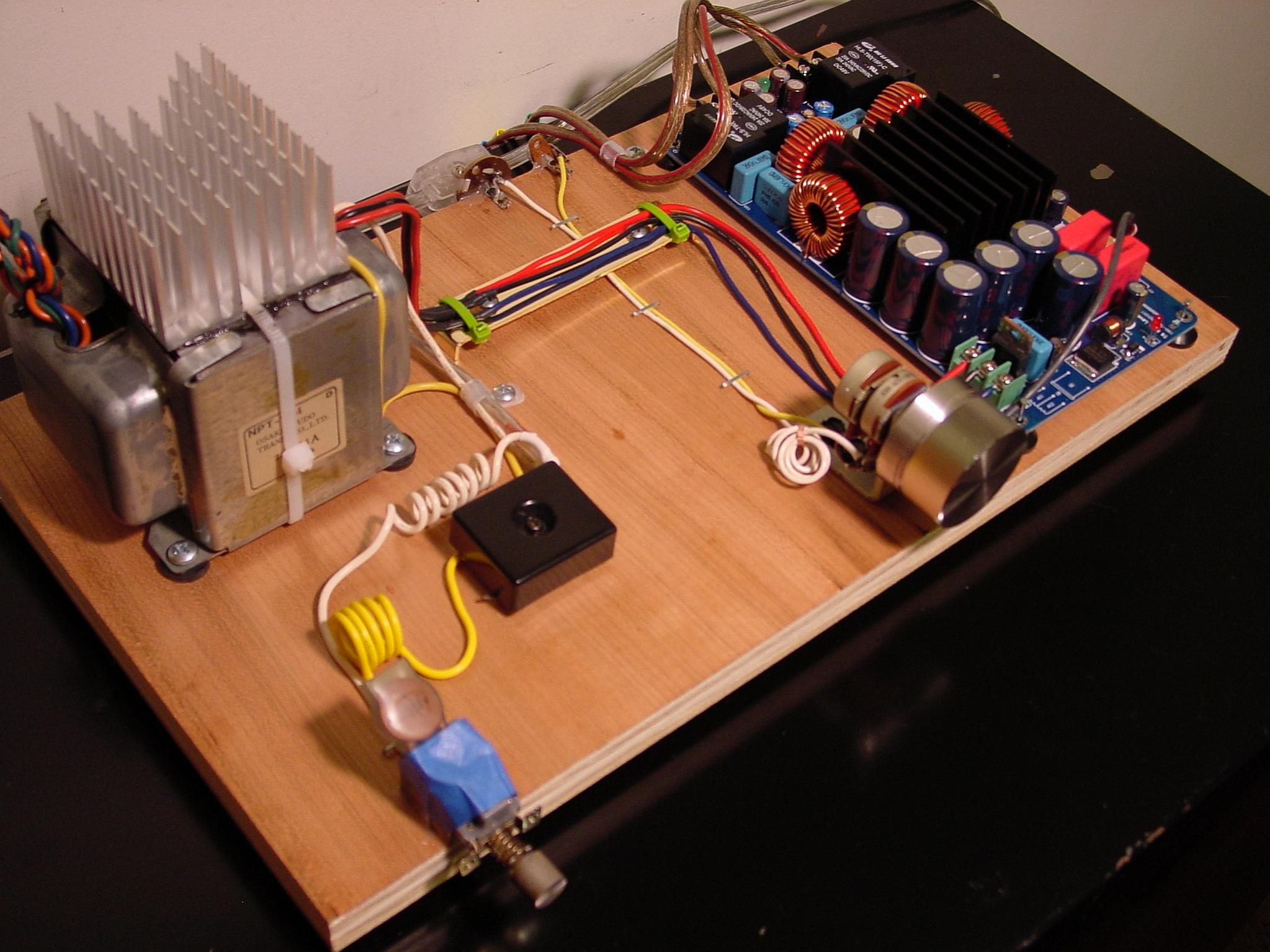

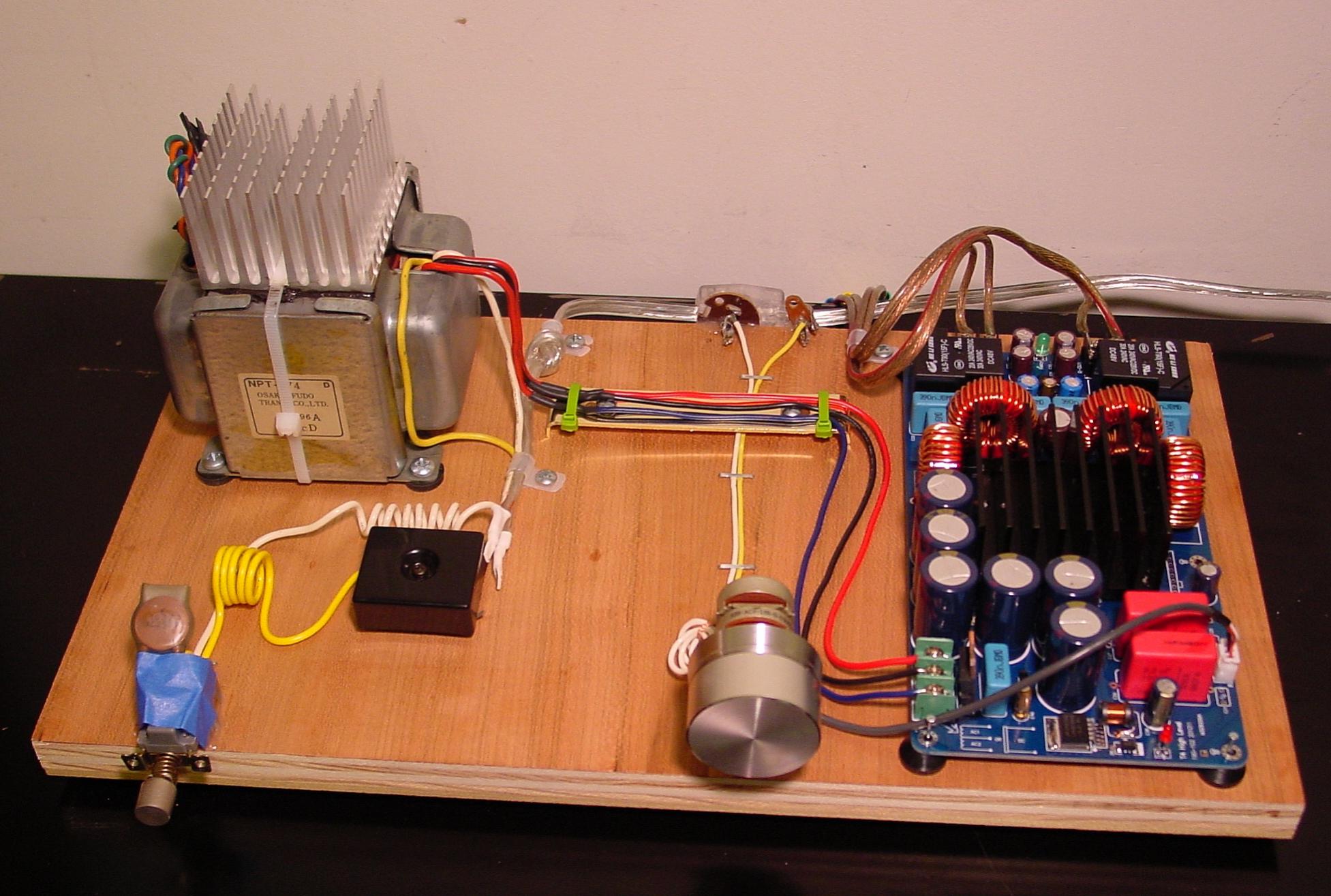

Thanks for telling us your impressions and sharing some pics. If I have more time I will target my T4 projekt again. My first built was more a quick test.

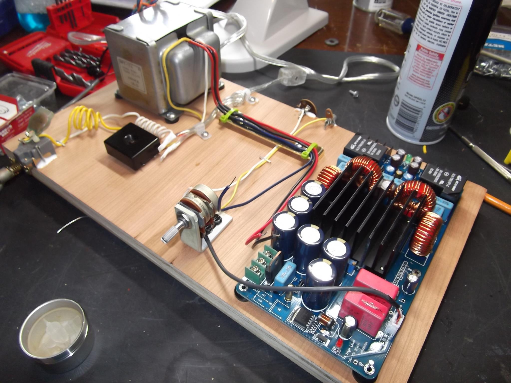

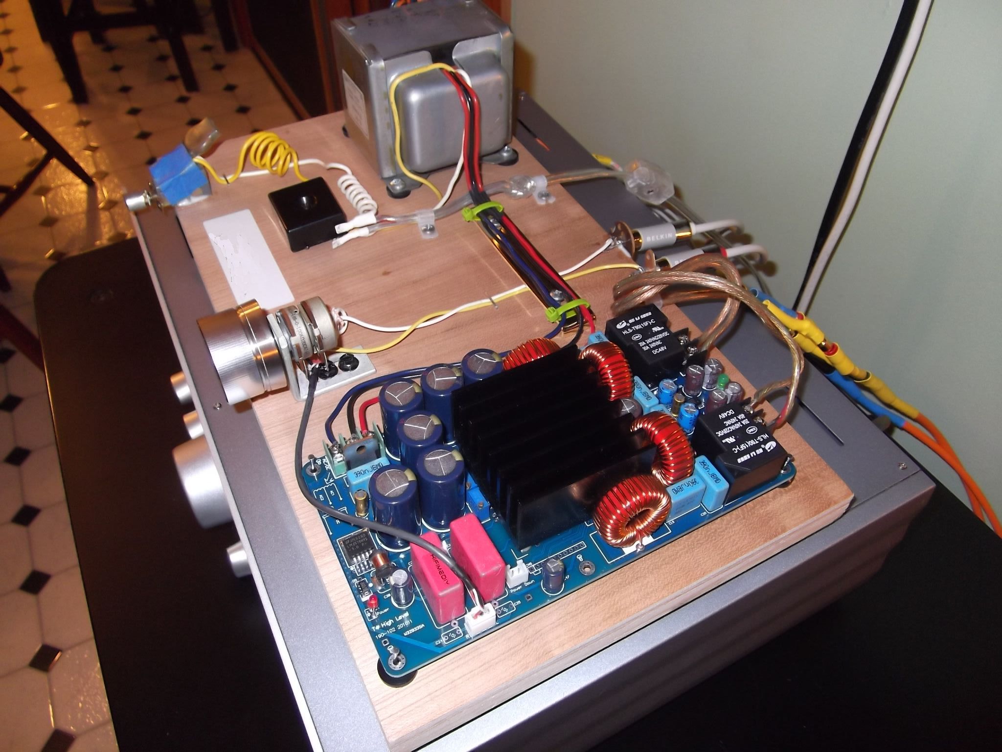

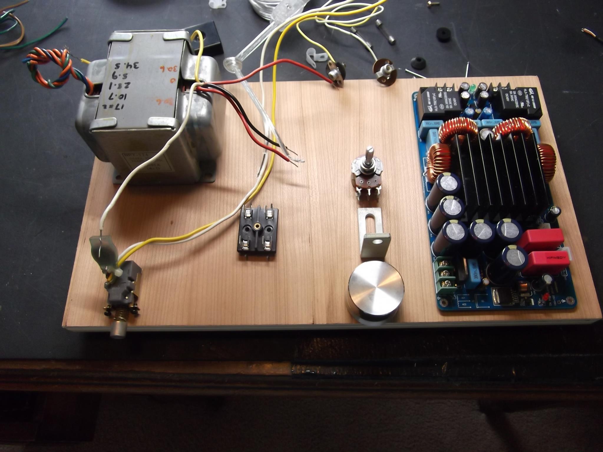

Thanks Jack and folks for the positive comments on the Franken-T. Its case arrived today.
So, what do you all think:
Option A: 330 VA toroidal
Option B: 500 VA toroidal
Option C: 625 VA toroidal
With:
1. Use the amp's own rectifier and capacitance, about 7,200 uF and feed AC straight from the toroidal.
or
2. Use my own rectifier bridge (heavy duty) and add 20-40,000 uF and feed DC into the amp?
I just don't know the amp draw of this amplifier, anyone measure it at over 1/2 output power?

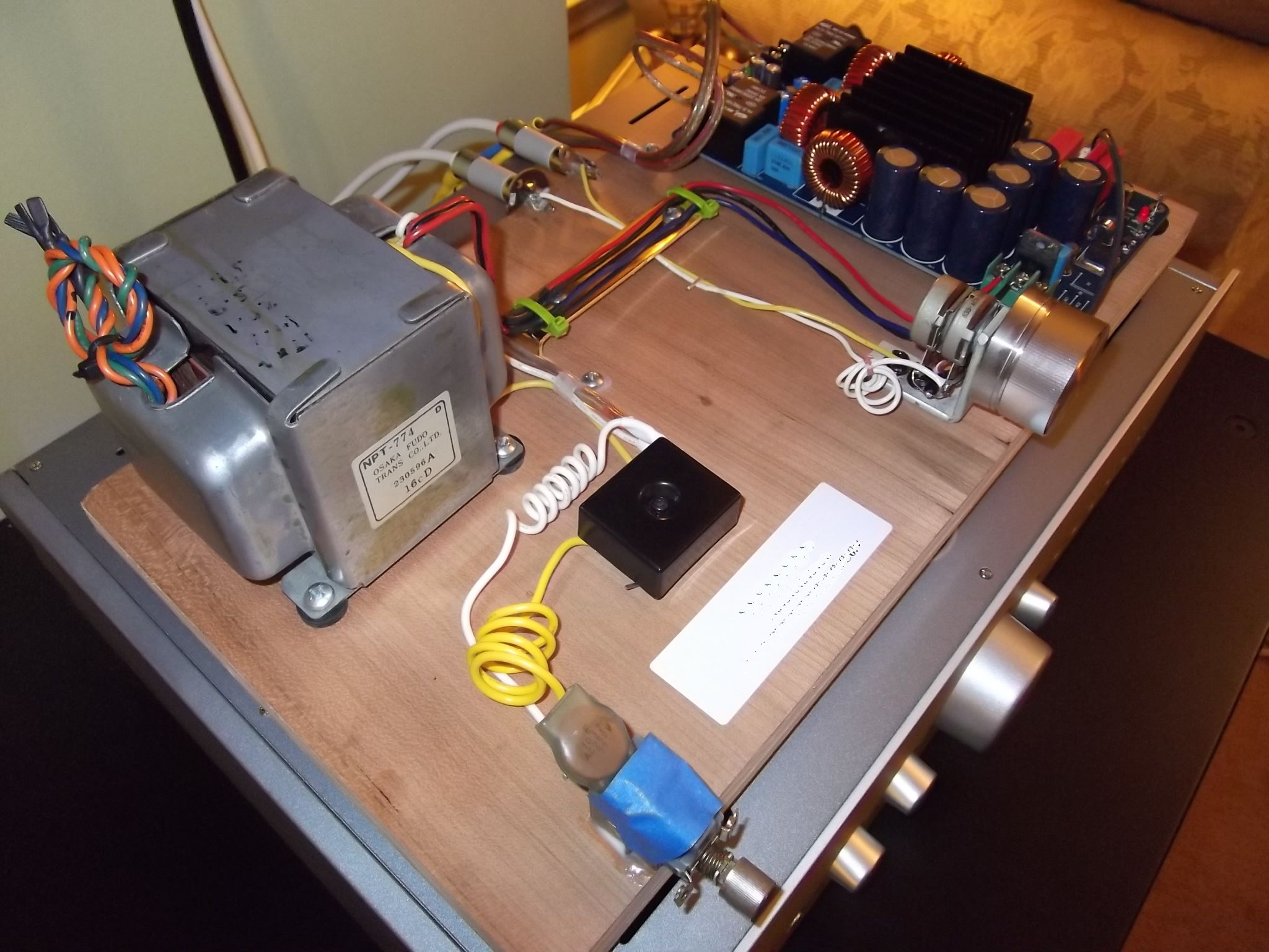

BTW, Franky got a heat sink. Pics below.
The amp draws at full power something like 400W (360W+360*10% of heat -assuming 90% efficiency). At half power shouild be around 200...250W...never measured.
Hence I would use 500VA toroidal. I think that 7200uF are too little...at least 4700uF more would have been acceptable. I would go with 20/40000uF. But -just as an experiment- try also without your alimentation board...I'm courious to know how much difference can be heard....I will wait your response about this...and an updated opinion about SQ, after 100h breaking-in. I heard SQ getting better exponentially.

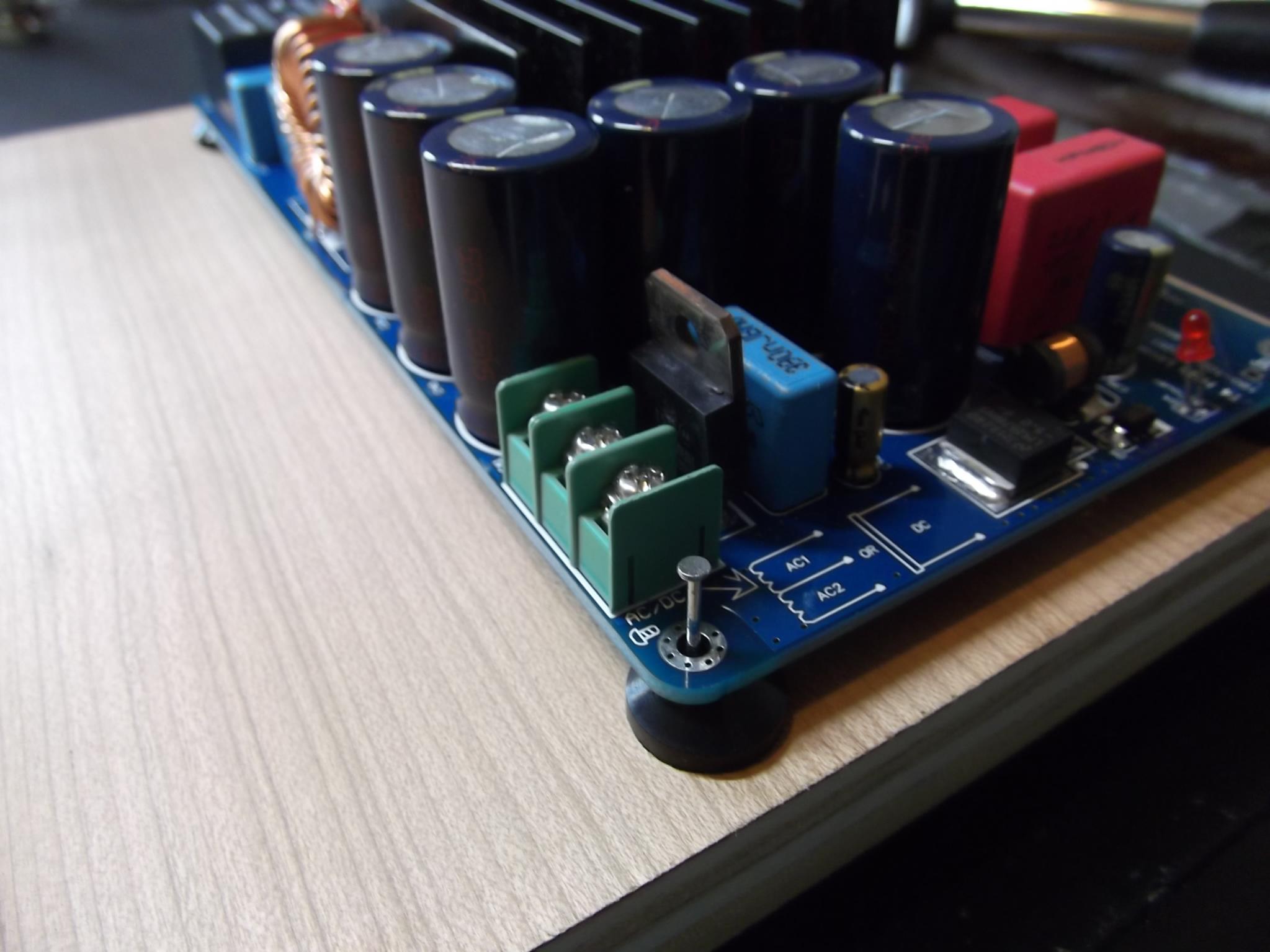

Whaleman, may I ask you for a photograph of the soldering site of the board?
Mainly of the power connection part.
If you want to add some uF, there are two ways:
-Use the build in rectifier and solder some cable to the bottom of the capacitor to support external capacitors.
-Unsolder rectifier and use external rectifier and capacitors.
