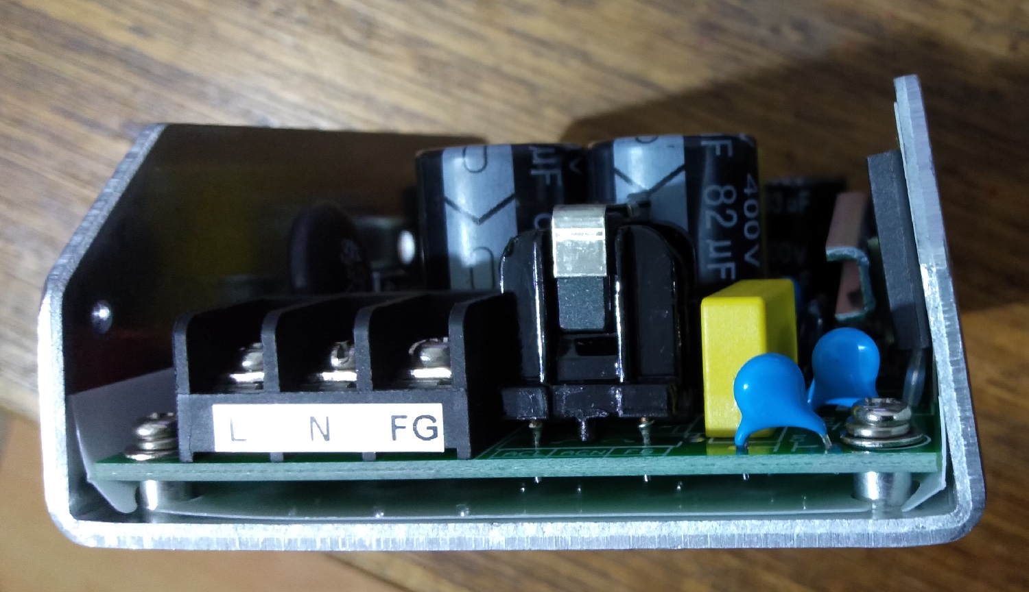

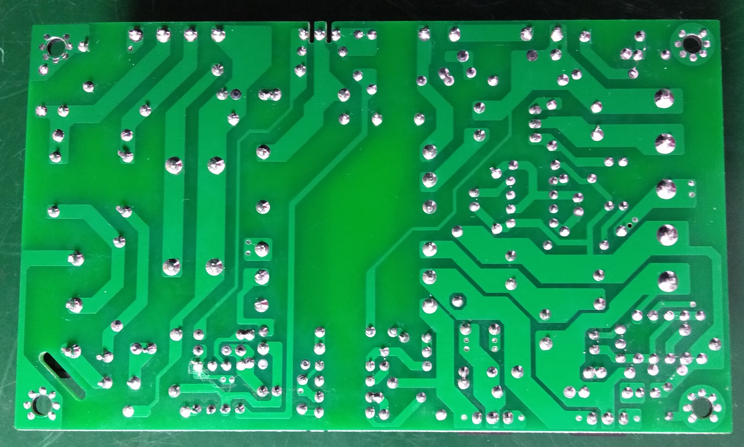

My power supply arrived today and had sustained some damage in transit so I have removed the PCB to inspect and have straightened the heatsink, in the next few days I hope to have the time to reassemble and test the power supply, apart from the damage the build quality does not look to bad.
It has given me the opportunity to have a closer look at the design.
some details are given below;
primary side
isolated 240VAC input
1 x bridge rectifier
2 x 80uF 400V electros
1 x LD7575 I.C.
1 x SVF12N65F mosfet
across the isolation barrier
2 x optocouplers EL817
Secondary
300VDC and 6.3VDC out
1 x optocouplers EL817
1 x NE555 timer I.C.
2 x DTV56F diodes
2 x MHCHXM MBR1060F schottky diodes
1 x power FET I cannot read the type
2 x 33uF 400V electros
2 x 2200yF 16V electros
2 x 1000uF 16V electros
I have not used a LD7575 my self so it will be interesting to see how it works.
Interesting use for high voltage damper diodes!
Has anybody a spice model for a LD7575?
I shall report back when I test the device.

The pad side earth track from input terminal to chassis corner looks a bit lean - is there a track on the part side?
Good luck if you get keen to make a schematic.
Well spotted, I normally have a secure earth terminal from the IEC socket to chassis so it should not be problem in my case, I have noted the LD7575 PWM controlled I.C. is on the opposite side of the PCB to the power FET it is driving, it will be interesting to run the scope over it, the track to the gate is about 7cm long it is in series with a 47 ohm gate drive resistor, the resistor is bypassed by a diode.
I have a decent isolating transformer and will use it when scoping the hot side of the cct.
The power supply from pictures is weak because it's a flyback not a half-bridge . Max 150W but even this could be very optimistic . If is the same as the one discussed before , protection trips and issues with cold filaments and +B are to be expected ... maybe usefull for preamplifiers or simple low power single ended amplifiers .

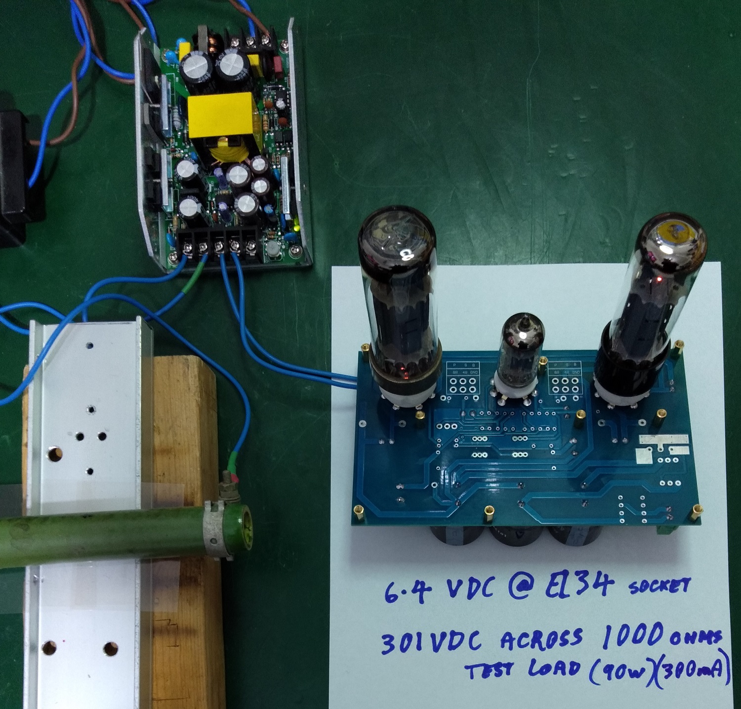

First tests:
Fitted a 2.2 ohms resistor across the 6.3VDC output,
Turned on the 240VAC to the power supply.
300VDC was measured at the open circuit HV output.
5.74VDC was measured across 6.3VDC output.
Turned off and fitted a 500 ohm 200W load on the 300VDC output.
Turned on, the power supply failed to start (hiccup mode) so I turned down the output voltage pot and the device started at 260VDC output, I slowly turned the pot up to maximum and 301VDC was measured across the 500 load using a Fluke DMM, this equates to 600mA, the maximum power specified. 6.4VDC at the 6.3VDC output.
After running for 5 minutes I could only hold my finger on the flyback transformer for 10 second and the heatsink was getting hot to touch next to the switching FET. The test was stopped as the power supply will be never used at 600mA output.
Second tests:
Two EL34s and one 12AX7 were connected to the 6.3VDC output, the cold resistance of this circuit was 0.3 ohms. A single 1000 ohm 100W resistor was used to load the 300VDC supply to 300mA. The power supply started and was left to run for 1 hour.
At start up the HV was at 301VDC, and 6.3V supply measured 6.4VDC at the base of one EL34.
At the end of the hour the HV supply had dropped 1 volt and measured 300VDC.
I could only hold my finger on the flyback transformer for about 3 seconds, the heatsink was warm not hot. After turn off when the caps were discharged I used a finger to test capacitor temperatures all were warm with the two 16V 2000uF caps the hottest.
Switching frequency 65kHz with some RF on the outputs so some additional filtering will be required.
I will only have a 200mA load on the HV and a 3.15A load on the 6.3VDC output and think it may be best if I fit a small very quiet 12V fan just to move a little air through the power supply.
At higher power levels I think the fan would need to work harder.
The 12.6VDC (4A) output was not tested under load, if I use it it will only be to run a micrcontroller PCB with relays, I find a micro uses less parts than a 555 timer.
Power supply part number : LCT250-0612300-52
BTW I had to place a small fan on the 100W resistor as it could melt solder.

It is a cold morning here in Adelaide when I turned it on for an extended run with a fan to see the change in temperature from yesterdays run it went into hiccup mode, I disconnected the 6.3VDC out put and P/S started and continued to do so after reconnecting the heater load. As I don't want to modify the power supply I will draw up a small relay PCB with a PIC micro on it so I can do a controlled timed start up, this will give me control of the start up sequence and any thing else I want to control.
I use PCBway and ten 100mm x 100mm PCBs landed in Australia only cost about $50. I should be able to fit a 3 relays a PIC and a couple audio optical isolation circuits on a single PCB. I have lots of small PICs around and some small relays left over from my tube tester. I will use some of the blue relays shown here. Ken's Tube Tester
I may be able to fit a couple input transformers and a buffer on the same PCB in case the opto does not work out.
The power supply has been running for 35 minutes with the fan on and the heatsink and flyback transformer are only just warm, a good result indeed.
6.3V load 2 x EL34s and one 12AX7
300V load 1000 ohms.
