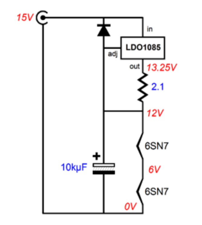

I see, a filament can be 1 ohm cold and 40 ohms hot!
A cheap 1A switcher wont complain if you tack on a little current source board. With this you don't even need to buy a grossly oversized amperage switcher, just one with enough voltage to overcome the drop out. The voltage trimmer on the switcher could be handy getting the drop out margin optimized, not sure. This arrangement shouldn't be used with Filaments wired in parallel though, because if you remove a tube or a filament blows, the remaining tubes will be given a gross overvoltage as the CCS raises the voltage to maintain the original current set point, then you burn out all the remaining Filaments. A very bad failure mode, but for series Filaments every failure mode I can think of seems pretty safe.
Or kang a voltage regulator and a current limiter together and you don't have the issue of one tube missing.
I made something similar for the B+ using a 500V 6A depfet. I just don't think I should have to build work-arounds for a purpose built supply. 🙂

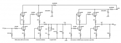

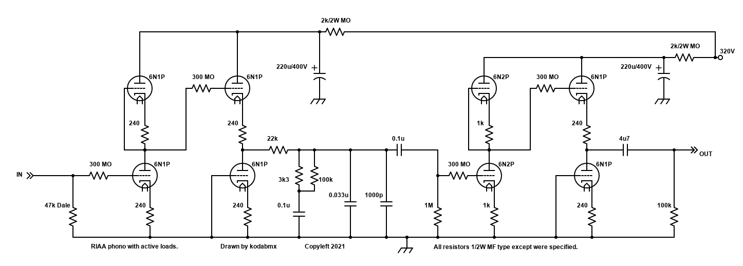

Removing the 220uF caps from this circuit results in a crosstalk from L to R channels, and generally poor performance. Combine this with a line stage, tone controls, and buffers? All should have zero PSU decoupling caps? I don't think so.
