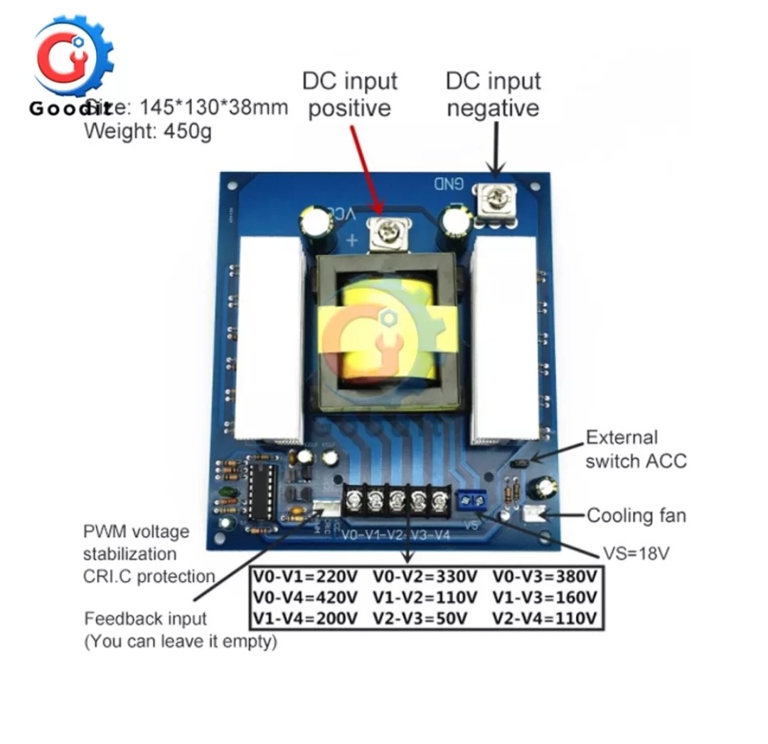

I like the convenience of using this SMPS but I wouldn't be happy if it went through multiple hiccup cycles every time I turned the amp on or if it shut down due to a solid bass transient. So I'm happy that it works with my circuit.I go from B+ > 100R > 47uF - push pull trioded 6P43P driven by 6F12P - 6 tubes and ~200mA, Heaters run in series parallel from 12V. 6V is not connected.
I can hear a faint switching hash but that's probably a ground issue.
If I had those issues I would be experimenting further in hopes of eliminating them but, as always, YMMV. Perhaps you find them acceptable.
If not, I'd start with reducing the cap value significantly or even eliminating it. I'd also try wiring the heaters to run off the 6.3v output since my experiments seem to show that using the 12.6v requires you to either turn the voltage down or endure repeated hiccups.
I'm guessing that the higher current draw (200mA vs 100mA for my SE circuit) is not the issue.

The fact that it's only on power up, and that the amp needs to be at full power to the point of clipping to drop out doesn't bother me - it's the lowest power amplifier I've built.I like the convenience of using this SMPS but I wouldn't be happy if it went through multiple hiccup cycles every time I turned the amp on or if it shut down due to a solid bass transient. So I'm happy that it works with my circuit.
What would be nice is if somebody made an SMPS with 12V @ 20A and 300V - 400V @ 2A - Then it would power a PP 6P45S amp
From what I've seen using the 6.3v tap instead of the 12.6v to heat the tubes will likely eliminate the hiccup issue. But maybe you don't want to bother with changing anything.The fact that it's only on power up, and that the amp needs to be at full power to the point of clipping to drop out doesn't bother me
What about an ATX PSU + this thing? Rated at 1KW, 300V/2A is close to the Aliexpress' special 50% power ratingThe fact that it's only on power up, and that the amp needs to be at full power to the point of clipping to drop out doesn't bother me - it's the lowest power amplifier I've built.
I designed my boards to use 12V since it's far more common - the heaters for 6P43P run in series, the 6F12P runs off of a 7806. So I can't really use the 6v3 output.From what I've seen using the 6.3v tap instead of the 12.6v to heat the tubes will likely eliminate the hiccup issue. But maybe you don't want to bother with changing anything.
I have one, and I've used it to power a PP 6P45S amp. It would just be nice to find a one PSU solutionWhat about an ATX PSU + this thing? Rated at 1KW, 300V/2A is close to the Aliexpress' special 50% power rating View attachment 1243636
