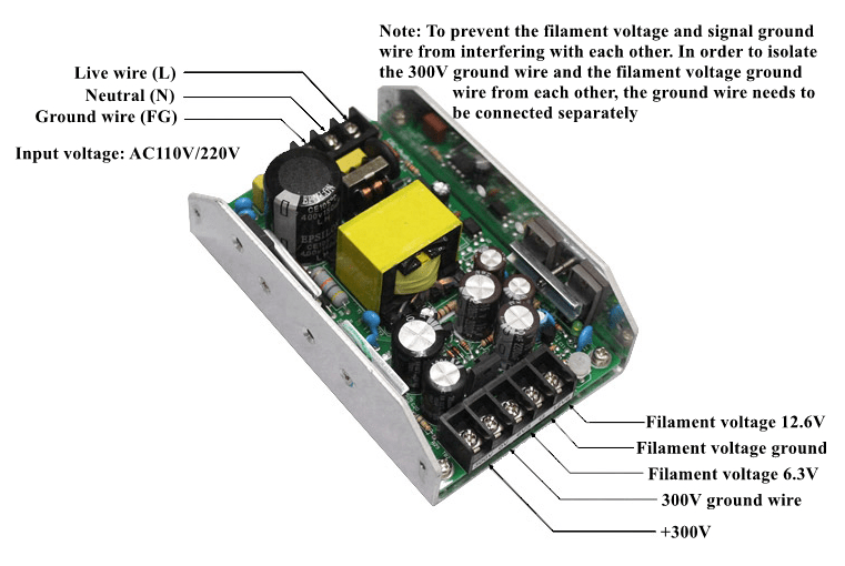

I bought one of these SMPS units a while back but have never used it. I've got a different project on the breadboard now so I'm not ready to start experimenting yet, but I'd like to clarify a few things.
I'd like to try using it to power a simple SE amp using 2 output tubes and no more than 2 input tubes. Outputs would likely be something like 6BQ5, 6V6, 6AQ5, 6N6G or similar.
An earlier post mentions that having a load on the 12.6v output is needed in order to maximize the level of HV output. In my current project I'm using a 6AX4GTB damper diode as a soft start device in a so-called "cockeyed bridge". The SS diodes take care of the rectification, the tube is fed DC and produces a slow start.
So I'm wondering if I could use the 12.6v output to heat a 12AX4GTB and use it as a soft start device? Would using a damper diode for soft start make it easier or harder for the HV supply to start up?
It wouldn't bother me if it resulted in an additional startup delay on top of the stock 30 seconds. But I'd like it to start up without having hiccups or re-starting repeatedly.

Unless you modify it, the HV is delayed by 30 seconds or so so the damper will already be hot when it tries to start the HV section...
Perhaps I don't understand how the slow start aspect of the damper works. So you're saying that, once its heater is fully powered up and its cathode is fully heated, the damper won't slowly increase the DC from the HV tap? The load would see the full voltage immediately after the 30 second delay?Unless you modify it, the HV is delayed by 30 seconds or so so the damper will already be hot when it tries to start the HV section...
I guess it would make sense that the soft start characteristics of the damper (or indirectly heated rectifier) vary depending on the design of the cathode with some taking longer than others to reach full emission.
If that's the case a better way to load the 12.6v output would be to use a mix of 6.3v and 12.6v tubes.
The 12AX4GTB warm up time is -~11s. When your HV is turned on after the 30s delay there will not be a soft start, the damper diode will be ready. You will have to remove or reduce the HV delay.

I'd recommend just using the smps as is. Connect the output tubes in series to the 12.6V output, and the input tubes to the 6.3V or 12.6 depending on the heater requirements.
Soft start is not reay needed for such low voltage, and you already have an HV delay.
Yeah, I wasn't all that concerned about the soft start aspect. I just thought that perhaps a damper diode would alleviate some of the startup issues while also loading the 12.6v output but I see that's not the case.
So is it best to run B+ right off the supply and add an RC for the inputs or will it work better if I add an RC prior to the B+ and follow it with another RC to the inputs?

I've seen this advisory note about how to hook up the grounds "separately" but I'm confused about exactly what it means.
Another question . . .

I'm mostly just trying to figure out how to hook it up so that it operates as smoothly as possible, which ideally means that it starts up after the 30 second delay without hiccups and re-starts.
Some posts say to just run the B+ directly from the 300v and then use an RC section to supply input tubes. Another post says it worked better running 100R into 100uf (to B+) followed by 10k into 50uf (to input tubes). And other posts warn against using too large of a cap to supply the B+, but I got the impression that this referred to putting a large value cap right after the 300v output with no R between them.
I assume the 300v ground connection would be to the negative of the cap?
So I'd like the hear about other's experiences and how they have the HV portion configured and if their startup is smooth.
Also, if I was heating the tubes with a normal filament winding I would run the heaters in parallel using a CT filament transformer with the CT providing a ground reference.
How would the heaters be wired in order to use a mix of 6.3v and 12.6v tubes when there is only one shared heater ground?
For example, if I was running two 6.3v tubes and two 12.6v. Would one heater pin of each 6.3v connect to the 6.3v, one heater pin of each 12.6v connect to the 12.6v connection and then the other four heater pins connect to the common heater ground? Is that ground connection then grounded to signal ground or is it left floating?
As I understand it, unless the tube is a rectifier, the heaters need a ground reference. Yet that seems to create a dilemma because the "note" in the diagram says that the HV ground and the heater ground need to be "isolated" from each other and connected "separately".
Would a ground buss with the HV ground connected to the cap negative at one end and the heater ground connected further away be considered "isolated" from each other and connected "separately"?

Could anyone comment on the basic questions I posted about how to physically hook this up?
RC to B+ or B+ straight from the 300v output? How to wire a mix of 6.3v and 12.6v heaters when the two share a ground connection on the SMPS?
The technical issues involved in the question of whether a film cap or electrolytic would be best is something that I'm not so concerned about right now. Some info about the cap values that people have used with this would be informative, however.
