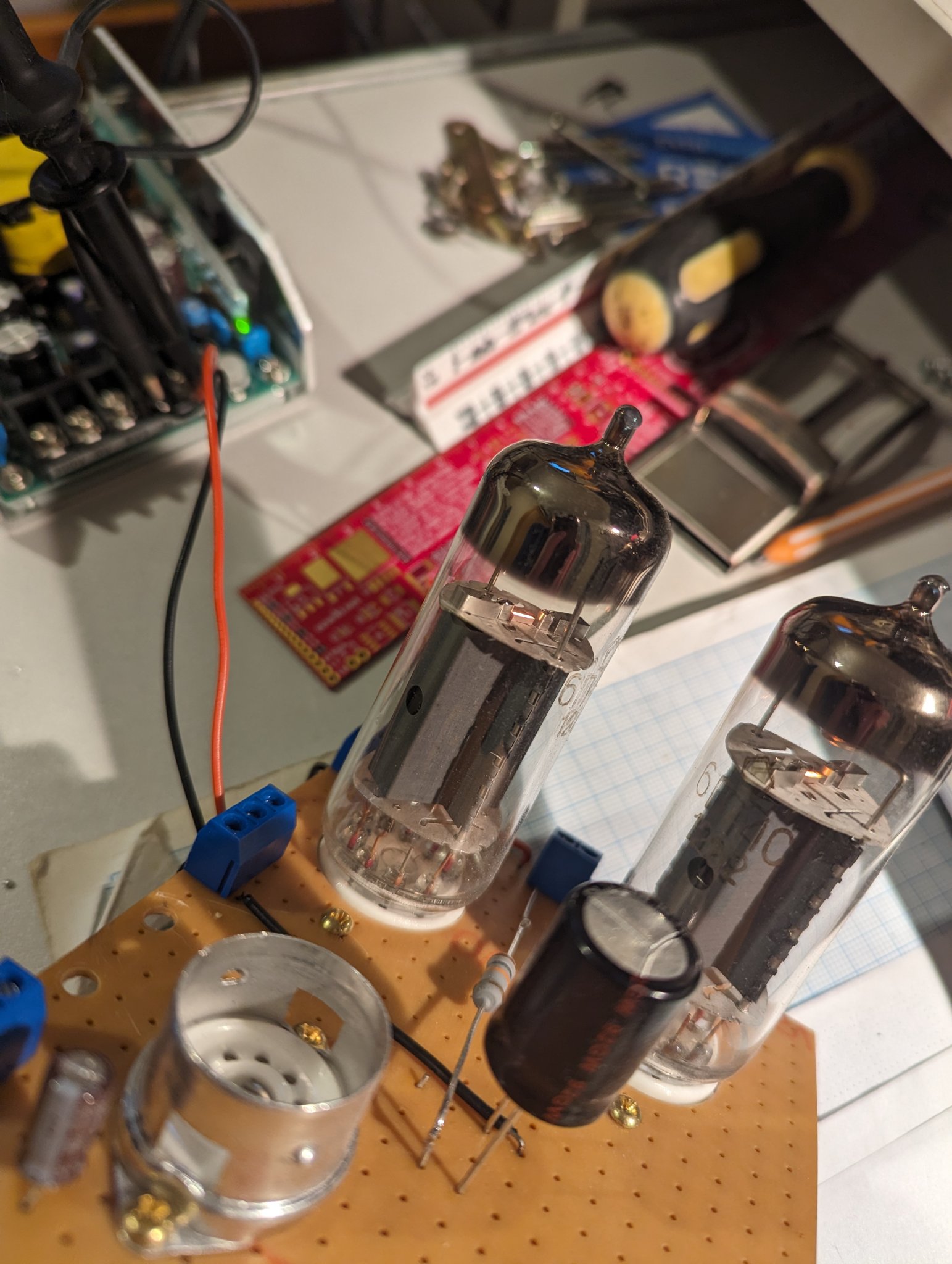

So I'm using this SMPS on the breadboard running a simple SE circuit. First version used 6N6G output tubes and a single 6SN7 input tube. Later I switched to 6V6 outputs using the same input tube. I'm using the unit in stock form, no mods to the HV delay. I'm running the B+ straight off the 300v and then using a 1.8k resistor and 22uf cap to supply the 6SN7 plates. I just hooked it up and it worked immediately without issue.
High voltage comes up without any hiccups with less than a 30 sec delay. There's a very subdued "thump" when the HV comes on but I'm not concerned about that.
I'm running the heaters in parallel off the 6.3v and they are floating, the 0v heater connection which is shared with the 12.6v only connects to the tube pins, not to ground.
Unless I misunderstood, earlier someone said that the 12.6v heater connection had to be loaded for this SMPS to function. I have not found that to be the case. There is no connection to the 12.6v.
In fact, I'm having problems whenever I use the 12.6v connection, which is what I'd like to ask about.
Earlier I was using 6N6G output tubes instead of 6V6s and I decided I would try using a 12SN7 in place of the 6SN7. So I wired it with the 12.6v to one pin and the shared 0v to the other pin. Floating, no ground, same as the all 6.3v setup.
When I did this it would go into hiccup mode. I tried grounding the 0v connection but the results were the same. After changing the outputs to 6V6s, which draw less heater current than the 6N6Gs, the results were the same. I then tried running the 12SN7 with 12V6 outputs. Heaters wired exactly like the all 6.3v version which works fine . . . heaters floating with nothing connected to the 6.3v. Still goes into hiccup mode.
Excessive heater current draw doesn't seem to be the issue. The combo of 6SN7 and two 6N6Gs draws a total of 2.2A and the 6SN7 / 6V6 combo draws 1.5A. By contrast, the 12SN7 / 12V6 combo draws the least current at 0.75A.
I would like to have the option of running the 12SN7 / 12V6 combo since the tubes are so cheap. Any idea how to make the 12.6v output behave like the 6.3v one does?

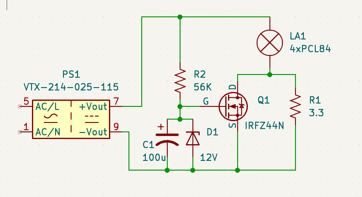

The header SMPS needs twice the rating of the heater current. When cold they draw a lot more current.
The 6.3V is derived from the 12.6V output (or at least that is claimed in Aliexpress), therefore loading it will load the 12.6V. And it is not strictly required, but the HV will be lower if you do not load the heater output. I definitely saw that, reported to the seller that the HV was too low, and he explained that I needed to load the heater output for the HV to give the expected voltage.Unless I misunderstood, earlier someone said that the 12.6v heater connection had to be loaded for this SMPS to function. I have not found that to be the case. There is no connection to the 12.6v.
The 12.6V output is rated at 4A, it should easily handle 0.75A cold heater.The header SMPS needs twice the rating of the heater current. When cold they draw a lot more current.
This is strange, when I tested mine I used a 20W 12V car bulb, and it powered up without hiccup. I will un-dust mine a bit later and try, and while I do not have a high current 12V tube, a couple of 6P45S in series should do.
That 0,75A should be hot nominal current , cold is much higher and tube filament is slowly warming not like a bulb that is instant hot and glowing.
For a power supply with current/overpower protection it is very tricky
Not that difficult, I just had a similar situation with a small smps (15V 25W) powering 4 PCL84s. It would take 30s to stop "hiccupping". A simple circuit solved the problem, now it is just two 2~3s and the output voltage stabilises.
Looks like I figured out a few things though I'm not sure why it acts as it does.
For one, I discovered that it's best to ground the 0v terminal that's shared by the heater outputs. Doing so doesn't seem to affect the heaters but with the heaters floating the B+ jumped to ~365v very briefly at startup. This shouldn't be an issue since the caps are rated at 400v but with the heaters referenced to ground there was no voltage spike on startup so I left them grounded.
With the 6SN7 / 6V6 combo installed I measured the unloaded 12.6v connection at ~13.35v which wasn't a surprise. The single voltage adjustment pot, which affects all voltages, had been set so that I had 6.3v on the heaters which gave me a B+ of ~295v.
I left the 6V6s in and subbed a 12SN7 for the 6SN7. On the chance that it might be shutting down because the voltage on the 12.6v tap was too high, I turned down the voltage adjustment pot a good bit and after doing so it started fine. So I adjusted the pot higher but it still hiccuped so I repeated the process . . . shut down, let the tubes cool, and adjusted the pot a tiny bit lower. I repeated this process until the hiccuping stopped. I neglected to take voltage measurements at this point.
Next I subbed in 12V6s so now all tubes are on the 12.6v and nothing is connected to the 6.3v. On the first attempt it shut down so I adjusted the pot a tiny bit lower. Repeated the process until the hiccups finally stopped, which took quite a bit of adjustment.
At that point the voltages were only 11.68v on the heaters and 267.8v B+.
So it seems that the more that's connected to the 12.6v section the less B+ you get.
The next step was to put the 6N6G output tubes back in, leaving the 12SN7 in place. The voltage pot was still set for the 12SN7 / 12V6 combo so it started right up. I then adjusted the voltage up bit by bit until I found the highest setting that didn't hiccup.
At that point I measured 12.42v, 6.03v and 286.2v B+.
Then I went back to using a 6SN7 with the 6N6Gs. The voltage pot was still set for the 12SN7 / 6N6G combo so it started right up. I then adjusted the voltage up so that I got 6.3v on the heaters. Now the 12.6v is unloaded. Turned it off, let tubes cool and it starts up at that setting without issue.
I now have 13.22v on the unloaded 12.6v output, 6.3v and a B+ of 299.8v.
I understand the need to derate the current and that the filaments draw considerably more current when cold. But the 12SN7 / 12V6 combination have a total current draw 0.75A which means they draw 12.6v x 0.75A = 9.45w. On the other hand the 6.3v combo of the 6SN7 and the 6N6Gs have a total current draw of 2.2A. So 6.3v x 2.2A = 13.86w, which is 46.6% more heater wattage yet the B+ is higher.
I didn't measure the 12V6s but they are biased the same as the 6V6s which were drawing ~44mA each while the 6N6Gs draw 46.5mA each so I would expect B+ to be lower not almost 12% higher.
So the highest (no hiccup) voltage with the 12SN7 / 12V6 combo was only 11.68v on the heaters and 267.8v B+ even thought the total current draw is lower. And the 6SN7 / 6N6G combo can run at 6.3v with a B+ of 299.8v even though the total current draw is higher. It might even go higher without hiccuping but I don't want to run the heaters over 6.3v.

I had the issue of all the tubes warm up but when it turns on B+ the supply turns off and won't restart until the tubes are cold enough to stop conducting.
So I reduced the 30 second delay to about 300ms, and let it "hiccup" roughly 10 times on start - that's long enough to charge the B+ caps and get the heaters warm enough to let it latch up.
If you drive it to clipping and a bass drum hits, it'll shut off though 🙂
Like most no name SMPS, the power rating is for resistive loads, and for practical purposes it should be derated to about 40% if you run it in a closed chassis like I do.
I'm not getting any hiccups at all with the two SE setups that use all 6.3v tubes. As noted, with the other tube combos which include at least one 12.6v tube, lowering the voltage eliminates the hiccups but I'm not able to run the heaters at full voltage like I can with the 6.3v tubes and the B+ is lower.I reduced the 30 second delay to about 300ms, and let it "hiccup" roughly 10 times on start - that's long enough to charge the B+ caps and get the heaters warm enough to let it latch up.
The SMPS is stock and the startup delay is only ~17 sec. Once the B+ comes on it stays on, never had it shut down while playing.
I run B+ directly off the 300v output then a 1.8k R and 22uf cap to supply the 6SN7 plates. It's dead quiet, no hum or noise at all.
The circuit doesn't draw much current though - only ~103mA total for the 6SN7 / 6N6G version and ~98mA with the 6V6s.
How large is your B+ cap? You might try reducing its value or even eliminating it entirely. Since my setup is dead quiet without any cap I assume the supply itself is well filtered. My meter shows no AC voltage at all on the 300v output and playing bass heavy music hasn't caused any issues.
