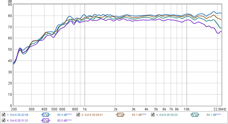

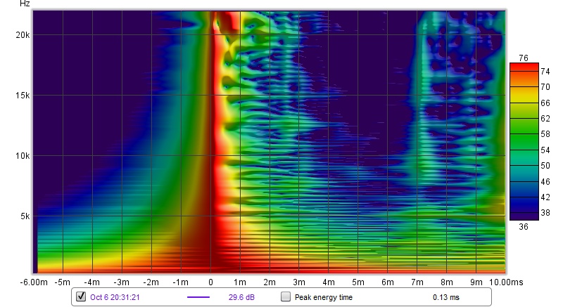

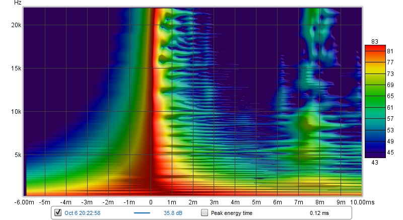

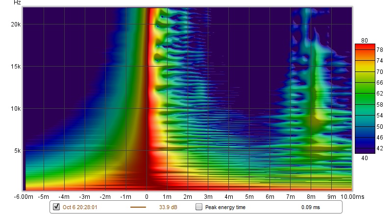

In order 0,15,30,45
All spl with 1/12th smoothing at 0,15,30,45.

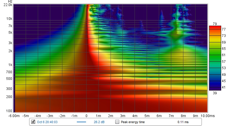

5m on axis butterworth 800hz/24db.
At 800 using BW 24dB - seems OK so far. Bear in mind I'm sat in a cold warehouse right now though. Cathedral reverb going on.

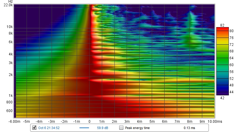

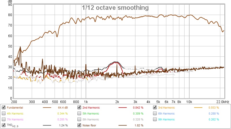

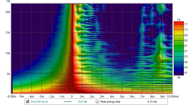

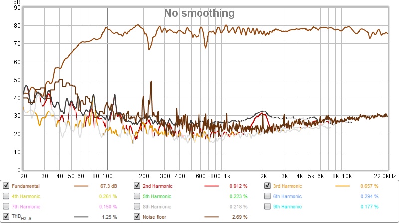

2.5m on axis complete speaker. The 12p80 is "open baffle" here and four EQs used to flatten as best I could manually. REW EQ helper needs a little more time spent with it.
incredible off-axis response! Properly controlled dispersion indeed. Good job! Harmonic distortion looks very low at these levels at least. I'm curious if intermodular distortion could be an issue, but i don't know how to measure that.
It was four EQ, sorry. This was a quick and dirty to smooth it out by eye the the charts you see in post #63 HF10AK + 12P80ND + custom WG
720 +5dB Q5.0
1600 +5dB Q0.8
2180 +4dB Q4.0
9300 +3dB Q3.0
720 +5dB Q5.0
1600 +5dB Q0.8
2180 +4dB Q4.0
9300 +3dB Q3.0
yeah maybe 2k H2 rise comes from eq'ing maybe acoustic problem?
Or diaphgram has null.
i would not go under 2k with this driver
For domestic “hifi” use the HF10AK seems to be often used lower than that. I’ve read several reports being fine at 800 BW 18/24 slopes. The 2K dip/droop is a known drop with this Faital.
Thnaks Charles - I'm looking for some comparison charts on here now. Is that region due to the HF10AK impedance curve? Or acrylic painted MDF waveguide? Or waveguide shape?

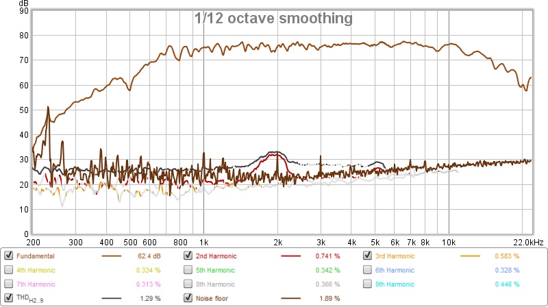

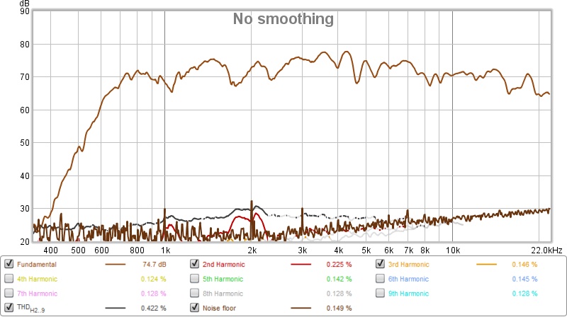

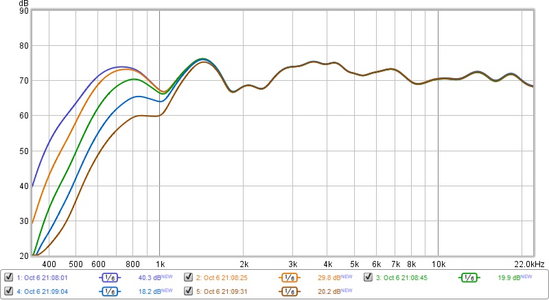

Additional test at 70dBSPL, on axis, no EQ.
BW 24dB highpass at 400/600/800/1000/1200

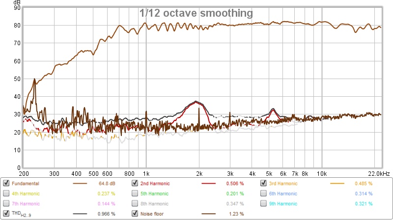

Right.

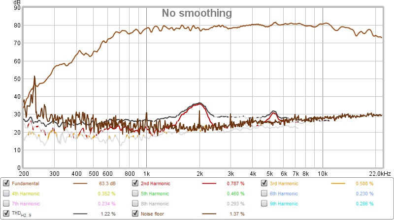

1). set the SPL to 104 dB at 1 m using a pink noise.
2). measure the distortion with UMIK placed 10 cm from the waveguide mouth
yeah hard to say what input volts really are.
"For the remaining series of tests, I set up the Listen, Inc. AudioConnect analyzer and 1/4” SCM microphone (provided by Listen, Inc.) to measure distortion and generate time-frequency plots. For the distortion measurement, I mounted the Oberton ND45/H-960 combination in free-air in the same manner as was used for the frequency response measurements, and set the SPL to 104 dB at 1 m (2.83 V determined by using a pink noise stimulus generator and internal SLM in the SoundCheck 17 software). Then, I measured the distortion with the Listen microphone placed 10 cm from the mouth of the horn. This produced the distortion curves shown in Figure 10."
2.83V?
what i've read they have been between 0.5V and 4volts
2.83V?
