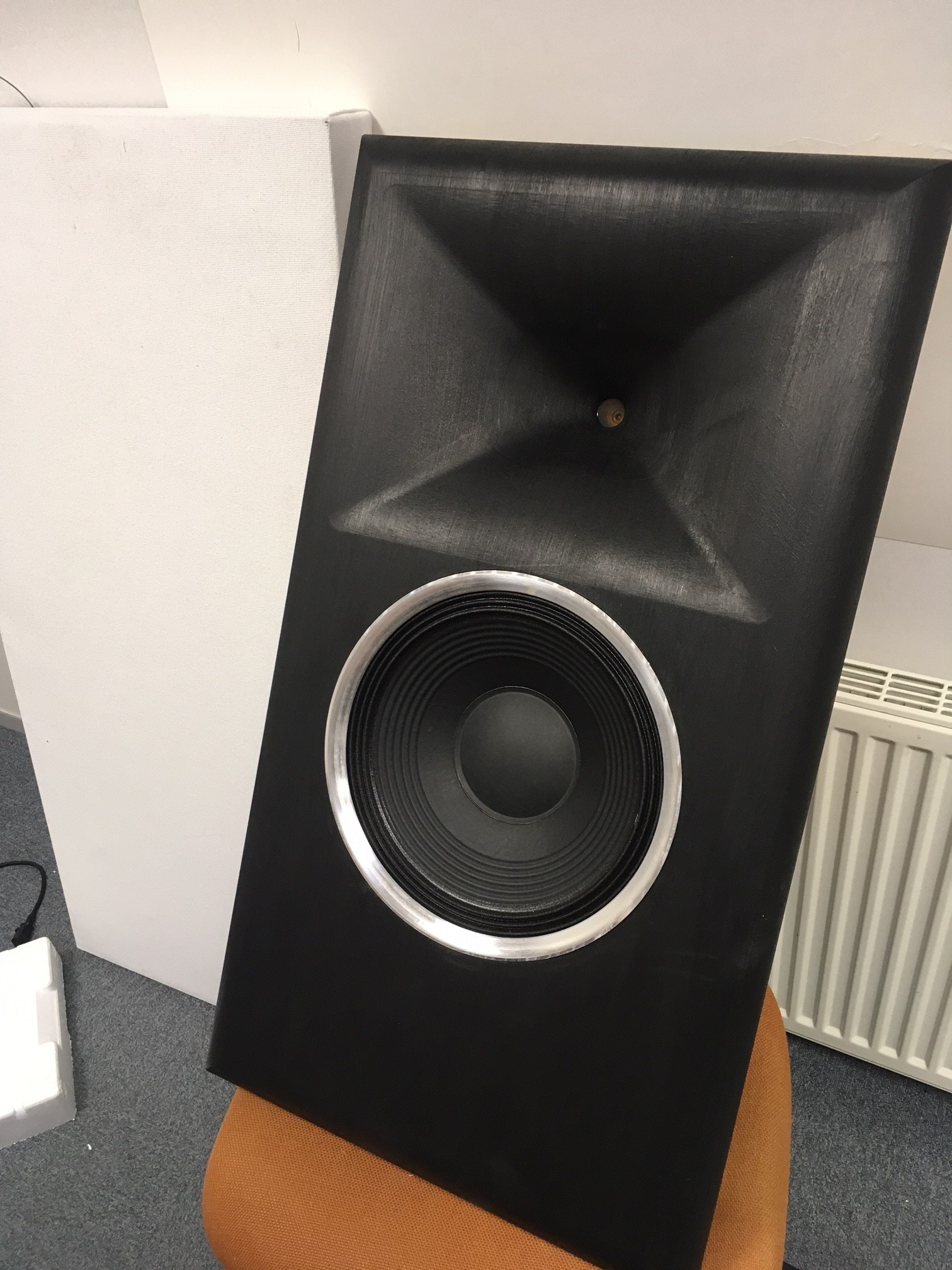

HF10AK + 12P80ND + custom WG
The distortion peak coincides with the great dip of HF10AK. Could you measure distortion per driver?
Both drivers measured at 50cm on axis. No EQ, just Xovers.

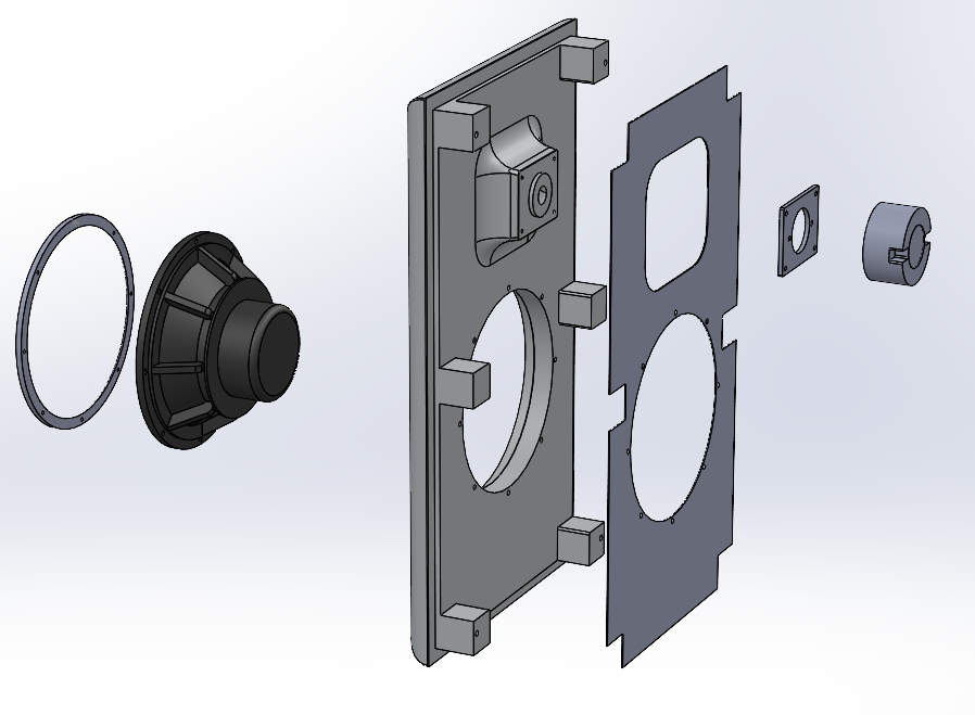

I’ve located the source of the distortion.
The HF10AK adaptor plate was 0.6mm too thick. When bolted up it was not actually sealing well (at all) to the location face at the back of the waveguide.
Revised HF10AK mounting, Change of rear port stuffing from 20 to 35kg/m3.

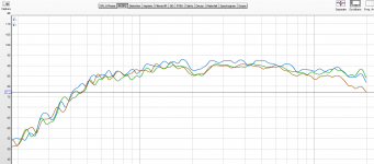

I just bagged a pair of HF10AK so I am reading your thread with great interest. Mine have very minor variation from one unit to the next around the 2k mark. Have you compared yours? Here are mine on STH100 horn at 35cm just for a test run. Distortions:
I hope this helps 🙂

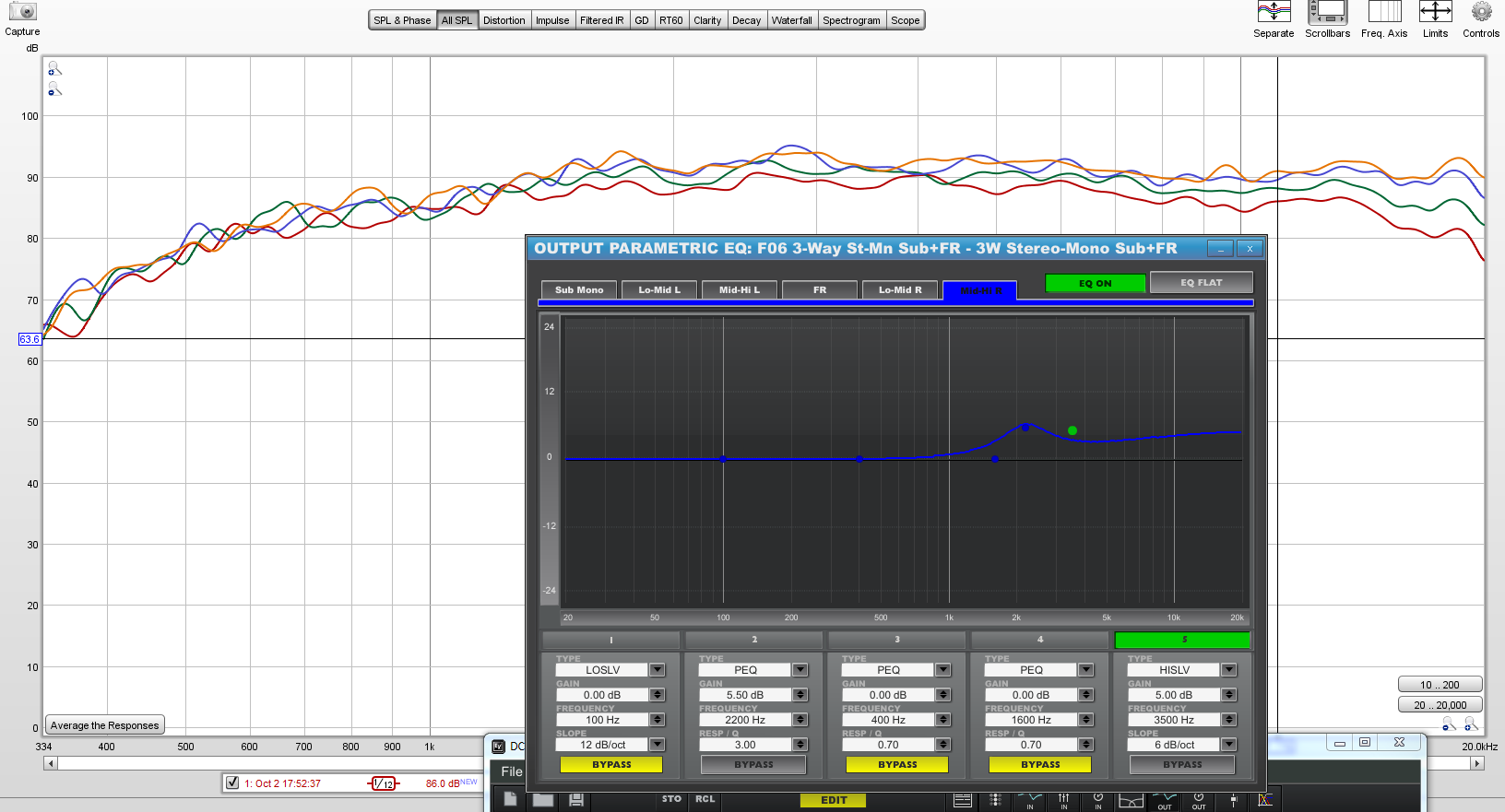

Are you EQ'ing up or down? I tend to EQ everything down rather than EQ one thing up. Choose a low point and aim to level everything down to that to avoid any chance of clipping from the output of the DSP. You can adjust gain afterwards (tho I doubt you will be anywhere near clipping owing to the tiny signal needed to drive these drivers)
PC -> Topping D10s SPDIF -> DC-One -> MC2 T4-250 (CD set +6dB above W)
The DC-One crossover levels are both set to -10dB - no lights are on DC-One outputs at 106dB levels. No lights on the MC2 yet.
I dont use pre-EQ - just use the output PEQs +/- where needed.
