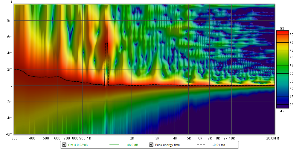

Do you know if there is an idiots guide to understanding what is the expectation in a wavelet spectrogram.
Or what ranges to use on the chart in order to see what needs to be seen? ;-)

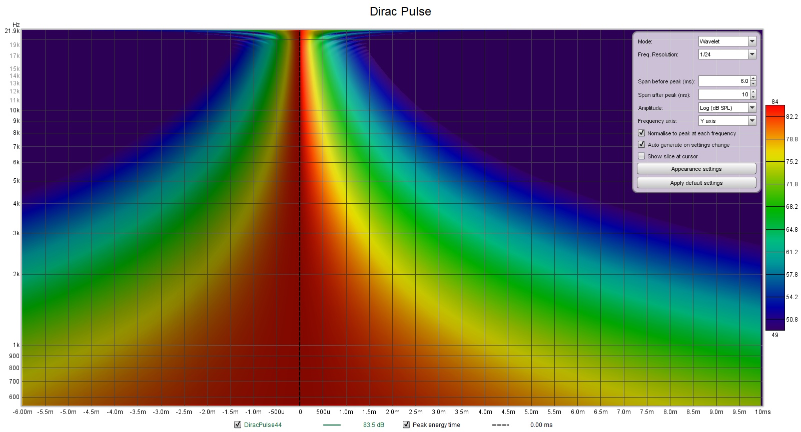

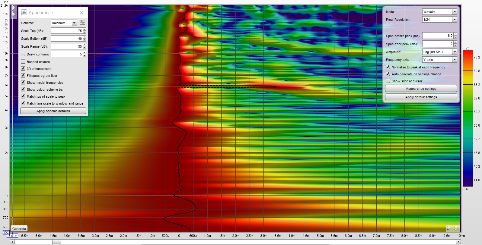

I've attached two examples, one of a perfect Dirac Pulse (ideal impulse) and another of an in room measurement. Because the spectrogram is derived from the impulse applying an IR window as you would to gate out reflections won't make any difference. I prefer to look at it the other way round with frequency on the Y axis, you can use the limits box in conjunction with the controls in the spectrogram to change the view. I also like the rainbow 3D enhancement and turn the bands off.
It is a time vs frequency view so you can see when in time something happens and how long it goes on for.
The smoother the plot looks the better, the quicker it decays the better. Reflections or delayed resonances will show up where they appear in time and frequency.

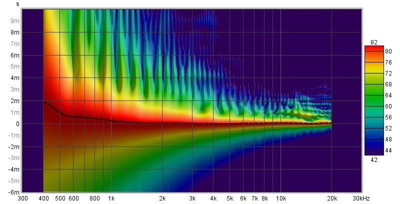

That is also a good view, turn on the CSD mode to look at the early time information. You won't see much in the way of waveguide reflections with mabat's termination and a cabinet roundover.Perhaps a 3D waterfall with time span of about 1.5ms would allow us see the waveguide reflections.
That horn looks remarkably clean, here is my current setup to compare. It's a XT1464 with faital HF146 driver. You can see the diffraction issues clear as day in my setup. Looks to be non-existent in yours. You should set "amplitude: log (db SPL)" in the spectrogram settings btw.

"Standard" Y is 50 dB.

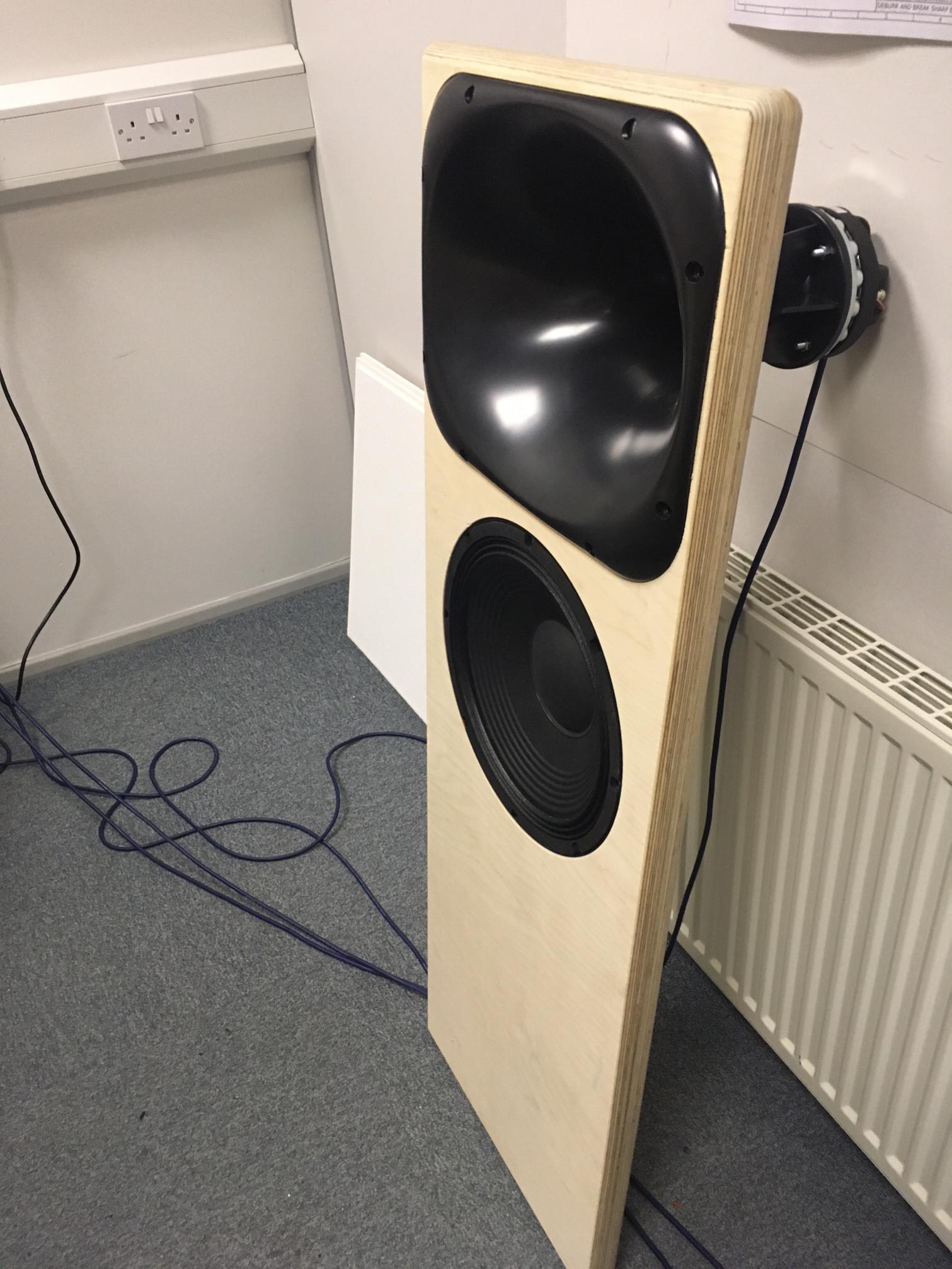

Hey kipman725, thanks! It is work in progress. I'm down in Nottingham. I might end up with a wood cabinet with a machined anodized aluminium wg and woofer ring.
B-52 PHRN-1014 10" x 14" Plastic Horn Waveguide | eBay this is the B-52 horn I have that looks a bit like your horn. Haven't done anything with it yet as big backlog of projects.

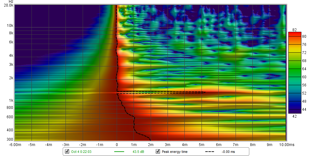

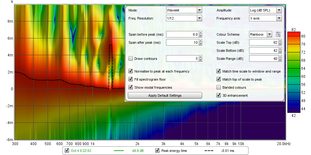

Simulation in post #1 set at 2.5m so I’ll aim for that mic distance. I’ve seen a few charts now that peak at 82dB. Would that be adequate for wavelet / reflection test? Do I let REW auto set axes or override to a “standard”?
“Time smear” is a term I’ve picked up regarding these wavelet charts.

I am trying to stay at least 40db above the noise floor when measuring frequency response and wavelets. 82db is probably perfectly fine, unless you're in a very noisy area.
Setting up again tonight - I'll stick to 82db peak.
