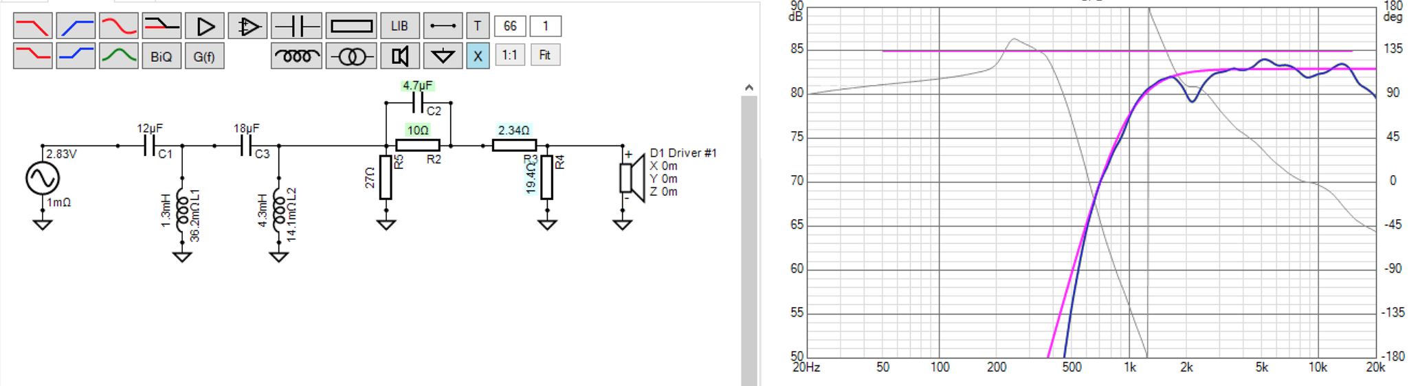

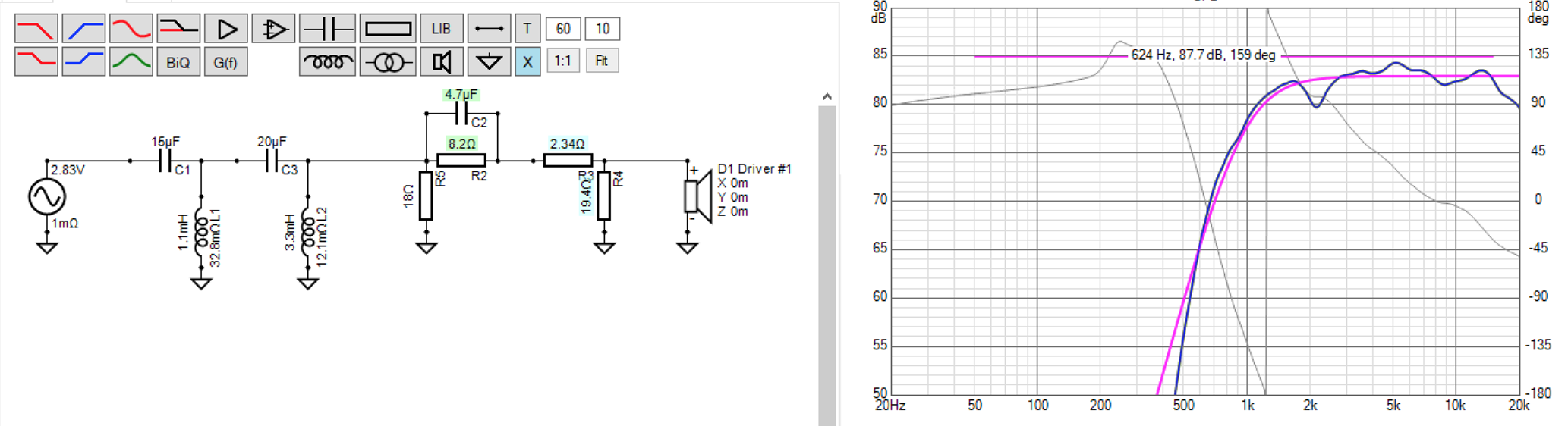

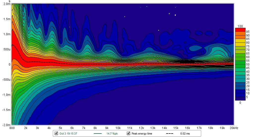

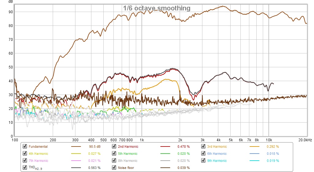

A little test with an open 15P80ND. Quite good 40 to 20k with just three EQs.
Pondering a 950 LR4. Just that 2.2k dip.

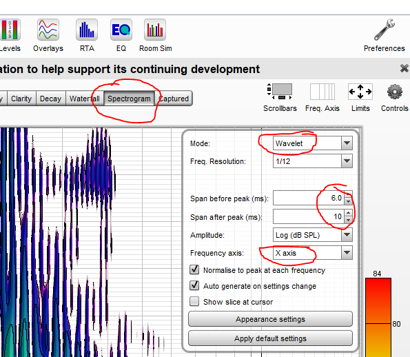

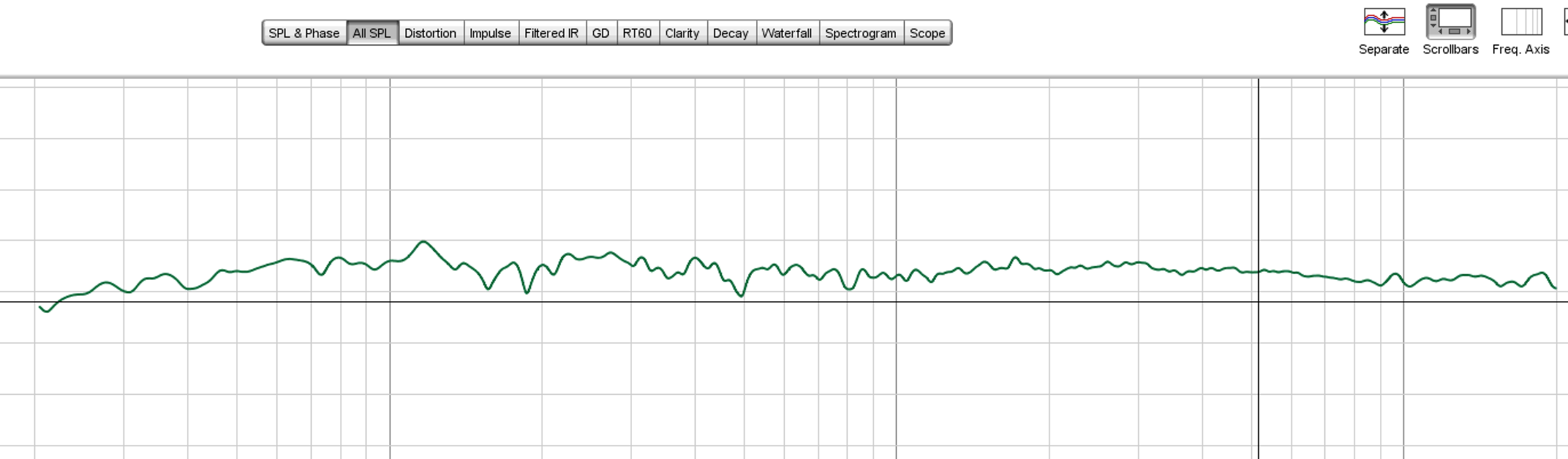

In REW there is a camera icon with the word Capture underneath it. Press that to take a screenshot including all your scales etc. If you set the Horizontal width to 800 pixels it can be put inline without making the window too big.

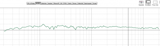

Taking screen snips without the scales makes it difficult to know what you are looking at 🙂

Have you tried anything to address the 2.2k dip? Is it a floor reflection ... horn reflection? Does putting in a piece of foam help?
I'm not that familar with REW just yet. Is there a guide to set / run this ?
It's a good way to get the time alignement right. I also believe that it will reveal diffraction issues.

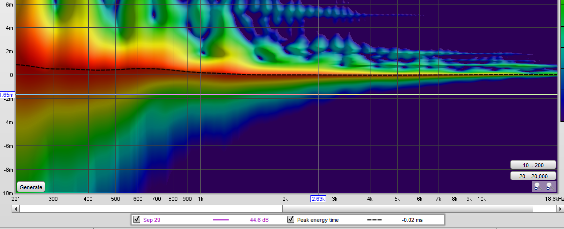

Does this spectrogram time alignment differ some how looking by phase response?
yeah, seems to do something. looking by my old random file where was some polarity check made
Two drivers can have overlapping phase response, and at the same not be properly time aligned. Spectrogram is also a good way to show resonanses. You could probably use the combined phase response to determine if the time alignement is good, but i think the spectrogram is a very good visualization.

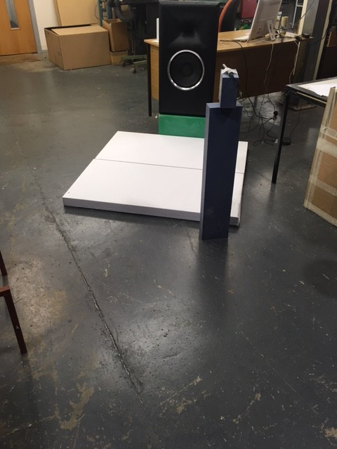

Thanks! Working on it now. Setting up in a bigger space.

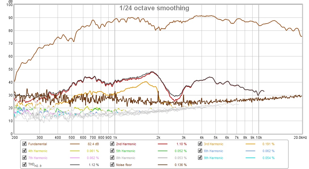

First images
200Hz LR4 high pass only
30 degrees off-axis, no EQ
caveats
- used the D2 Audio HDK dsp & amps
- in a factory setting
- used 50mm GK acoustic panels on the floor

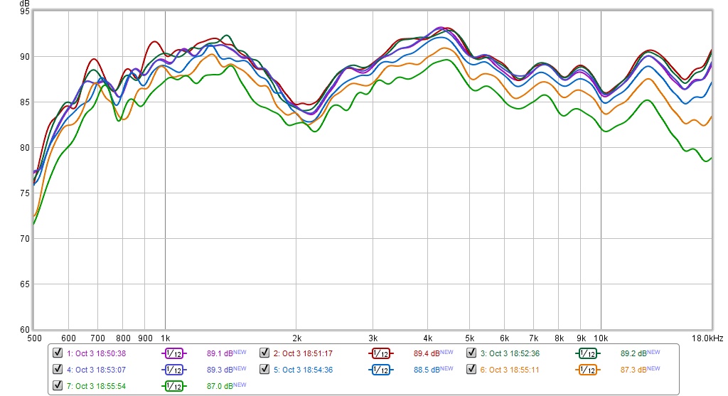

Second images
0 degrees off-axis, no EQ200Hz LR4 high pass only
caveats

Waveguide looks like it performs as it should off-axis.

Looks very good so far! Could you do me a huge favour, and post a spectrogram with the wavelet-setting?
similar to this:
https://www.diyaudio.com/forums/att...reading-wavelet-spectrogram-0-5msinverted-png
Let me know what range in X and Y you would like to see. I'll set up again next week and also improve upon my test area at work. Failing that, these guys are only a few miles from me. Wonder what their day rate is...
