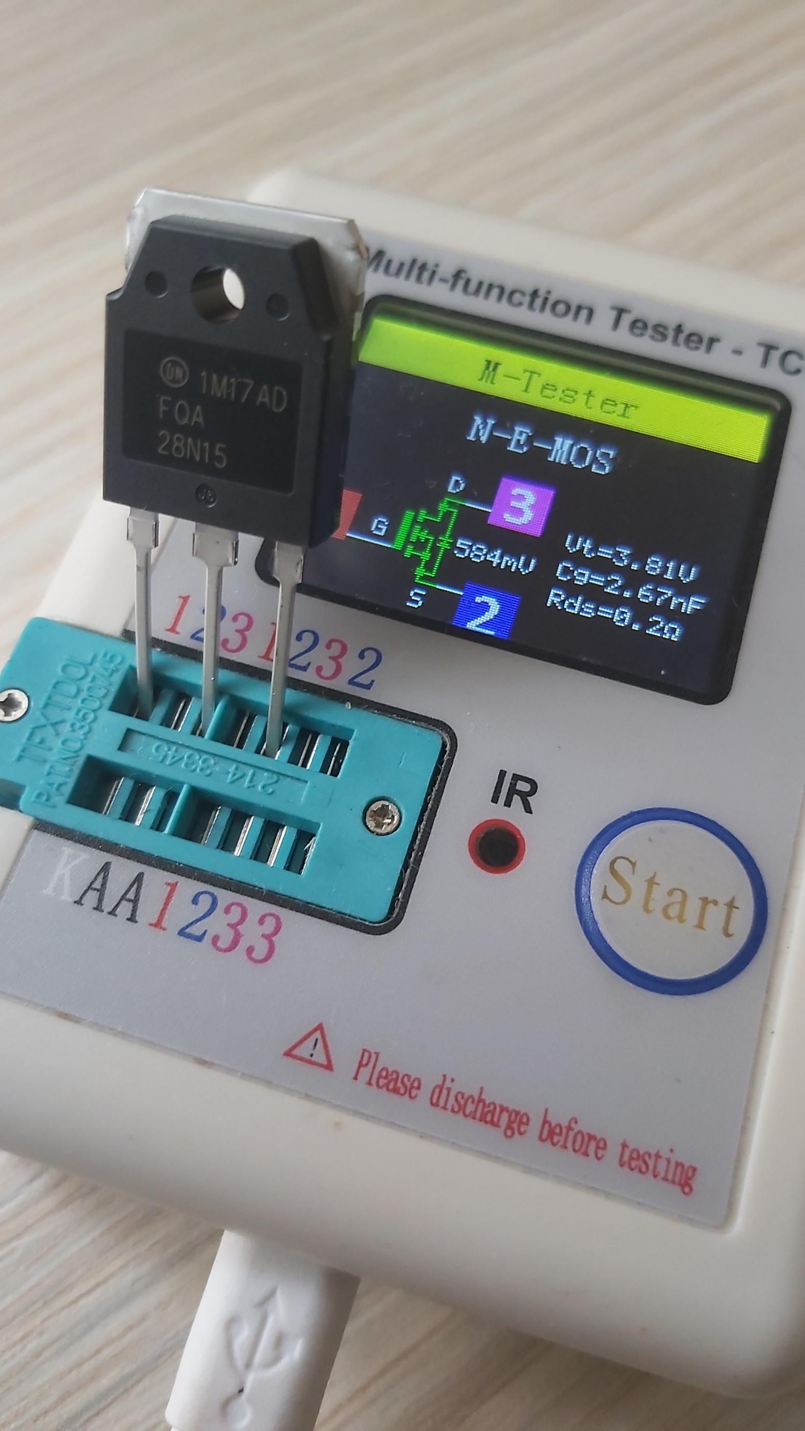

Not yet. I quoted this statement from opc. However Tvicol uses FQA46N15 and FQA36P15 pair in his Quad amplifier successfully, so I decided I will use these too, the Cg is high for both FETs, but almost identical (measured). In both side I'll use a 120 ohm gate resistor.

1. In my original build resistors that are placed between heatsinks for to-126 transistors, were soldered UNDER the board, so heatsinks could be closer to each other
2. I think the 2.2uF speed-up cap (C21) should be replaced with 220nF.
2.2uF is too much for fet OS (2.2uF would be more appropriate for BJTs, but for fets 220nF will be enough). In my build I used 1uF.
I see two of them on the PCB???
3. I was trying to avoid placing tall components in front of the output fets, to avoid obstruction of the screw/bolt, in case when transistor has to be unscrewed from the hetasink. Even as it is, I had to used special tiny wrench for hex bolts to screw fets to the heatsink. Could not fit normal screwdriver to do this...
4. C12 cap it could be anything from 1uF to 10uF. I used 10uF electrolytic.
5. C16 cap (47nF) can be anything from 22nF to 100nF (ceramic is ok). I used 39nF in my build.
My latest sim file attached.
C8 feedback cap was originally 82pF (perfect value according to the sim), but in real build was corrected to 220pF to fix square waves response.
Thanks for your comments.🙂
That was a duplicated 2.2u cap - i will remove it and replace the other one with 220n.
I will also check and if necessary spread the gate protection diodes so a hex spanner can fit between them. The height of those diodes should be lower than the Fet bolts anyway but a few more mm clearance won't harm. That remaining 2u2 cap also needs to be moved to provide more clearance but again, the height should be lower than the Fet bolts.

So why not FQA28N15 ?Patrick
You're right Patrick. In the meantime I remembered that there are some FQA28N15 in my stock so I measured them too. The difference between Cgs is significant, so the gate resistors must be changed to 100 ohms on the P side and 200 Ohms on the N side. Many consider this N fet to be the most ideal one for the FQA36P15 because of their similar transfer characteristics.
