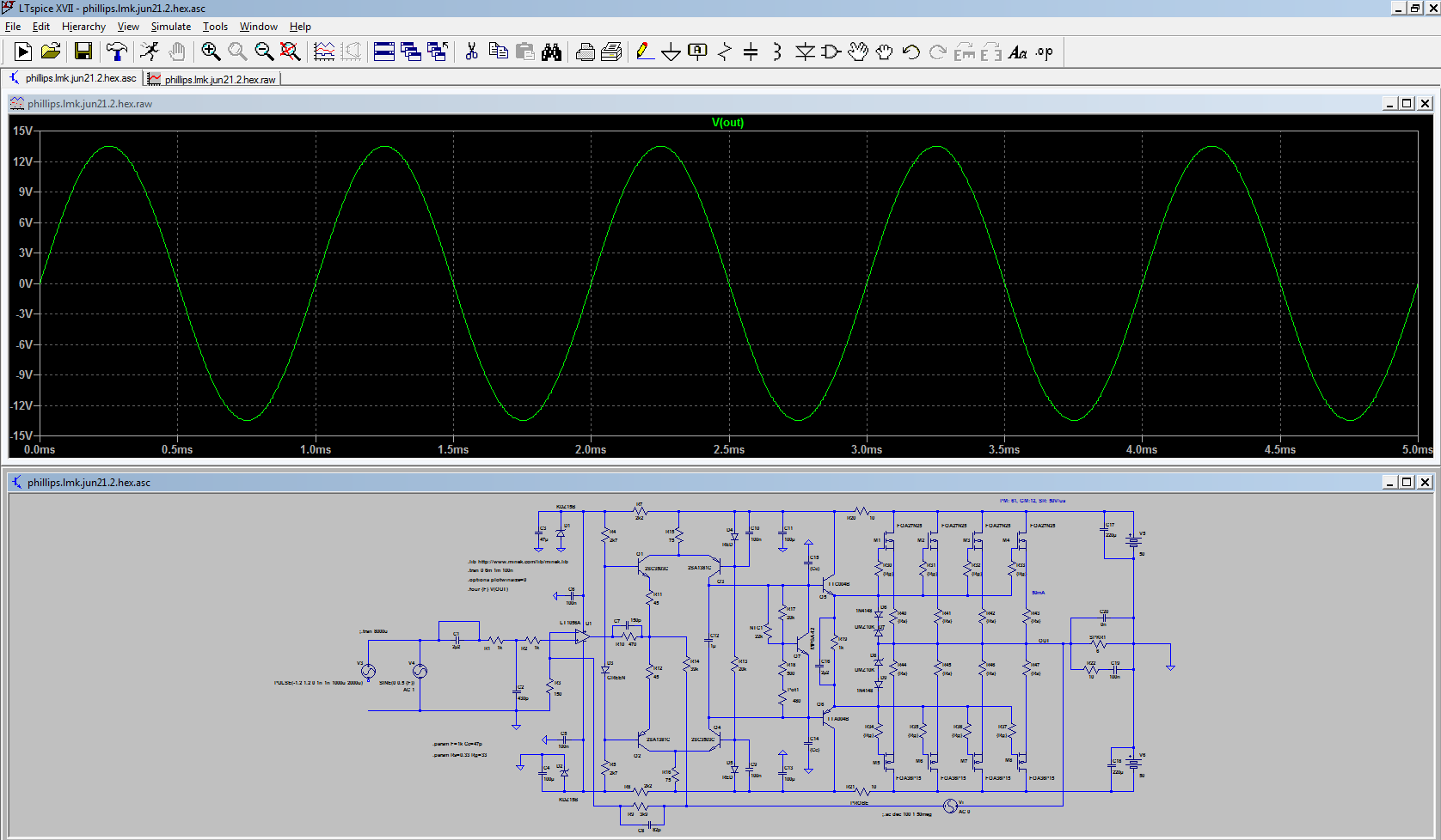

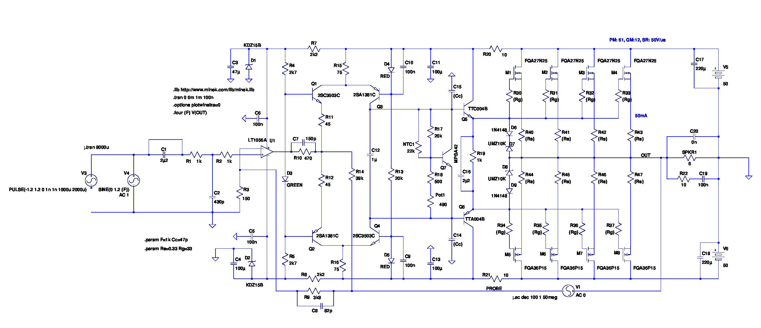

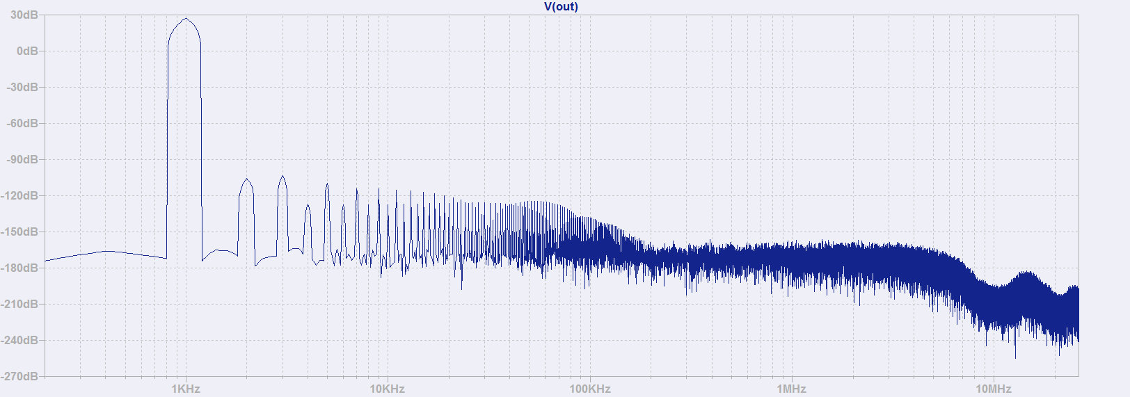

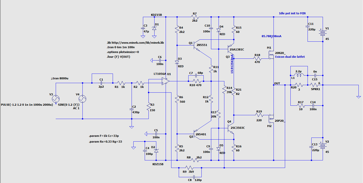

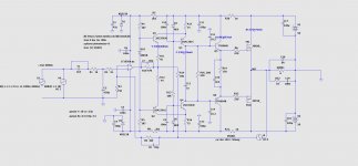

After several weeks (?) of production time, the boards have finally arrived today. No one recommends using VFETs without source resistors, even for single par. Unless I would use an 'auto-bias' circuit. So I'm trying to place the transdiode sensor as efficiently as possible. I will glue it on FET direclty as follows. Glued on heat sink it would not be efficient and fast enough for this, I guess.
This is a "HexFet Amp Based on Philips AH578 and LMK" with 36V supply voltage and single pair FET output. The nickname is Tietze & Schenk BA-50M. The topology was first published in mid 70's by Dr. Tietze and Dr. Schenk as "Breitband Verstärker" i.e. Broadband amplifier (BA), 50W (50), the circuit designed by minek123 (M). Later, I will refer to it so.

.. The nickname is Tietze & Schenk BA-50M. The topology was first published in mid 70's by Dr. Tietze and Dr. Schenk as "Breitband Verstärker" i.e. Broadband amplifier (BA), 50W (50), the circuit designed by minek123 (M). Later, I will refer to it so.
Which edition of the book ? Thanks
>Will try to post the relevant page later if it is of any interest. |
It was posted already in another thread:
Unusual amp from 1987
Maybe you have more/different source info about this topology?
As far as I know it was first published by Faran and Fulks.
See this post:
See this post:
I have to correct what I wrote. This schematic what I refer to can only be found in a later edition of the book (1992?). I have a printed version of the first edition from 70's translated in Hungarian. In this book you can find a single ended (earlier) version of T-S broadband amplifier only. It's similar to LMK, but in this case the emitter current of the first transistor is equal to the output current of the opamp (5-7mA), so this circuit is much more sensitive to the type of IC used.
Off topic : what are D2, D3 good for (post189) ?
I don't have the book in my hand right now, but those could be overcurrent protection diodes.
