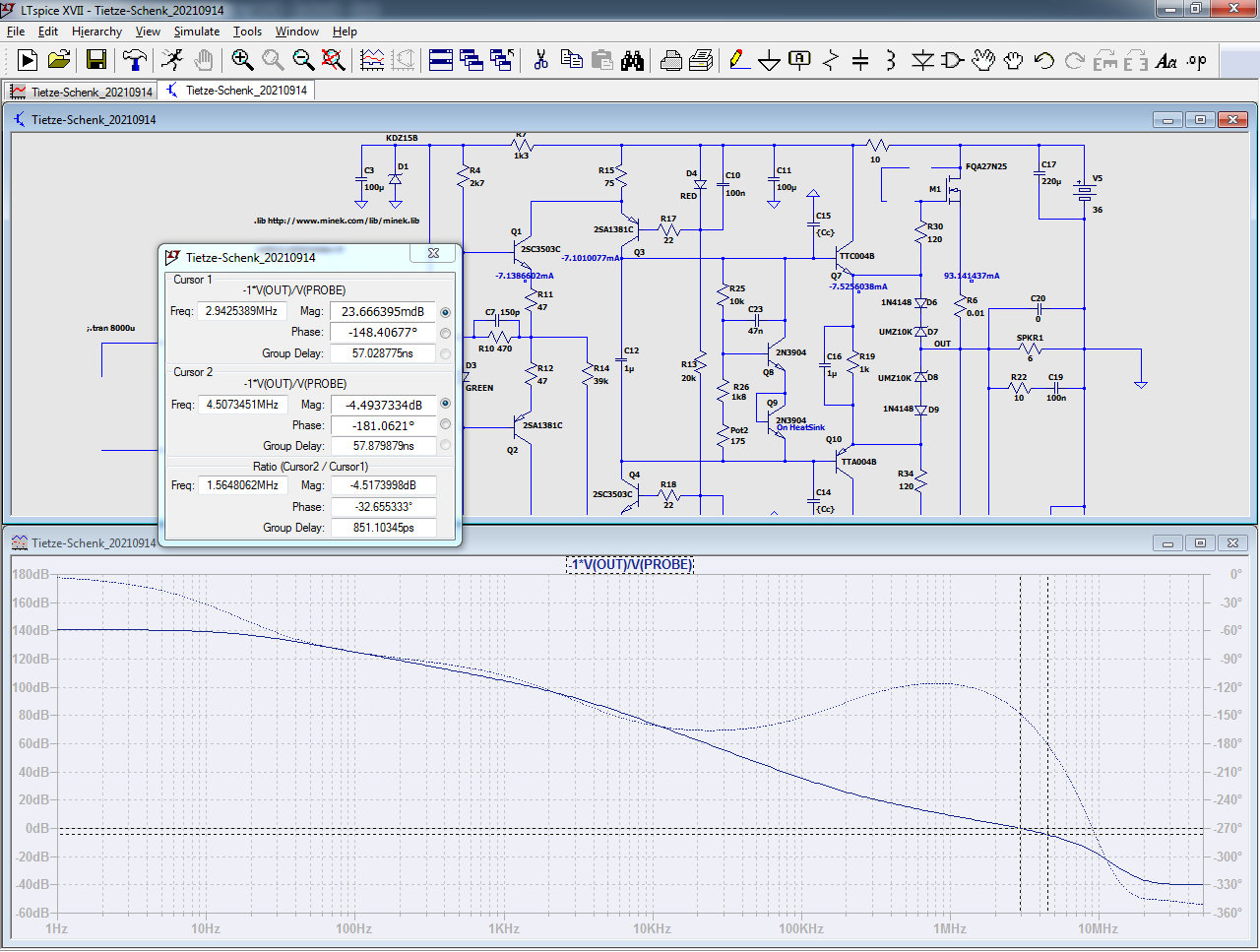

PM of 29 - well below 45 which I consider 'minimum', is not acceptable.
How is it without snubbers?
I used my schematic/sim, and l modified it it to match yours.
Same results. PM 27.
Weird - I tried my own latest schematic/sim without any changes, and PM also comes at 28.
If I change feeback cap C8 from 220pF to 120pF (as it was in the original post #1), PM goes back to 60.
At some point this cap was even at 82pF... (post #71).
I guess this cap has been adjusted in the real build to correct square wave response..
Will need to check my posts from the testing stage...
Yes: post #107 documents change from 82pF to 220pF.
So I guess that's the difference between sim and real life.
Start with 82pF, and check the squares on the oscilloscope. Perhaps for your build square waves will be fine.
If you have overshots like me, try increasing C8.

I think increase the lead compensation capacitor value from 82pF to 220pF destroys the stability margins significantly .
Well, hard to say who is right: sim or real build.
Obviously they are not in sync.
However in real life amp is solid and stable, so I guess my vote goes for reality, not for the sim..

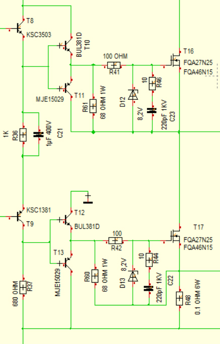

NMOS,
In my quick sim this doesn't seem better than 'normal' quasi.
Are you sure collector of T12 should be grounded? It's impossible to bias OS correctly like this. Problem disappears if T12 collector goes to the OUT instead of GND.
There is also crossover distortion present...
Can you share your sim?

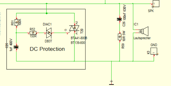

I changed the schematic and add DC protection.
I'm in the process of designing PCB board with the changes

1. In my original build resistors that are placed between heatsinks for to-126 transistors, were soldered UNDER the board, so heatsinks could be closer to each other
2. I think the 2.2uF speed-up cap (C21) should be replaced with 220nF.
2.2uF is too much for fet OS (2.2uF would be more appropriate for BJTs, but for fets 220nF will be enough). In my build I used 1uF.

My latest sim file attached.
C8 feedback cap was originally 82pF (perfect value according to the sim), but in real build was corrected to 220pF to fix square waves response.
