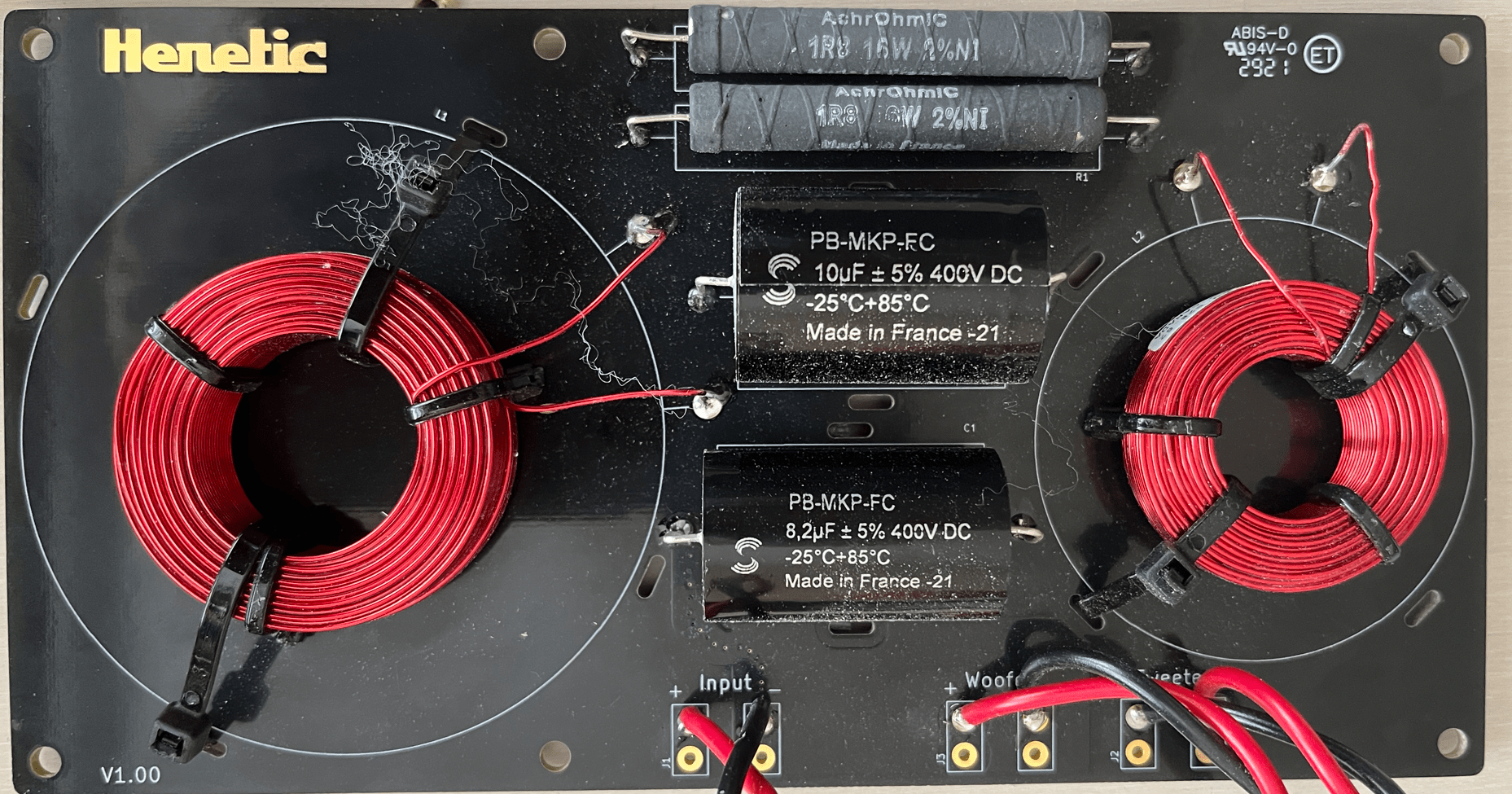

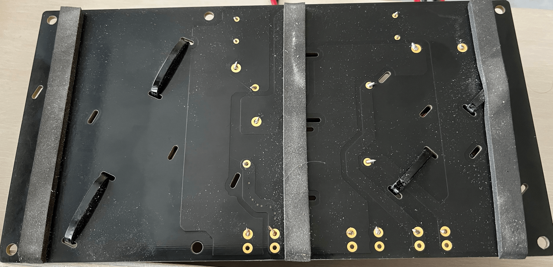

Just to show the only trace I can find on the component side of the pcb.

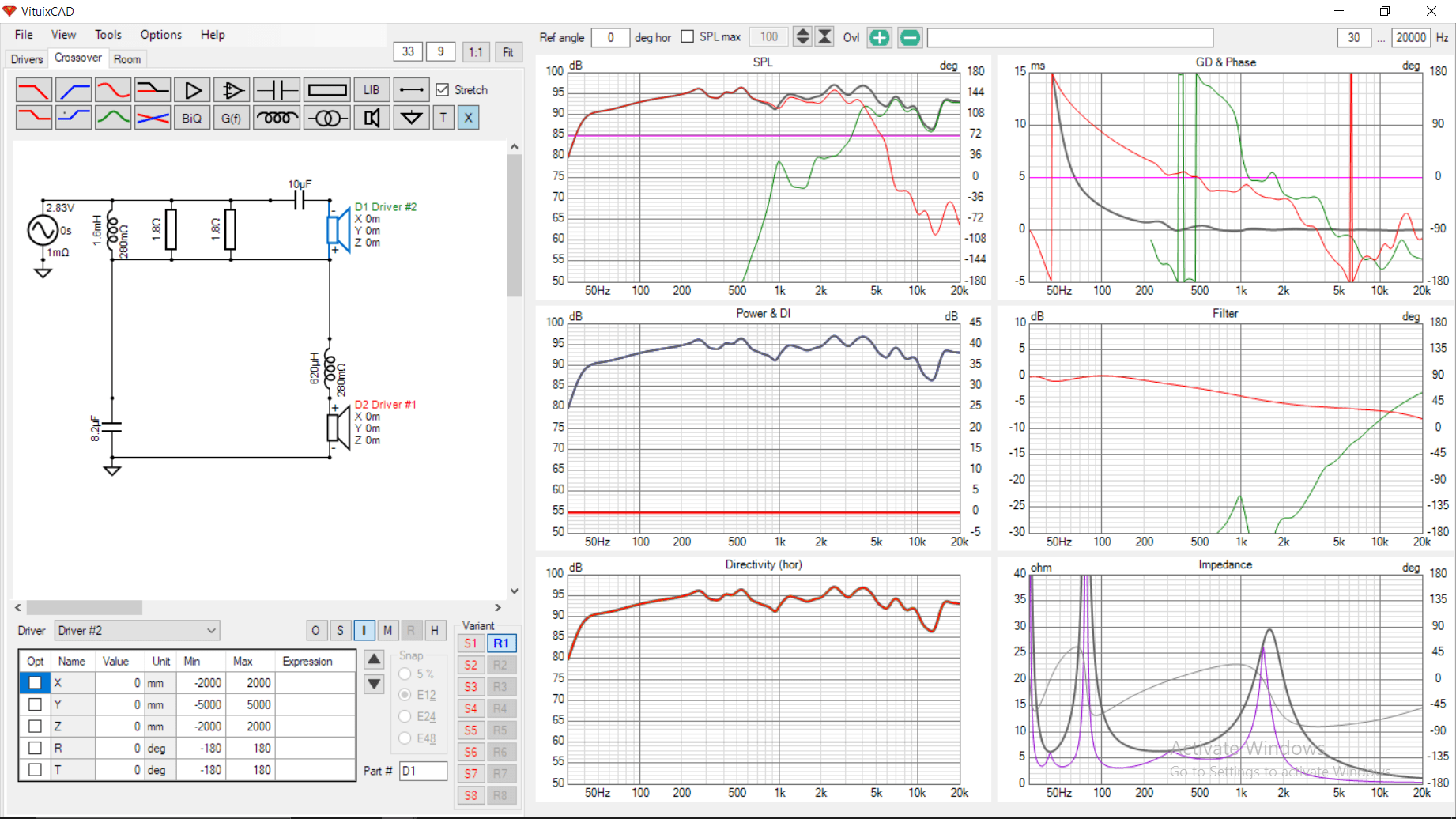

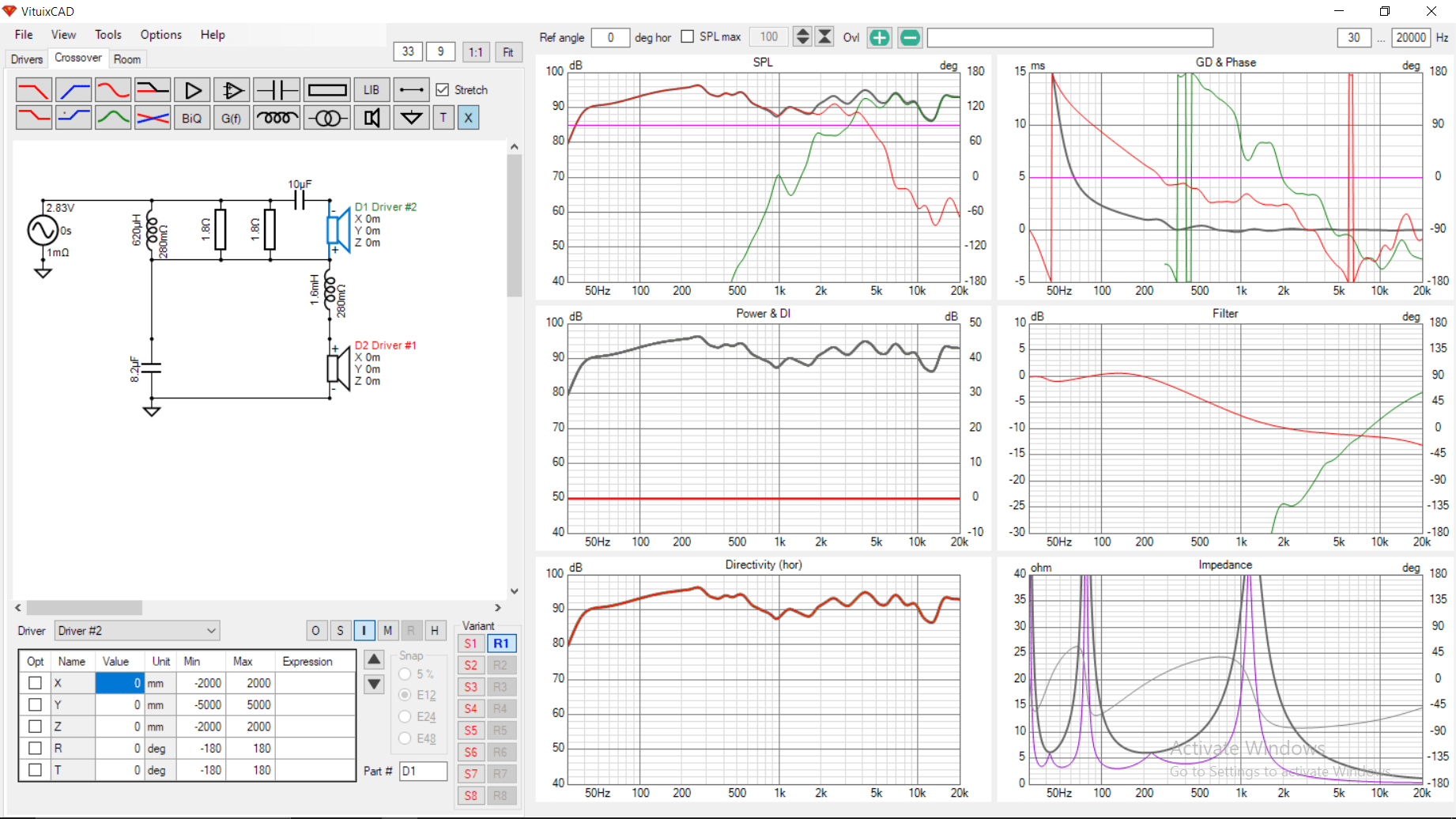

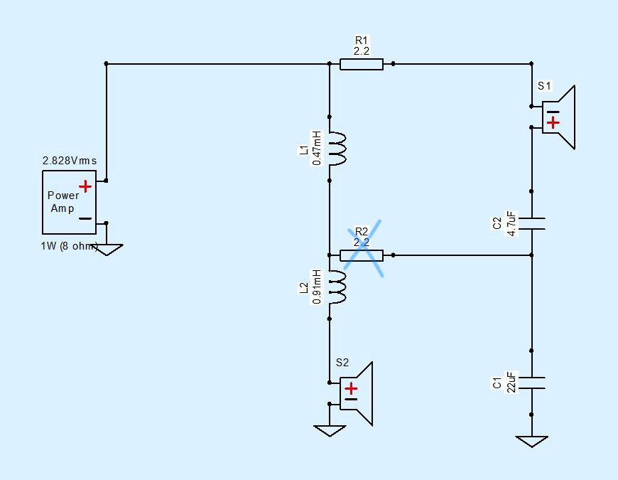

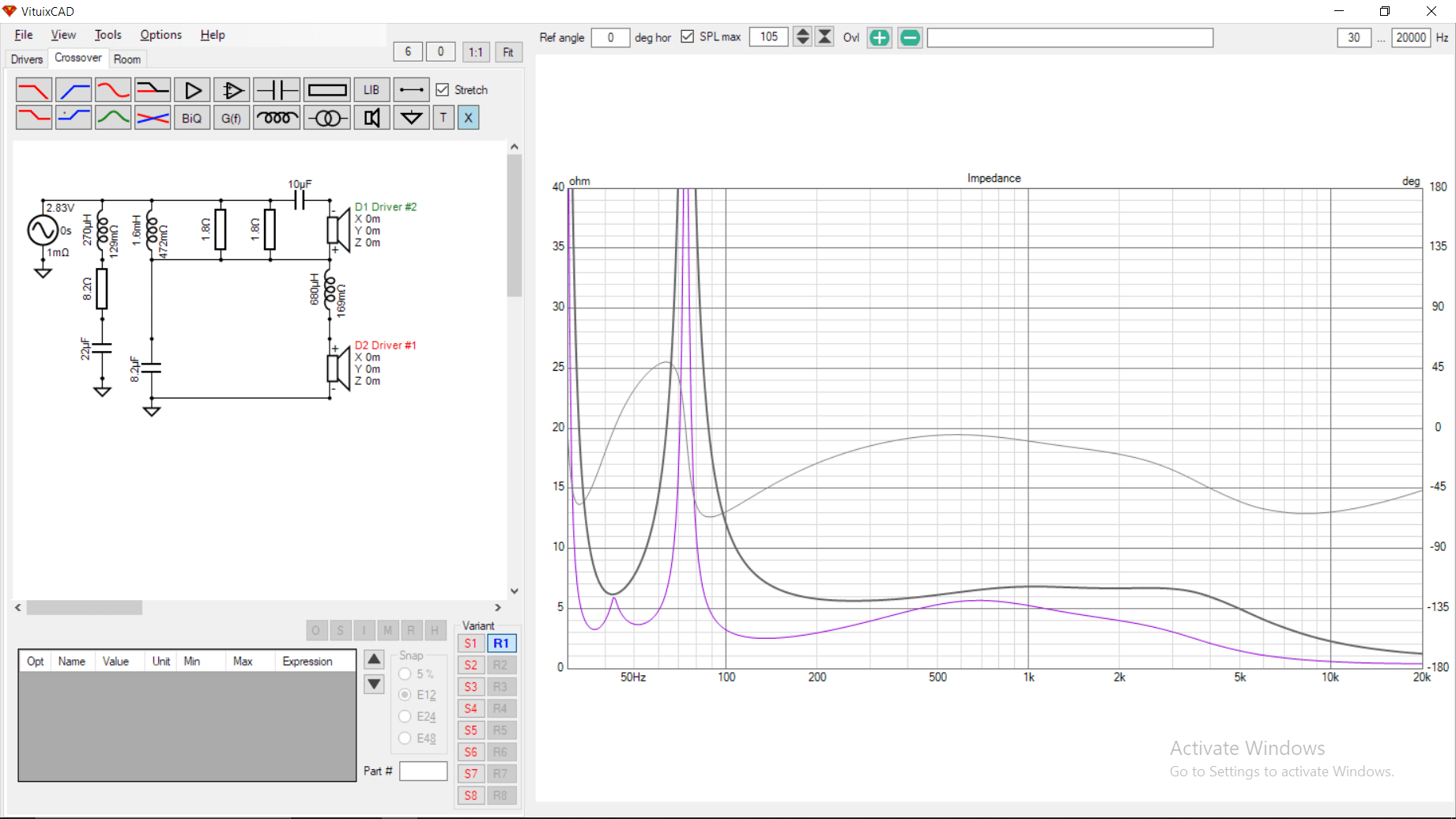

In answer to A1008, I posted data to help others approach the original design, and at the same time I wanted to try and understand serial Xovers a bit more as I had never tried the idea before.
I am slowly building a box of approx. 80 litres along the shape of an old Tannoy Chatsworth sized cabinet and now have a different serial over i want to try and tune further once i have built the cabinet.
I imagine that Chris's post 82 would work as one of many possible solutions.

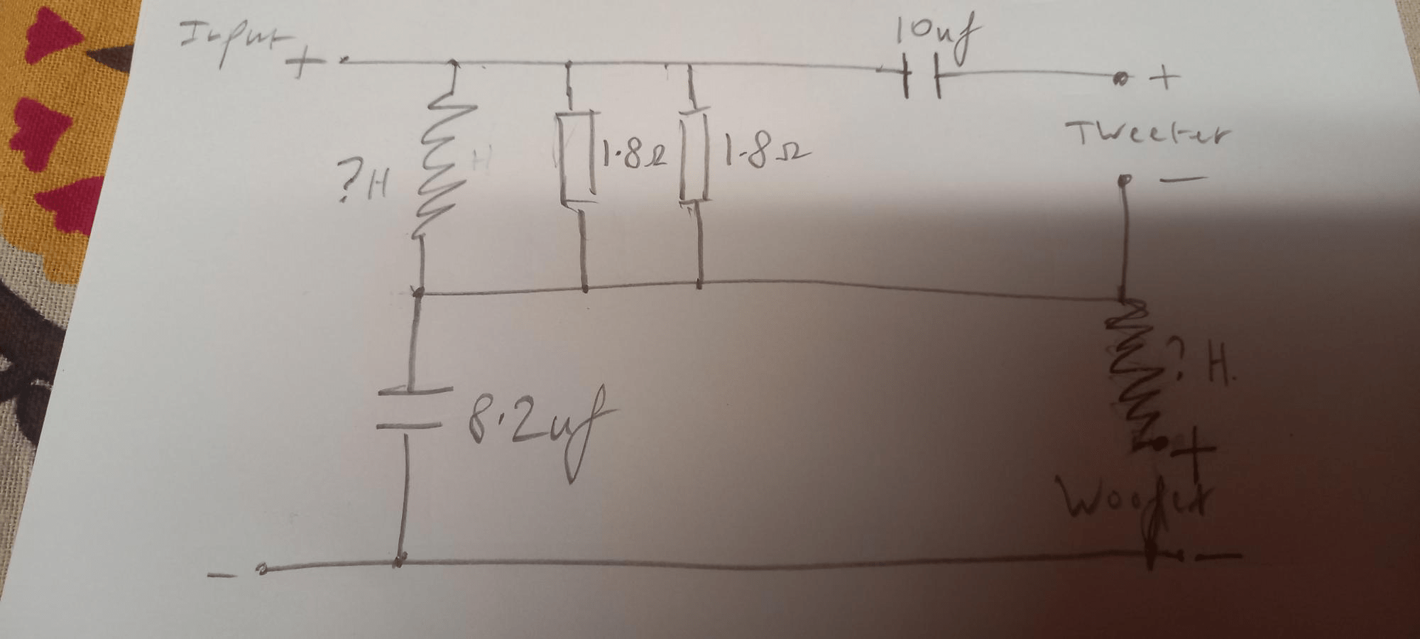

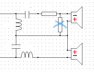

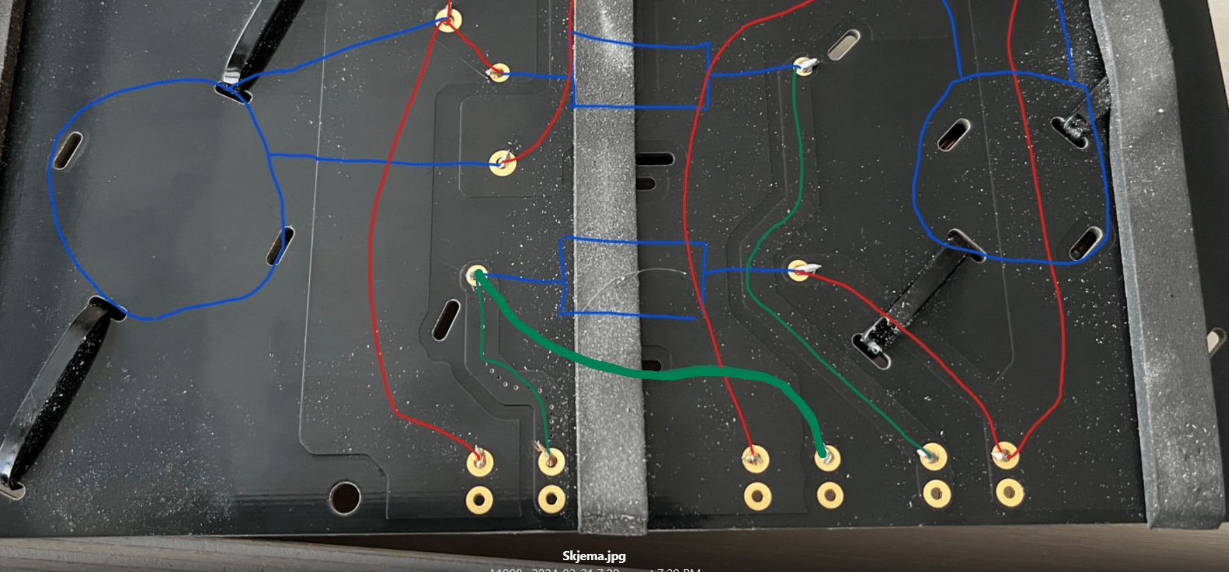

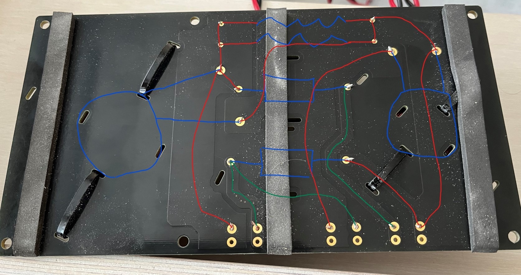

Is this it as traced out by our friend?
This looks to be correct. from post #66.
Count on the back: Left side bottom to top 1-6 ( #1-8.2uf, #2 -1.6 mH,#3-10 uf,#4-1.6mH,#5 Res,#6-Res.)
Right Side 7-12 top to bottom (#7-Res,#8-Res,#9-.62mH,#10-.62mH,#11-10uF,#12-8.2uf
post#71
The smaler coils Solen 20.62 ( 0,62mH )and 201.6 (1,6mH ) both 20awg or 0,8mm Pure Copper Solid Round Type.
The bigger types, maybe 16awg.?????

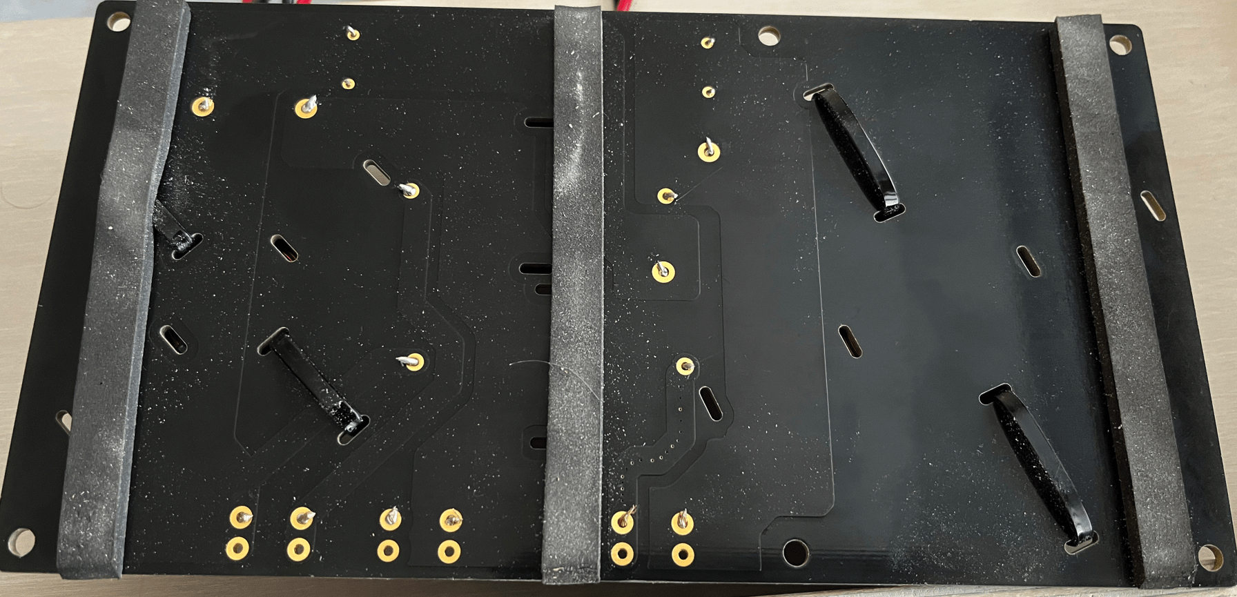

Just a thought regarding PCB images?
Look at component side image big inductor on LHS.
Now look at posted images of the underside, ie the soldered side. Note that the solder input terminals are not flipped they still align?
Question: shouldn't the larger L1 inductor be on the RHS now?
I am in the garage attempting cutting wood for cabinets today, so the cold may have addled my brain.
I was wondering about that, looks like he flipped the image so we could trace it easier.

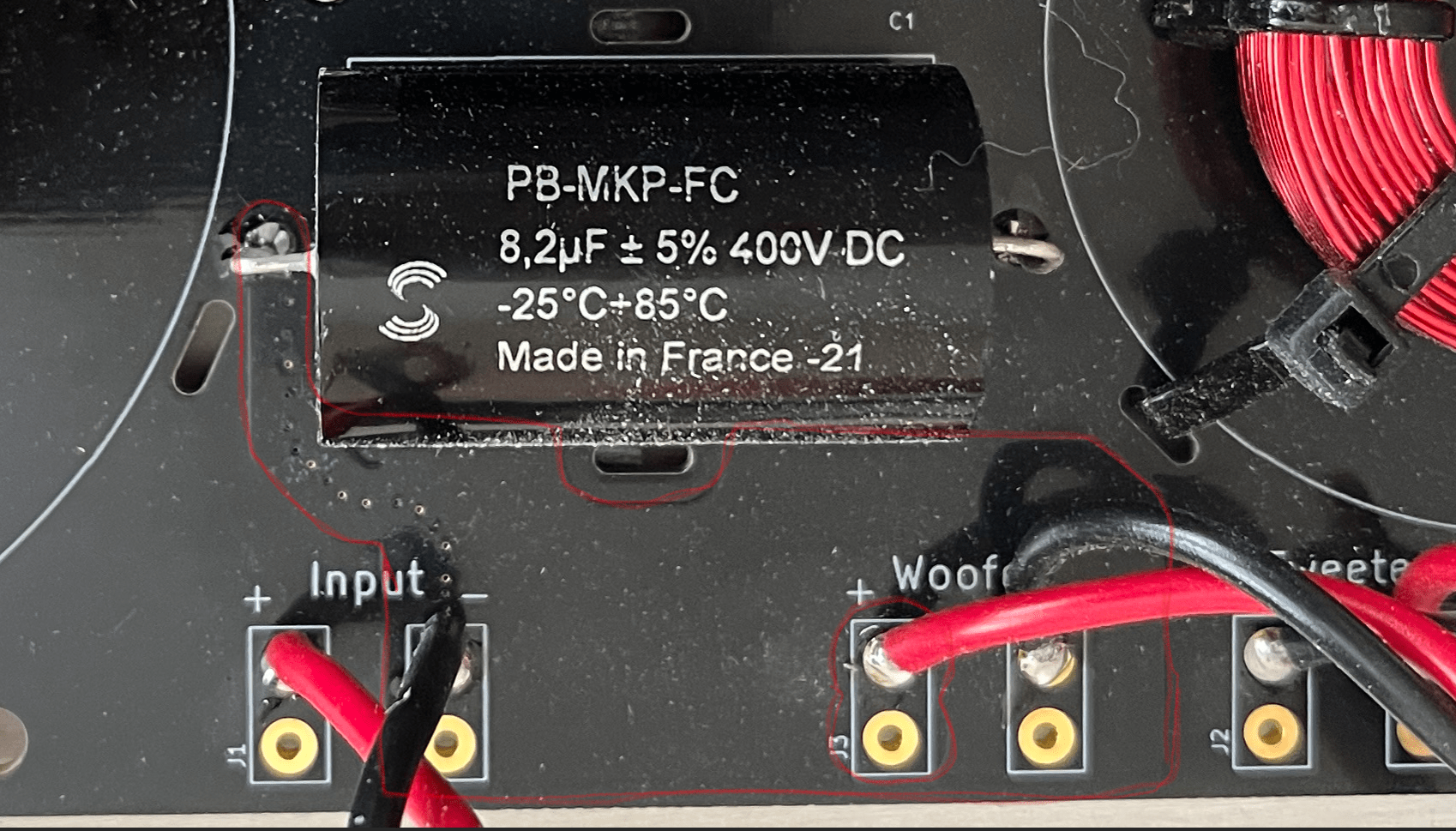

If you look at the component side the tweeter terminals are on the bottom right. Amp +/- near the mounting hole.
The tweeter terminals are on the bottom right- flipped image.

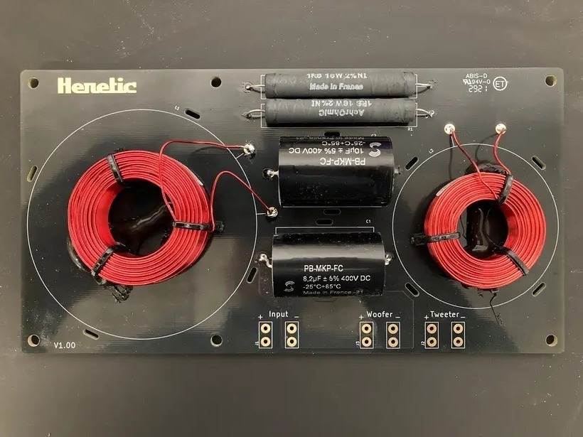

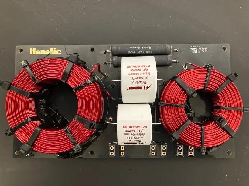

The Zap straps Larger Coil on the left, Smaller Coil on the right.
Normal back & top pcb.
Flipped pcb image
from post #88 Try this & apply to the crossover on post #27 or #66
Backside flipped (image supplied), count on the back: Left side bottom to top components 1-6 ( #1-8.2uf, #2 -1.6 mH,#3-10 uf,#4-1.6mH,#5 Res,#6-Res.)
Woofer - negative see post #65
Yes- Thank You, A1008 without your help this would not be solved!
POST # 89 Crossover

Same pcb board. Any idea$s.
from post #1 White Mundorf Cap EVO aluminium Oil 450VDC Caps , the coils fill the board
$30 usd Mundorf Cap 10 ufd

from post #11 Solen PB-MKP-FC 400 VDC Caps, the coils don't fill the board.
$6.55 usd Solen Cap 10 ufd
