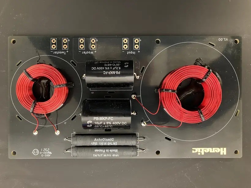

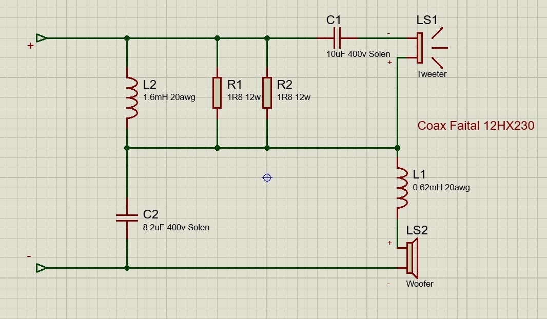

Could it be something like this?

I have been playing a bit I have them on a 18mm MDF Baffle. H 65cm and W 40cm. N.B. Only one baffle so no stereo listening achieved yet.
I need to check my smaller inductor as it is old and is marked as 0.7mH it could be a little bit different once re meaured.
I have one resistor at the R1{}R2 position of 11ohms. Additionally as attenuation between C1 and the negative of the tweeter I have 18ohms.
L1 is 1mH, L2 0.7mH as mentioned capacitors are both 8.2uF Mic was at approx. 20 degree horizontal offset> will do more investigating and refining.
My first impressions is that I should be able to do this passively using the serial crossover topology.
Obviously component values will change and I have the impression that I will have to go ahead and build the box in the Tannoy Chatsworth style. The reason for this is that I do have some 12" Tannoy reds and the cabinet with a detachable front baffle should allow me to work with either. It will be interesting to see how these tune further. Obviously the box and the effect of its stuffing still need to be worked with. The 4-5Khz bump looks a bit high but I may leave it or have to address it but at the same time not killing the higher frequencies.
I see that at the Heretic website that they have too gone to something approaching the slimmer taller tannoy box design. Which probably means more sales for them as its slightly less imposing

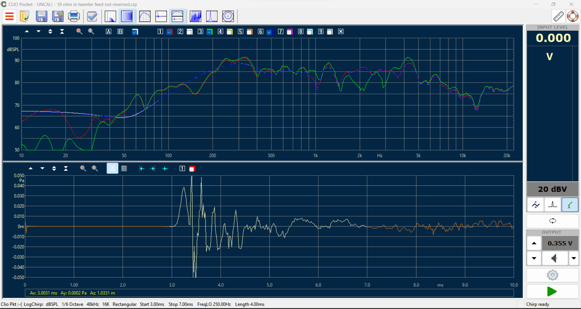

Graphs:
Response
Red / blue is response 20 degree of axis. blues being 4mS window. Green is reverse connection.

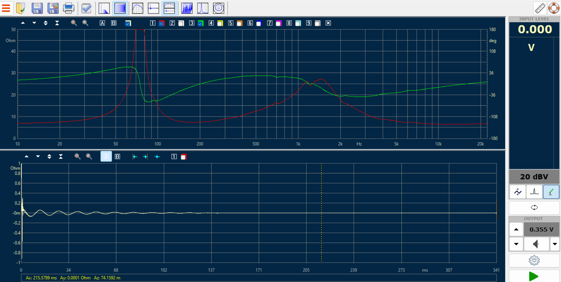

Impedance
Red impedance, Green phase.

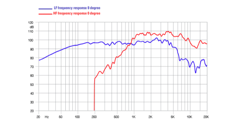

Heretic driver
Faital 12hx230
https://usspeaker.com/faital pro 12hx230-1.htm

Agreed! So what is the guess as to what these are? Two resistors in parallel on the tweeter? 0.9 ohms attenuation is only about 2db on the tweeter.
An L-Pad seems unlikely to me given the values. Any thoughts on this?
The diference in SPL LF/HF is about 9db that is huge... So it is not lightly that 0.9ohm is the serial value? Simply it is not enough.
More ligtley is that they are in serial OR even configured as L-pad...
To remainf You -6db is a 1/2 of voltage value. Another -6db will be 1/2 of 1/2 (1/4). So -12db is 3/4 : 1/4 toatal level...

And that's one of the major issues with series crossovers. The basic function is reasonably straightforward, but once you get into trying to shape response and deal with real-world speakers you run into constraints all over the place and resorting to circuits that get complicated and tend not to perform exactly like the simulators say. If you're picky about the result and don't have speakers that posses the desired frequency response inherently, series tends to be a lot harder than parallel. So far I haven't pushed a series project to completion due to their rising complexity and inherent limitations. With a parallel crossover it's much easier to beat frequency response into submission. With series it seems like sometimes you just can't get there from here.
But I also don't think I'd be happy with the drooping upper end of the 12HX230's tweeter, so maybe I'm just too picky for series in this application. I haven't seen a frequency response plot of the Heretic speakers, so I don't know if they're mostly settling for the native response of the tweeter or if they found a way to shape it. Or if it doesn't sound like it looks in the Faital plots. Assuming the crossover shown earlier in the thread depicts the full circuit, the part count seems low to be doing much shaping, but maybe they're better at it than I am.
