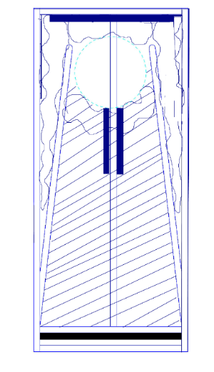

well spent most of the day puttin em together. Had the panels cut at Totem on their panel saw. Other than a couple of practical changes, pretty much as Dave has stated on his site. With very minor modifications can be made with 2 sheets of BB ply, 18mm.
First, they are a pain in the A** to put together. We used white carpenter's glue, and PL400 adhesive. Haven't attached the backs yet, and need to add the felt. Oh and a few brads to help hold it all together. I'm sure that given my 'druthers, I'd druther buy a flatpack if CNC'd for panel placement.
Question regarding the felt: is it just attached to the front baffle below the woofer, but not including the narrow end? And then the narrow end of the taper is stuffed with poly fill? the top is then lined, as well as the side wall for a few inches?
Once I know it all works, I'll post a couple of pix before getting them buttoned up. Using some very nice binding posts, bought for $2 a pair. Haven't decided on internal wiring, but perhaps CAT5 stapled down the "holey brace". Once these things are together, they ain't ever coming apart. If smaller drivers are ever used (the FE167 or Hemp 6.5s) then a supra baffle will be added.
finish will most likely be a stain and polyeurathane.

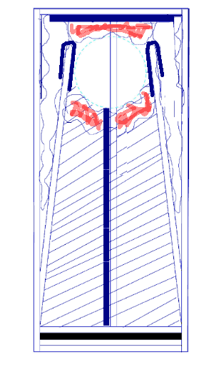

Re: Demetri, con't....
2/ the pointy end stuffed with poly fill
3/the top is then lined, as well as the partition for a few inches
4/ line the fat side of the holey brace.
5/ final tuning with loose polystuff just before and/or after driver (accessibkle thru driver hole).
dave
1/attached to the front baffle below the wooferNanook said:Question regarding the felt:
dave
ok, so I'm feeling a little stupid...
p10: you mean something like this?
The clouds are poly😉
the solid areas are felt lining the sides and holey brace
the cross hatch is felt lining the front baffle
I'll email you a dwg of a modified Demetri cut diagram so that one speaker can fit on one sheet of 60"X60" BB with the appropriate grain direction.
