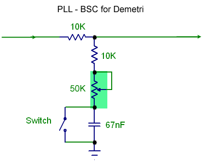

Gonna cost you some bucks to try. About 4.7mH in parallel with 4 ohms might do it. Add a variable resistor (or 1/2 an L-Pad) and adjust to taste. Big inductors cost $$.

well I moved the Demetris up very close to the rear wall (about 7" behind the enclosure). Hmm the bass and midbass go deeper, but I don't think improved the sound. A trade off between the "open" sound I like and an improved lower end in response.
pano mahn... I understand big inductors cost big $$$. My intent would be to do it passively and at line level between my passive preamp and power amp. I agree some kind of flexibility in regards to components (L-pads or easy to change out resistors) would be good for me.

That's a good idea, and much cheaper. 🙂
However, I have found that PLLXO really benefit from low drive impedance, like a good active preamp. Or maybe putting the filter before the pot. It's easy to make a passive setup sound wimpy.
Have a look at the circuit below. It could be used inline for adjustable BSC. I use something very much like it for OB bass correction. The pot allows you to dial in from about 6dB full correction to about 1dB. The switch bypasses the EQ, but not the attenuation. That way you can listen to the circuit flat, to hear if it is affecting the signal any.
Nanook said:My intent would be to do it passively and at line level between my passive preamp and power amp.

Have you seen this one?
http://www.t-linespeakers.org/tech/bafflestep/passive-BSC.html

panomaniac said:ave a look at the circuit below.
dave
Re: Re: Re: up against the wall.
Now I have! =) Thanks Dave.
Pretty much the same thing, but that one has a high end boost that I'm not using. Simple but clever.
FWIW, in my OB version I'm using a low more attenuation than is shown in my circuit above, as the OB needs it.
planet10 said:Have you seen this one?

pano,
Thankfully my preamp has an active mode as well the passive (McCormack micro line drive)., but I was hoping to keep that for possible subwoofer duty.
Dave , do you have any good software for generating and recording to cd? Audacity is a little cumbersome, and iTunes sux!
I don't need any high frequency boost, I do need the low end to offset in room placement. The Demetris really sound good, except for the lack of bass (so sez the significant one , who's the real bass head in this house😉 ).

pano,
