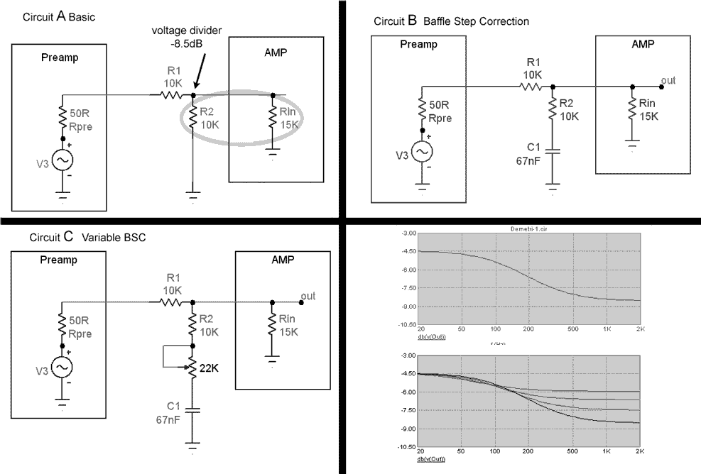

Variable BSC Circuit Part 1.
There were some questions about the circuit I posted above, so I thought it best to explain what's going on and how to use it and modify it if you want.
The way the PLL (Passive Line Level) filter works is just a voltage divider. Have a look at the basic "Circuit A" in the image below. You'll see a basic voltage divider circuit that attenuates all audio frequencies the same amount. In this case, by about 8.5 dB - a little more than 1/2. A potentiometer works the same way.
In this example we have assumed a low output impedance for the preamp or other source about 50-150 ohms. We assume a reasonable input impedance for the amplifier - here 15K. The voltage is divided between R1 and R2 with Rin. That's why there is a circle around R2 & Rin. Together they = 6K. So the attenuation is more than 1/2 (6dB) in this case about 8.5dB
In Circuit B "BSC" we have put a small cap in series with R2. What does that do? Well... a cap is going to have an AC impedance that changes with frequency. Very handy! Think of the cap as another resistor in series (more resistance) with R2. But it's a "resistor" that changes value with frequency. The lower the frequency, the higher its "resistance" (impedance). This 67nF cap has an impedance of 120K at 20Hz and 1.2K at 2000Hz.
So you can understand how C1 in series with R2 will attenuate the highs more than the lows. More current will flow thru it at higher frequencies, draining them off more than the lows - limited, of course by R2.
You can see the resulting curve charted below. We go from 4.5dB attenuation at 20Hz to 8.5 at 2Khz. A difference of 4dB. Not much, but all we probably need.
Variable BSC Circuit Part 2
Now lets look at Circuit C, the variable BSC.
You see that we have added a variable resistor in series with R2 and C1. It’s just a pot or trimmer with the wiper tied back to the input.
Remember in part one how the variable impedance of C1 changed how much the highs are attenuated compared to the lows? Same idea here, except that the resistor is frequency linear. So we are adjusting how much overall attenuation is applied. The higher the resistance of the pot, the less attenuation, right?
This lets us dial in less attenuation, if we want it. Why? To match your room and your ears. Full baffle step attenuation should be 6dB, but in most listening rooms it’s more like 3dB as the room tends to fill in the lows somewhat. As seen in the second chart, the pot allows you to vary how much BSC you get from about 1.5 to 4.5dB. That’s a pretty subtle adjustment, but should be about right for most rooms.
Want more range? Change R2 to about 2~3K. You’ll get more attenuation overall, and more difference, too. The pot value can be changed if you like, but 20K to 50K will work well. Keep R1 and C1 the same.
You can even put a switch across C1 to short it out. The will make the circuit frequency flat again, just like circuit A. By listening to the circuit with out the cap and its “bass boost” you will be able to determine if the circuit is having an effect on your audio. Having a series resistance in line can have the effect of less drive and less bass, so you need to be careful there. How much, if any, will depend on your preamp and amplifier input. But at least you’ll be able to test it.
Thank you for very good explanation.
Altough I have used PLL BSC for a long time,the attenuation hasn't been enough with equal size R1 and R2.Thanks to you,now I know to try changing the R2 to a smaller value.
I have found the PLL BSC to have more dynamic and clearer sound than with filters at speaker end.
