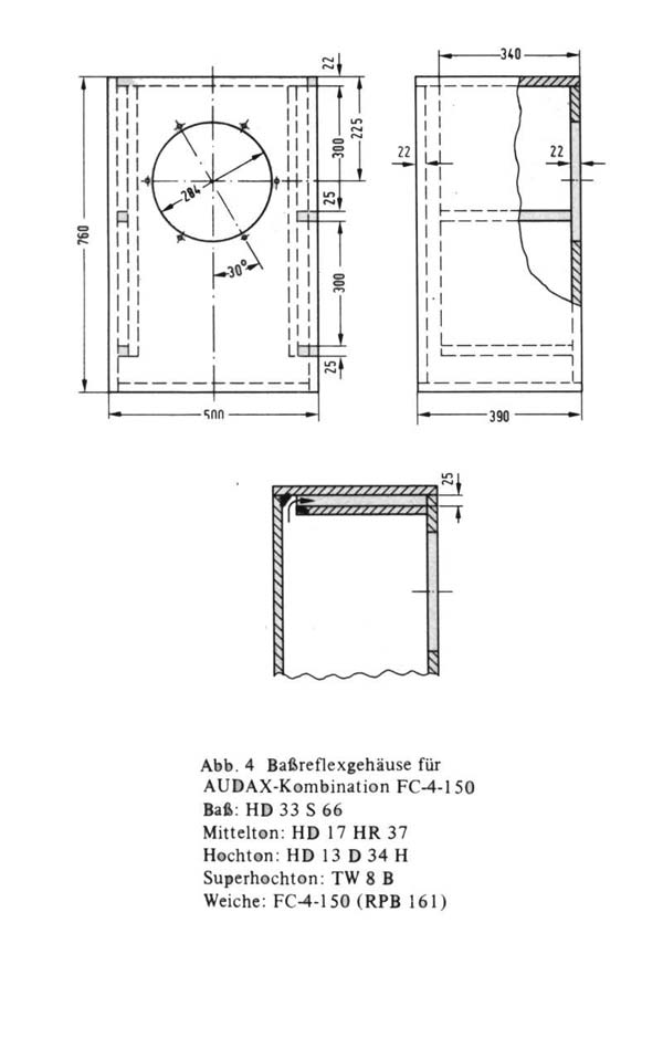

Cabinet Suggestion for FR8C?
Hi Gurus,
Can anyone recommend to me a simple to build cabinet for the FR8C? I would appreciate if anyone can share with me on their experience of the cabinet design for the FR8C.
I will probably not venture into Open Baffle design due to space constraint.....
Thanks in advance!

Re: Cabinet Suggestion for FR8C?
If you mean you won't be able to put them out into the room away from the walls......you should still try a cheap driver or one you may have lying about in an ob. Experiment, by damping the wall and/or the back of the driver and baffle one can often get good sound even with the baffles fairly close to the wall.
A bass reflex box is about as simple as it gets (short of OB). The Hemp Acoustics site has detailed plans for two sizes of BR cabinet for the FR8C. I'd expect the larger one to give a flatter response. The FR8C is pretty similar to its predecessor the FR810HQ, which is what I have. I originally had mine in an 82 liter cabinet tuned to 41 Hz.
I later built a pair of Metronome cabinets for mine, and I think they work quite well. Trickier to build than a square box, but the Metronomes are nicer looking and I think they sound better too.
Bill

Thanks Lin and Tim for your reply.
I am aware of the 2 box design provided by Hemp Acoustic which i will probably choose 1 of them. However, I will like to explore for any other alternatives .
Anyone have any idea whether the mini-onken works well with the FR8C? Just wondering whether the design in the attached file is suitable......

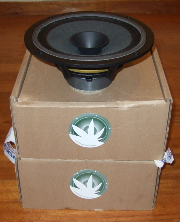

Re: Did anyone use the matrix yet?
I have a pair of the new matrix FR8C, just like in your photo.
Don't have old ones to compare to, tho.
They will be going on OB, with powered subs. Hemps to be powered by T-Amps, of course!
salas said:I have got a couple of the new 'matrix' version, has anybody made something to compare with the old one yet?
