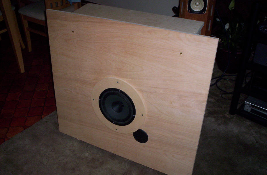

dmason said:Paul,
Did you build those BIB's yet?
Check the thread for a progress pic. Only a couple of days until they are ready to ascend to the living room.
pj

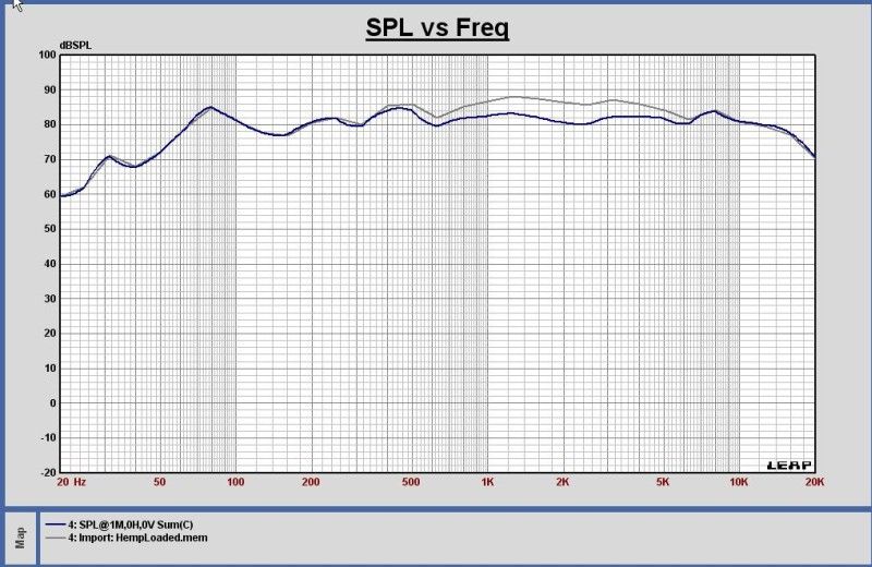

lousymusician said:
Salas,
Scanning back through this thread, I saw that in post #2 I managed to type 0.1 mH instead of 1.0, which is what I'm actually using. No wonder folks thouht I was out in left field! Gotta proofread more carefully, I seem to be getting more dyslexic as I age.
I dropped the resistor from 13R to 9.5R after treating the whizzer with a little damar varnish. I'm amazed that I wound up by SWAG right around were you got by measurement. I think that the ideal for my system right now would be somewhere in between. Maybe increase the size of the inductor a bit, too. I'm sure the bypass cap would help the measured response in the 10k - 20k range, but I don't feel a great need for it.
Do you have any before / after FR plots you could share?
Bill
Here it is. Gray is 'before'.
Hemp fr 8
