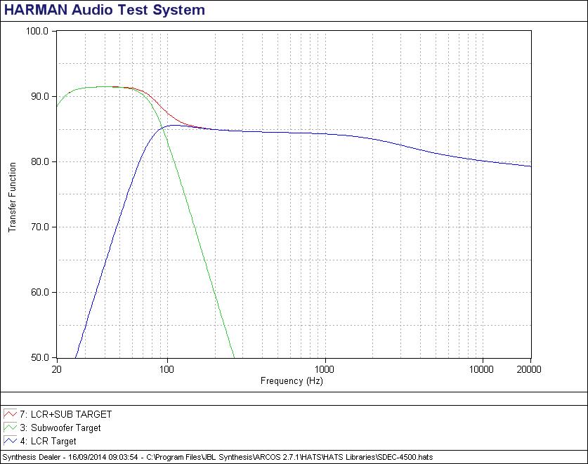

Without some sort of measuring gear you will struggle to get this set up properly. I think you said earlier that you were planning to cross as high as 750Hz which would probably require some EQ to deal with baffle step. Where is your xo point now and what slopes are you using ?
Just as an example for you my speakers are set up to follow the Harman curve and needed a 120Hz high pass on the receiver to get a close match to the acoustic 80Hz -6dB point. My subs also ended up with an 18dB/oct slope added to the receivers low pass to get the correct acoustic slope. I'd never have been able to do this by ear. (the attachment is the target curve I used)
